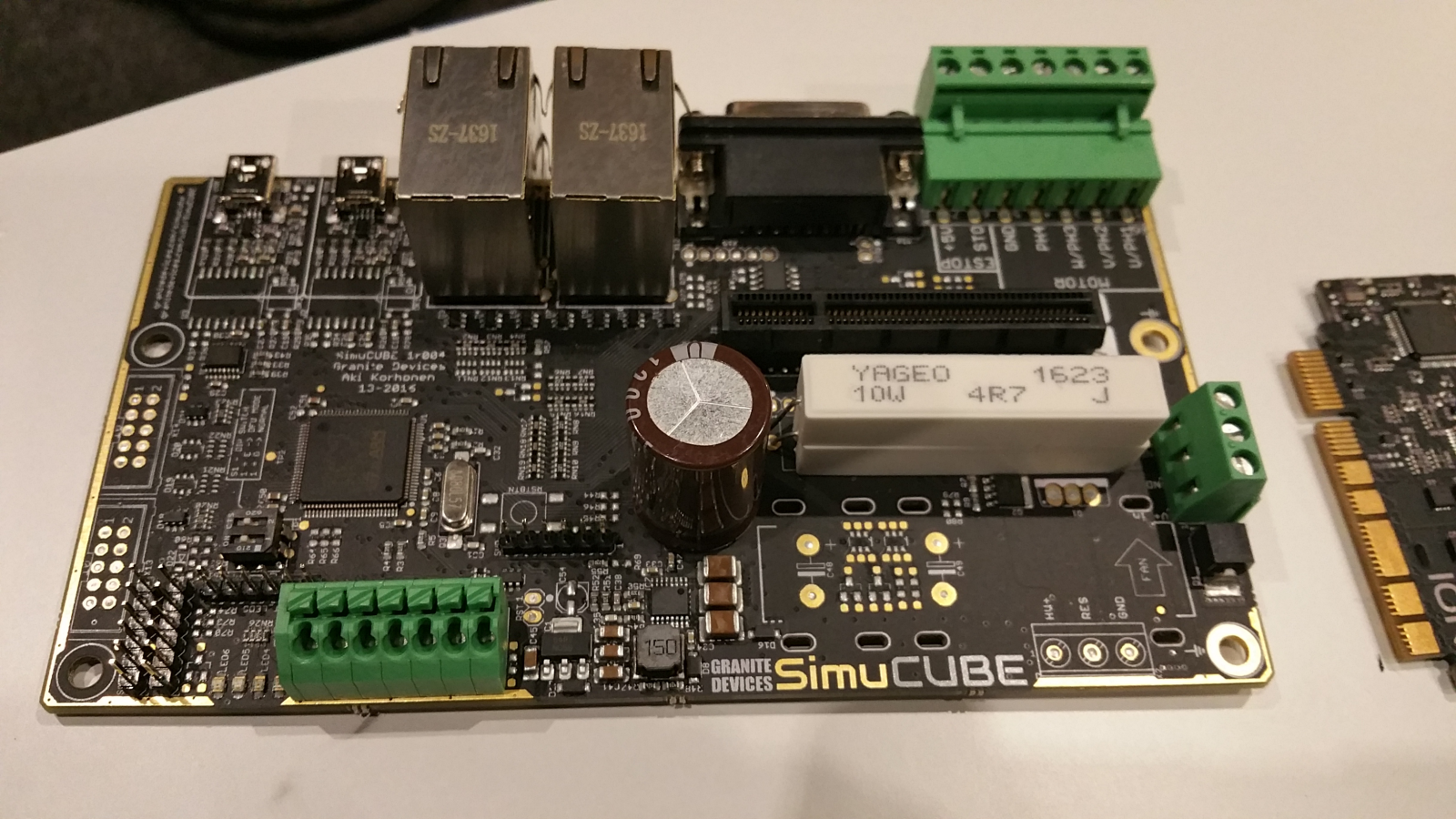

    Simucube Simucube £200.00

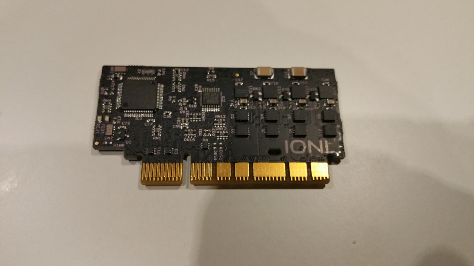

    Driver ioni driver £120.00

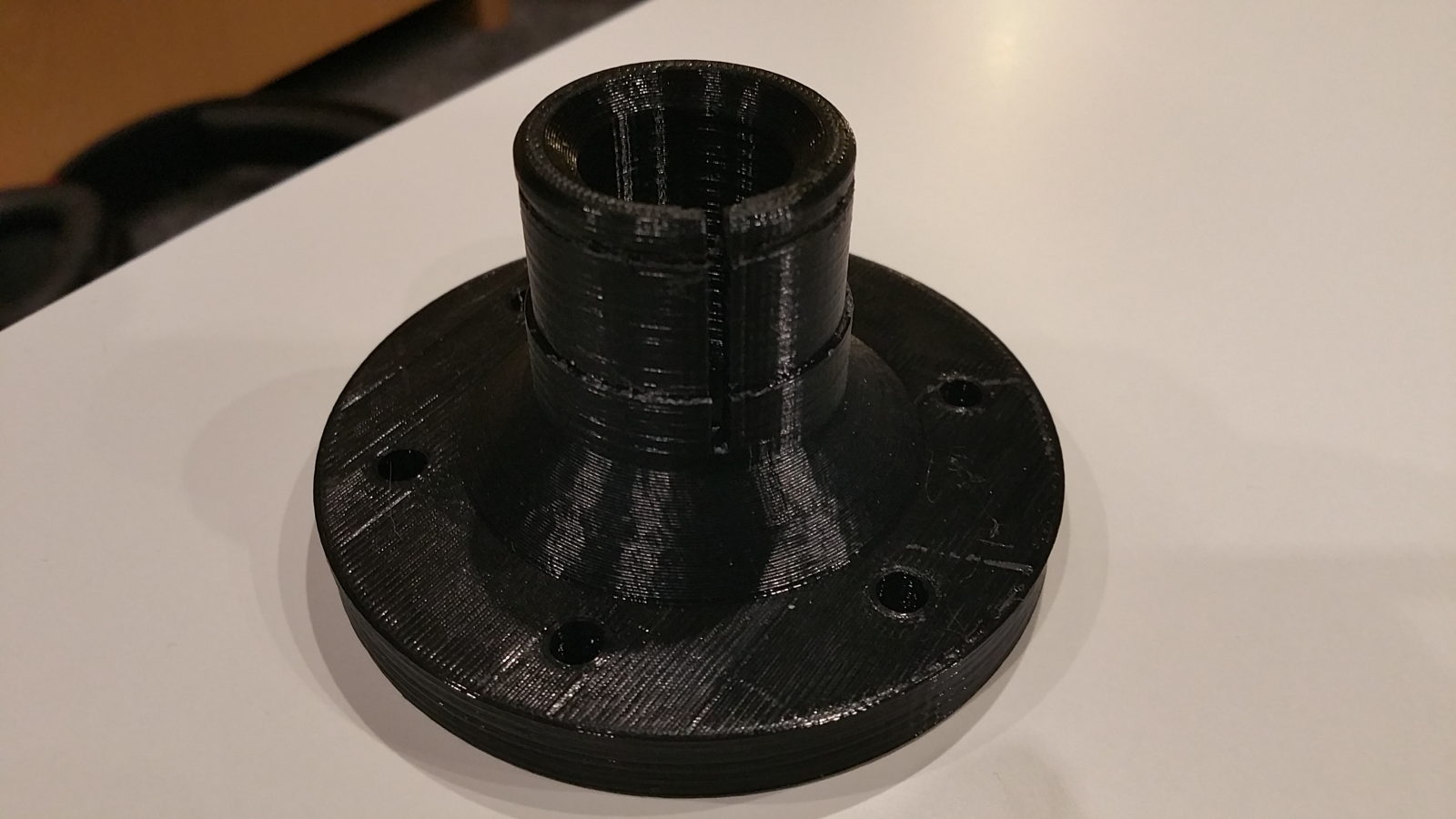

    3D Printed QR Clamp http://www.thingiverse.com/thing:1575453 £0.50

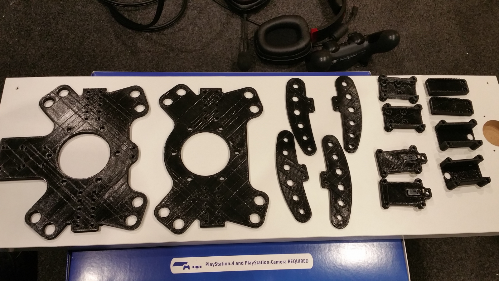

    3D Printed Shifter Paddles http://www.thingiverse.com/thing:1678086 £2.00

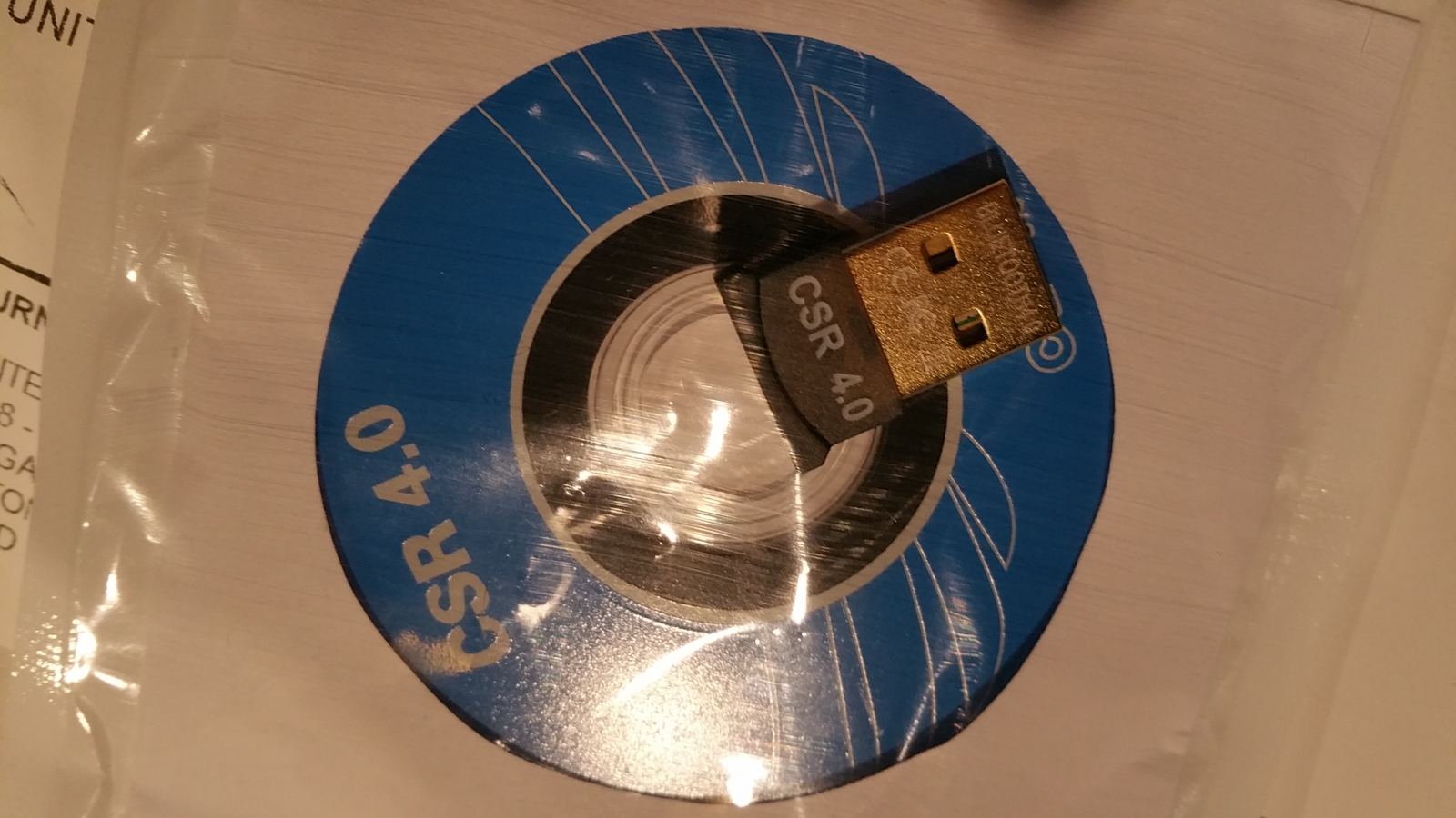

    BT Dongle USB-Bluetooth-V4-0- £3.19

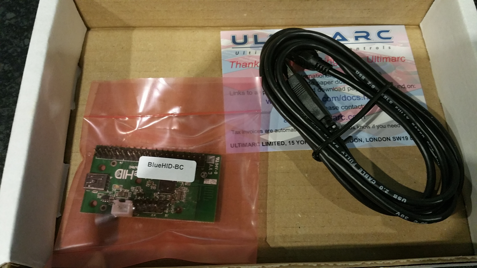

    BlueHid BC BlueTooth controller £50.00

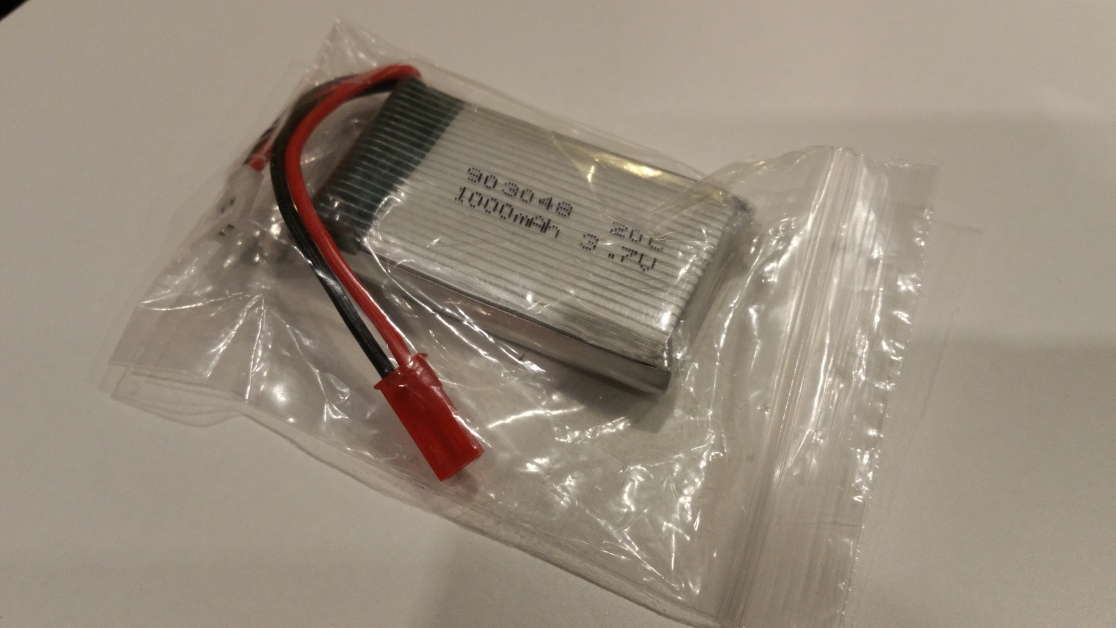

    Battery 1000mah LiPo Battery £3.69

    I will add pictures as I progress :)

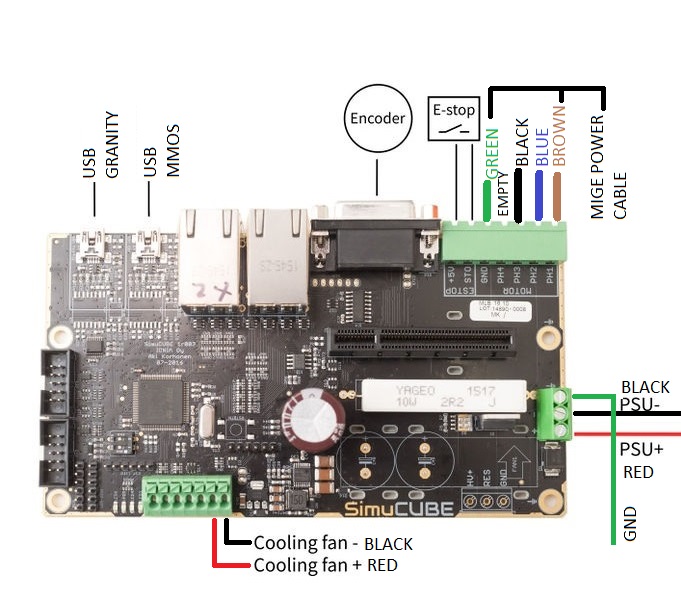

    you'll need a NC e stop. I'm eager to read your reaction going from G27 to dd.

    Do I need any plugs and adapters from the motor cables to the simucube ? hmmm thinking about whilst I am writing it would be easier to go look at the wiki :p

    Just the d-sub 15 pin female plug for the data cable.
    photo provided by Joe sullivan @Iracng forums

    thats handy you just posted this. i was just about to start a topic as i couldnt connect my wheel to granity to change the settings for dirt. I just noticed that the 2nd usb is for granity. i did have 2 cables plugged in the day i set it up and tested with one to play and it worked so left it out. that is such a relief. i thought i had buggered something up but it still worked in game so i couldn't figure it out.

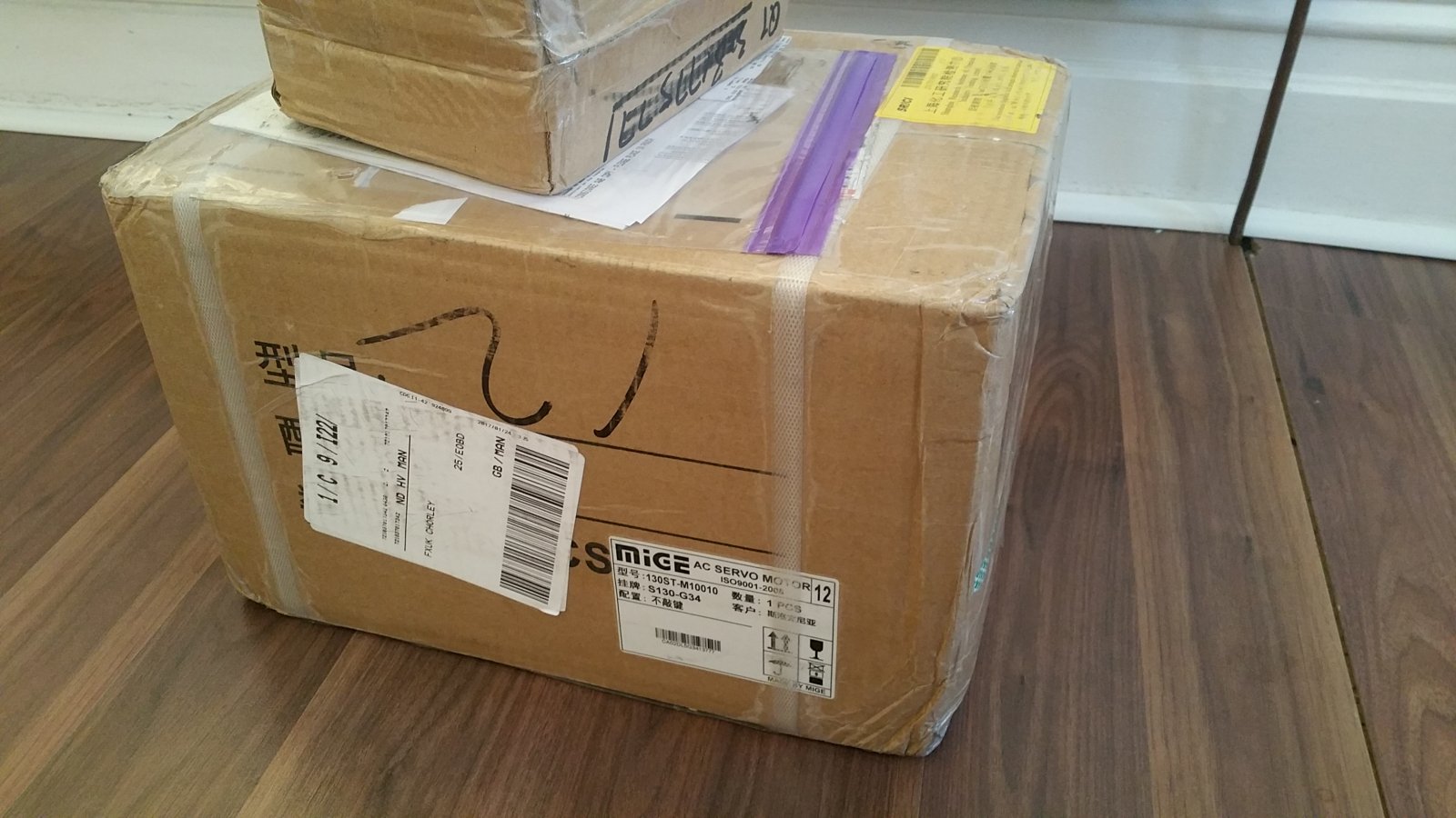

    My motor has been shipped and I have my FedEx tracking number :D

    Ioni Pro I got it 2nd hand ;)

    Wow that was some fast shipping ,,
