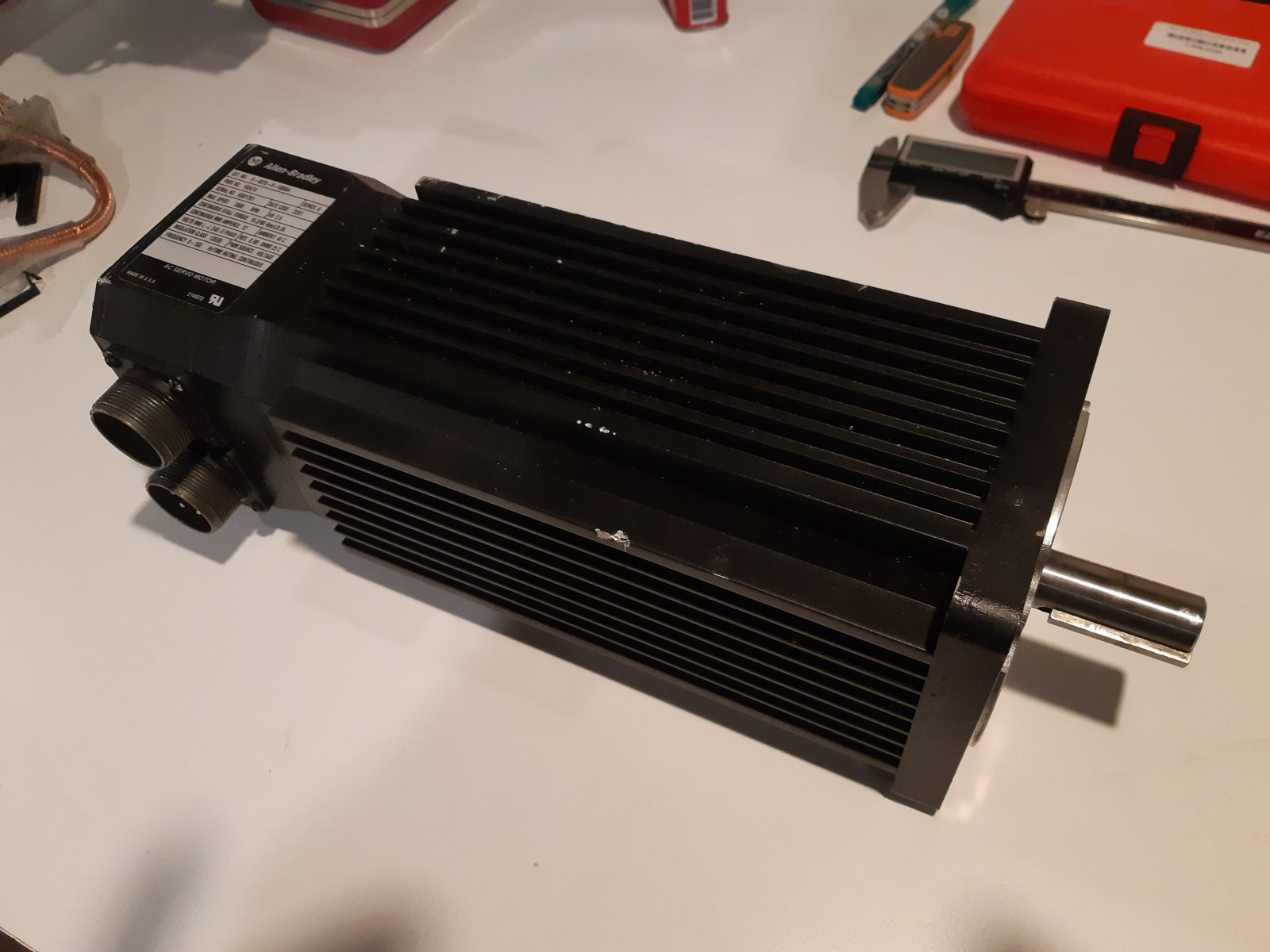

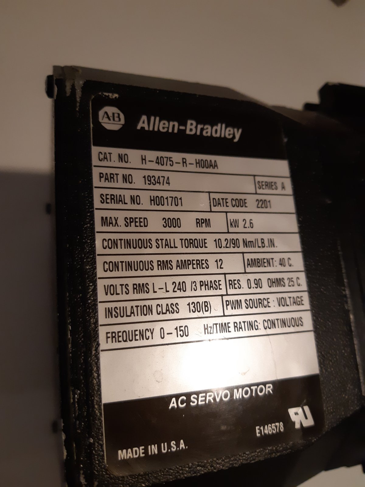

    The AC servomotor: It's an Allen-Bradley H-4075-R-H00AA

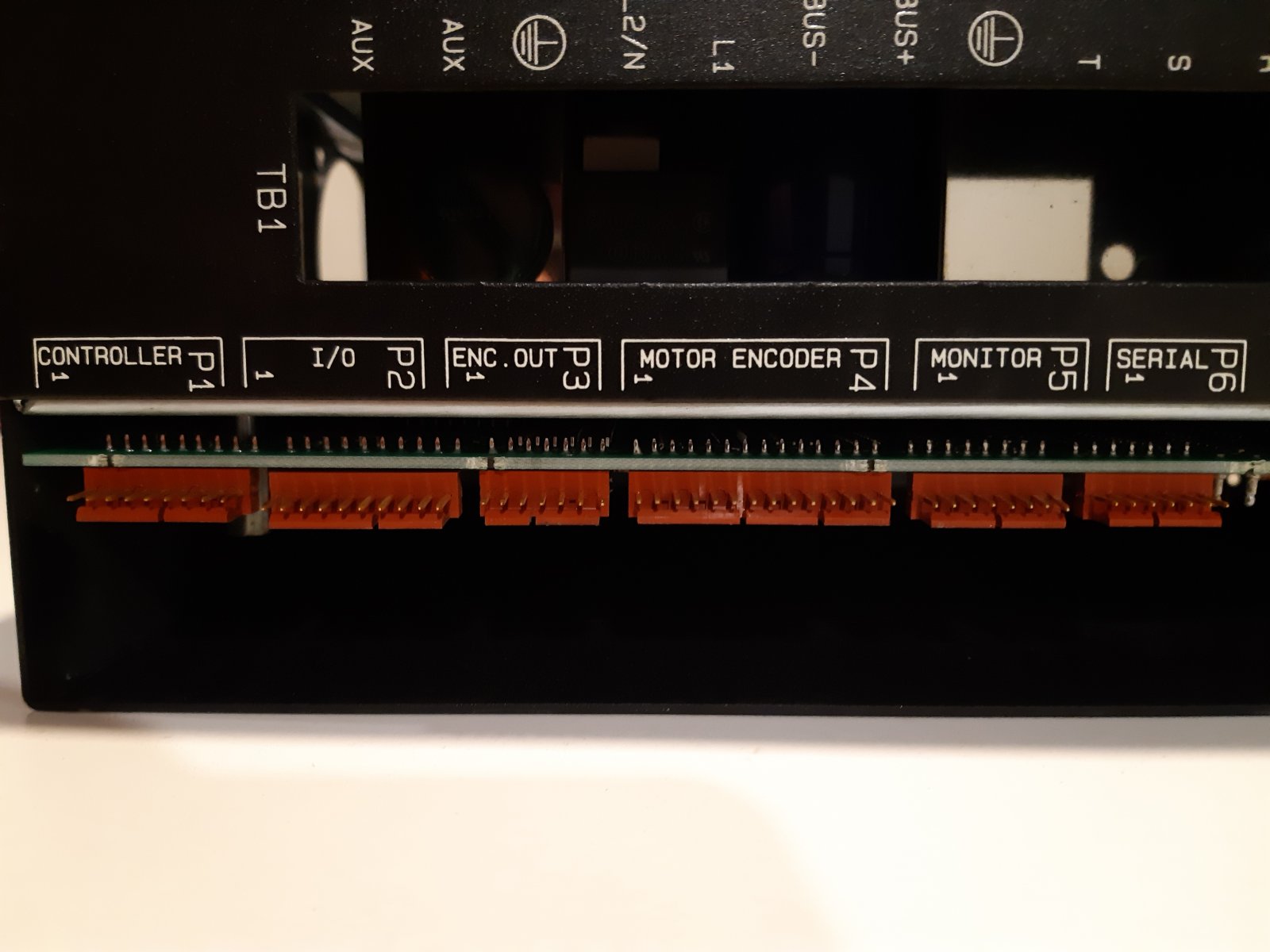

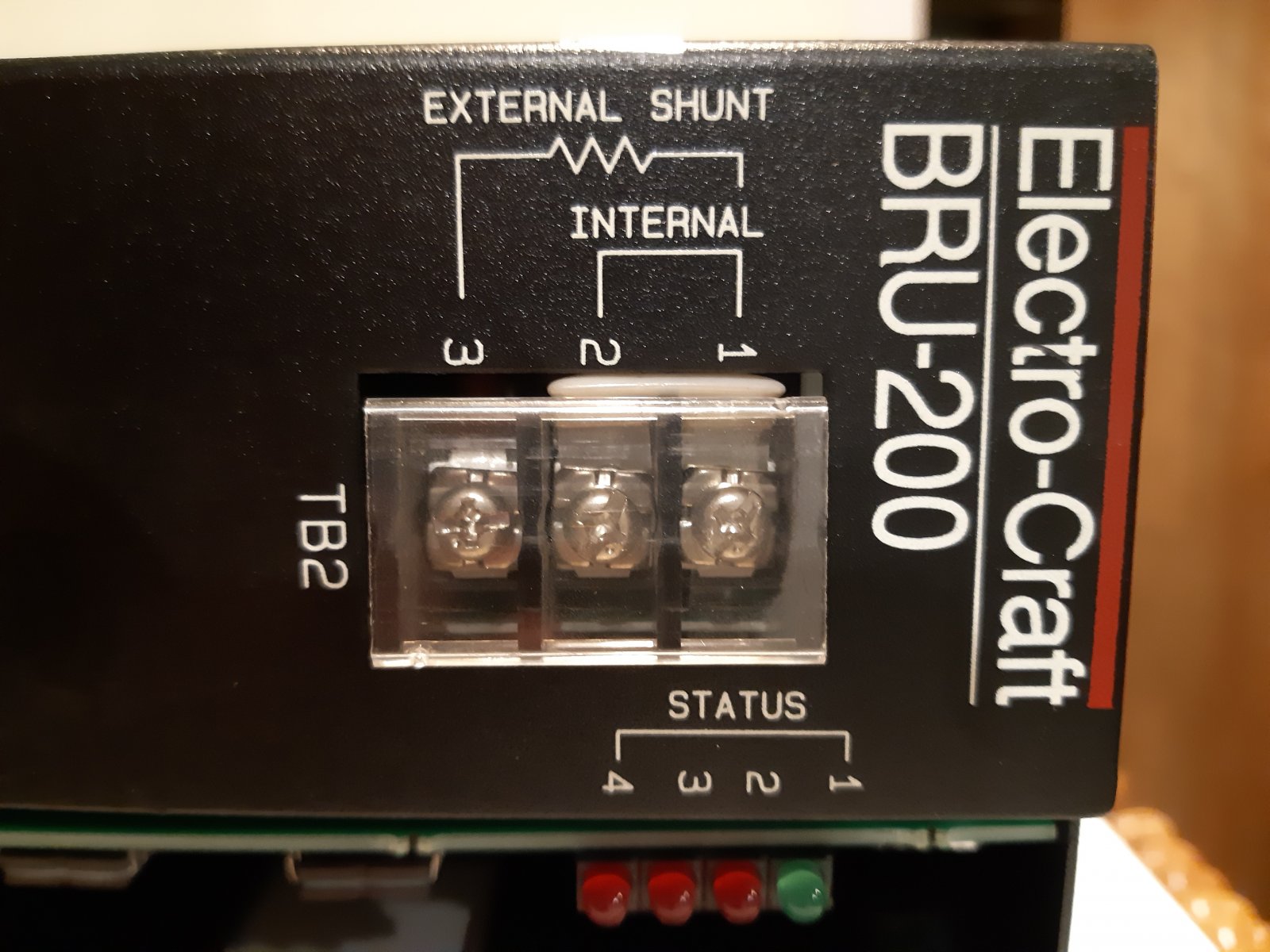

    The servo drive: An ElectroCraft BRU-200. I'll have to understand it and be able to interface it to the available STM32 firmware. That will be the challenging part :)
    https://www.axcontrol.com/pdfs/bru-500.pdf

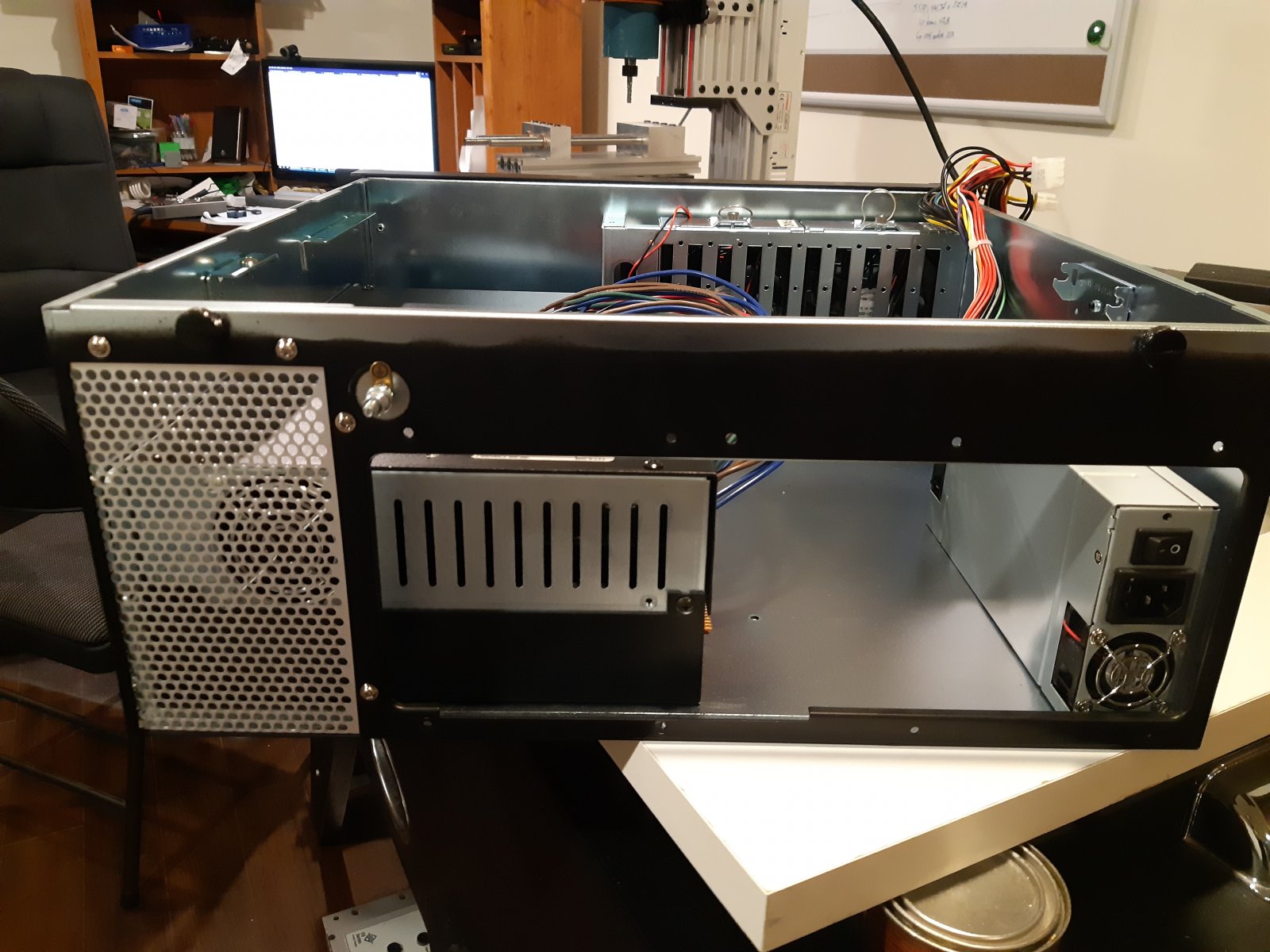

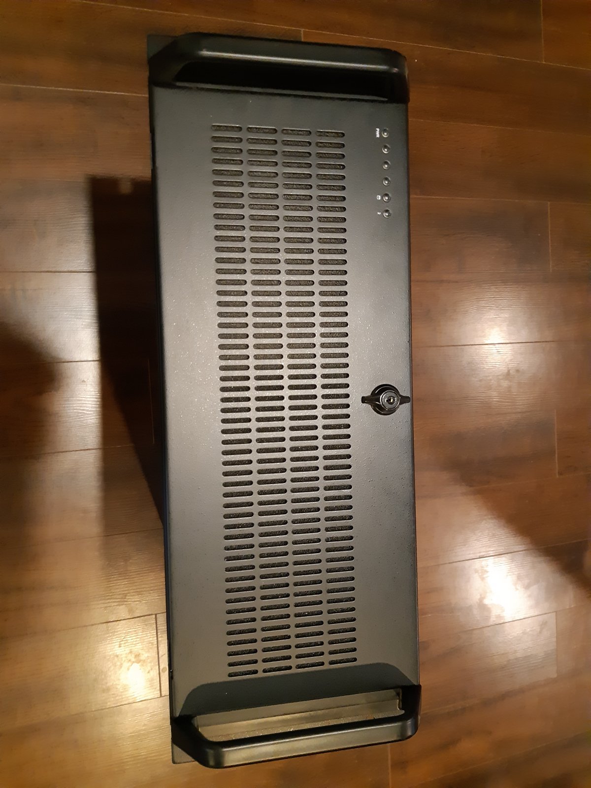

    I also plan to put everything in a 4U 19" rackmount case. I'll probably add another 4U over it afterwards for the computer.

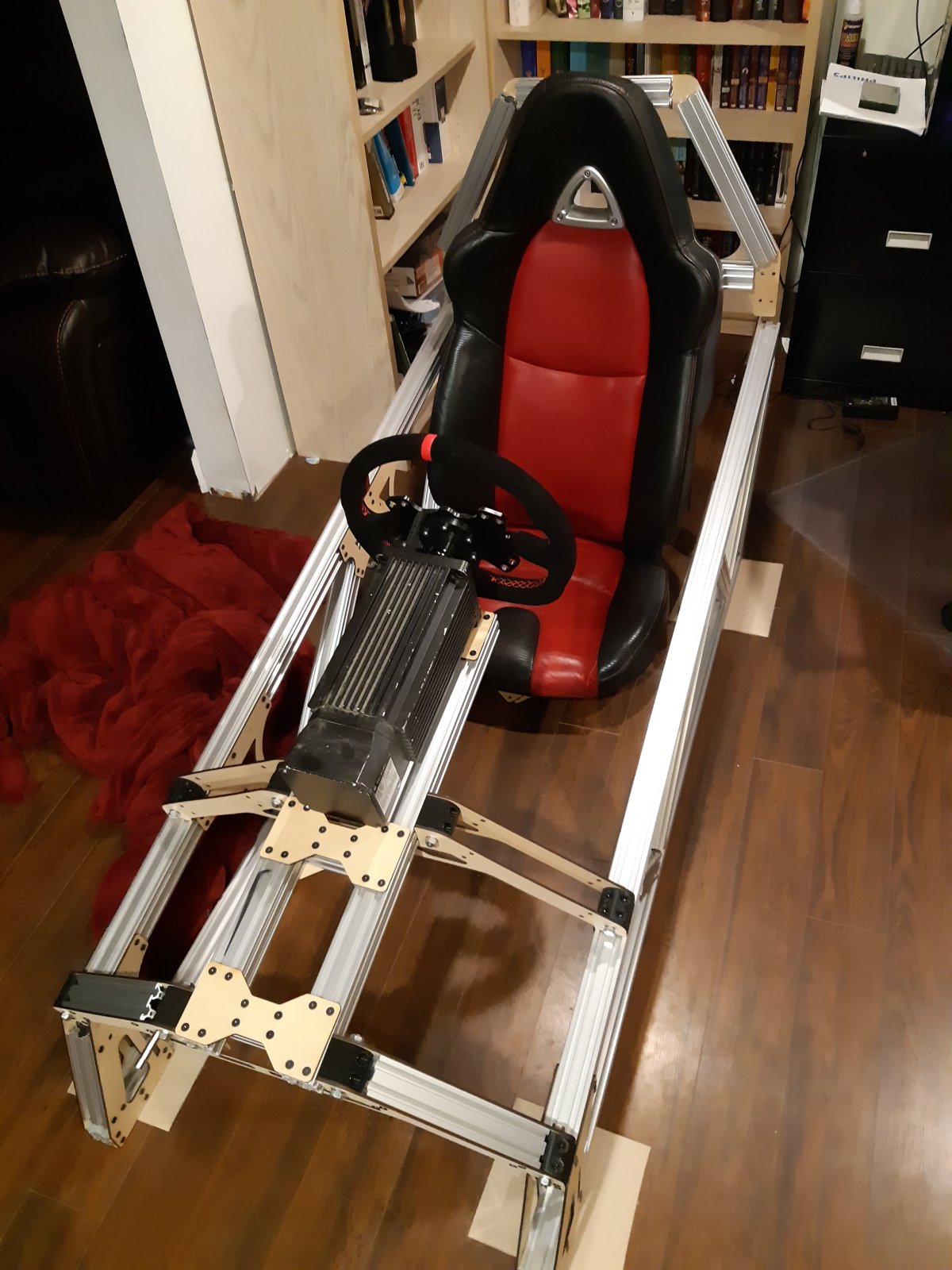

    IMechanical:
    This section will contain everything related to mechanical stuff.
    The wheel:

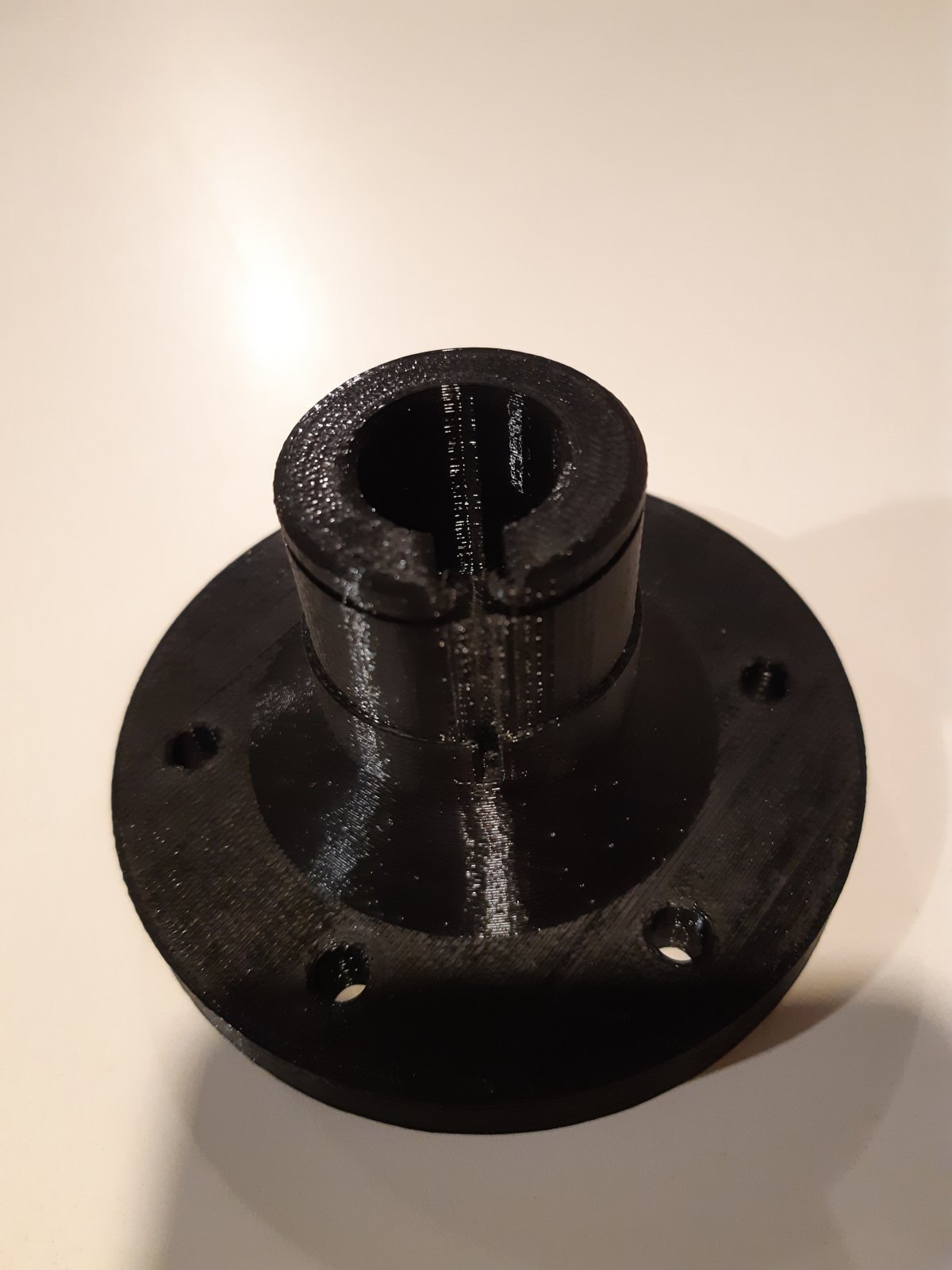

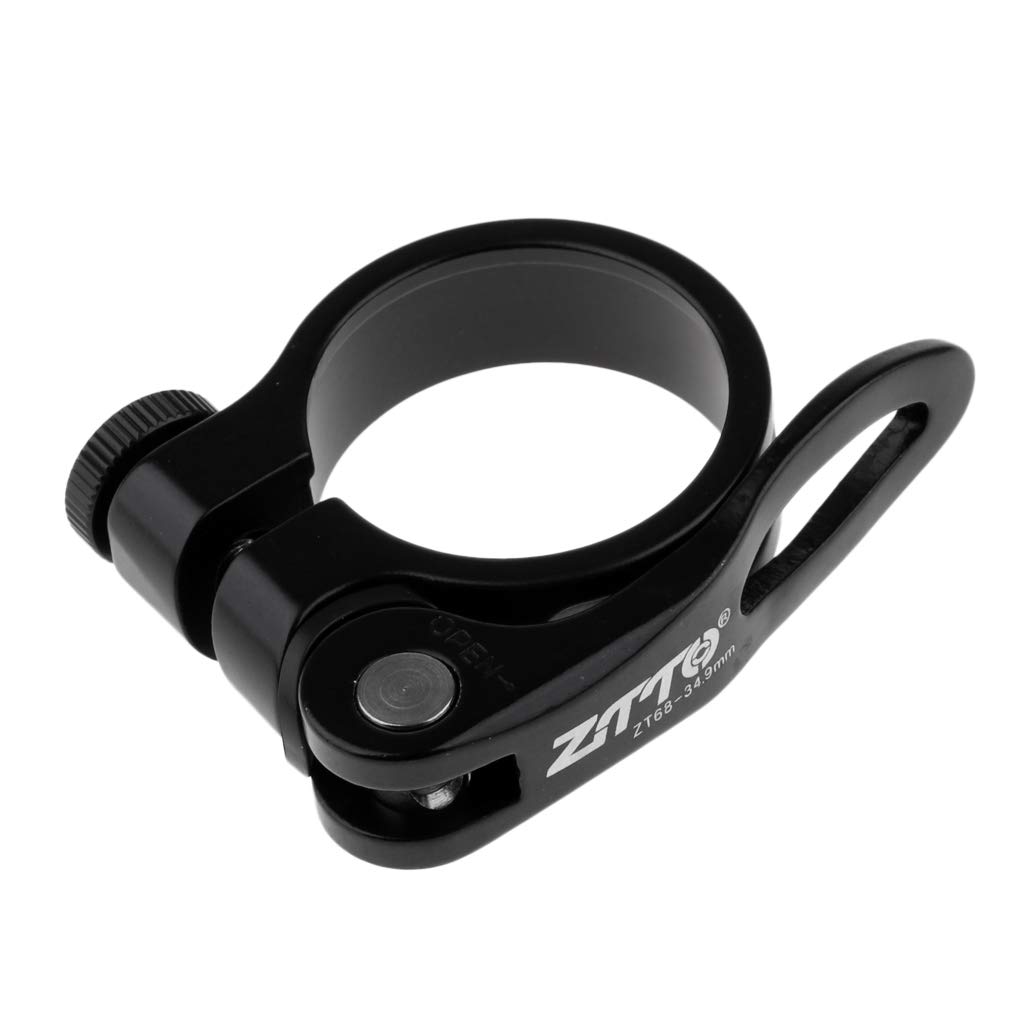

    Here's a 3D printed part available on thingiverse for a cheap quick release mount for the steering. As my motor have a 19mm shaft, I did a remake of the original design to be able to fit it.
    (22mm shaft version) https://www.thingiverse.com/thing:1575453
    (19mm shaft version) https://www.thingiverse.com/thing:3559786
    I also bought a bike seatpost quick release (34.9mm) on amazon
    https://amzn.to/2V4YnFG
    For the actual wheel, I went for the cheap Momo Aliexpress copy
    https://bit.ly/2IzWDOo
    The Seat:

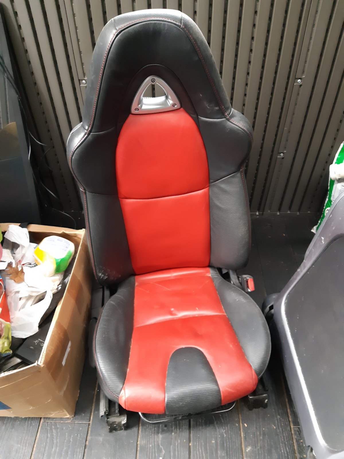

    A couple years ago I did a swap of those RX8 seats into my Mazda6. Long story short, I crashed it and I kept the seats (one is motorised). I finally chose to keep the one with manual adjustments as it is way lighter!

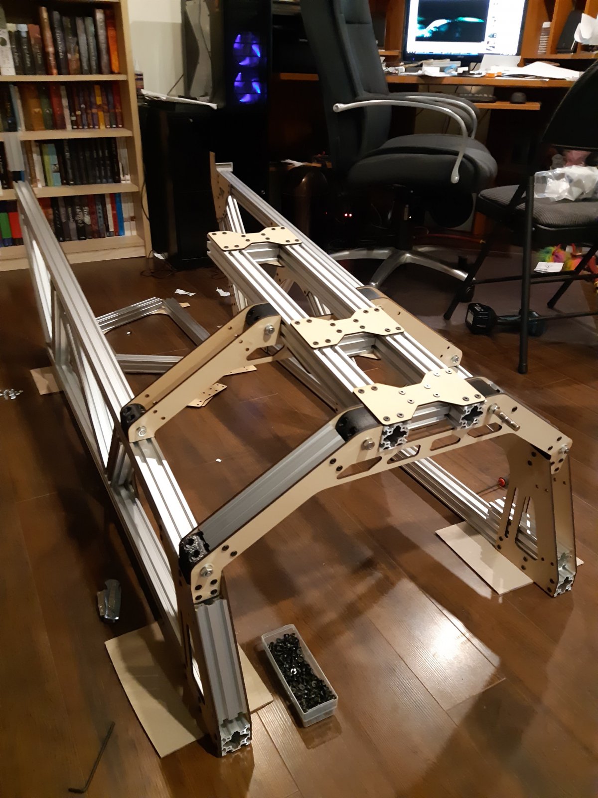

    The Frame:

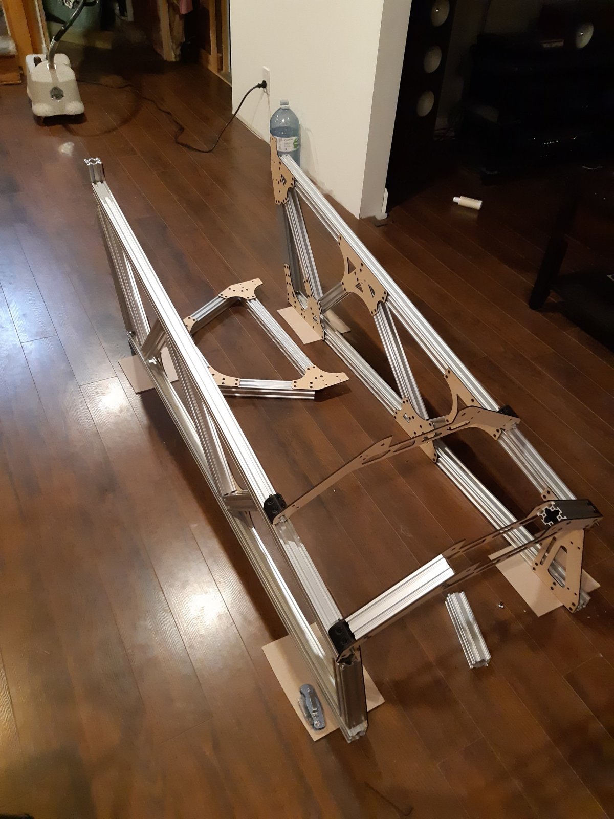

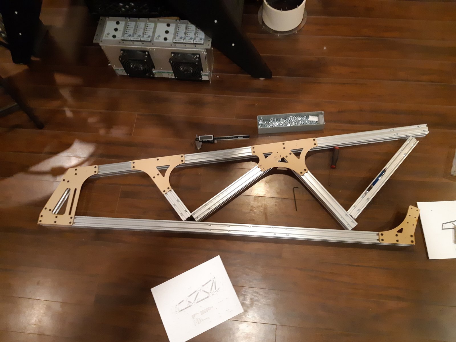

    I bought some plans (30$) from OpenSimRacing but as I was too cheap to buy the version will all the quotes I had to be creative to be able to have the same plates. Specially that I would have to modify them to fit my Openbuilds 40mmx40mm rails. I really don't know if I can share the plans of the (modified) plates so if there's demand I'll ask him. I'm progressing a lot and I've decided to keep the base of the seat with the standard adjustments as the back cushion is bolted to the base.
    I started to make the plates from 3mm MDF because that's what I had laying aroung and it's cheap to replace if I make mistakes in the design. It's surprinsingly rigid for now so I'll keep them like that until they doesn't fit anymore.
    https://opensimracing.com/collectio...a-8020-40-or-15-series?variant=12731702345805
    61215560_671927596610977_9136007660410241024_n.jpg 65386711_2299078576999917_2490431757178896384_n.jpg 62245867_815032842212582_2135355828587200512_n.jpg 64949497_2370732749860105_2985645600986365952_n.jpg 65515605_365814557412577_284960836592599040_n.jpg

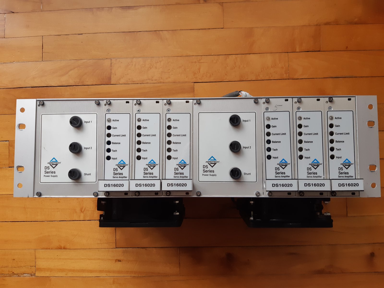

    Well well... call me crazy but I think a direct drive wheel and pedals won't be enough... I looked at a couple of builds and well... I HAVE to also build a moving seat! So my next question was... 2DOF or 6DOF? I don't really like the 3DOF and haven't took time to analyse the other ones... So I went into my garage to find inspiration... and the choice have made itself! I found something that was perfect for the project!
    So here's the beast! A six axis servo drive! So did I really have the choice? I don't think so! Now my girlfriend calls me crazy (nothing new under the sky), but I can live with that :p
    http://www.aerotechmotioncontrol.co...llerAccessories/Other Amplifiers/DSR_DSRF.pdf
    Another plus is that I plan to store everything into a rackmount closet and run the cables from there to the rig afterward, so I'll be able to "kind of" move the thing around for events or whatnot.
    Now I have to dig around to see if I have the matching motors... stay tuned!

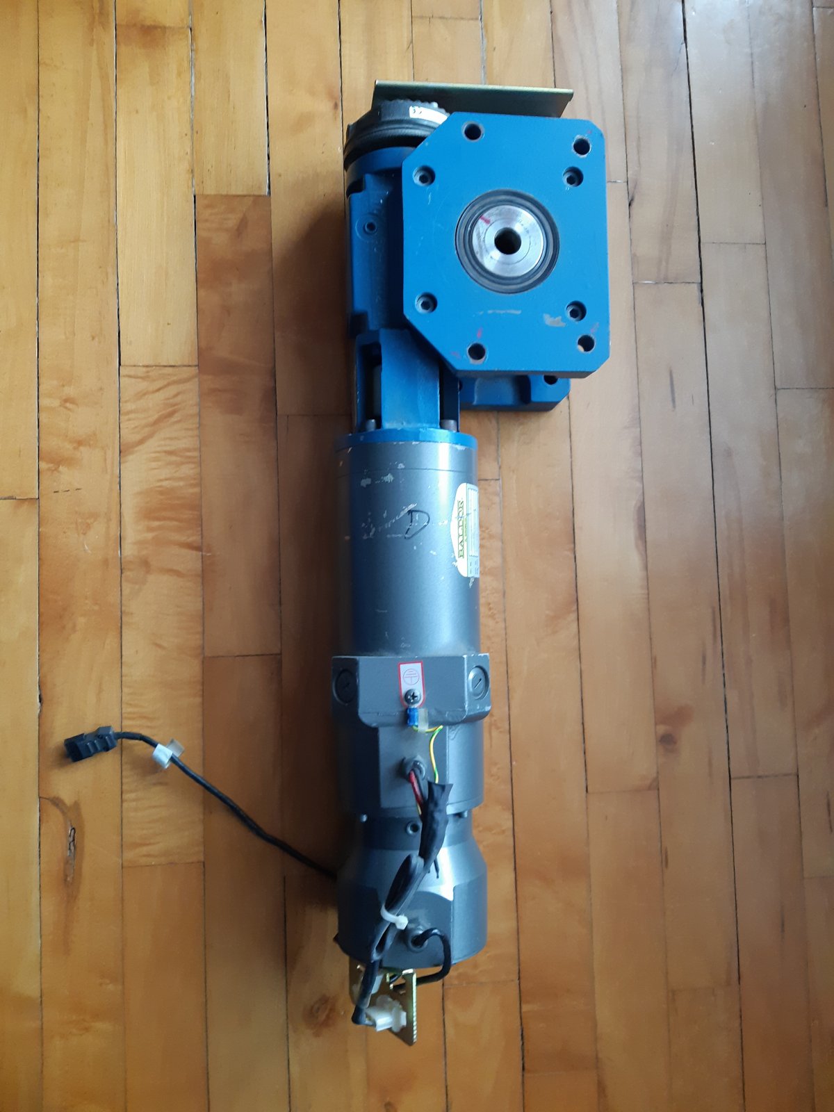

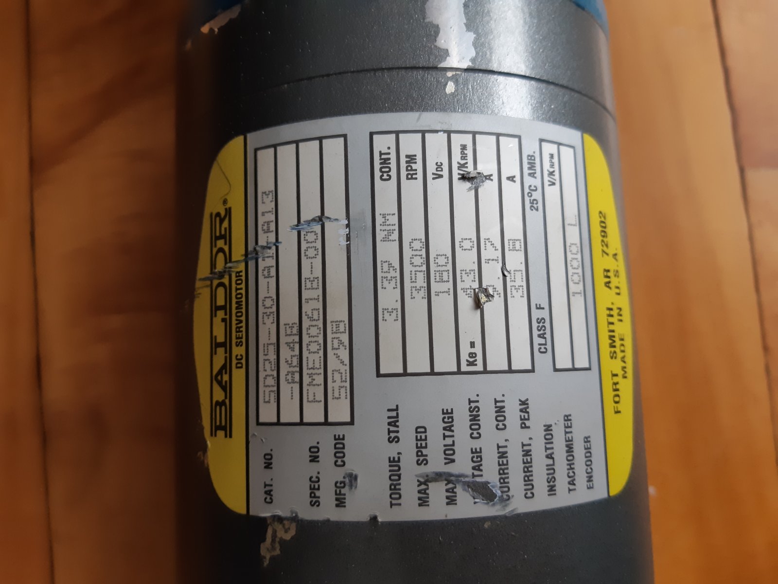

    I dug around and found 4 of those beasts... The specs seems to match the drivers :) Will it be too much? Too big? Don't know yet! What's sure is that I'll need two more!

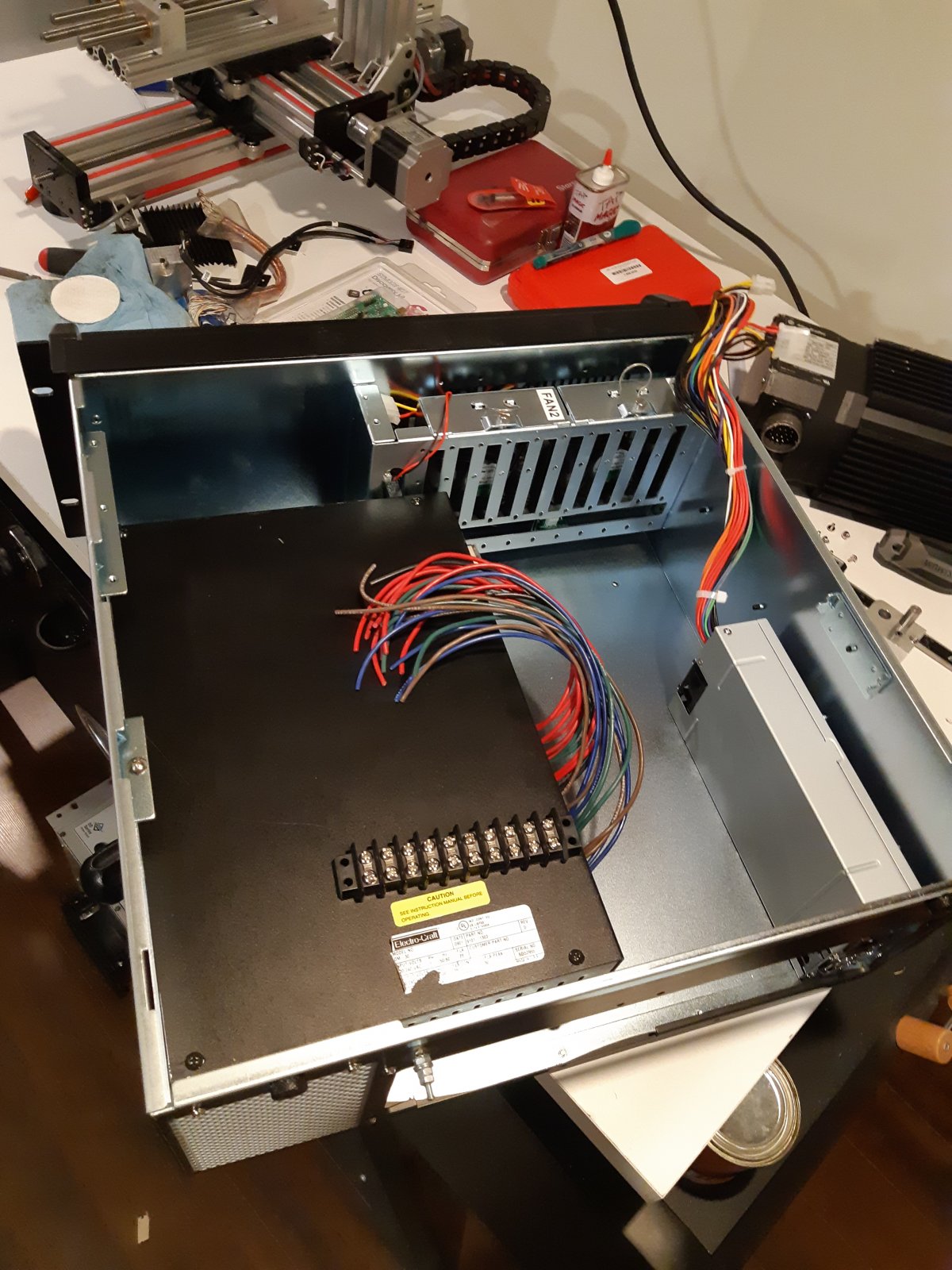

    Weekend update, I removed everything that was in the 4U rack, removed the backplates and changed the one that was for the ATX power supply for a plain one. I also changed the broken connector on the drive for wires (I wasn't able to find a connector that was fitting). I did a test for the fit of the drive and the supply and I'll have plenty of space for the remaining electronics.
