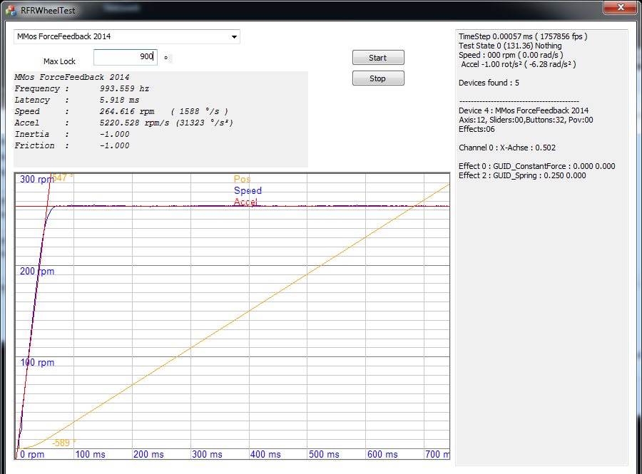

  13. Pit
    3,007
    30,516Coins
    +3,098 / 31 / -0
    agree, same I was building up a hypothesis by provoking the theory at the assetto corsa community that wheelcheck does not typically work with the OSW...

    did a test using a drift steering wheel (350cm diameter, 10cm depth) and got these results:
    Actually we should test without wheel - every wheel is different.

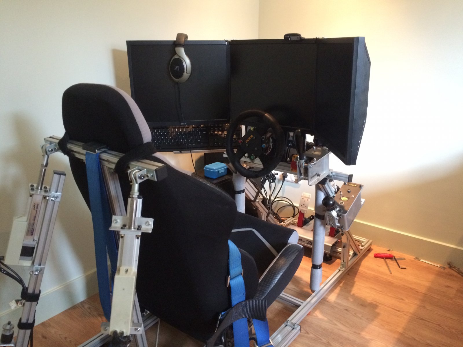

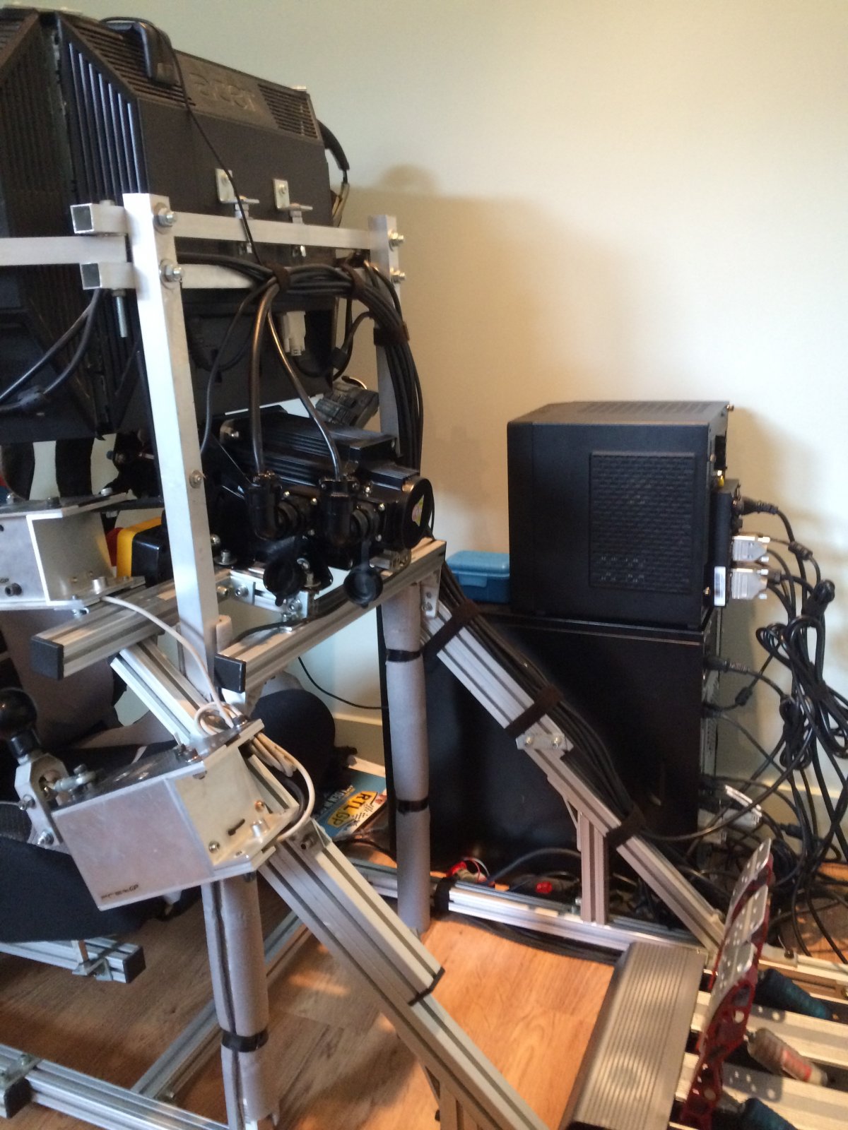

  20. bob williams
    bob williams OSW sfx100
    Apr 18, 2012
    123
    IT
    Ermelo, Netherlands
    113Coins
    +47 / 1 / -0
    Well I can confirme both GPL and NR2003 are working good. They behave quit similar. I am definitly not completly familiar with all the settings yet for finetuning.
    I have used a simple gamepad to connect the buttons from the steering wheel. Its located directly behind the wheel.
    So far I`m very impressed with the OSW, it really puts my rig to another level! IMG_5809.JPG IMG_5810.JPG
