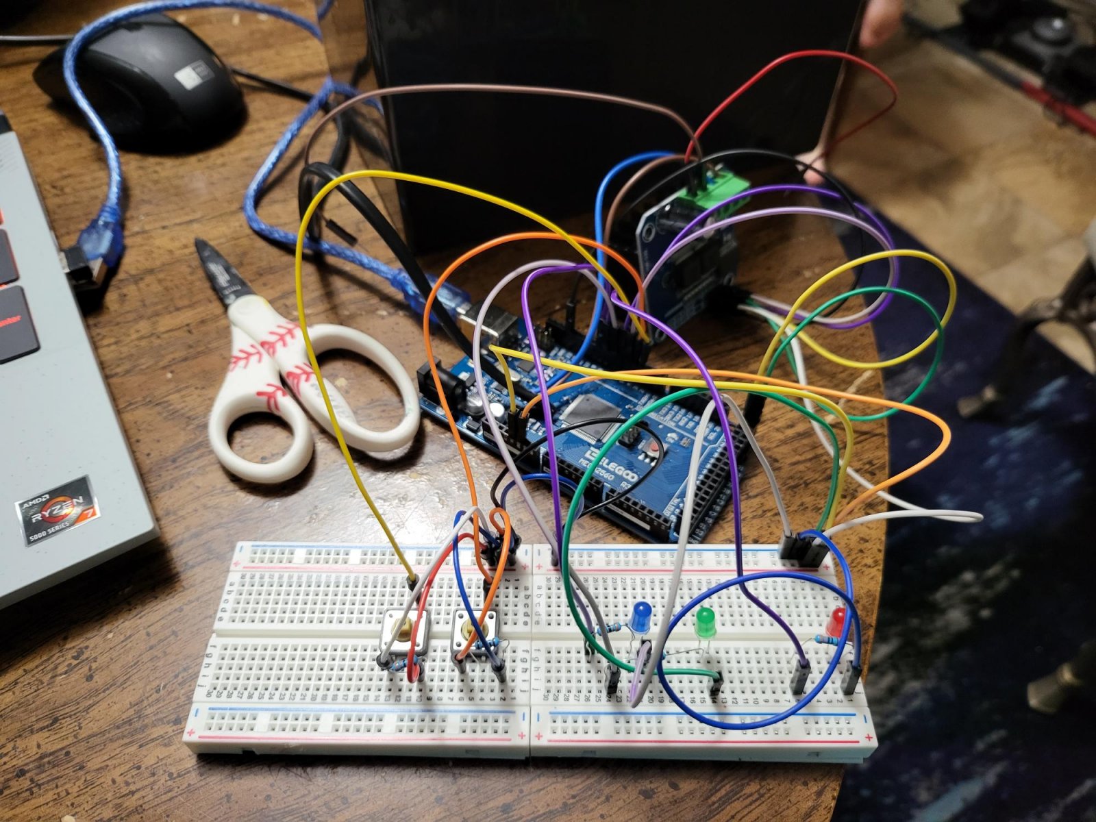

    Thank you for the advice noorbeast, I used the post that you attached to build the code for the Mega. From what I believe the coding for the Mega and Uno are the same with the exception of a few extra bits of coding. Having found some good videos on how to program the Mega I have so far been pretty successful at using C++. The only issue I am having with coding is the syntax and how the compiler accepts it. This is what I have so far lol. Build Pic 1.jpg

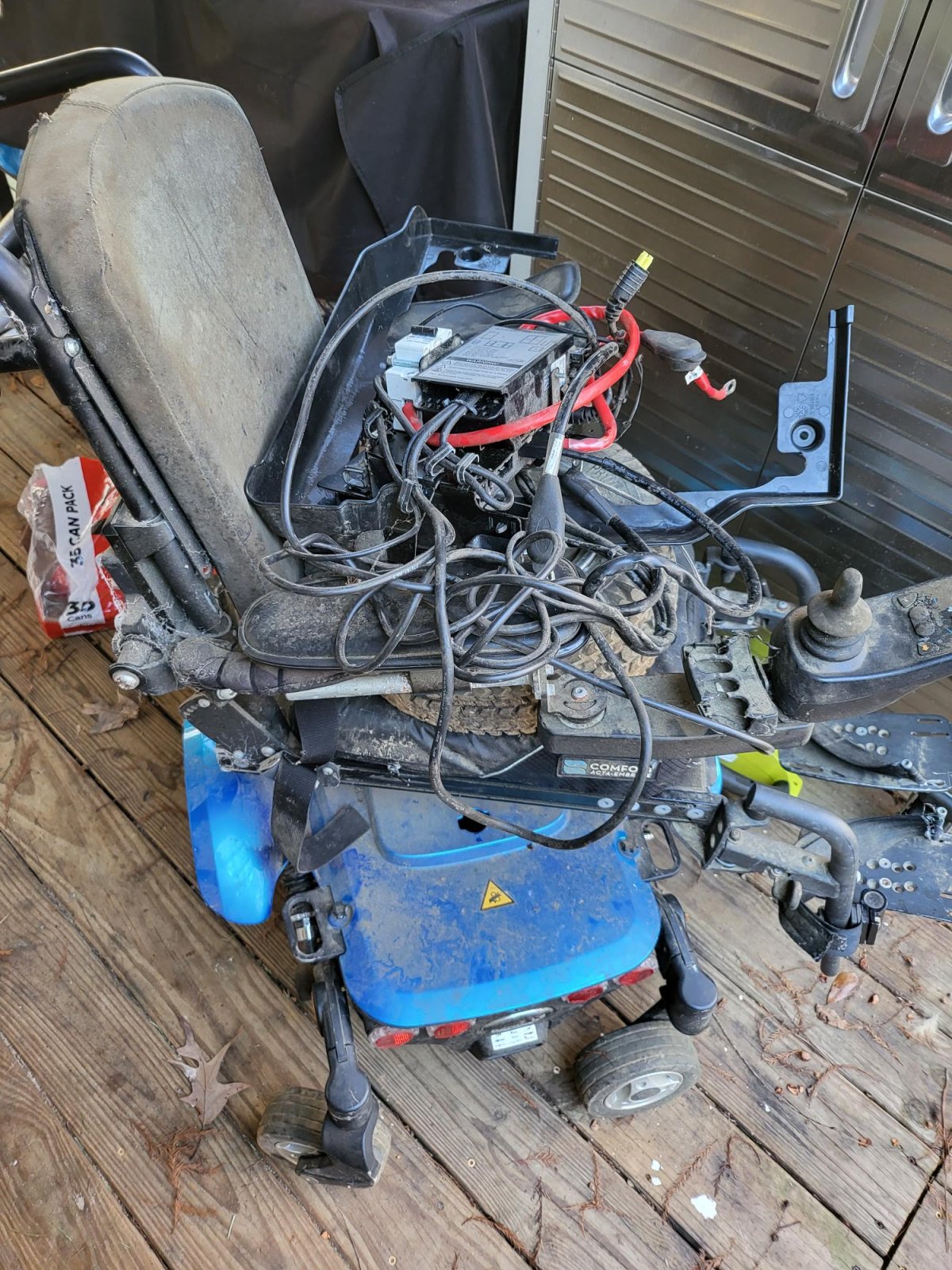

    Build Pic 2:
    I have harvested the batteries from the power chair and others I had laying around. Once I recondition them I should have enough power to run the rig.

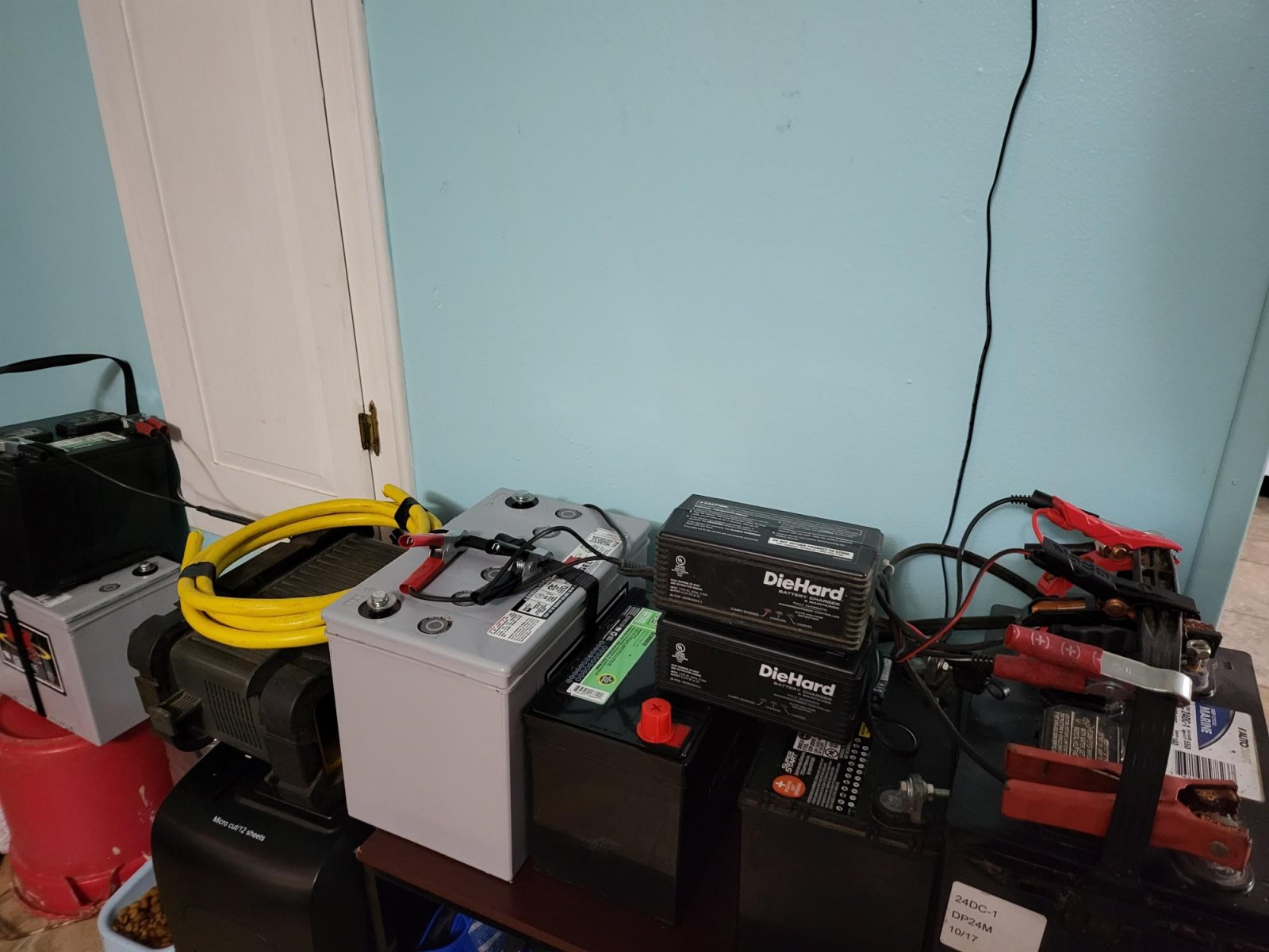

    Build Pic 3:
    It was a good chair for many years. I tried to donate it after my son got a new one but no one would come and get it. I found one organization who was interested but wanted me to bring it to them for free so they could harvest the parts for resale. Needless to say I kept it and now am putting it to use.

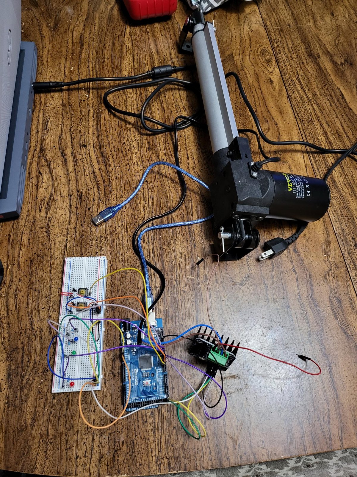

    Build Pic 4
    I was able to remove two of the three motor to use in the sim build. They are 24volt 350 watt 4500 rpm DC motors that should have more than enough power to move the rig,

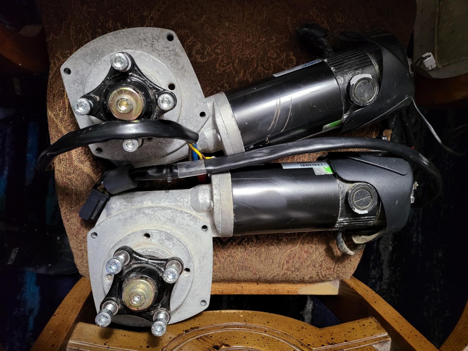

    Build Pic 5
    I also got this motor off Amazon for testing which is a linear actuator that is 16inchs long and has a lift rating of just over 1300lbs. The issue with it is that it is slow so I am going to use it to possibly move the chair up and down based on user input.
