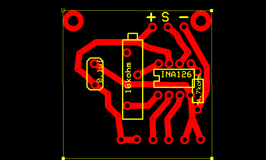

    I have attached the pcb I made for this project, there are 6 pins where the load cells attach, I used similar load cells to @RacingMat I just put 6 screw terminal block on the board pcb load cell.png

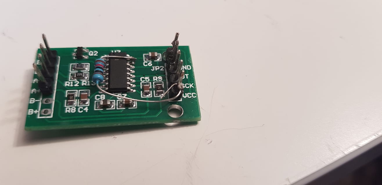

    Got my Uno working with HX711 clone and Unojoy.
    You will need to do some soldering to get the clone into 80 hz mode. The default 10hz lags for the axis
    Lift pin 15. Add a 10k resistor and route it to Vcc 5v (could probably do it another way too but i dont know)
    Threw in the code. Ill be adding for Ard Leo/micro once it arrives.

    @Trigen Can i use hx711 with Arduino Pro Micro + your code

    @Trigen I would like to use your code for a load cell brake with a HX711 and an Arduino pro micro. Would you be able to help me with the connections between de HX711 and the pro micro? And which of your codes I could use best?
