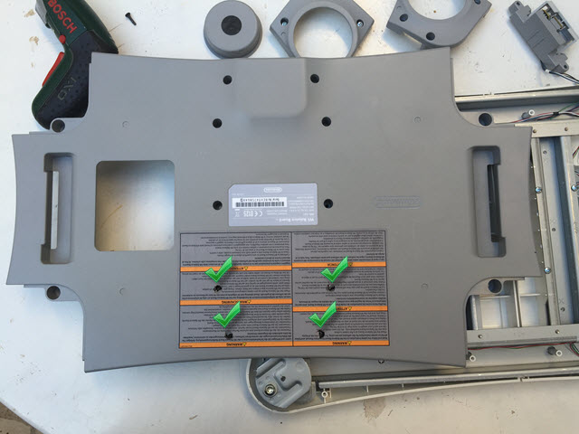

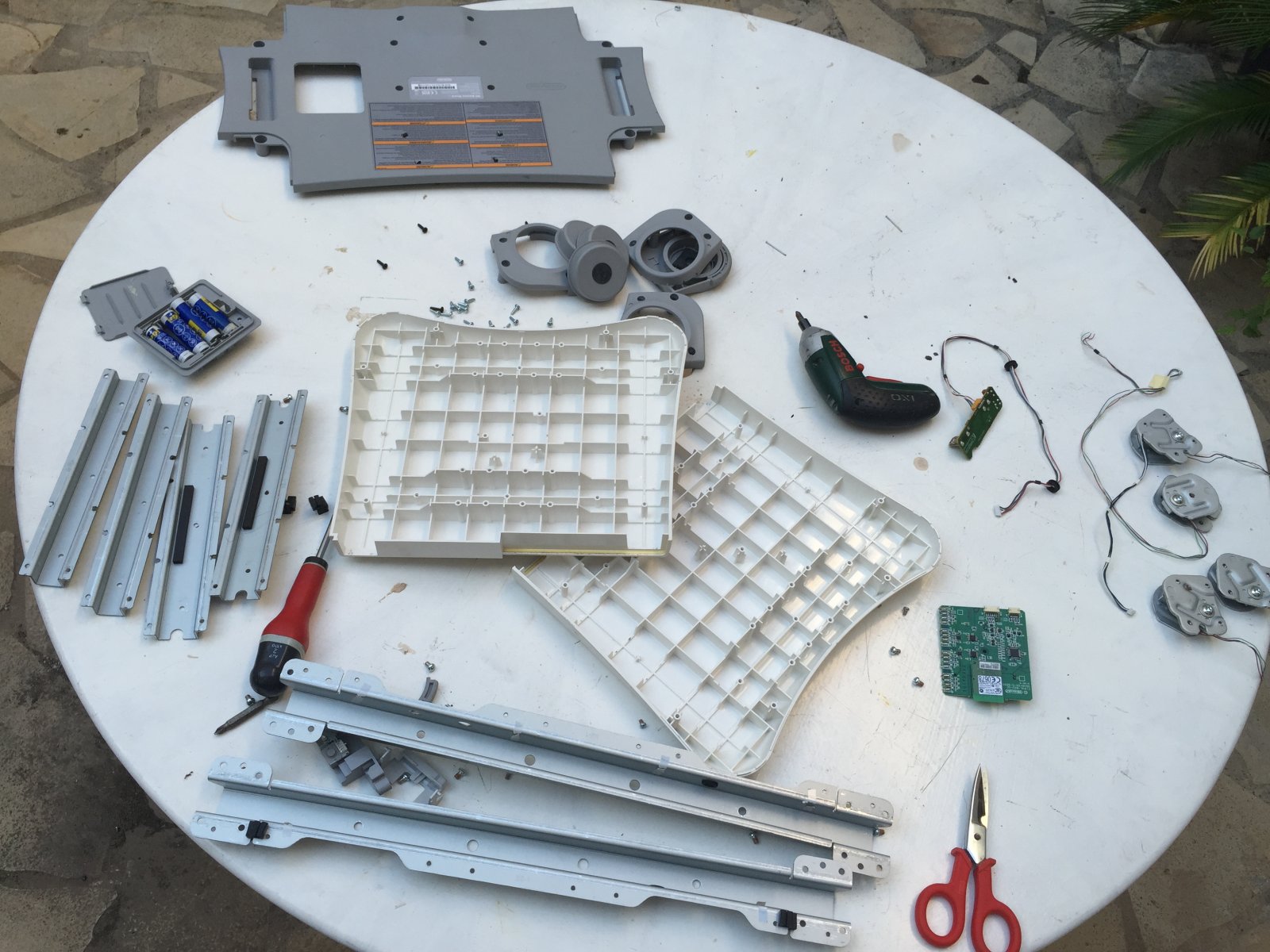

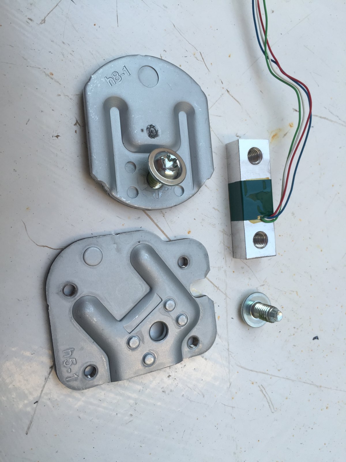

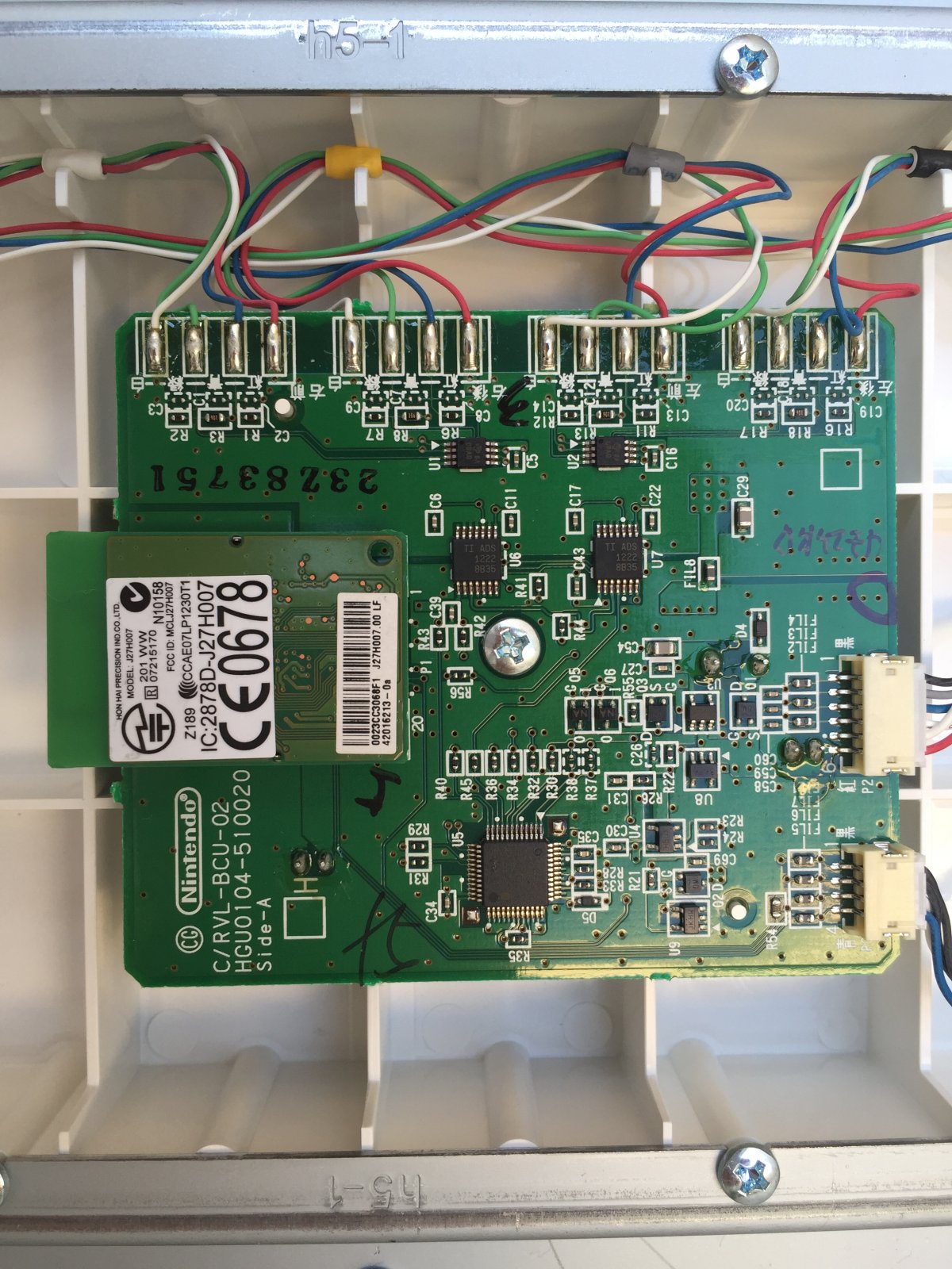

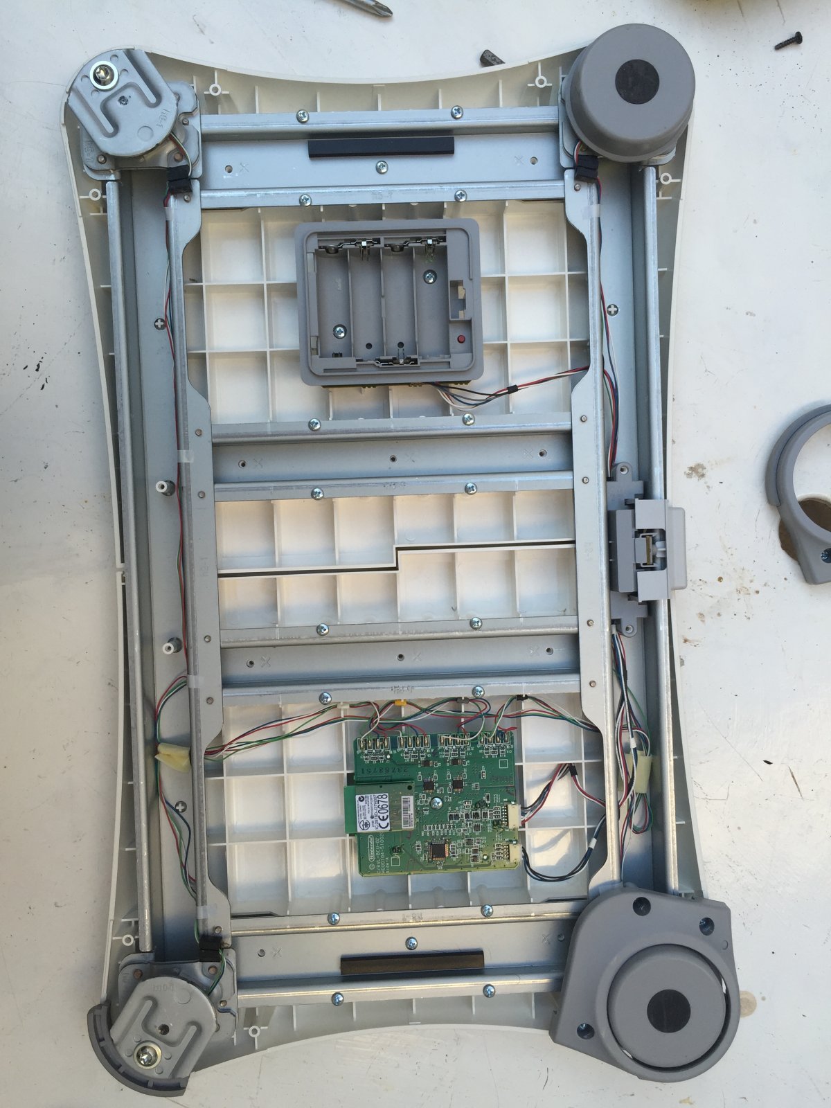

    Hey Guys,
    just wondering if you know if the load cells from a Wii Fit balance board will be good for this mod? Not sure what he specs on it are...

    Thanks for the reply RacingMat, Should I be getting a voltage out of without an amplifier?
    Max.
  5. NVMax
    NVMax New Member
    Dec 19, 2015
    10
    North Vancouver, BC
    423Coins
    I'm thinking, No...
  6. RacingMat
    2,233
    21,085Coins
    No, an amplifier is mandatory to read the small values from the wheatstone bridge...

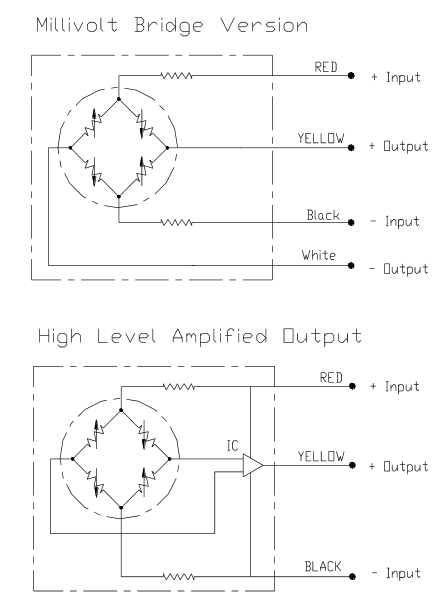

    By any chance do you you know what "E" & "A" stand for which is the input V?
    Thanks for clarifying the need for the amp.
    Cheers,
    Max.

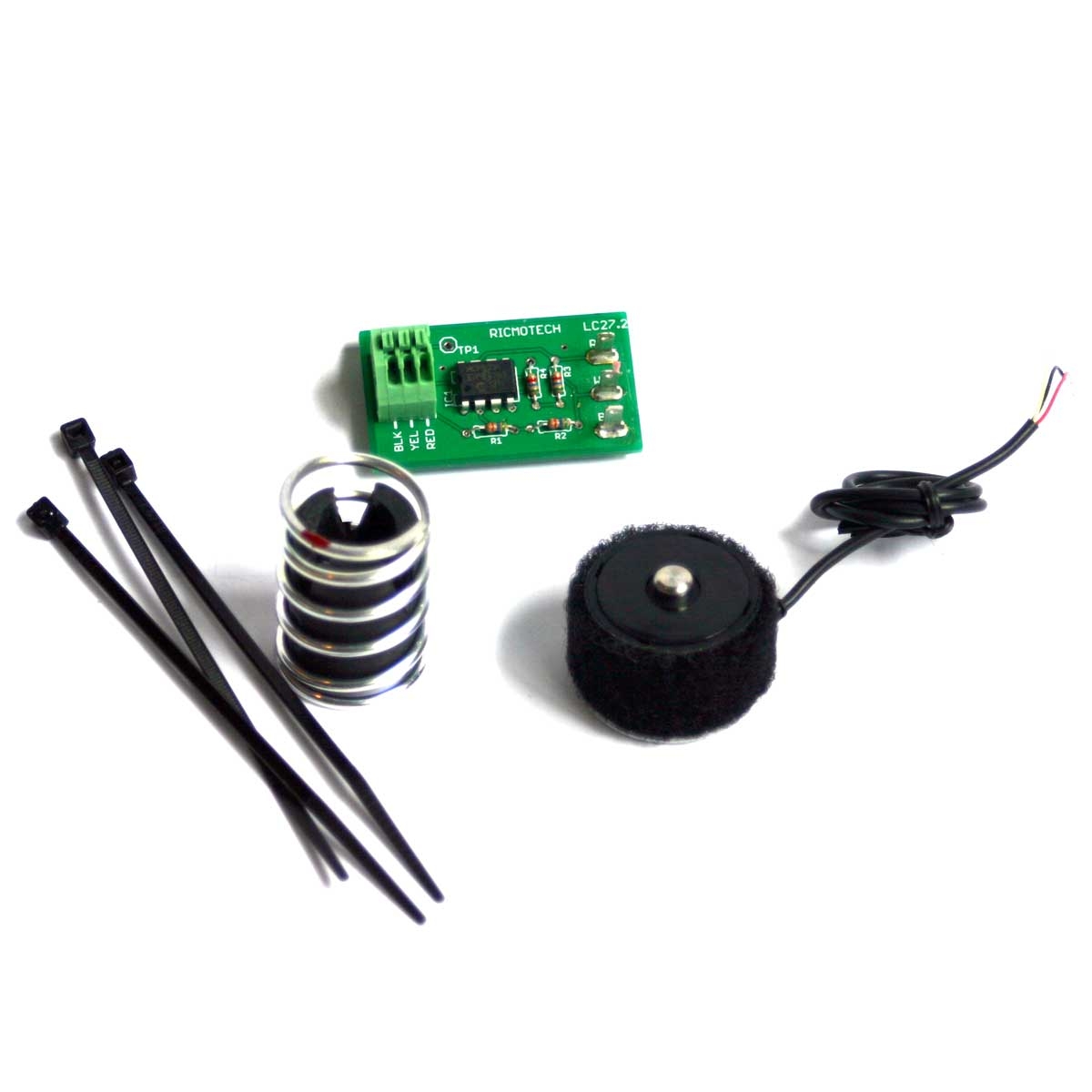

    Hi Guys, I'm new here so first of all, Hello:)

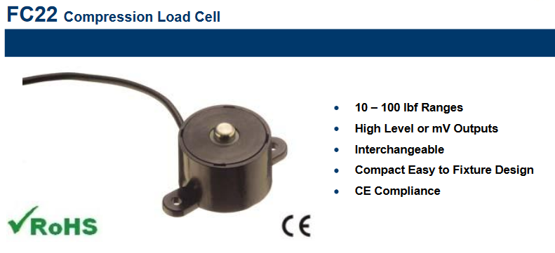

    I have a short question, will this load cell be ok as a replacement of pot in g27 pedals? I can see that you can order it with amplified output (0.5V - 4.5V). Will pedals calibrate with such voltage range?
    Thanks in advance.

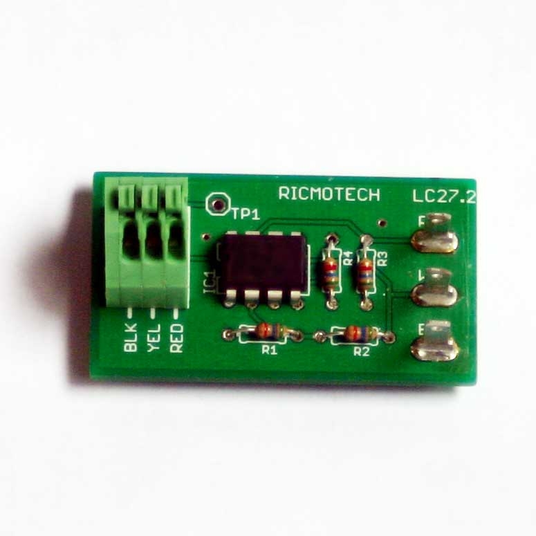

    So the rephrase, In case of Load Cell with amplifier, I do not need to do any wiring/building custom ciruit board, just attach it to wires that were attached to pot, right?
    and regarding consoles?
    ricmotech first revision of load cell was using this device as replacement of pot and you just connected it directly in place of potentiometer (without any amplifier/circuit board) however he stated that it is incompatible with consoles. Why?
    Lately he released v2 which is compatible with ps3 however there is a small circuit board included in this mod (load cell itself looks the same). Can you tell me what is the role of this circuit board?
    Is he using load cell without amplifier now and the circuit board is amplifying the signal (similiar what you have done with diy mod) so it will calibrate properly when plugged in to console?
    Thank you very much.

    Yes, exactly. It's this one (v2).
    I found a youtube clip (I can not paste links yet, so if you are insterested search for "Logitech G27 Load Cell Brake mod by Ricmotech") in which they review v1 and if you will go to 5:35, they have mentioned there that it's incompatible with ps3 because the axis is reversed.
    Anything that could be done about that?
    Thanks.

    you could insert some swiches to invert the polarity...
