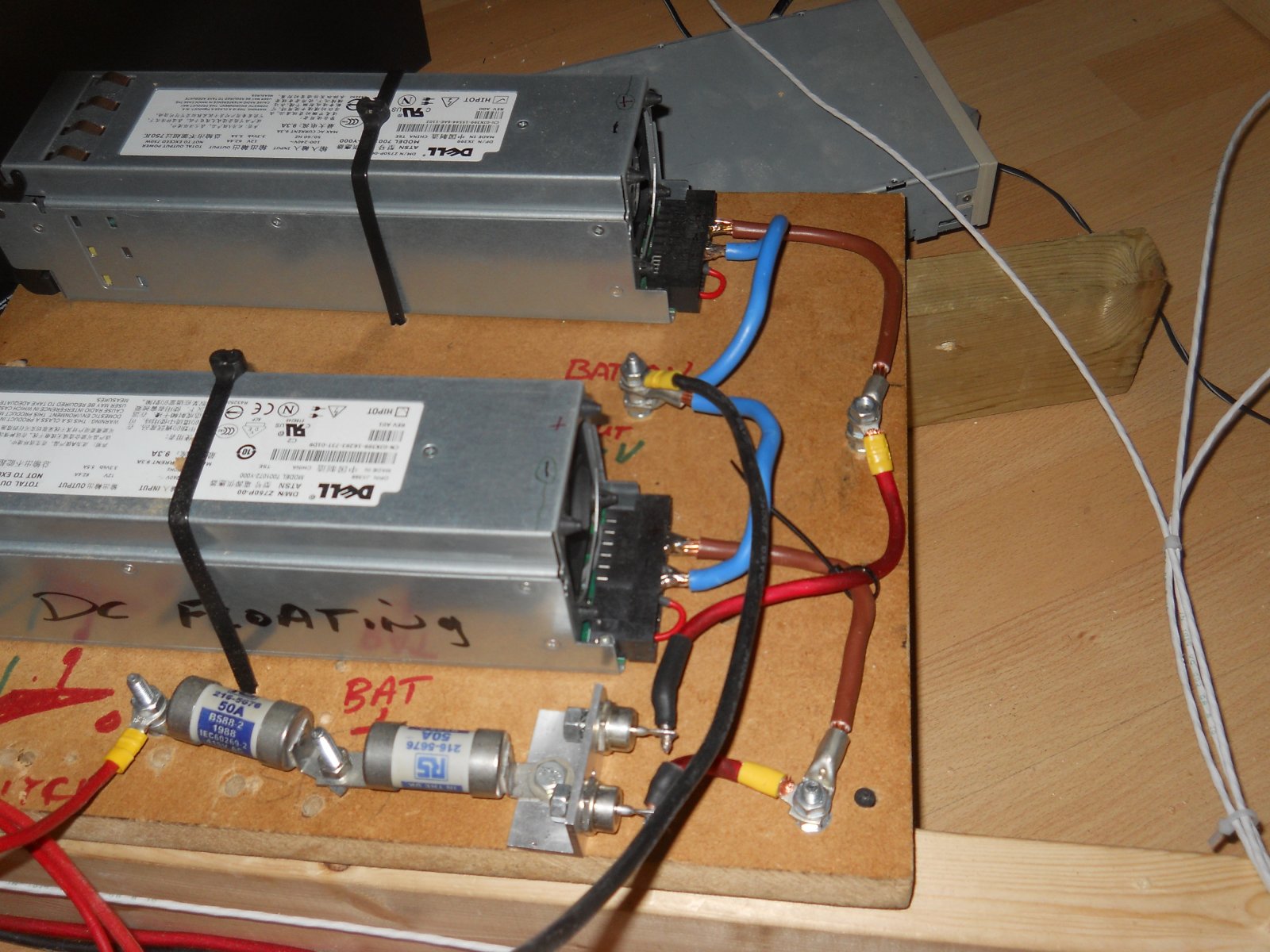

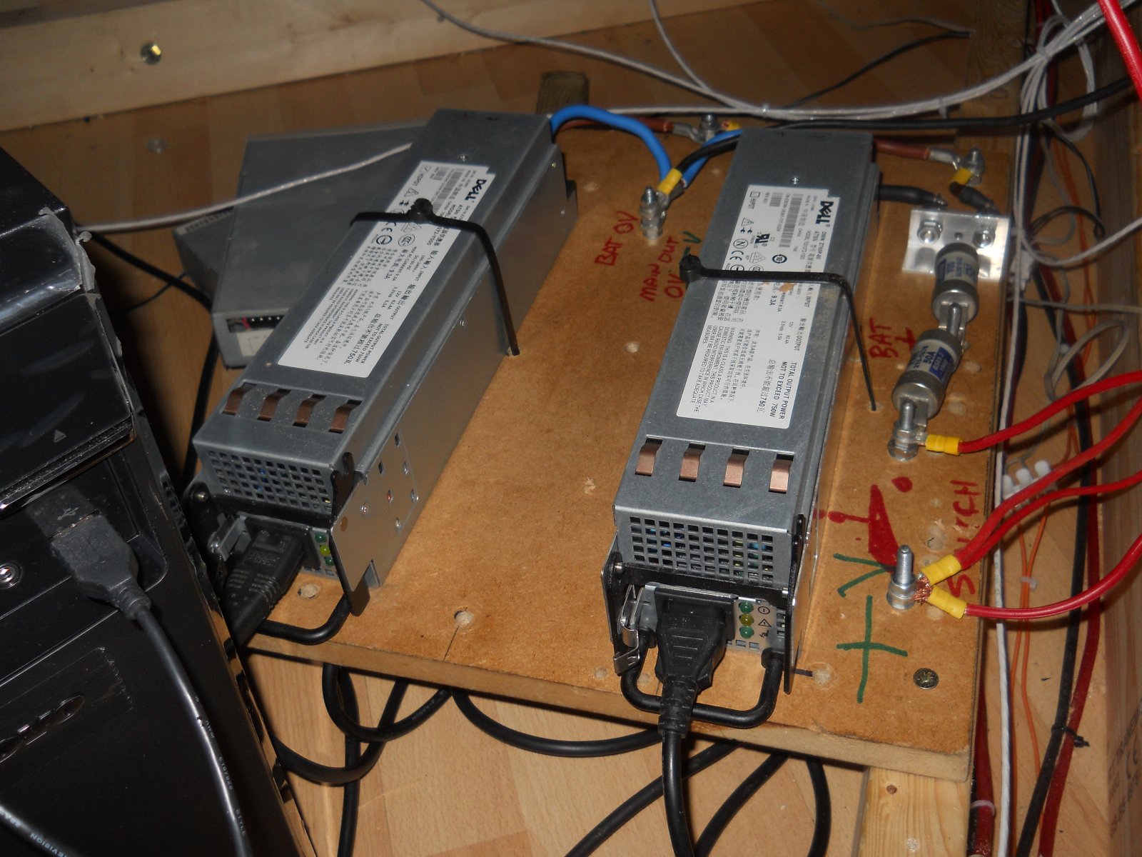

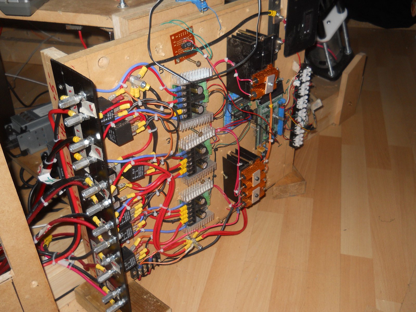

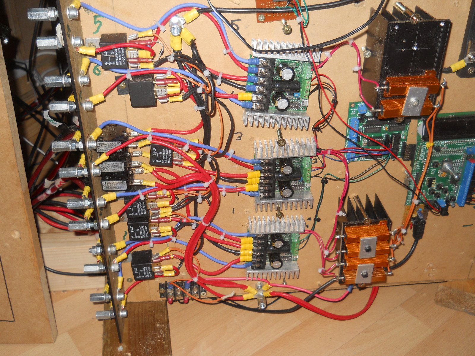

    My Controller setup ....Not pretty ( downright Ugly more like ) but after all the lessons have been learnt I will re do the layout ( relays may come out and simpler wiring scheme is possible .Just need to figure out how to safetly disengage motors when limit switch is tripped .
    CONTROLLER
    Ok system based on AMC128USB Motion controller
    Motor drivers = 3 of 2 X 32 Sabertooh motor driver cards
    Regen Energy Dump Via Gold coloured High Current resistors Mounted on very crude heat sinks
    6 off 45 amp car relays to Cut power to all motors if limit switch activated
    3 off 45 Amp Resetable Fuses in Motor controller Supply lines
    PSU
    Psu = 2 Off PowerEdge Server supples ( 56 amps??? @ 12 V ) need to check nameplate details
    configured parallel to give 12V Out at > 100 amps with 2 x 50 amp fuses in circuit that allows a 12V Car battery to be connected in parallel if required ( not presently used ) and 2 Schotkey Diodes to prevent Regen Energy from rapid reverses getting back to PSU
    OK the above Supply set up has some Lower values fuses But this was done to make sure my FRY Factor was low LOL :)
    Check out the Circuit sketch in an earlier post to see how it should have looked :)

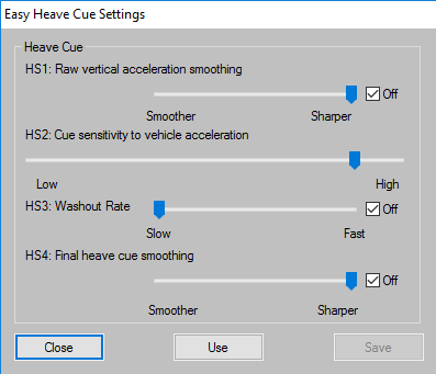

    'Crap Driver Alert' :) OK..recommend selecting Auto Gearbox :p. . IMO, I don't think you have given the rig a good workout yet (heave is still quite soft for a F1 car) , so maybe a reason why you haven't have any issues - although lets see what @SilentChill finds. Note that there is a setting where you set the G meter for a crash and when triggered it will 'Park' the rig.

    Hi @SeatTime is there some setting I need to bump up to get the heave setting to give sharper Bumps and rumble, your on Holiday so it can wait till you get back ...
