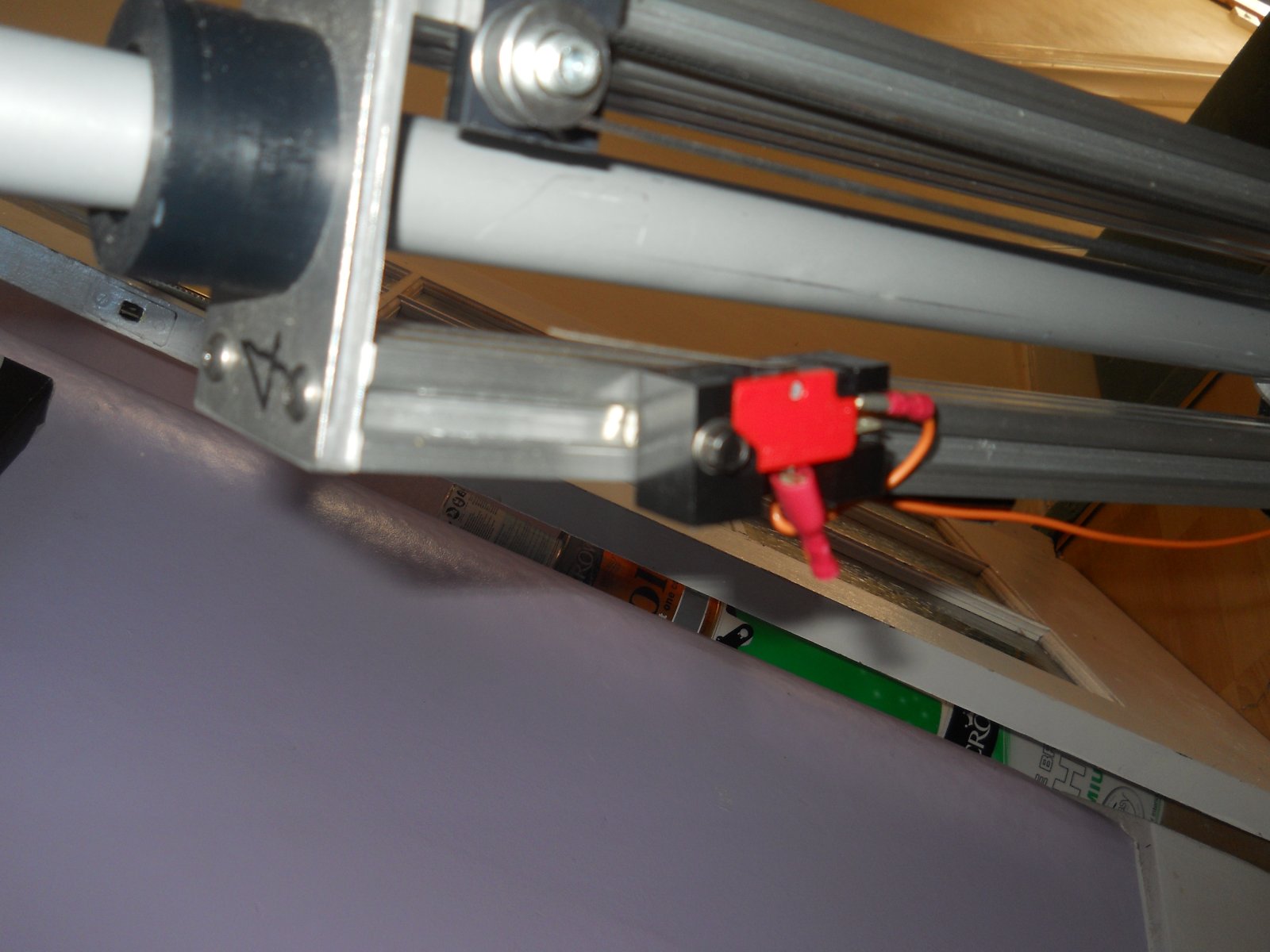

    How far does the ball screw travel after hitting the limit switches ?
    And have you a picture of how you connected the UV to the bottom plate of the actuator and to the base ?

    with regards to the ballscrew overrun after tripping limits switch I would say a good 40mm due to I guess inertia .. this does eat into the total travel a bit but so far i'd rather save the mechanics than gain an inch or tow ( dont tell the missus that I said that LOL ) i'll try to get some pictures posted later , one thing I did do was get limit switches with extended leavers ( 40 mm I believe ) the reason was due to said overrun ...to prevent the system becoming active again once it passed over the limit switch.. I also extended the Contact face of the switch activator with the though that once the switch was tripped then it would be mechanically held open until in my case the Actuator motor was reversed manually past the trip point as it were ..
    the only down side of that is that once tripped I have to find which actuator was affected and manually rotate it back to before the limit switch ( note I press my E-stop butt to ensure the motor is not active, or it would go to the demanded position as soon as the limit switch was reset ( def not good with finger in the area :) )
    Now need figure a way of electrically backing the Motor up to reset limit switch without getting out of sim ... all part of the learning curve and I'm loving it ..

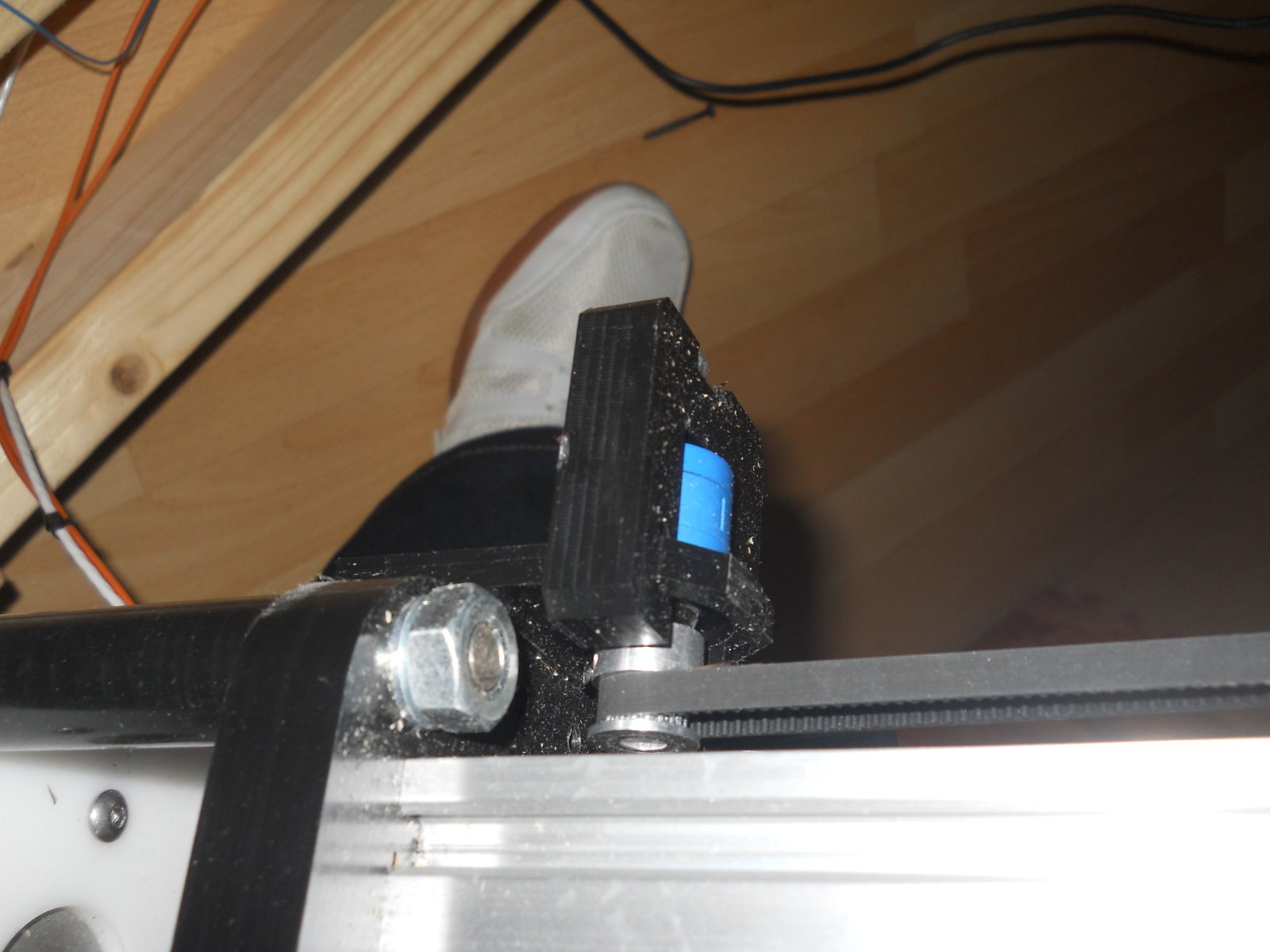

    I was thinking to be risky and just put the limit switch on a bracket that's tight but not too tight so if it does hit it, it moves the bracket a little but because its tight but not too tight it will act like a bit of dampening so it doesn't overrun as far. I will try and see what happens, hopefully there will be no over runs to try it haha
    I'm just on with getting the belt drive in place for the pot and then I should have a 1st prototype to test

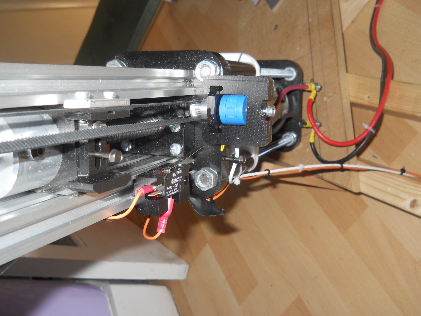

    Hi @SilentChill here is the detail of my current limit switch setup ... at some point soon i'll release the final drawing package for the whole sim including actuators .....its running at 16 pages at the moment lol but think there will be good info in there for the guys to use or modify .. Have a look see good buddy and pick the bones from it I always say there are many ways to skin the proverbial, so feel free to skin away mate

    For Silent chill a little late now But like i said many ways to skin a puddy tat :) love you method so me thinks update will be required by me soon, You may notice the retaining clamp over the pot . i found the chepo pots would begin to seperate if the belt was tensioned too much , so they were a belt and braces fix which did the job nicely ... once again pics for info

    Hi guys mini update my system just had hour of running and took a battering but held up well , just thought I give you the heads up for lessons learnt,
    Actuators seem more than man enough to chuck me around nicely
    double check the coupler screws to make sure they are well secured against motor and actuator shafts .
    Check for Belt alignment ref POT gearing
    Be aware that too much belt tension can damage the pot .
    Under extreme .
    Limit switches should be mounted so that even if the actuator overruns it will remain triggered .
    KEEP FINGERS AWAY from pinch points when actuators are powered ( they move bloody quickly )
    Limit actuator travel during initial testing to minimise mechanical clash in the event of and issue..
