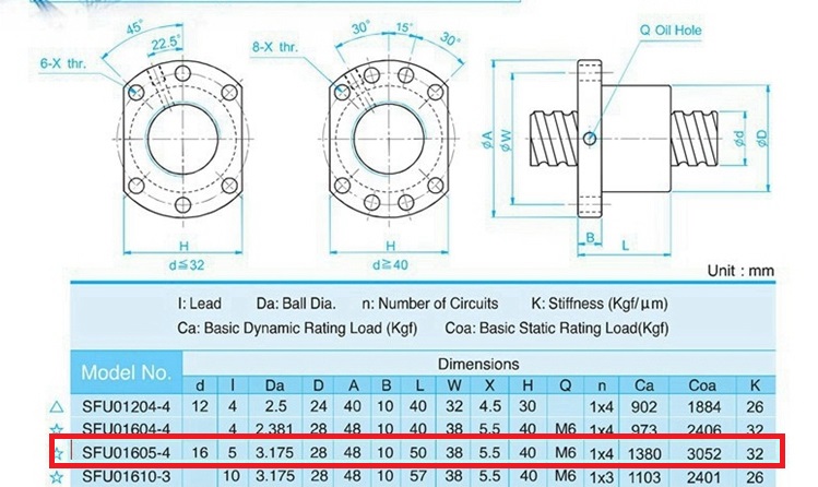

    i like to ask if i am ordering carbon tubes with 25mm OD x 20mm ID is ok to use instead of 23mm ID?
    im trying to understand everyones DIY builds, so i think it is ok since the screw diameter is 18mm?

  9. wannabeaflyer2
    Jun 12, 2015
    724
    london uk
    8,359Coins
    +958 / 7 / -0
    Hi @hannibal not by the sim but pretty sure the 1605 balls rew diameter is 16mm so the tube should be OK. Remember to allow for what I call the rotating anti wobble insert at the top end of the ballscrew .. that's still doable with the tube you selected (it just reduces ball screw whip at the inside the tube whe actuator is going full speed)

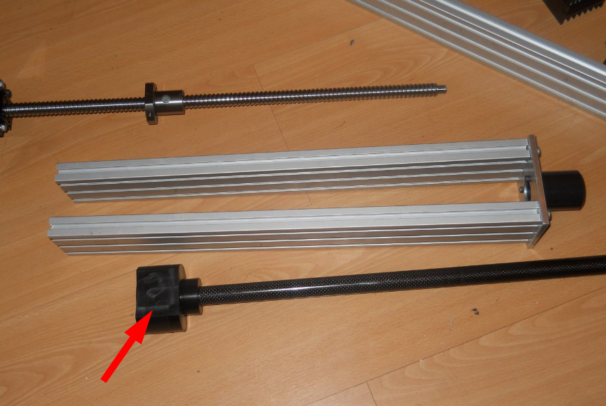

    Hi everyone, I need to know: the piece indicated by the arrow (see attached figure), which runs between the two aluminum profiles, where it can be found?

  16. SilentChill
    2,645
    20,604Coins
    +3,570 / 34 / -0
    I think that's a custom made 3d printed part ?
  17. motiondynamics
    motiondynamics Member Gold Contributor
    Apr 12, 2019
    211
    1,235Coins
    +9 / 0 / -0
    2DOF, 3DOF, DC motor, AC motor, SimAxe, Arduino, Motion platform, 6DOF
    Maybe yes.
    Or an accessory to insert into the ball screw nut?
  18. wannabeaflyer2
    Jun 12, 2015
    724
    london uk
    8,359Coins
    +958 / 7 / -0
    hi @motiondynamics there are so many variations of that part you may well find its not off shelf item , I'd agree with @SilentChill and say its either machined as solid from High density nylon/plastic type material or more often 3D printed with high infill setting for strength :
