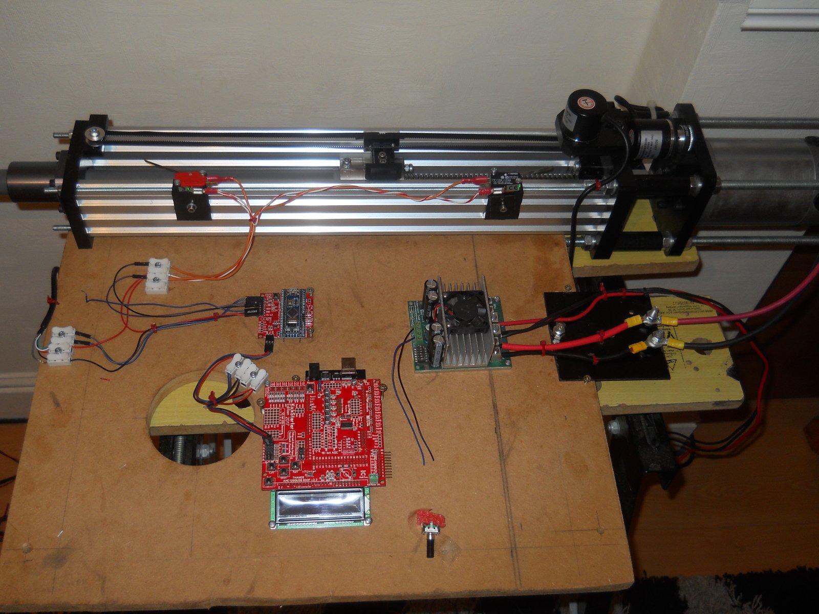

    hi guys he's back with the 1st rough setup and initial connection/operational tests done .
    to be honest it would have been straight forward had dofuss here read a bit more and followed his own wiring diagram LOL .
    anyways I made a few fundamental mistakes which sortta had me pulling hair out and have to add they were self inflicted issue , and nothing to do the with the product , ok long story short I had the limit switches connected wrongly NC instead of NO so that in itself led me down the wrong path as I was sure it was correct ..
    Thanos was extremely helpful and patient with my hamfisted connecting of his Encoder2Pos PCB but to his credit he stuck with my numerous e-mails and even provided debugging tools which allowed me to identify my mistake ..
    OK so the setup as shown in the video is not pretty , but it was enough for me to get used to the operation and what connection will be when and if this option is incorporated within my 6 DOF motion Platform
    as mentioned I will add my notes and lesson learnt here so that anyone that decides to go with this option can have an easier path and not make the dammm fool mistakes I made :)

    Ok, I admit this put a smile on my face, but for the wrong reasons.
    You see because of the unique unidirectional way the sabertooth handles it command input with 0-5v signal, the way you connected it kinda works.
    But the amc1280usb is no-where in that loop, to actually provide target position or PID control of the position.
    See you need to connect the 0-5v output of the Encoder2position module to the 0-5v analog input of the Amc1280usb. Then connect the analog output 0-5v of 6DOF ext board to the analog input of Sabertooth. And the encoder on the motor is connected to the Encoder2position module thus all together form a complete loop.
    Until you that, the motor will only calibrate and stay in middle position.

    Here are the settings you need on the AMC1280USB:
    In USO DATA FORMAT select "Motion Data Only"
    In Set Sensor Type select "Analog 10-bit" (degrees dont matter here).
    in Set Output Type select "Analog 8-bit" and "2. SNS Uni-DIR" option"

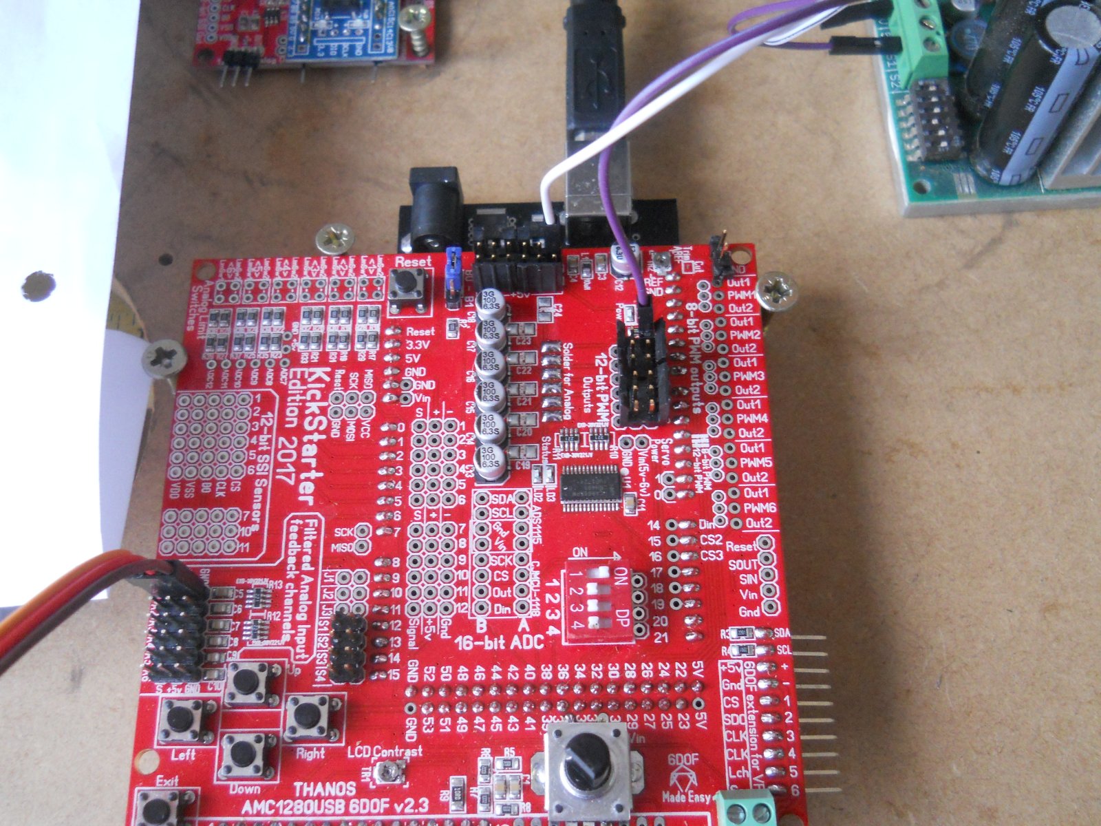

    Hi @Thanos just to say Thanks for checking this out for me , this video is just what I needed , one thing ,,,
    I noticed what looked like Links ( Jumper) fitted to the PCB header just to the right of the analogue input pins , Is this required ?
    My barebones does not have this Header fitted to those pads "S1 to S4" . Should I add one and fit the jumper across "S4" ?
    is this why I have not been able to get a voltage change at the analogue output pin as shown in your video ...
    Of to work Now but Hope to check this out later today . Cheers @Thanos

    The double row pin headers on S1-S4 are for jumpers to enable certain functions.
    S1= enables output for Maestro mini servo
    S2= ... dont remember lol
    S3= logic output for enabling clearpath servomotors
    S4= keeps the LCD menu enabled while in ONLINE mode.
    They are not really needed for your case except if you want to place a jumper on S4 to debug while connected to Simtools.

    Hi @Thanos massive thanks for the closed captions on the Tutorial video for the sabertooth and Encoder2Pos for me that was brilliant as it cleared up some misconceptions on my part. so Big shout and thanks for those new Videos ..
    I have to hold my hands up and say I must have zapped something cos my analogue Output pins are sitting at 1,794V in some instance and then other times its 3.0594Vdc ...New firmware successfully updated and as per video with nothing connected other than the USB supply im not seeing any change when I press the 4 Cursor keys in sequence ..
    Im thinking that those pins should sit at half of the 5v supply ref SNS unit -dir Control method ( and that way any controller connected wont runaway when the system is powered up) also means when the cursor keys are activated left /right or Up/Down the signal should go 2.5V to 0V or 2.5V to 5V . (ref inbuilt AMC test commands)
    I have not had any blue smoke or any other signs that damage was done , other than I noticed that when I disconnect the USB cable any Voltmeter connected to analogue out pin and ground reads 1v or thereabout ( as though the board is holding a charge somewhere) will stick a video on youtube if it helps
    Is there another test I can try for determine what I have blown up .

    Added link to Video of my possibly self inflicted Issue, getting My barebone AMC128USB interface fully operational at testing stage
    DVM Connected to Analogue Output Pin and Ov
    all Menu settings as shown in tutorial Video
    I,e Sensor type Analogue 10 Bit .
    Output Type = PWM 12 Bit , Sns Uni-Dir etc
    video shows 10K pot connected but even with Pot disconnected and manually triggering each cursor , the voltage change at the Analogue output pins does not do what I expect it to ...
    Any ideas Guys , Off to Work so will check back later ..

    Can you take a clear photo of the board, i can't see the connections you did on the video because of the LED glare!!

    Hi @Thanos rry about the duff video , Ok the Positive lead form the dvm was connected to the Each analogue out pin 3ed row of the 12 bit PWM header and the zero o volt was the Gnd Pin next to the 5 V pin top RHS of PCB above the 8 Bit PWM headers on the PCB or in this picture I used the ov header as per your Video either way I thought all 0V points were common :)

    Sorry for the delay,
    Can you try the test mode of the outputs to see if there is proper output voltages?
    Just set the DIP switches as:
    Dip #1 OFF
    Dip #2 OFF
    Dip #3 OFF
    Dip #4 ON
    The analog outputs should be ramping Up and Down from 0v to 5v and the digital out pins should toggle states 0v ot 5v

    Hi @Thanos , I went through that test and that's what's weird :-( when I monitor the anologue output pins and the digital PWM pins i'm getting the switching correct (on /off ) and ramping up from 0V to 4V ??, but noted the voltage at analogue seems to be 0v to 4 volts ( never get to hard 5V but that may be the analogue meter needle damping) ..
    I take it that after this test , I should just be able to switch back to Dip switch 1 on all others off, and press reset.
    That being the case and without any other device connected , when I press any of the jog keys I would expect the signal at the analogue out to be steady 2.5Vdc (No jog button pressed ) and once a button pressed it should move towards 0V or 5V ( depending on which direction selected ?
    quick clip of test setup
    Unless im missing something ( VERY likely lol ) Im sure there is another issue that's stopping the anologue feedback demand signal getting to the analogue out stage of the PCB ..
    Does the test routine bypass this route ?
    Really appreciate the patience and the assist with this ,so I can move this test forward and start getting some progress info to post here and possibly help others :) will stack a video on youtube for you to see the test setup and verify my findings .
