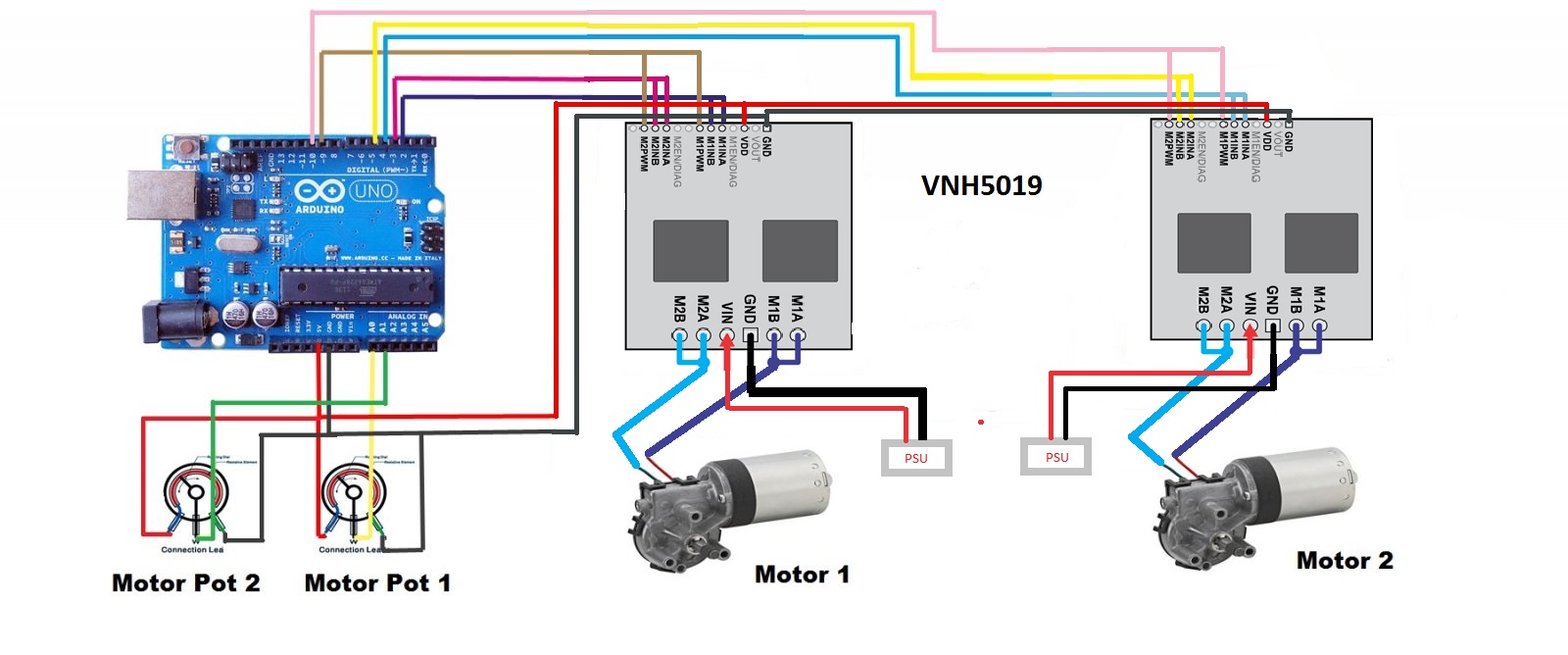

    hi guys, this is the scheme I use for the project of the actuators, where should I put the microswitches?
    on the engines you told me not to put them I would have too high power returns, where do you recommend me?

    You are missing a part between the vnh5019 and the motor (it could also be between the PSU and the vnh5019 also). Its a high current relay. It will cut the power to the motors if one of your limit switch is triggered. I plan to do a closed circuit with all my limit switch. If one of them is triggered, every high power relay will be turn off and all of my 6 motors will shut down. I will have to find the cause, reset positions, and start again. Also, a panic button will be part of the limit switches closed circuit.

    The sabertooth 2x32 seems a better value than the pololu vnh5019 at $50.00 each. Are you getting the vnh5019 for less somewhere?

    no I have not found the VNH5019 unless, but I'm very comfortable with this card and even if it costs more I continue to use it.
    as soon as I have time I will also try the sabertooth.

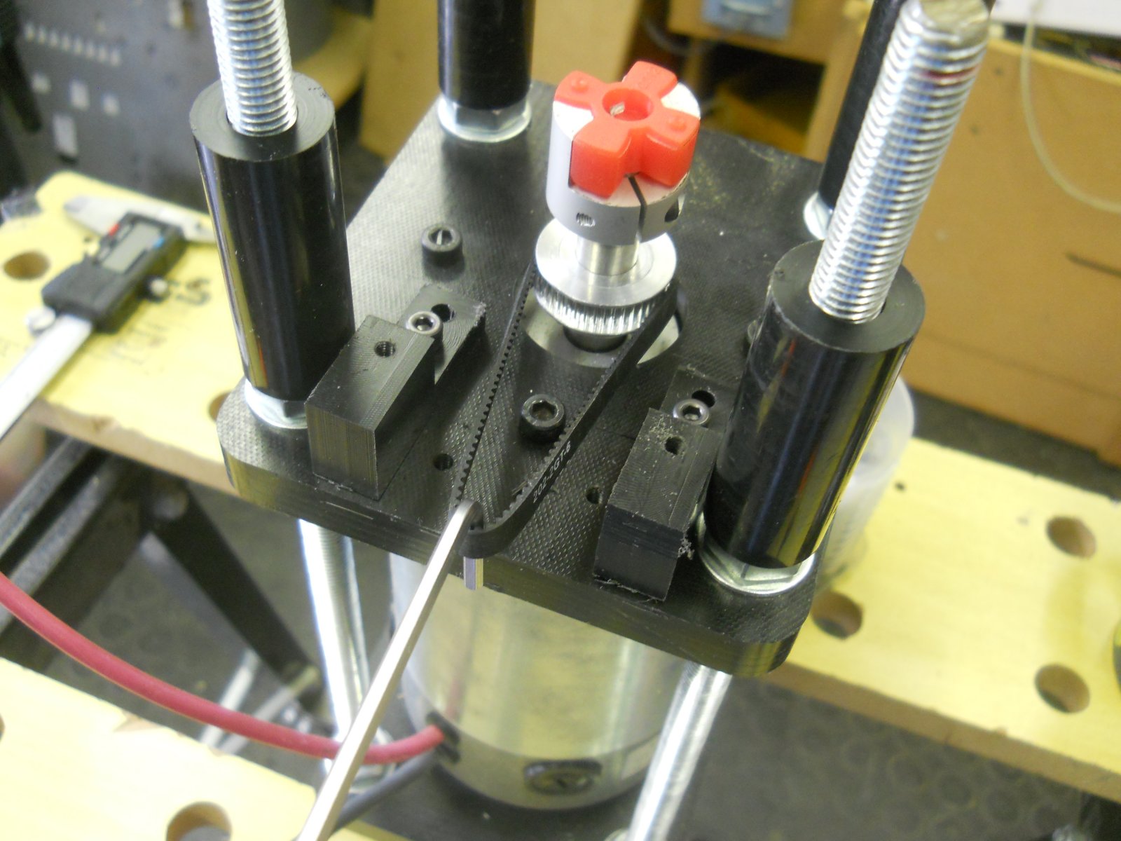

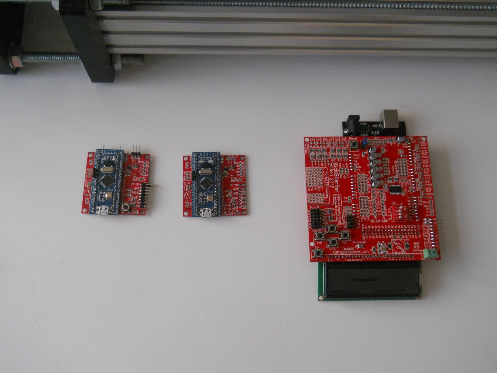

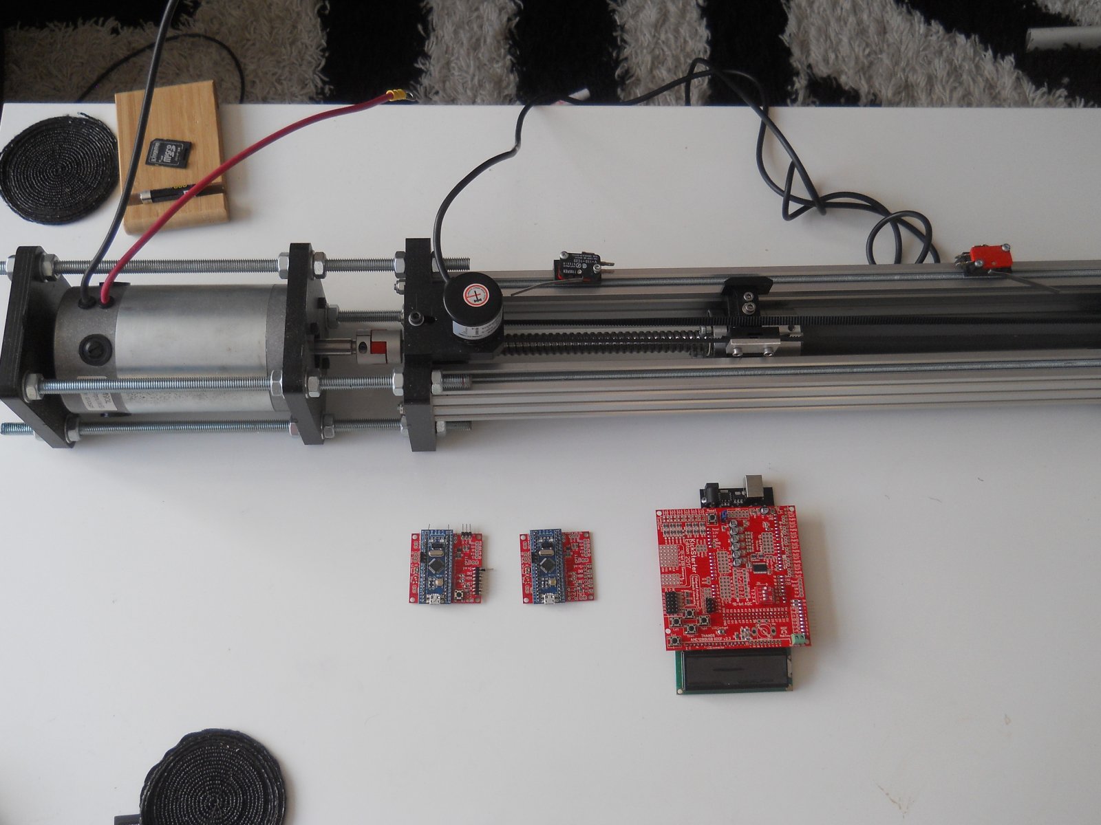

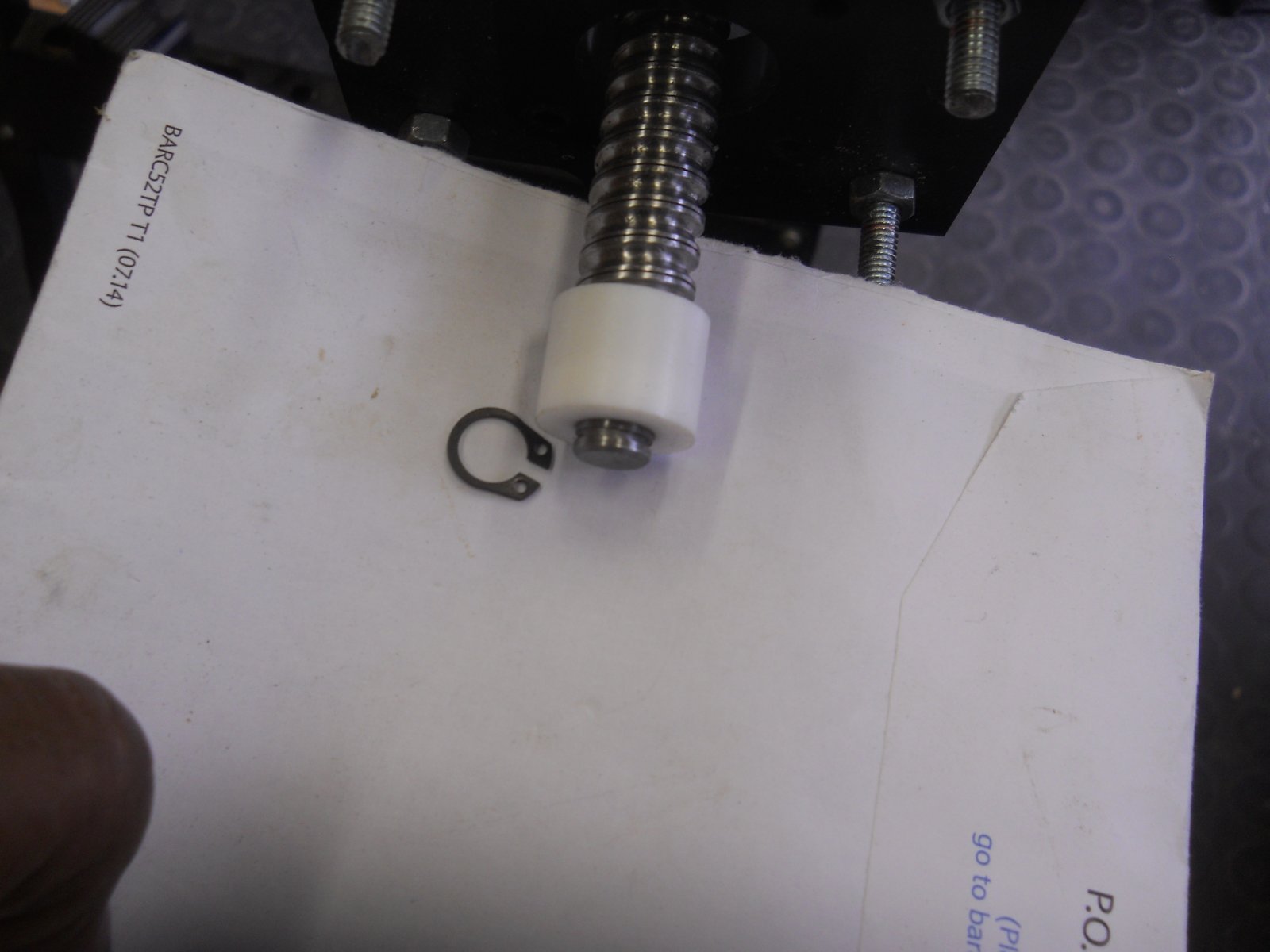

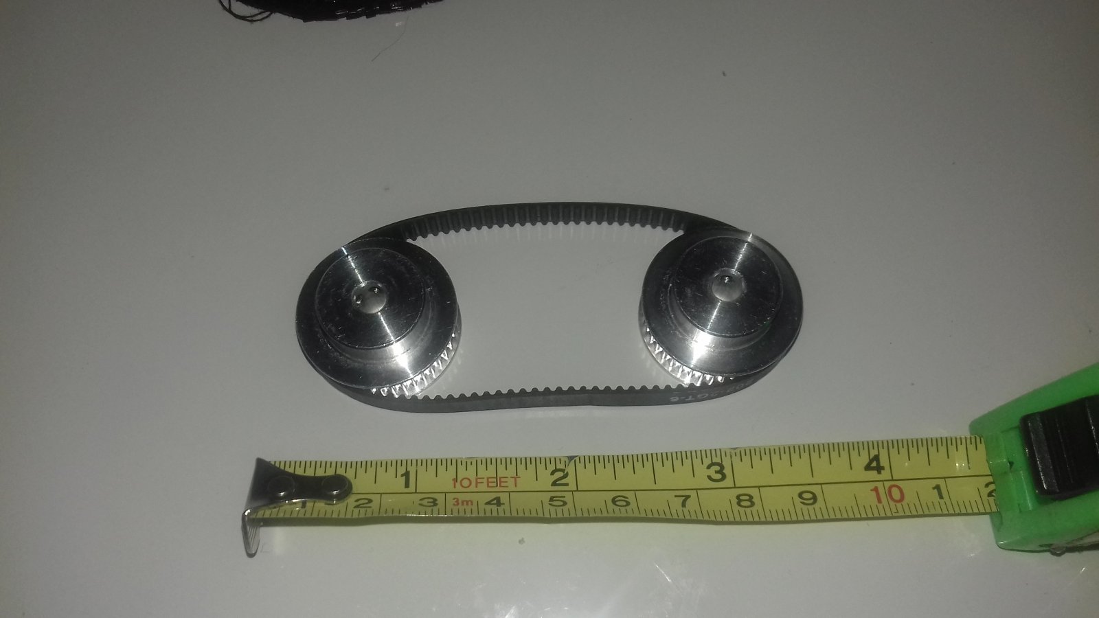

    Hi Guys He's 'back as mentioned somewhere in my posts I have had this bee in my bonnet about swapping Pots for optical encoders for feedback on my actuators . well the new journey begins I have now bought Thanos's Encoder2Pos Interface PCB with the intention of doing some trials before commiting to changing out my current ( yes its Still in one piece Pride of joy 6DOF sim ) in my sim room .
    I may well start another Post for this part of the project but here is the target Outline ..
    I'll be using 600cpr Optical encoder ( already had those)
    Each actuator will need 1 Encoder2pos Interface PCB ( Simplist term it Converts Digital Pulses form encoder to Analog Output Suitable for Sabertooths and Barebones Kickstarte AMC Controller
    one Barebones AMC128USB Controller Card
    My spare Linear Actuator fitted with Limit switches and Suitable Gt2 Gear Pulley Ration 1:1 to Drive the Encoder via Looped GT2 Belt ( No Place to Mount Encoder directly to the shaft in this setup :-(
    Initial Trials will use BFF software But followed quickly by Simtools and SMC to cover my Options
    Not been active here for a while so its gonna be painful trying to pick up all the new info you guys have posted as things have moved on at a great pace .. but that's the plan ..
    I have attached some tatser picys but will add nes cad drawings and wiring diagrams as I go along
    1. Just waiting for the gears and belts to turn up then I can make the mounting plate and start connecting wiring
    All togather NOW shout out all Hail Blue SMOKE LOL fat finger freddy is on the case...as they say on THUNDERBIRD or was that STINGRAY " Stand by for action,, (drumbeat here ) anything can happen in the next half hour :) (its an UK thing LOL

    Don't forget to update to the last firmware. It has some additional goodies for the encoder2position modules...
    https://www.dropbox.com/s/v9y8cjo5zhlhurx/enc_6dof_AMC1280USB_v2.4_rev7_debug.hex?dl=0
    The actuators should move up (limit H) and then down (limit L) to complete the calibration. If not, change the motor direction from the lcd menu (6dof direction).
    Thanos

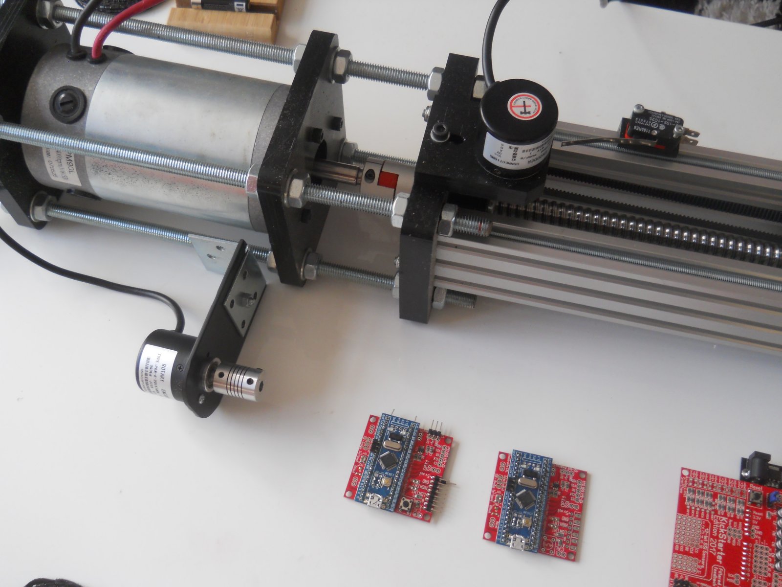

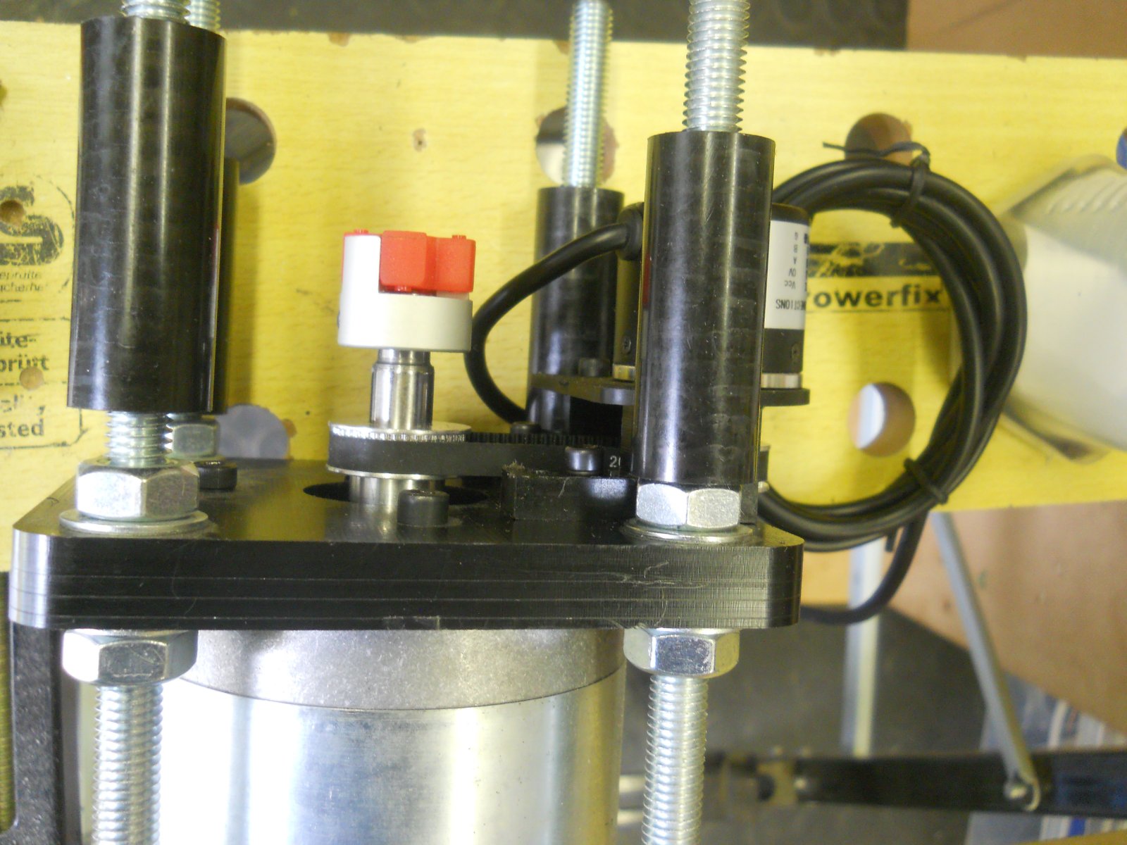

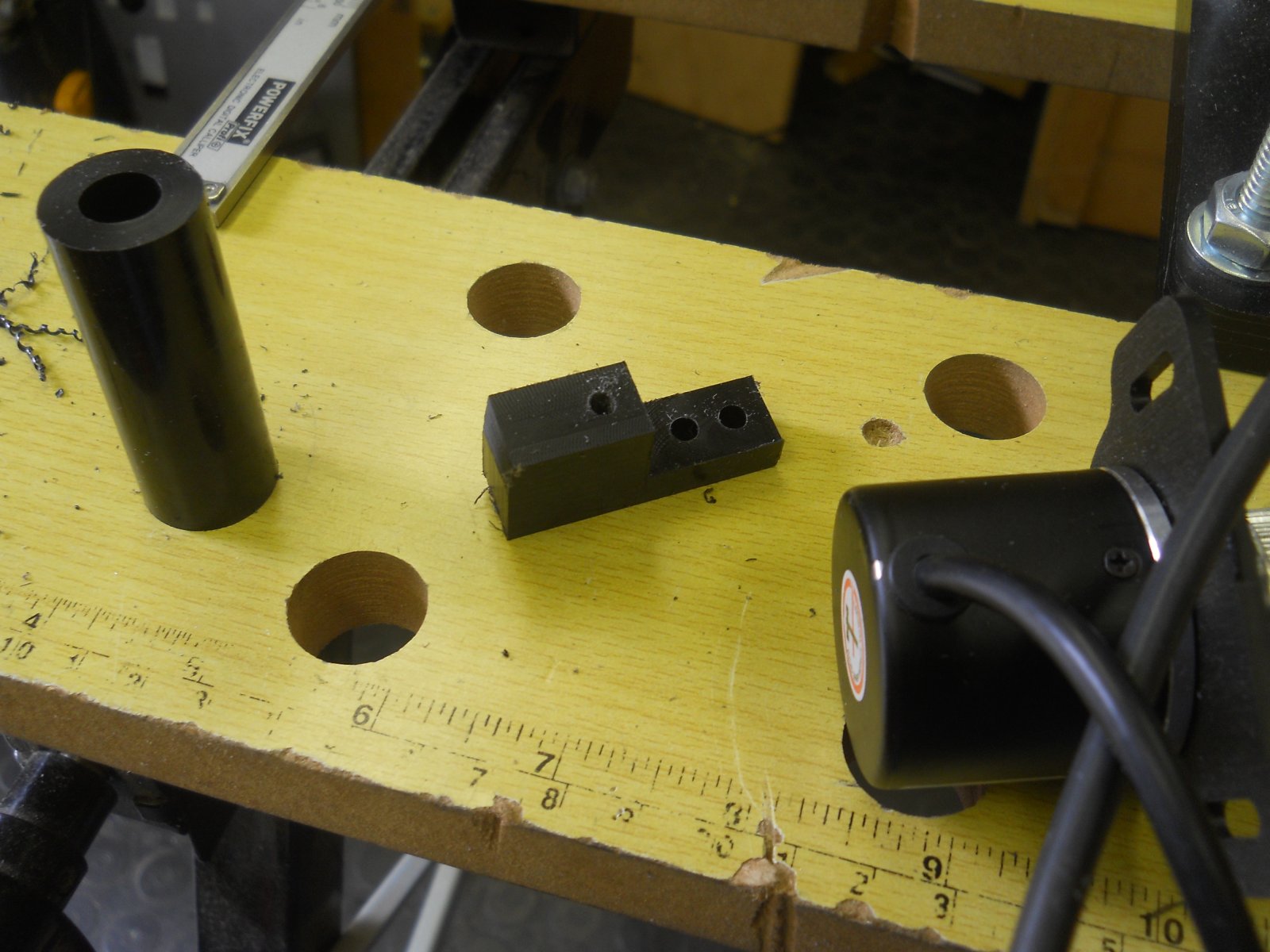

    Hi Guys more bits trickling in via ebay so fingers crossed weekend should see some headway test setup wise at least , just some more Pic's showing todays tweaks to the cad Model ..
    the 2 x 40Tooth GT2 Gears will be bored out 12mm for motor and 6 mm for Encoder , that'll be tomorrows lunch time mission :)
    will try to document as much of the setup and lesson learnt so hopefully others can see how this thing will pan out.
    attached CAD pdf for visualisation but I have 2 schemes for encoder connection ..
    Option A would be straight swap out for pot and use the existing belt arrangement
    Option B would be the Gear on motor and Encoder with 1:1 ratio
    will need to breadboard the ULN2803 chip initially but further down the road both the encoder and that chip will be mounted somewhere on the actuator to sort of make it self contained ( I stress Sortta) ..
    it appear I need to flash a firmware update so that will be my 1st item in the new posting ... have to ask general uestion ,,would you guys prefer a separate post as this is now Control system area as opposed to tacking it onto this post which was initially just to cover the mechanical assembly of an actuator ??

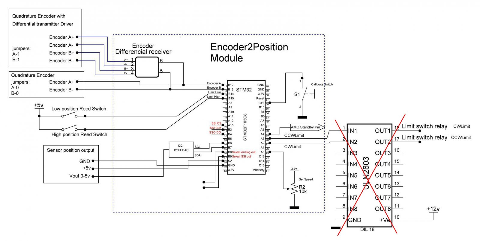

    Hey, you don't need to use the ULN2803 mentioned on the schematic, this is used to relay the limit switch signal to the Servo drives for their internal function and disable the motor from moving to that direction.
    The limit switches are used primarily to detect the travel length of the actuator and remap the encoder pulses correctly to the length of stroke.

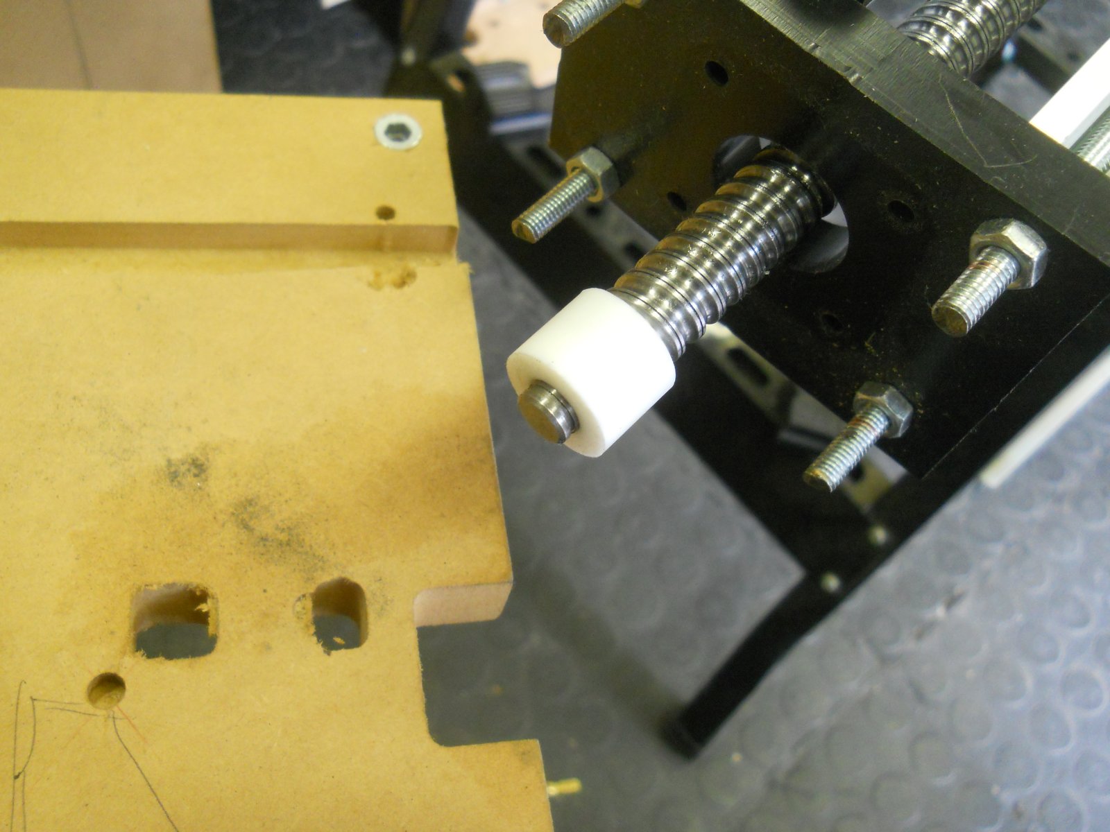

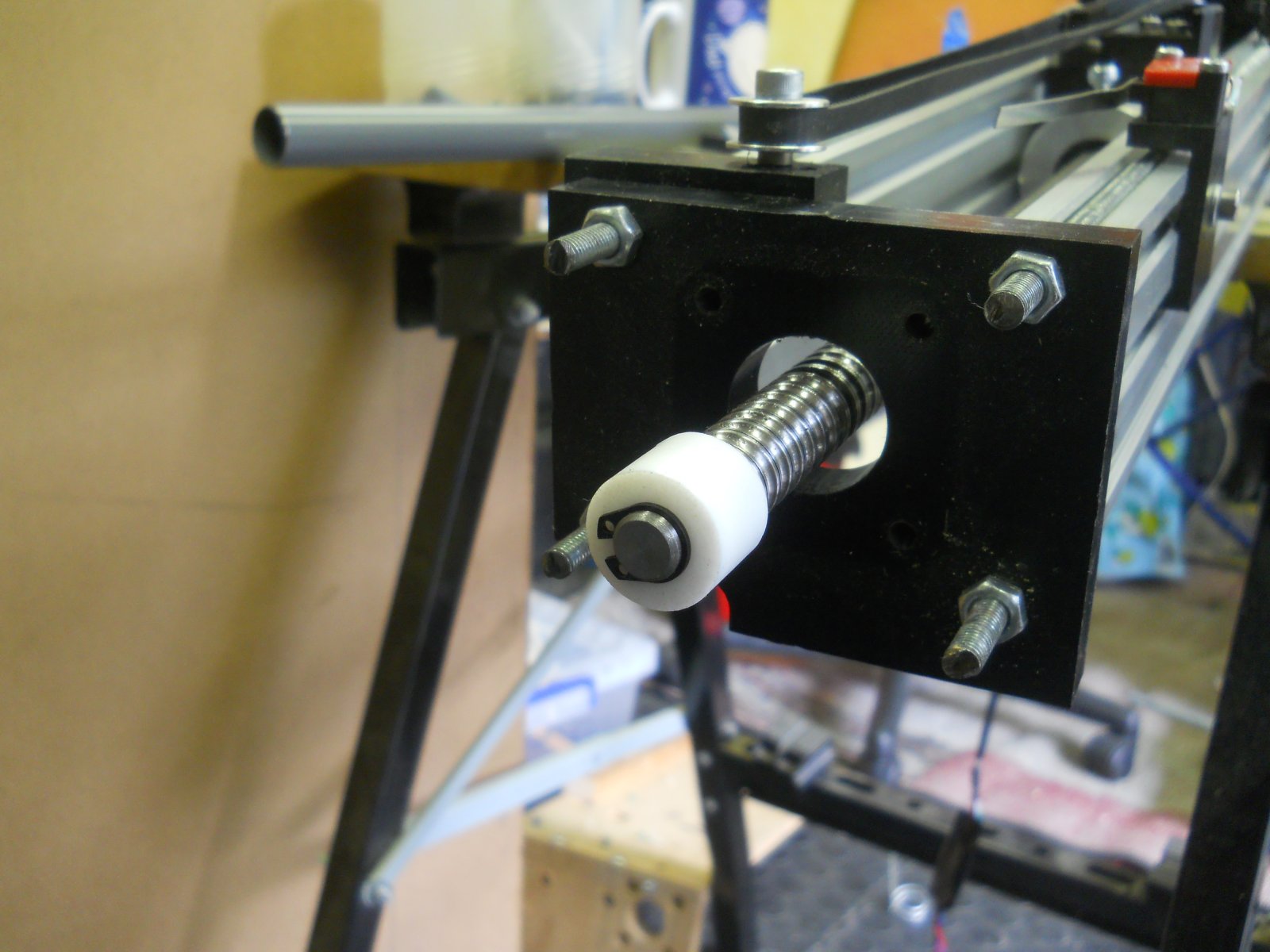

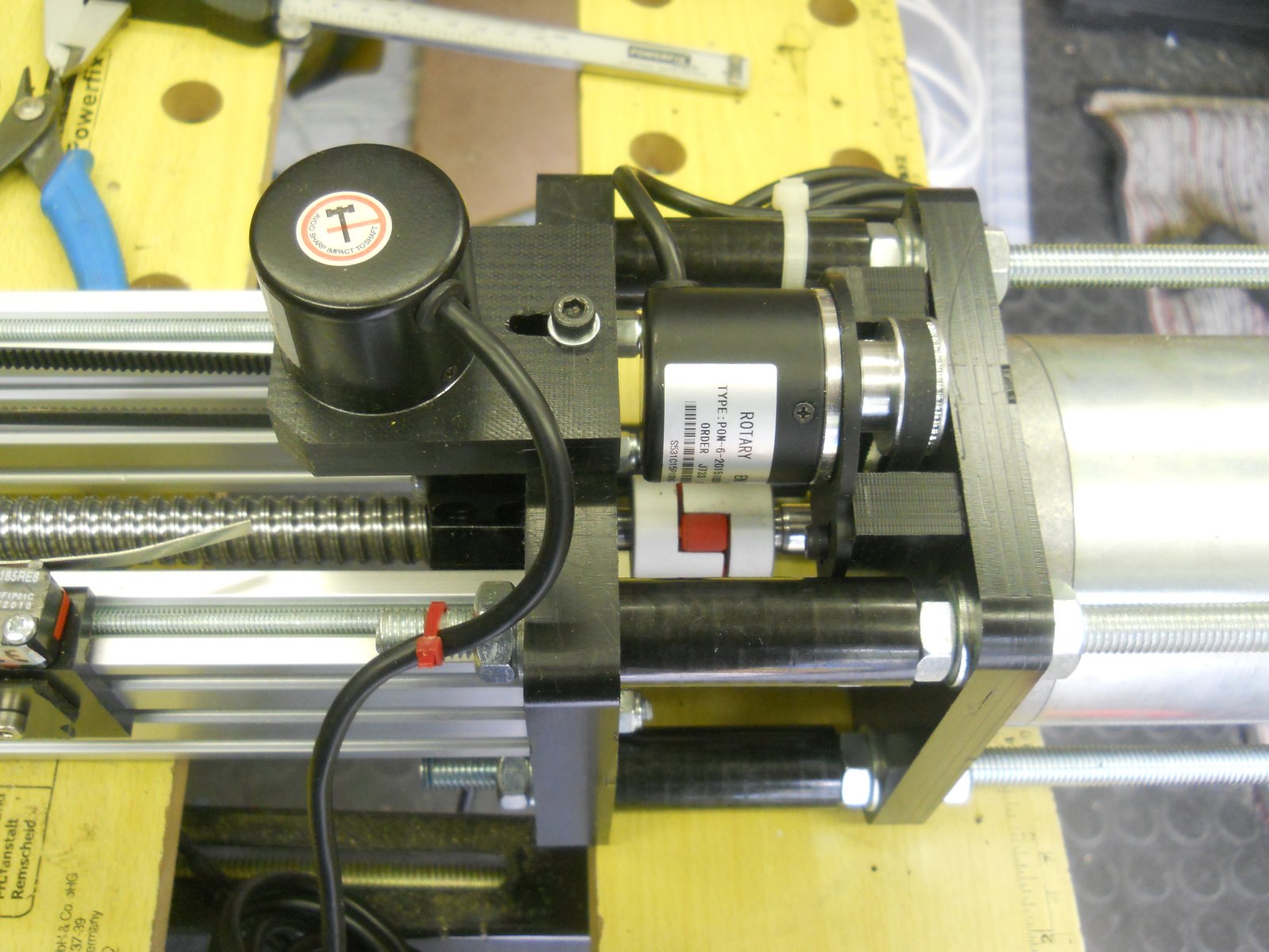

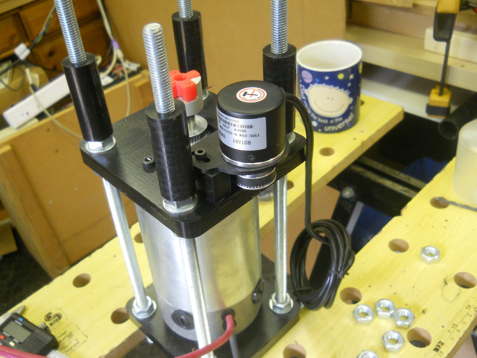

    ok mini update , the easy part the mechanical assembly is done and I have configured the actuator to have both Encoder Position option already fitted , that way I can evaluate each option and settle on the final position depending on how the tests go .. some picys again just for reference
