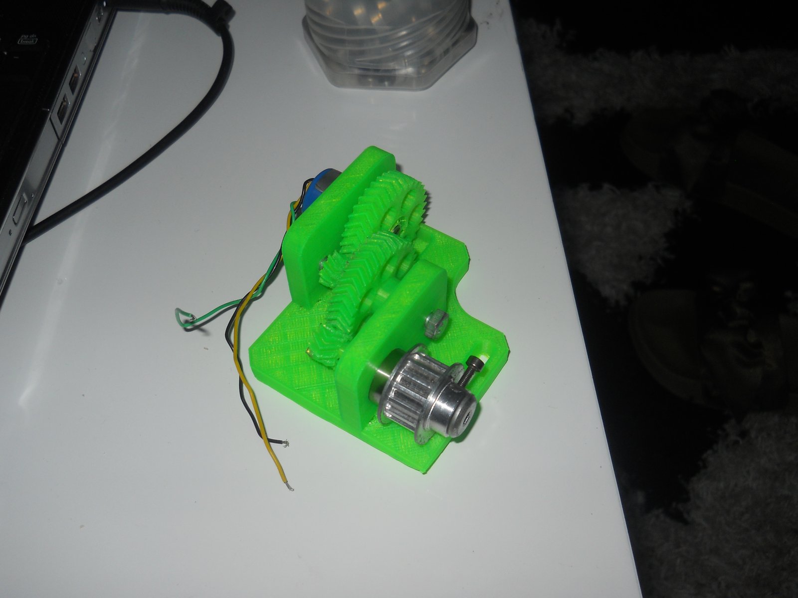

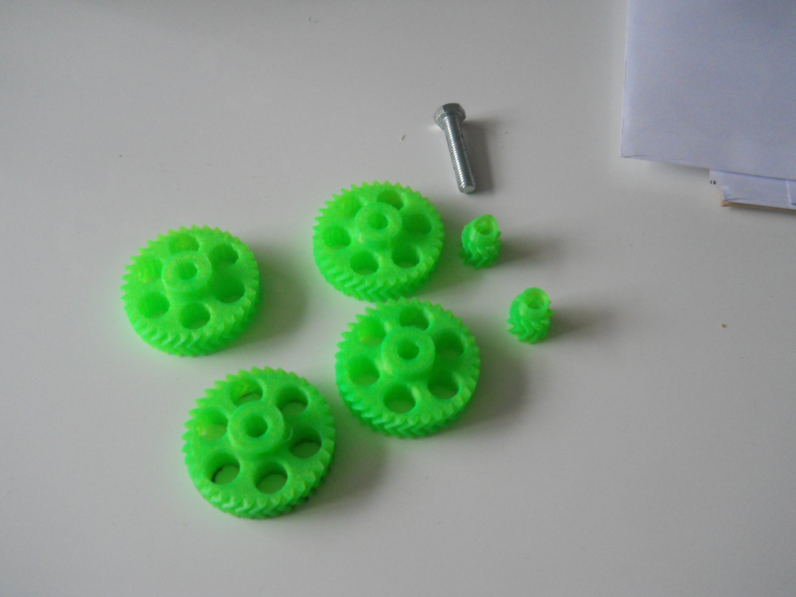

    Hi Guys small steps but thanks to @SilentChill I have been able to make the gear I need for the Hall sensor as future replacement for my actuator that currently uses 10 Turn Pots for feedback . early days yet as I still need to design the supports but get to play on the CAD station at work tomorrow so will put it to good use Lunch time ( Of Course LOL )..
    Printing the parts was easy ...Getting the dam Brim off was mega pain but think I have the right settings now so will redo the smaller gears next print session ..

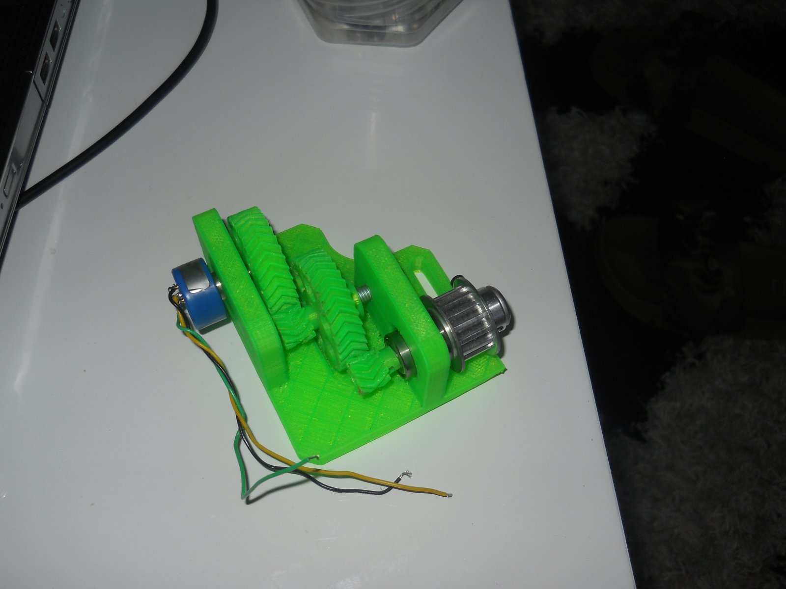

    Hi Guys Small update , but before I go any further gotta say Big big thankyou to @SilentChill for sharing his Reduction gearbox concept and for the 3d printed Gear set ,, thanks to his design I was able to Print off a Wannabe version LOL ... I take no credit for the work he did just wanted to say thanks good buddy . I have attached a couple of pics of the 1st test unit ,still needs some fine tuning , but for all intents its a nice concept prover ..
    I made some minor changes using the gears that @SilentChill created and they worked a treat . all I did was Bond the 2 gears together to make a combined Gaer seen in the middle of the gearbox and this runs on a 6mm shaft with bushes in the support block , ( I have acces to a lathe so it was easy to do ) .. the main smaller drive gear is Clamped on a 6 mm shaft to which the Belt drive pulley is Pined .. and the hall sensor and 2nd stage gear will be supported by just the 12mm nut and clamped to the other support upright . ( my thnking was the load on this wont be too much and should not stress the hall sensor bush type bearing ------that has yet to be proven .. as with all thing , once I verify this works i'll post the files for anyone that care to use and improve .. but have to say the design @SilentChill created works fine ..3d Printer and Cad truly are an addictive combination too much tinker potential and designs change no sooner than you print the dam things LOL ...Massive High Five Craig

    Awesome work mate any improvement is always better :)
    Could do with it all being more compact but it works and that's the main thing.
    Look forward to seeing you in action matey :thumbs

    Doh I may have come unstuck with this as I forgot my Hall sensors were 180 degree version :-( buger ... Love this idea so will have to invest in 360 degree sensors .. LOL the beauty of the CAD and 3d printer though does make redesign easy.. its not out of the question to mess about with another combination of gears so will keep you guys posted either way ..cheers Crew

    Just be mindfull of what quality of Hall sensors you purchase and how you mount them - I've only ever had two pots go on me in my rigs and they were both Hall sensors - basically the shafts bound up and seized from very small lateral loads - I just buy good quality wire wound pots as the 'good' quality Hall's (designed for servos) are very expensive. My current actuators have just good quality pots fitted and have been operating fine for over 18 months - with a small lateral load.

    That gears kills two birds with one stone , less revolutions on the shaft, but also no lateral load over it.

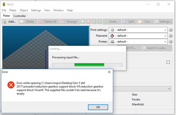

    I tried to open it with slic3r:

    What program you are using to read that file? Can you export it to STL that can be sliced or edited for remix?

    My printer came with CURA as the slicer and not really messed around with any others as it currently does the job for the few bits I have made to date. their should be a Stl file in the unzipped document ...it may be *.amf which I think is some sort of Microsoft file extention as I recall I was able to open the file in windows 10 (works PC )

    No Stl file in zip. Only an amf document.
    Doesn't work in Cura 2.6...
    https://ultimaker.com/en/community/35655-amf-file-support
    Why not STL file that all slicers support?

    im using Cura 15 I think its supplied By Wanhao My 3D printer and it opened it so I just left it as is .. i'll have another look and get back to you ..
