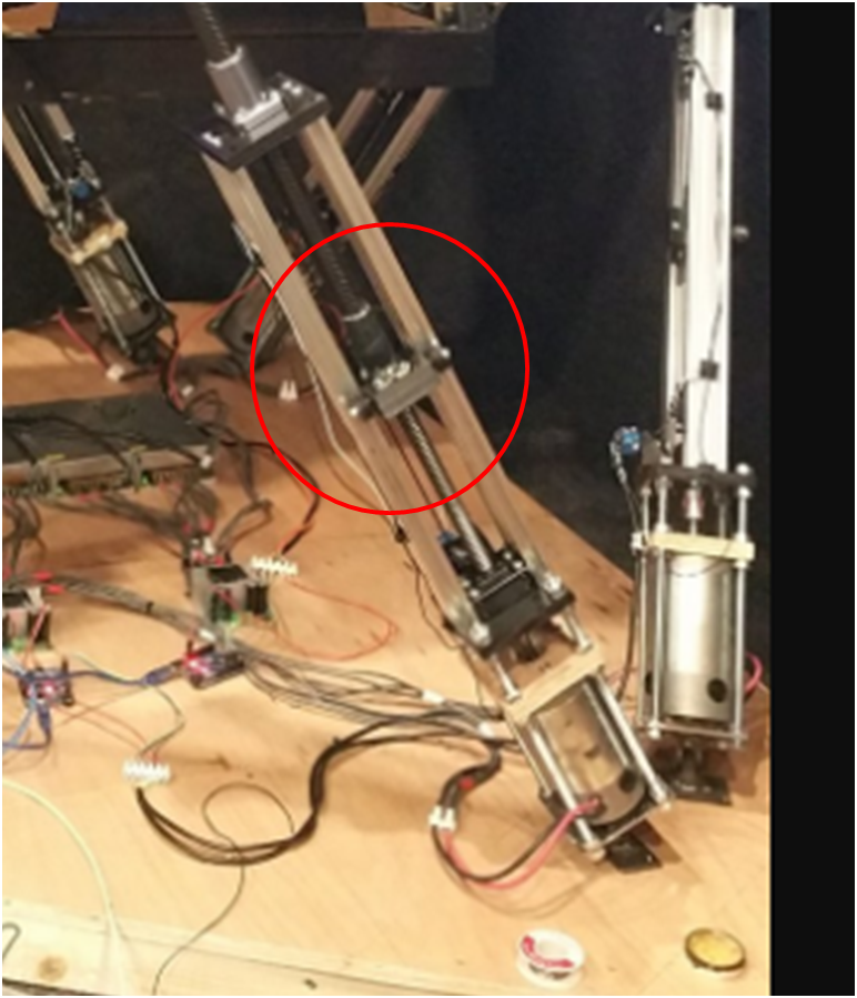

  18. baykah
    baykah Active Member
    Sep 1, 2016
    137
    Toulouse - France
    414Coins
    +133 / 0 / -0
    guys, my actuators are a little be wobeling, like the ballscrew is not straight (but it is..), I beleive this is due from play in the upper linear bearing igus and the fact that the end of the ballscrew is not fixed but wobeling into the 25mm rod ...
    It is not that bad, but during high speed movement the entire actuator vibrate due to rotational imbalance ...
    Any thought ?
    EDIT : Ok I think I need to do that (see pic)

  20. baykah
    Sep 1, 2016
    137
    Toulouse - France
    414Coins
    +133 / 0 / -0
    I just noticed that wanabeaflyer changer the linear bearing in the latest design ...
    Rework needed, but in the mean time first configuration is OK in simtools, I just need to test with a game now.
