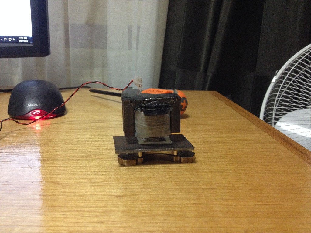

    Hi Guys,
    This is still in it's infancy but the results have been far better than expected. I've been playing around with some old speakers trying to make a decent bass shaker but they end up being disappointing to say the least. To get decent results you need a high power speaker which can end up being costly and take up too much room. The best way to go about making a speaker based shaker is to get one of those logitech 2.1 systems and use the sub as the shaker core. The problem still remains, these shakers take up too much room!
    I'd searched around the interweb and looked up how an actual bass shaker works which led me to find an interesting way on how to construct a bass shaker with easy to find parts.
    Behold!
    This thing is on minimum power too. If you connected a speaker to the amp you wouldn't even hear anything.

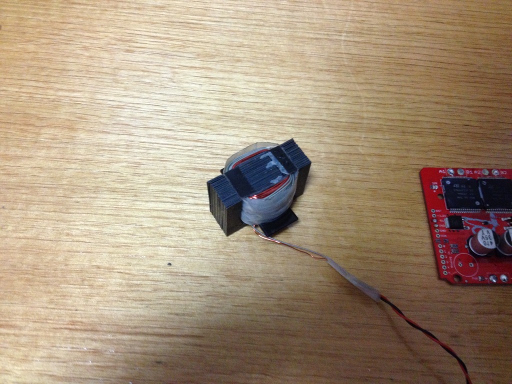

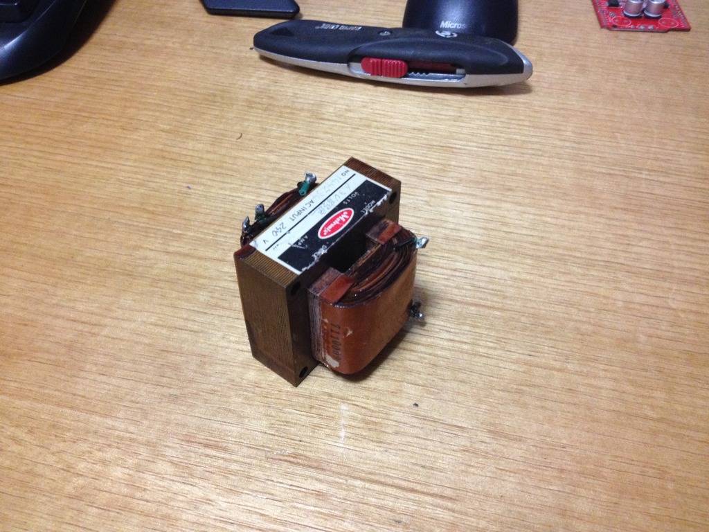

    The construction is quite simple but can be a pain in the arse. First you must find an amplifier that you are going to use to power the transducer and then find a suitably sized transformer. These two things work hand in hand as the transformer will need to be able to dissipate the power being put through it. So you can't use a 50W transformer and a 200W amplifier as the transformer will cook very quickly. The other aspect to consider is the required ohms that the amplifier will drive.
    Once a suitable transformer has been found it must be stripped down to be converted into a bass shaker.
    I ratted out a simple power transformer from an old power supply, it's quite small but it'll do for now. I then stripped the transformer to it's core and winding case. Most transformers are built the same and consist of 3 parts: the core, the housing for the winding's and the winding's themselves. The core is the first part to be taken apart and consists of thin, two piece, overlapping plates making up the thick core. Usually the plates are stuck together with a lacquer which can be taken apart by using a scalpel blade and jamming it between the layers and slowly prying them apart. Each plate is shaped like an E with the center spoke having the windings around it and and end cap shaped like an I to complete the figure 8 shape of the core. The I piece is the first to be pried out which frees up the E piece to be pried off next. To do this insert the scalpel blade between the plates and wiggle it around until the blade breaks through. Then slide the blade along the seam until one layer is free from the other plates. The first plate is by far the hardest to get out as it has the pressure of all the plates behind it as well as the bonding lacquer keeping it in place. Using some flat nosed pliers try to wiggle and pull the plate out of the housing. I mangled the first piece on mine but being that they are made of iron they are quite soft and will hammer back into shape quite easily.
    Once all the plates are out the I shapes can be discarded and the windings must now come off. The winding housing must be retained and care must be taken not to damage it as it will be re used.

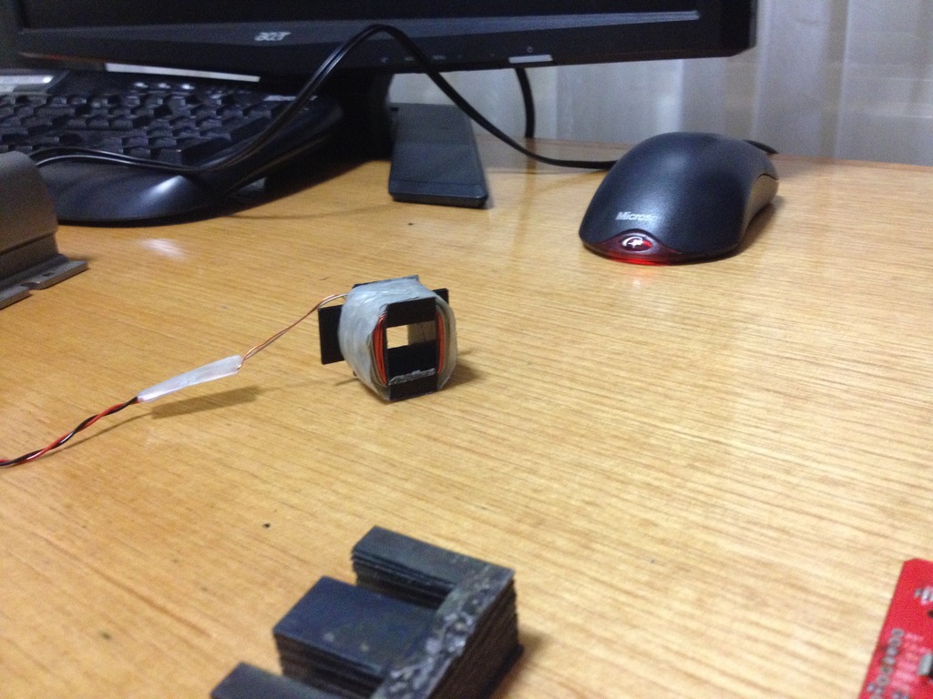

    The core must then be re wound with suitable wire that will match the required impedance of the amplifier.
    Wire gauges and number of turns vary greatly depending on your overall system. For instance a 200W system will require much thicker wire and a large transformer, whereas a smaller 50W system can get away with smaller wire and transformer. The amount of windings will depend on the resistance of your wire, use the thickest possible wire to take up all of the housings space. It's ideal to go for 2 ohm systems as this means less windings on the transformer and thicker wire. I can't give exact details as I am still experimenting myself. Solid wire is a must, stranded wire will have too much resistance for the same given space.
    Then the core must be re inserted. Face all of the E shapes so that they all face the same direction and slot them through the housing. Done!
    It's just a baby!
    The way this transformer vibrates is when an electric current is applied to the windings it creates a magnetic field and turns the iron core into a magnet with the north pole being one side of the E shape and the south pole being the other side of the E shape. This makes the transformer want to lean to one side. Think of it like a horse shoe magnet. By alternating that current with audio you effectively switch the poles and cause the transformer to lean the other way.
    To actually get this thing vibrating a ferrous plate must be placed on the side of the transformer with the three spokes. This is the plate that the transformer will be attracted to and lean towards during operation.
    There has to be an air gap between the plate and transformer. I Used a hand wound spring out of TCW to space out the two. This mounting is still in testing phase and far from being ideal to transmit the vibration.
    Currently as shown in that video the vibration coming off such a small unit is awesome! The power level on the amp is on minimum as well meaning that a transformer that can handle 250W will shake the damn room.
    At the moment I am stripping down a transformer that is twice the size of this one and I plan on going a touch bigger after testing is done with it.

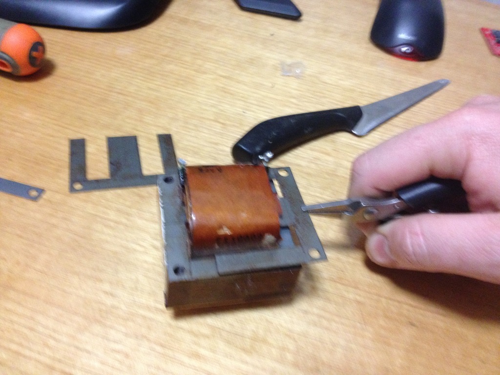

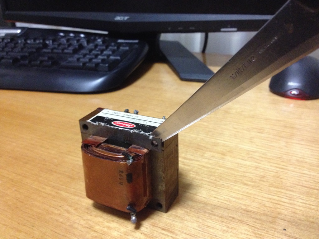

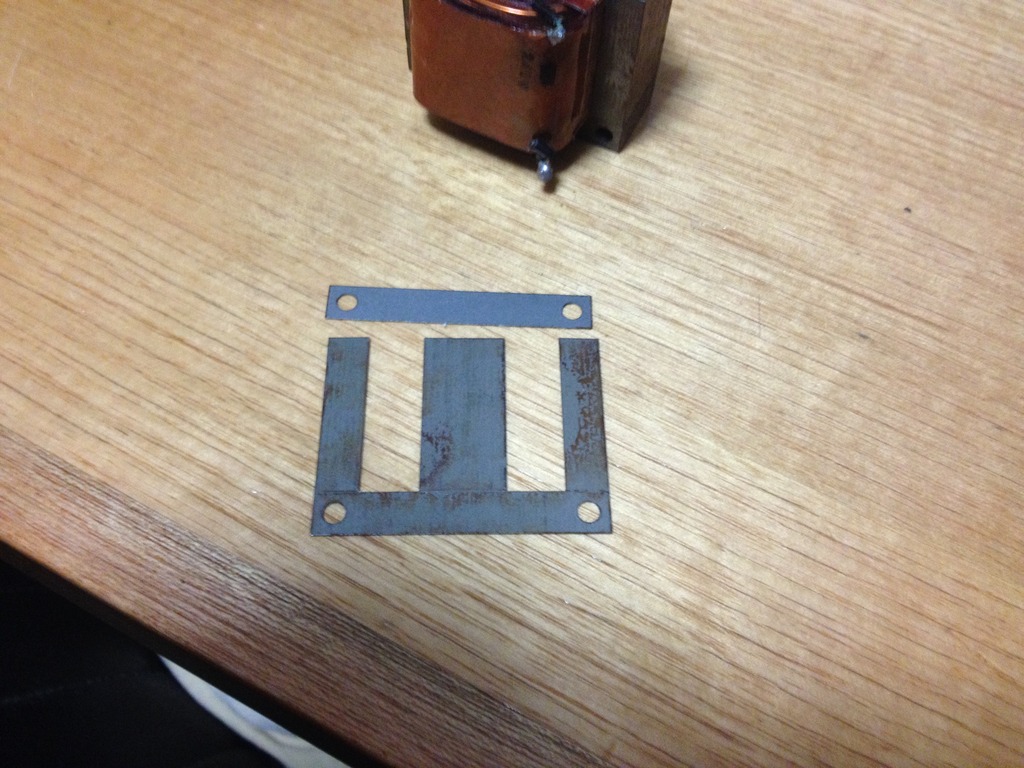

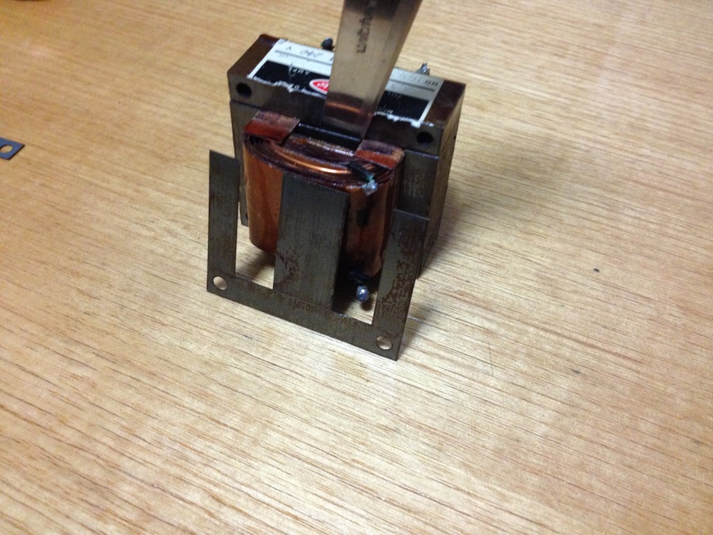

    Here is a quick video on how to strip the core out.
    Here is the transformer as you would find it (I've already taken a few plates out)
    This is how the plate arrangement looks like. I piece on the bottom going across. E piece facing downwards.
    The plates are stacked in an overlapping way so for instance the first E piece faces up and then the next plate faces down.
    Using the tip of the knife, jam it between the plates. Wiggle it around the perimeter of the transformer, loosening one layer at a time. Some transformers haven't got much lacquer on them so they pop straight out like in the video. Other times every layer will be a total pain.
    Arrangement of the core plate.
    Sometimes you will need to loosen the inner part of the plate (middle spoke of the E) as lacquer could have gotten down there and jammed it up.
    Pliers always help (potato cam quality image here)
    Once all the plates have been taken out you are left with the coil housing. stripping out the wires can take just as long as taking out the cores and can get quite messy as the dried lacquer crumbles. Also there will be multiple windings all separated with some type of plastic or cardboard. Keep the larger wire as this can be re used to wind the new coil.
    Done! Next will come the construction phase. The coil housing shown here is probably from the 70's as it is just some cardboard dipped in rosin to stiffen it up. More modern coil housings will be made of plastic and have end stoppers to make sure the coils don't slip off the sides.
    You basically have to guess the size of wire you will need to fill up the coil housing but have enough resistance to match your amplifier. The thicker the wire the less resistance per meter but inversely more power handling capability.

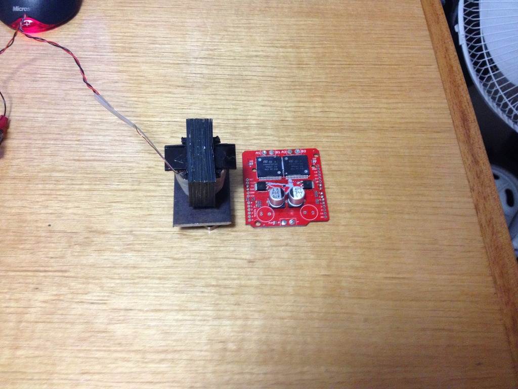

    Introducing: Mk2!
    Using a low frequency test tone
    This is the vibration power:
    The annoying noise is coming from the bottom mount springs which are bottoming out during the vibrations. Once I get the springs sized properly there should be no noise coming from the shaker itself but from everything else that is vibrating.
    The best vibration seems to come not from what the bass shaker is directly attached to but from all other items that are touching the table, hence the video of the table leg with the brick (had to raise the table height a tad while I construct my monitor stand). SO a really thin strip of rubber inbetween the shaker and the sim frame might be an ideal attachment method. Need to do more testing to confirm this.
    After more testing I have found that the coils ideal frequency is 30Hz with an upper frequency of 60Hz (everything after that causes barely any vibration). The unit can actually handle 1Hz for a period of time before it starts to overheat. I am hoping that with a square wave function generator I could potentially halve the amount of time that it draws current but still have good vibration.
    Here is a video showing a range of different frequencies:
    At the moment the biggest problem with MK2 is the coil heating up over time. It gets quite hot so I need to see if the square wave will reduce the heat otherwise I'll need to use a higher voltage source.

    Hello, new here but i think your heating problem is due to the lamination thickness, mains power transformers are only designed for low frequency (50/60 possibly up to 120 Hz) and the individual lamination's are quite thick, at higher frequencies eddy currents can flow in the individual lamination's (wavelength of frequency) and this generates heat. An audio output transformer from a valve amplifier might be better as it is designed to work over a larger frequency range and has much thinner plates.
    To get better bandwidth you also need to start with a coil that has very low impedance (low inductance, low number of turns, heavy wire and big currents at low frequency) as frequency rises the impedance (effective resistance) will rise rapidly and you will struggle to get meaningful current flow in the coil.
    The best sort of amp for this is a simple mosfet switching bridge (motor driver) as it will not suffer from the poor load matching you will get using an audio amplifier that is expecting to see around a 4 ohms load.
    PWM can then be used to limit the current at lower frequencies by using a low duty cycle square wave (triangular at load). You must also ensure that you switch polarity each cycle when using 'square' waves to avoid a build up of DC field on the core so you need a true mosfet bridge which can reverse polarity each cycle. You will need diodes or a snubber to protect the output stage from back emf.
    If an audio type amp is getting hot this is a sign of poor load matching.
