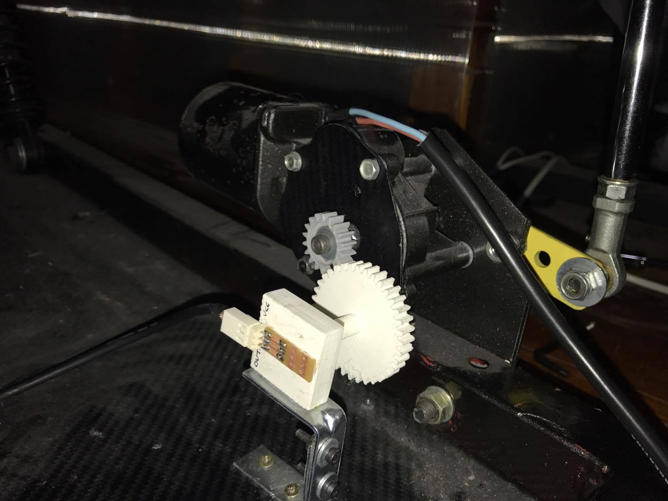

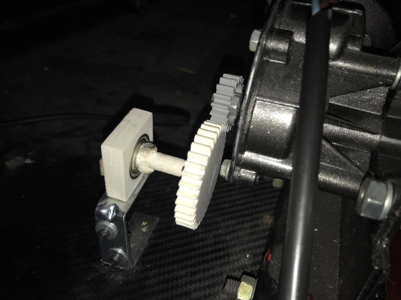

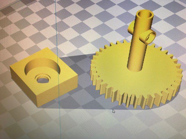

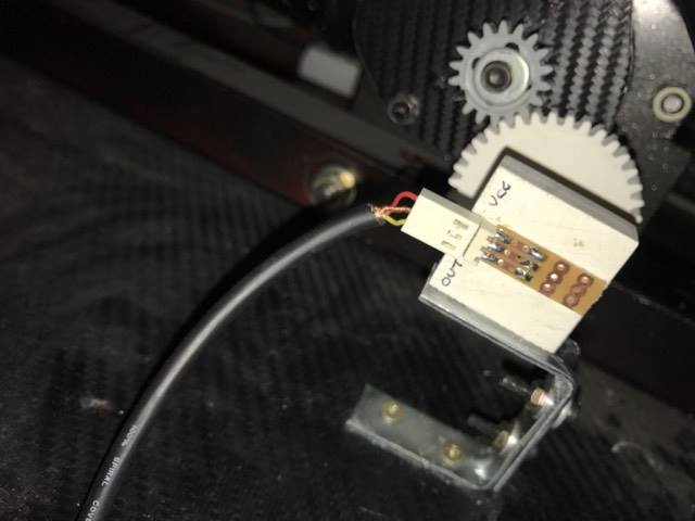

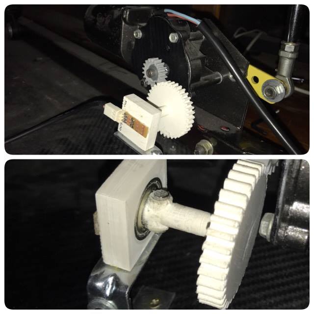

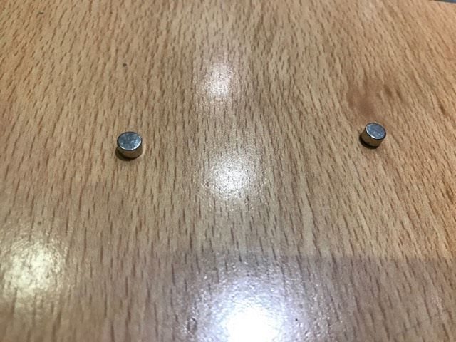

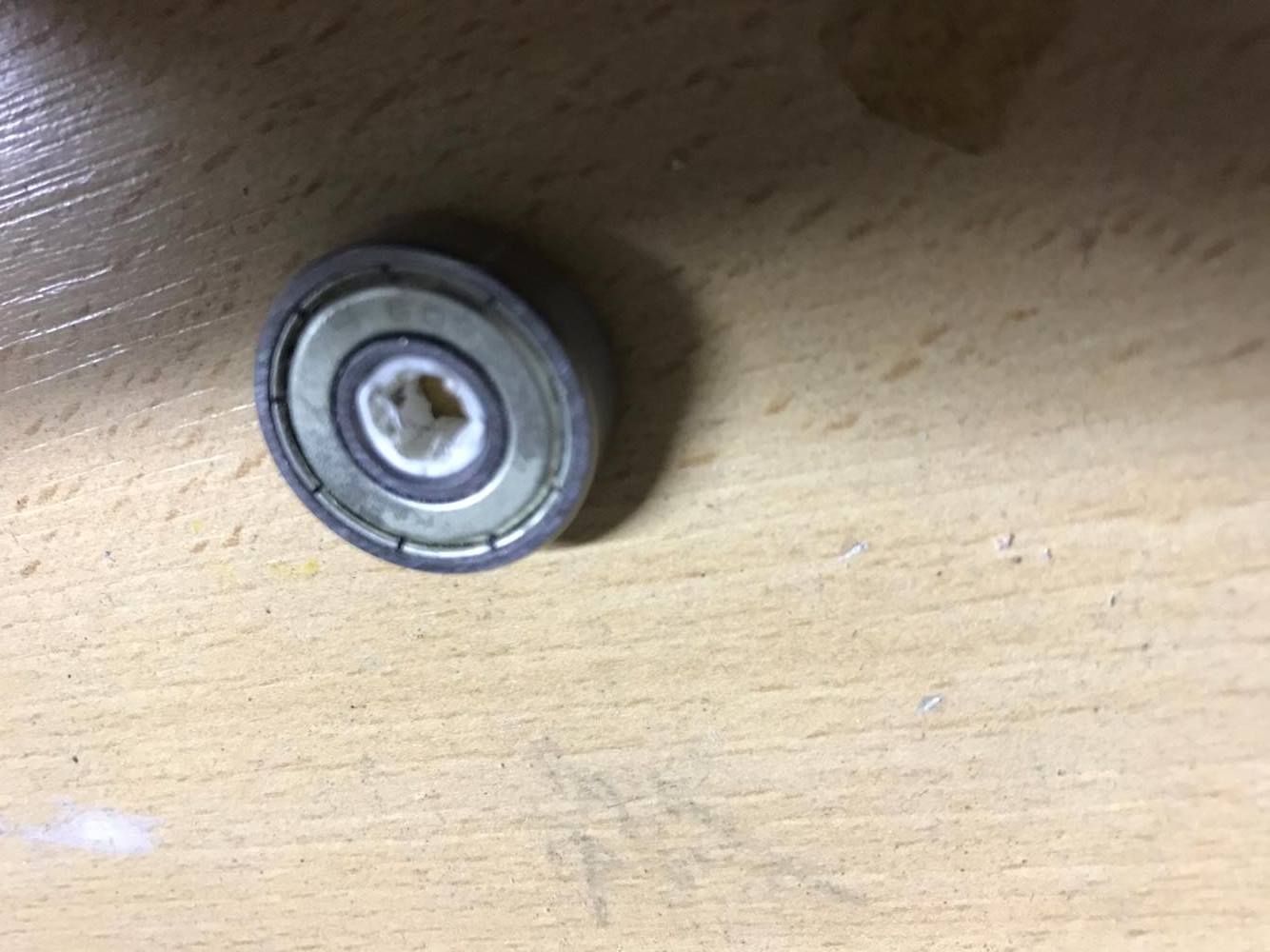

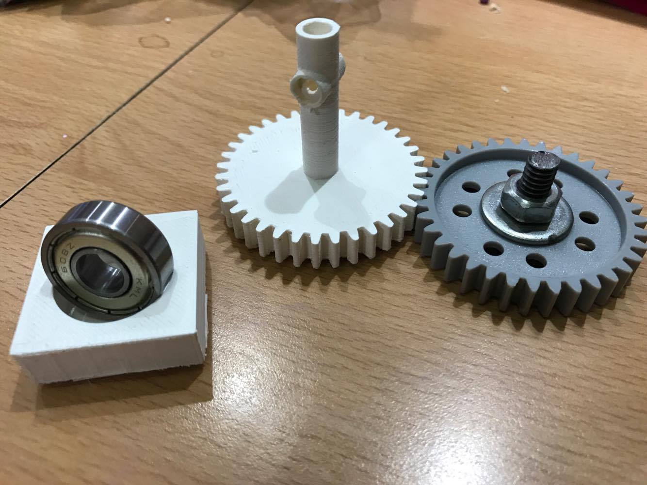

    Hi this is my version of DIY Hall effect Pot. Just design and printed on 3D Printer, glue 2 neodimiun magnets , mount a road and use a hall effect sensor.
    With a reduction gear 2:1 I got 180º (just what I need for simulator arm) "up and down just 180º.
    16934099_10211777695308487_166895136_n.jpg 16930600_10211777433381939_487783667_o.jpg 16924228_10211777736229510_2002414669_n.jpg 16910663_10211777695108482_216178389_o.jpg 16924109_10211777695188484_1923010135_n.jpg 16930721_10211777433061931_1461151274_o.jpg 16910974_10211777432661921_176721525_o.jpg 16933622_10211777751429890_1008044128_n.jpg

    That's a very good solution ... Which sensor did you used ?

    Do you have a good accuracy with these sensors?

    How strong is this 3D-printed thing?

    As there is no weight or force on these parts, the 3d prints are strong enough for this kind of part.

    which hall effect sensor did you use? and A1302?

    I think also it is possible with SS49E sensor. I`m trying to build something similar

    It's a 1302

    SS49E sensors will be good too.

    Just use a 1302

    The best. Never fail. The analog pots are obsolete

    Very strong they are made fr9m ABS.
