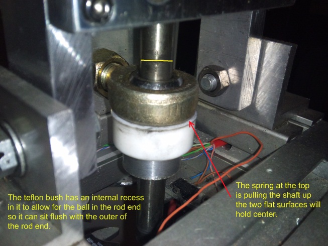

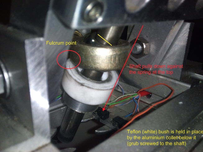

  11. elnino
    elnino Active Member
    Apr 1, 2010
    246
    Computer Geek
    Adelaide, Australia
    1,557Coins
    +139 / 1 / -0
    Yes, the English is a little off but understandable.
    The spring that is at the top is trying to push the whole shaft assembly up through the rod end. Because the teflon block at the bottom is flat and secured to the shaft, it wants to hold center. I can take some video of it in close action if you like. Basically, as you push it to the side, the shaft is pulled down against the spring so it wants to pull back.
    The file is an Autocad 2009 3d drawing. You should be able to open it with Autocad Design Review (helps with measurements etc) or TrueView (view only) tool - Go to autocad.com and there is a link to them in the bottom right.

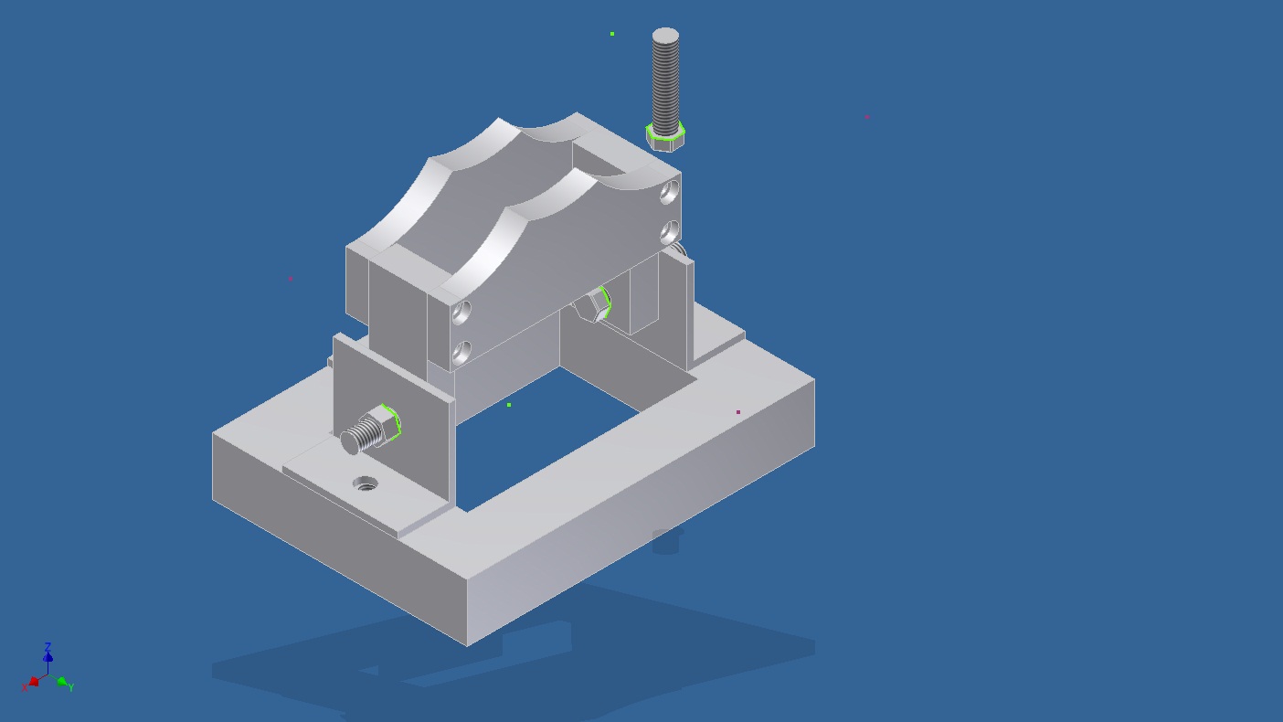

  12. pdor90
    pdor90 New Member
    Aug 8, 2010
    0Coins
    Your design is very nice :thbup: , but I have a small problem with the joint that moves the rod.
    I took a plastic joint with a hole 8 mm. you take photos or videos at the joint in motion? :) . to understand how they work your pieces.
    here is a picture of my hub:
    here is the model made by inventor on PC (I have yet to complete):
    Thank you for your patience and willingness.
  13. elnino
    Apr 1, 2010
    246
    Computer Geek
    Adelaide, Australia
    1,557Coins
    +139 / 1 / -0
    Here are some commented closer pics. I am not so sure your 8mm rod end will work too well as the surface area might be too small. Either that or you will need to counter it with a stronger spring at the top.
    Note the position of the yellow line across the shaft - It moves down pulling against the spring.
    Also note that the only things secured to the shaft are the shift knob, top collet and bottom collet - no other part is secured to the shaft at all. It is all free moving.
    The cad drawing is slightly different where it leaves out the bottom collet and the teflon is secured to the shaft. Minor difference but functionally the same.
