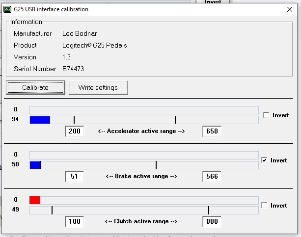

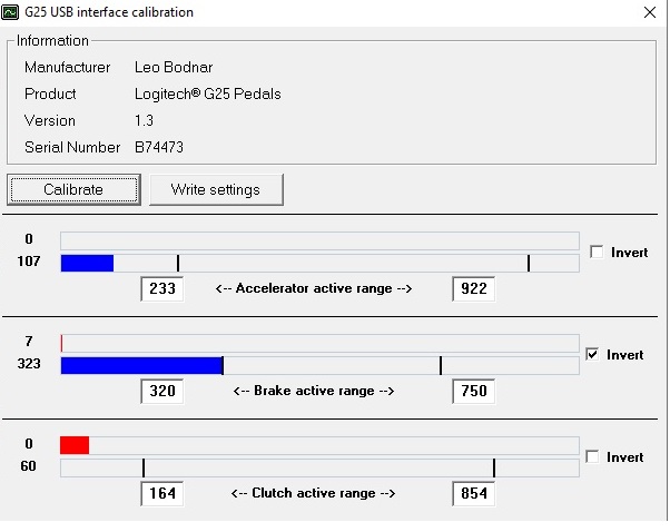

    D'OH - the issue was very simple to fix.
    I have a Leo Bodnar Logitech to USB converter and there is software to calibrate the converter - once I did that it was registering just a slight pressure on the pedal so now I can trail brake like a pro (well almost.....)
    I still think the wii fit loadcell is not the right option and will try a disc type loadcell. The cheapest one I can find is on back order so I won't get it for 6 weeks or so. Will report back if that makes any difference.

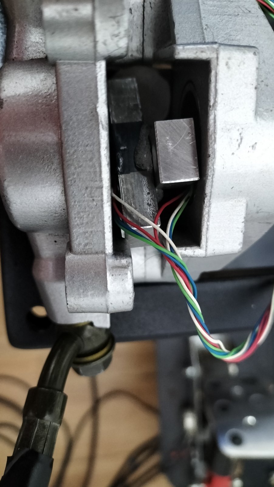

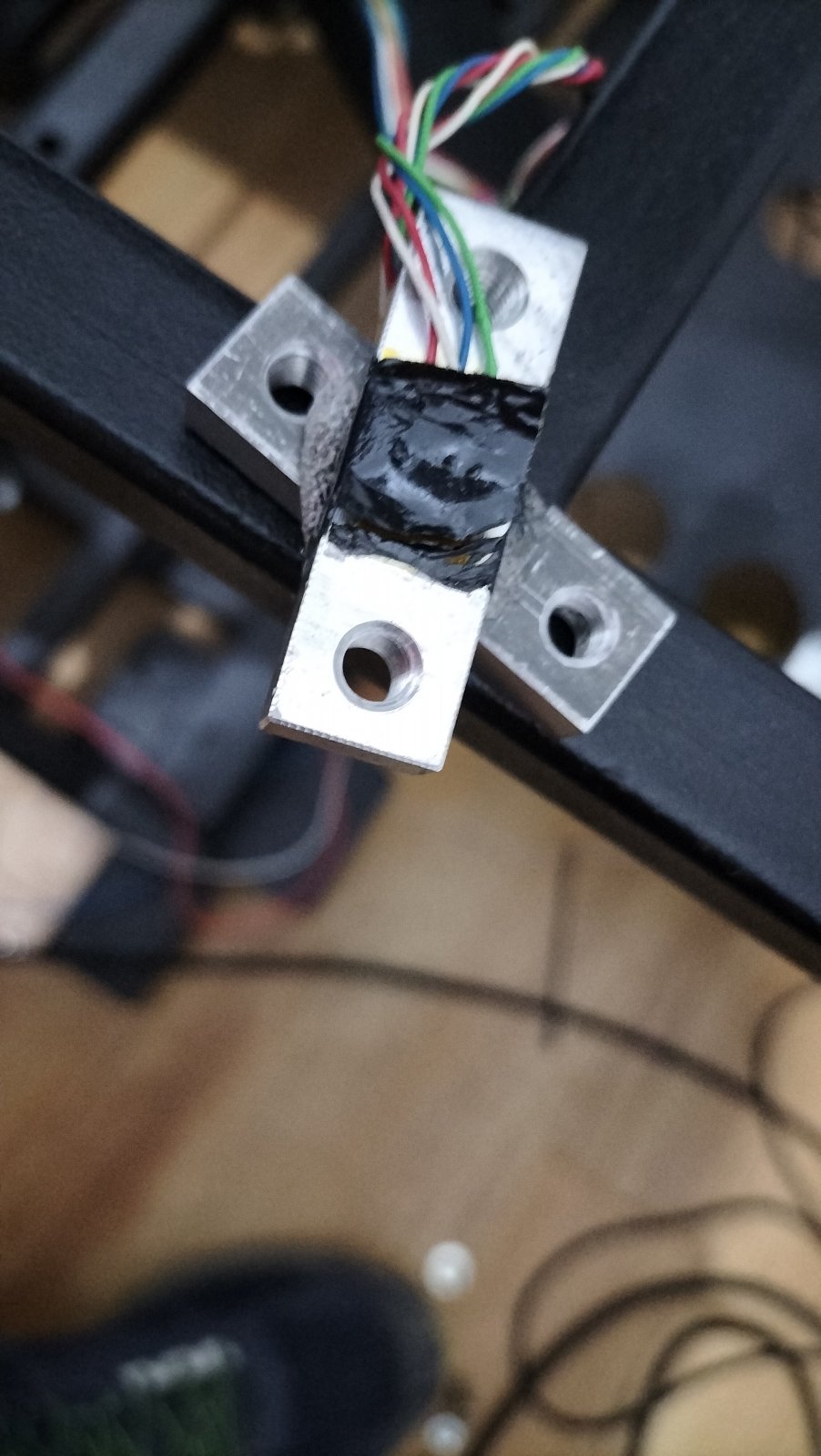

    Update time :)
    I redid my wii fit loadcells by taking 2 of the bare loadcells (without the pressed steel bolt on bits), placed them back-to-back in a X and then dropped them in my caliper. This got rid of any flex that the pressed steel bits had (and they ended up bending out of shape anyway) and made the pedal a lot harder.
    Then I tried different pedal arm leverage ratios and found it is very dependent on getting that just right. Too much leverage and the pedal is too soft and spongy and not enough and the pedal is like standing on a brick.
    I have it just about right but would like it a tiny bit harder - unfortunately can't do that unless I build new pedals with infinitely adjustable leverage ratio.
    Just did a quick race at Spa in a M3 and got straight down to 2:20's where I was usually in 2:21 bracket. Did one lap at 2:19.8. Braking was just so natural and trail braking all the way into the apex felt the most realistic yet.
    In fact I would say it absolutely felt exactly like real brakes :)

    Another quick update.
    I put the pedal back to the lowest lever ratio (from 3:1 to 2:1 roughly) so it is hard to push - even on the middle setting it was too soft and had too much travel and I was struggling to trail brake properly.
    I was also trying to use the variable resistor on the Derek Speares loadcell amplifier board to adjust the sensitivity. If you set it so it is really really hard to get full braking (F1 car) and then adjust it lower for Gt or road cars it then increases the bottom of the range. Sometimes so much that the brakes are on when you don't even touch the pedal. And you have to adjust it between cars or the F1 cars lock too easy if you have it set for GT cars.
    So now I have figured out that you adjust the resistor so it only read max when you are at max pressure you can physcially apply and leave it alone.
    I have a Leo Bodnar adapter for the Logitech pedals to Thrustmaster wheel and in the software you can adjust the pedal range (same as the brake range in AC etc). I set the minimum slider so that when you take up the master cylinder slack the signal sent to the game is around 100 (or 10%). This will stay the same for any car now.
    Then I adjust the maximum value to suit the car - 1024 for F1, 910 for GT and 800 for road cars (lower number means less pressure to reach 100% in game)

    Turns out my X shaped loadcells wasn't the best execution - as they were only glued together and the glue I used wasn't very good so they would move in the caliper. This then meant that the loadcell sensor and wires would sometimes get caught by the caliper piston and one of the sensors failed.
    So I machined (well used a grinder actually) a 1mm notch in the back of one the loadcells so the other one would slot into and stay at exactly 90deg and used a better glue. Then put that into the caliper with one of them upright (like a Cross) rather diagonally (like an X).
    Now it is just about perfect and my settings had to change because the readings were more stable and they didn't change as I used them since they were no longer moving etc.
    So I now have the minimum brake range set so that at rest it is on zero in game. That way the master cylinder free play takes up the slack (where you would normally set minimum brake in game above zero to avoid lockups) so when you first feel the brake pedal resistance in game reading will be around 10-15% (I have it at 15%). Then set the maximum brake range to where you apply your own max brake pedal force. And adjust from there to your liking and/or car.

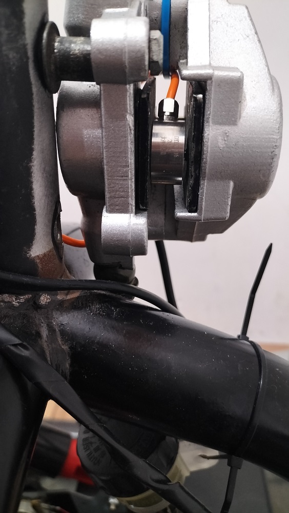

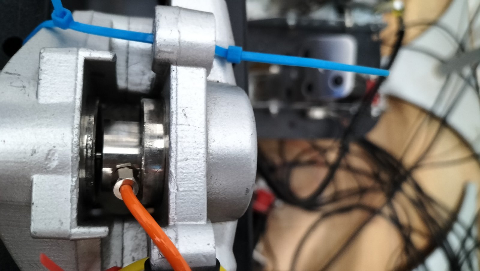

    I replaced the wii fit loadcells with a mini button 200kg loadcell.
    Now it is a very stable setup and finally works 100% - braking is now very easy, realistic and awesome.
    Also with this proper loadcell there was no need to do anything with the setup - just put everything on 0-100% and 1.00 brake gamma and then just adjust how hard to push to get full braking with the adjustable pot.
    I can now say it is a success :)
  10. niterida
    niterida Member
    May 13, 2017
    83
    Geraldton, Western Australia
    852Coins
    +46 / 0 / -0

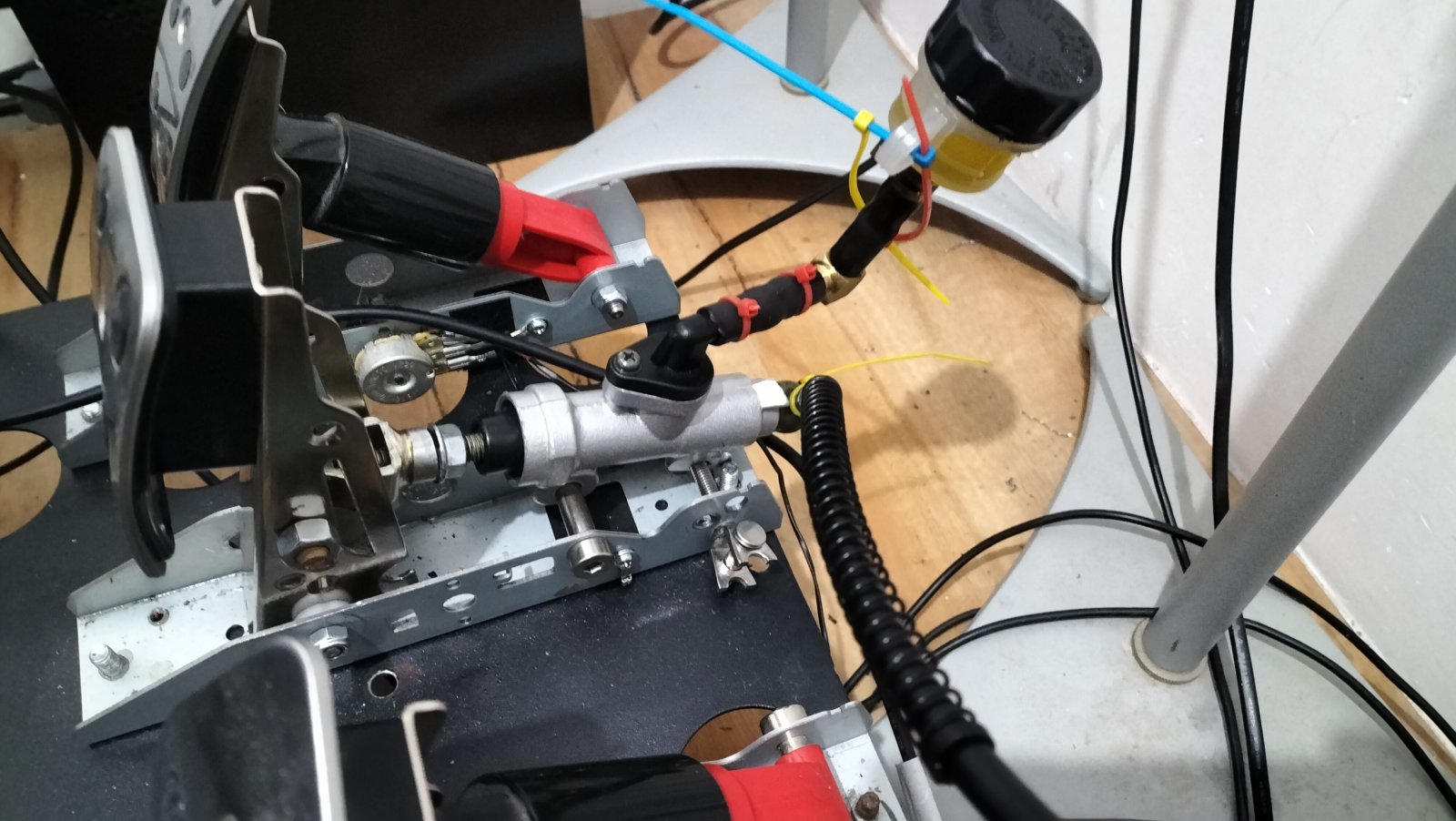

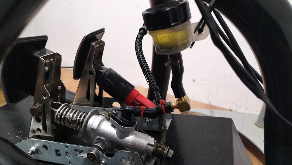

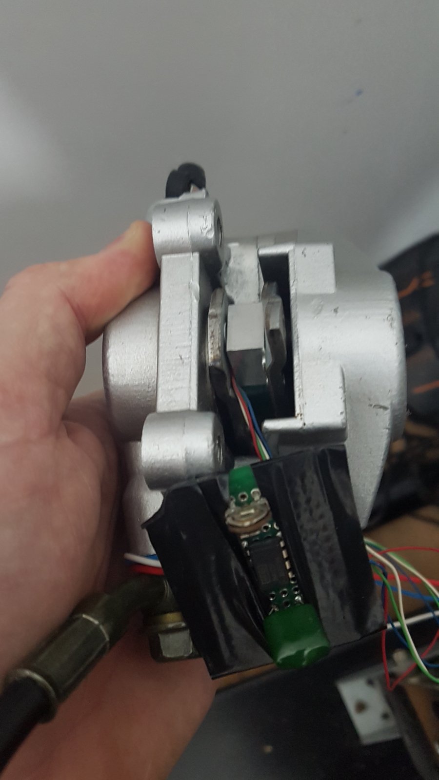

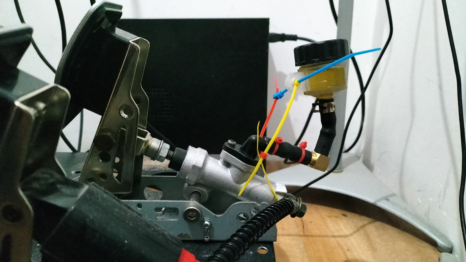

    Here are pics of the (almost) complete setup
    Ignore the cable ties - they are just temporary as I haven't finalised the rest of the rig yet.
    And a run down of what it is :
    $30 eBay caliper and master cylinder for a scooter (mounted to my G29 pedal)
    $70 eBay 200kg button loadcell in the caliper (replicating the disc)
    $40 Derek Speares loadcell amp (can DIY for less but savings aren't significant)
    $30 Leo Bodnar G29-USB adapter (not required if you have G29 wheel or if you have different pedals/wheel)
    So $170 total. (all prices in AUD)

    Just in case anyone is still following this saga :

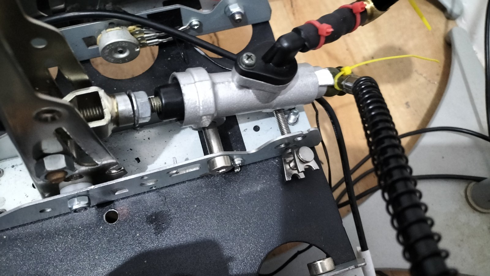

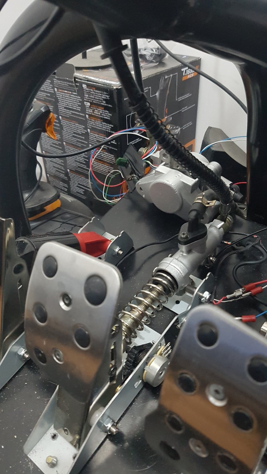

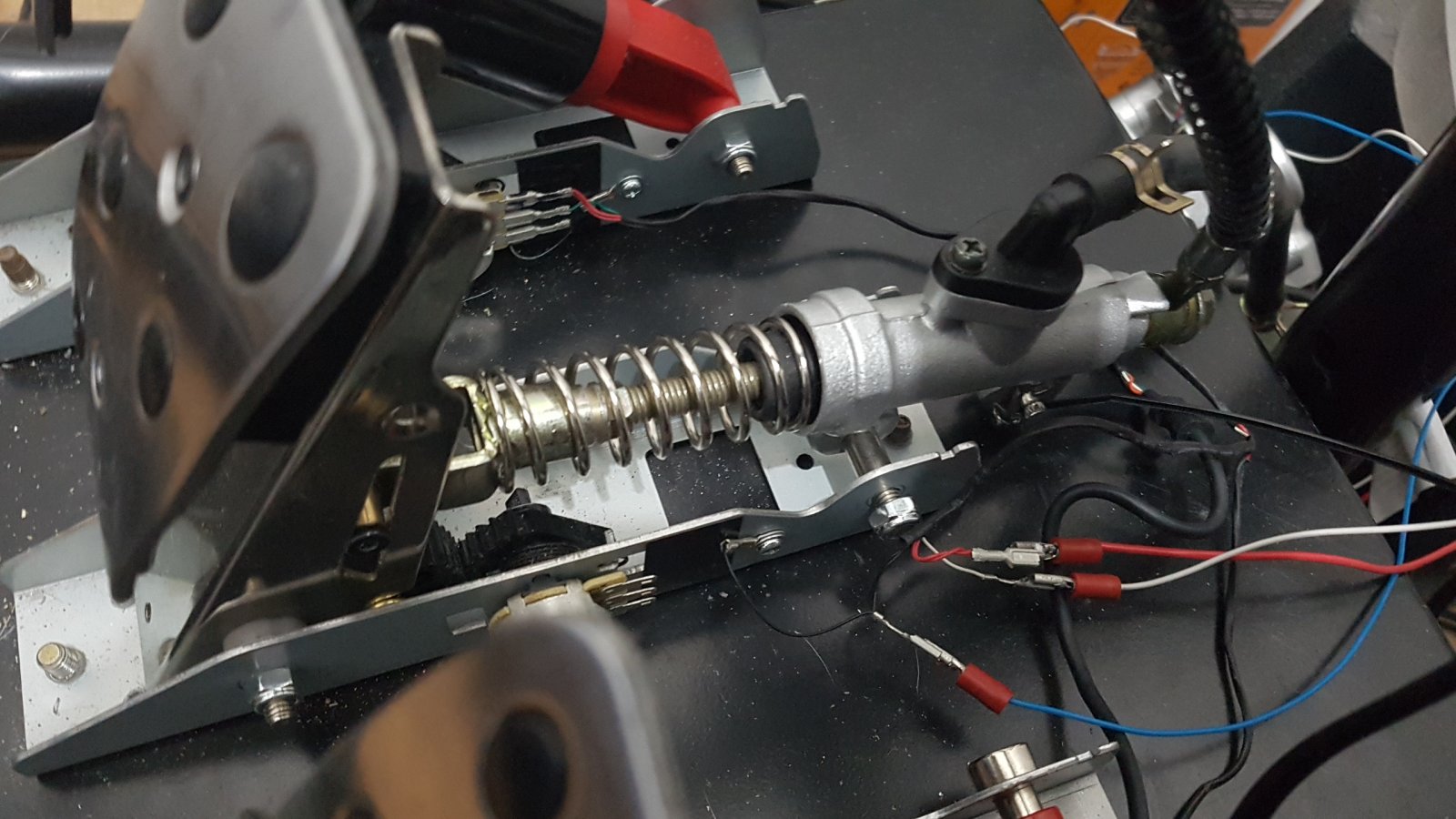

    So I rigidly mounted the caliper (not that I think that makes any difference but it looks a lot better).
    And I put the brake pads back in after removing all the pad material (so just the backing plates really). I di dthis because one of the pistons would retract all the way and one was fully extended and the loadcell would hit against the caliper body. Now the pistons can't do that and the loadcell stays central. Not really sure if this ahd any effect on the actual performance but I think it did, just not sure how.
    But the biggest change was the settings. I have finally settled on the right way to have it.
    I turned the Potentiometer in my load cell amp all the way hard (1000ohm resistance) and set the minimum slider in the Leo Bodnar software to just 1 above the resting output (51)
    Then I set the maximum slider to the value of when I pressed as hard as I could (605) Then I went for a drive in a M3 GT2 (so no ABS) and braked as hard as I comfortably could after getting used to it for a few laps. When I checked on the telemetry I was only getting 93% braking. So I worked out what 93% of 554 (605-51) was (515) and added that to 51 (566) and set my max to 560. Now I was getting 97% braking. So I set to 567 and got 99% braking and finally set it 566 and now get 100% braking, with no (or very little lockups) and great trail braking (once I got used to having more trail braking available).
    Pretty sure that I have finally nailed it - only took me2 years. In fact I just looked at my first post and it was posted exactly 2 years ago today !!

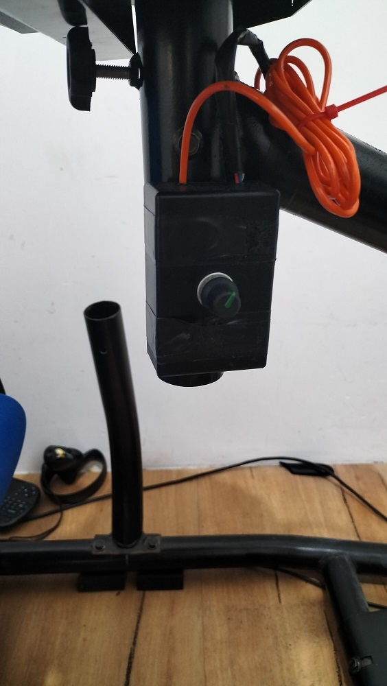

    And I mounted all the electronics in a box and tidied up the wiring and fluid reservoir and remounted the Master Cylinder to make it more rigid - so pretty much done :)
    IMG20220617120010[1].jpg IMG20220617120035[1].jpg IMG20220617120120[1].jpg Leo Bodnar settings.jpg
