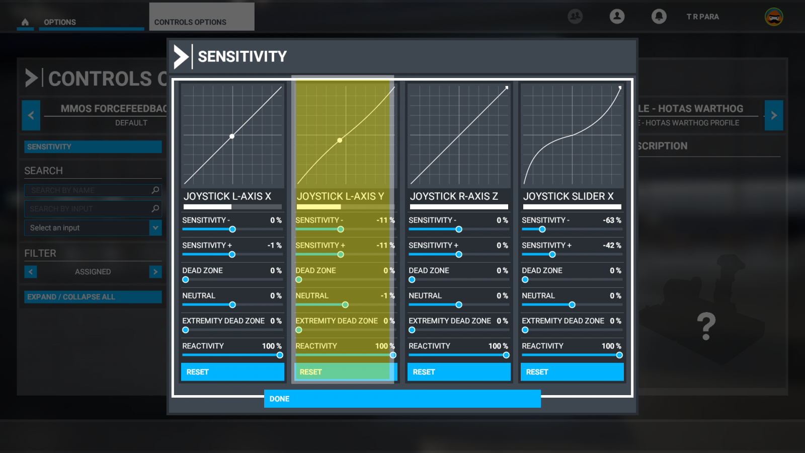

    buuuuuuuuut, back to my problem: how to get rid of the deadzone. Where at the board is the program code stored, if there is any. Or is all done using standart parts with correct wiring? Are we able to modify the bord in a way that we get the pure Pot readings to the computer? Can we use aditional Pots parallel to the existing ones with a bodnar board or an arduino micro? Does FFB still work wenn we use different axis assignments for FFB and steering?

    Ok well I do not have an answer for you. There is a dead zone. I can see it in the fs2020 sim control options screen.
    It has never bothered me. I flew for an hour or so today and once I get it trimmed it sees stable to me.
    Reducing the tooth count on the Bodnar would make the pot move faster through the deadzone but I do not know what effect it will really have after you calibrate the joystick.
    Here is a pic of the pitch axis curve on fs2020. It is easy to see the dead zone..
    I think your yoke is performing properly. If your not happy with it that is a bummer.

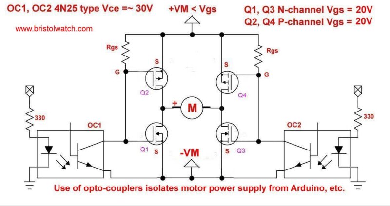

    Please can you tell us more about your mod to discrete mosfets?
  10. T R Para
    T R Para i make stuff up
    Oct 18, 2018
    385
    Cincinnati, Oh
    2,447Coins
    +358 / 3 / -0
    AC motor, 6DOF
    To explain it in detail would be rather lengthy.
    The MS FFB2 uses special H-Bridge chips that are very small. They overheat and fail rather quickly.
    I removed the 4 H-Bridge chips from the control board and hand wired a daughter board consisting of 8 mosfets. 4 P-channel and 4 N -channel as 2 seperate H-Bridges.
    The FFB2 control board is fragile and reworking smt chip will eventually ruin the circuit board.
    I do not how familiar you are with electronics so I do not know what information you may need.

    The output from the ffb2 board is not a standard pwm signal that the BST7960 board requires. I too was hoping that it would work. In order to preserve the desired effect that the ffb2 board provides I believe you would need to mimic the HAT3004R H-Bridge chip.
    Right now the simplest mod is the resistor modification which increases the torque of the motors.
    The motors used in the ffb2 joystick are also critical for the proper operation or "feel" of the yoke.
    The base line is that Microsoft designed a very good joystick in the FFB2 . Considering the cost and now the age of the device there is nothing that I am aware of that is comparable to it.

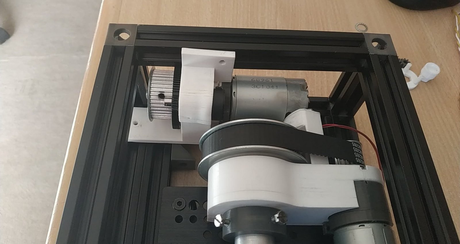

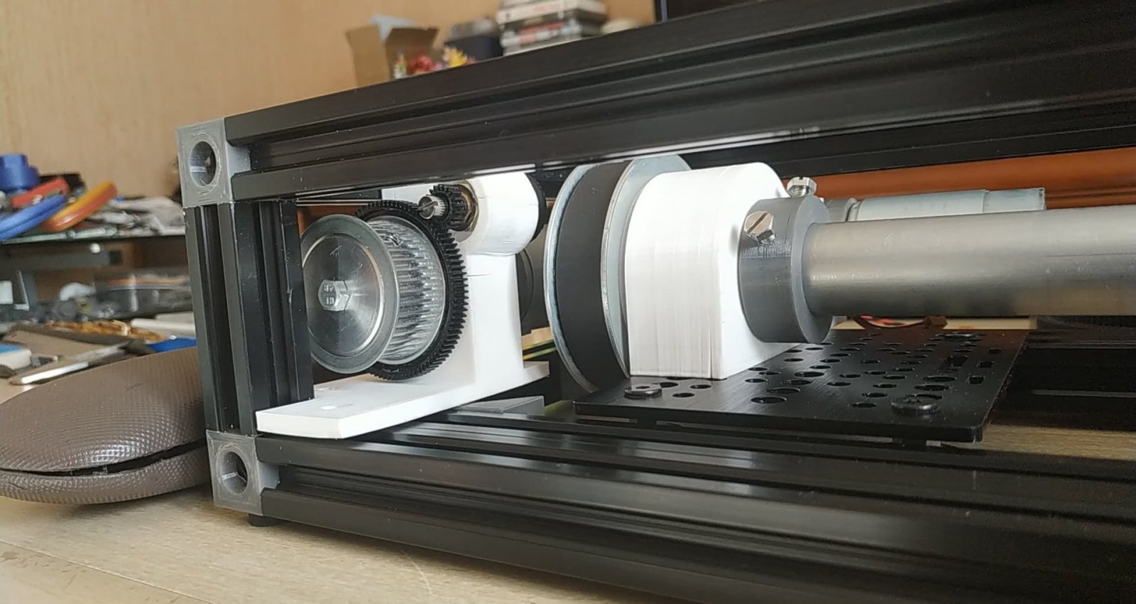

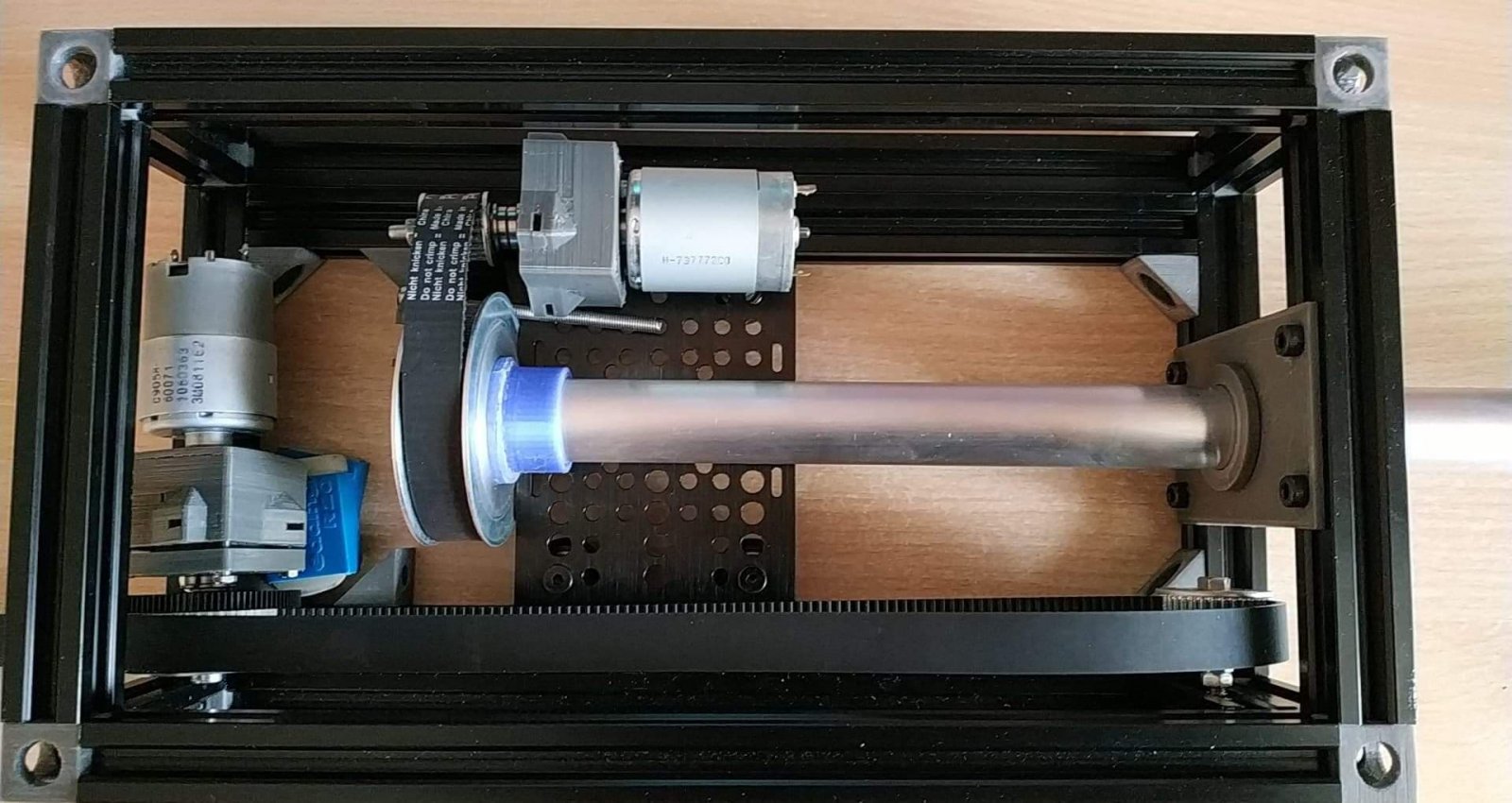

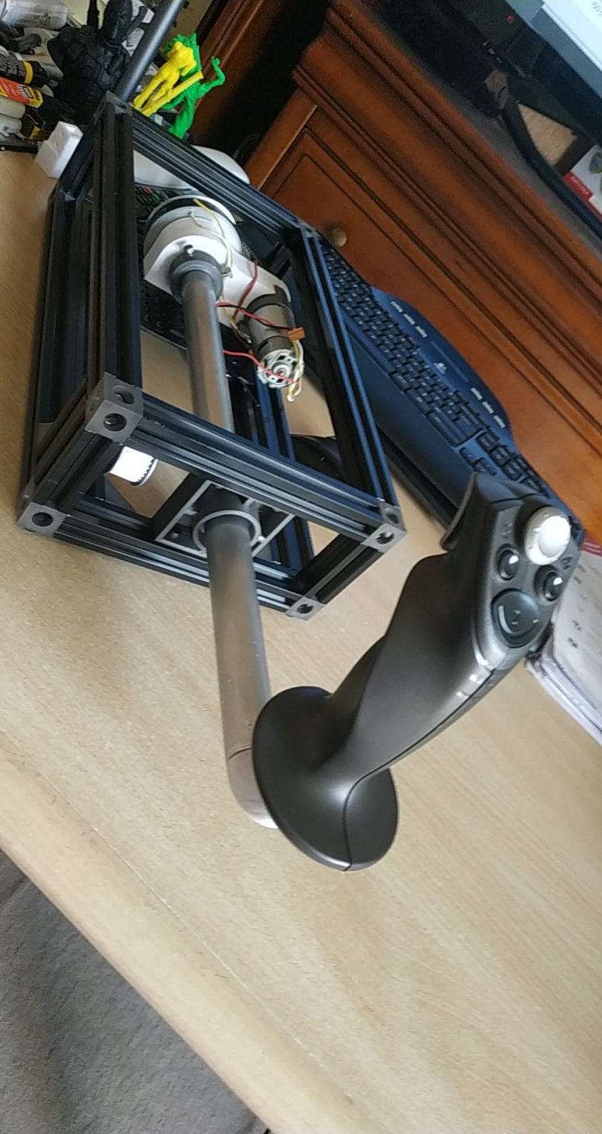

    hello at the start I went with the elegant VR solution FlightSim (Jay) V2 which seemed to me the best so I created this
