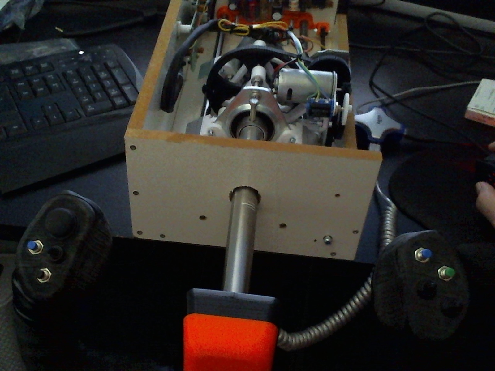

    I finished my vrflightsim DIY FFB Yoke some months ago. Did anybody find a solution for the hardcoded deathzone of the Sidewinder Force Feedback 2 Stick? it is really annoying.

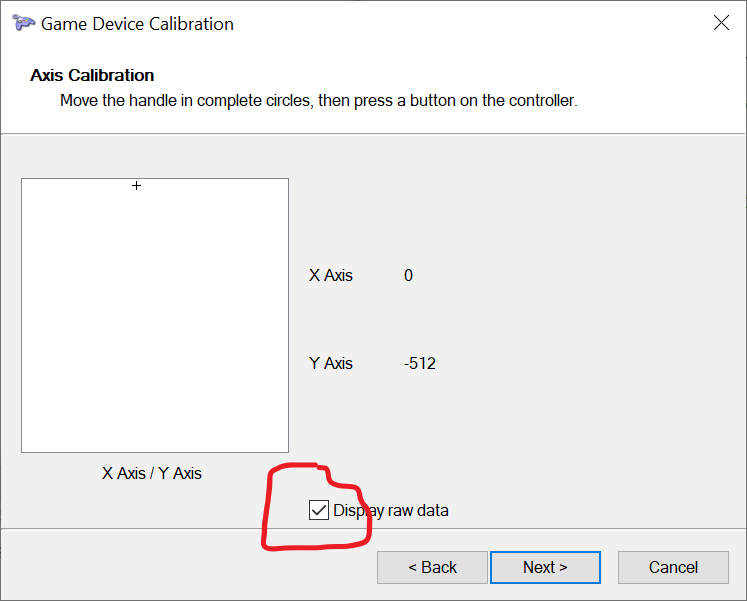

    I did some measuring today on my yoke. Deadzone on pitch is 4mm. Deadzone on roll is +- 3deg measured.
    This was done using a electronic protractor.
    Here is a screenshot of the calibration screen used to do measurements . Note be sure to click on raw data.
    I set the yoke to zero zero on the x/y axis.

    I understand the calibration attempts. What I am asking is what is the raw data saying.
    Set the pitch to zero (raw data )and the slowly move the yoke in/out until it reads a value greater or less than zero.
    I measured this pitch deadzone at 4mm you know +-2mm.

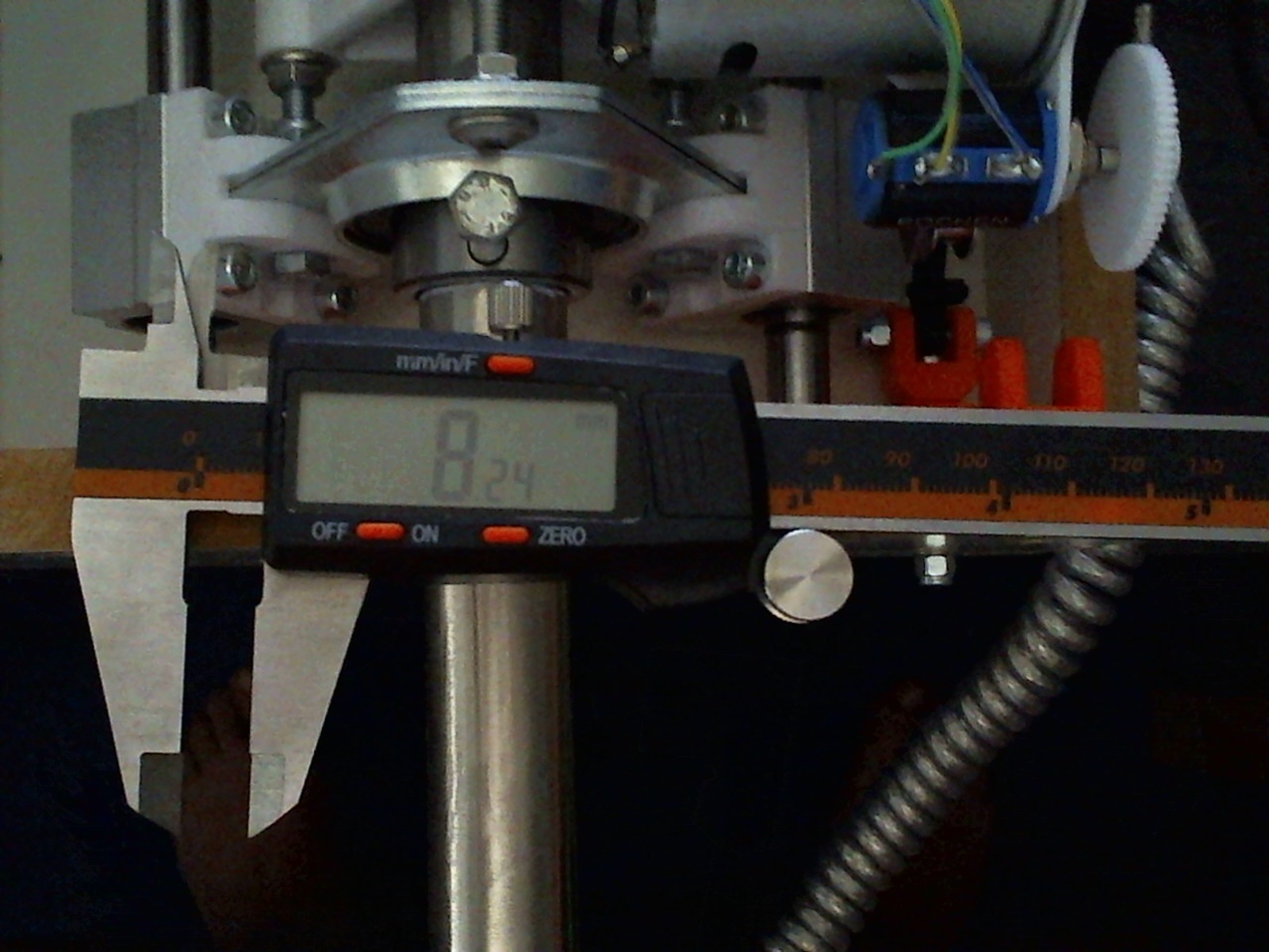

    All right.. I have a few hours of board level modding experience with the Microsoft Force Feedback 2.
    I am pretty familiar with its electronics.
    I will ask once again.
    Pitch only test
    Remove power to the motors so They are not pulling or pushing the yoke.
    Go to the config screen and set the raw data to zero.(by pulling or pushing on the yoke)
    Place a mark on the yoke shaft at the point where it lines up with the front of the housing.
    Push the yoke slowly until the raw count # goes to 1 or slightly more. 2-5 is still ok
    Make a mark on the yoke shaft again.
    Pull the yoke until it comes back to zero and through to -1,-2, or so.
    Mark the shaft again.
    The distance between the 3 marks is your yokes deadzone.
    The deadzone distance on my yoke is about 5mm +_
  15. Getnothingdone
    Getnothingdone New Member
    Jul 14, 2021
    11
    90Coins
    DC motor
    The Distance between the first and third mark is 8,24 mm Picture 2.jpg Picture 3.jpg

    I made a short Video showing movement of my yoke. made some Belt modifications. The Smal Roll axis Belt is modified to an open version, each end atttched with a zip tie. The Pitch Belt has a slightly different Routing with two Pulleys guidance, and both ends at the same plane, forward end in a custom Belt Tensioner.
