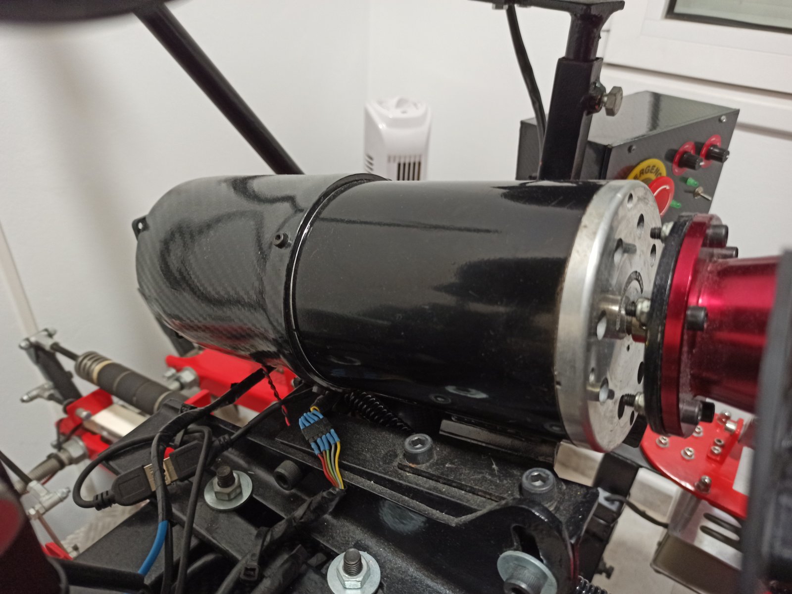

    I use a my1020 1000w 36v feed with 12v and 82A. I use 4 ibt2 and get 9nm in lock directly. IMG_20200312_221709.jpg

    Depends what you call hot - MY1020 48v @ 12v here. 3 X IBT and EMC Developments firmware (which seemed to run cooler than MMOS). Runs 100% at about 75-80A but it can't sustain that, the windings will melt. At about 2/3 power for about 1hr of racing my motor is somewhere between very warm and hot. I would estimate 45-55 deg C. I have a 120mm fan on the back drawing air through but it could be better. Direction matters too!
    I have also found that if i finish a race and immediately turn off the wheel via eStop, thus turning off the fan, it gets massive heat soak - The motor will rise at least 20deg. This is because all the heat is in the windings/armature and not the motor body. It then radiates out due to no air flow. This highlights the need for good air flow. It might even help just removing the mesh screen from the holes.
    Ideally, i would enlarge the ~10mm vent holes out to about 15 to get better flow but for the moment it's fine. Maybe next time i have it apart...

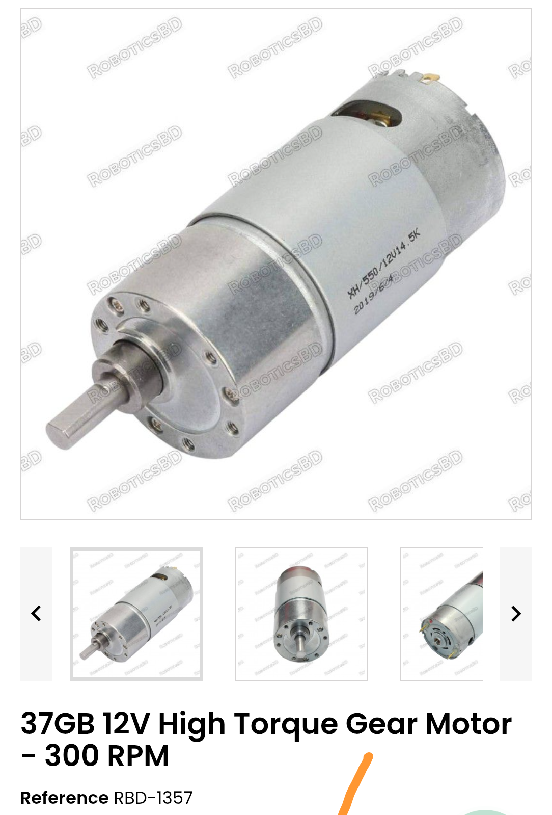

    Can 37gb 300 rpm motor be used for making ffb wheel?

    No, not in any way.
