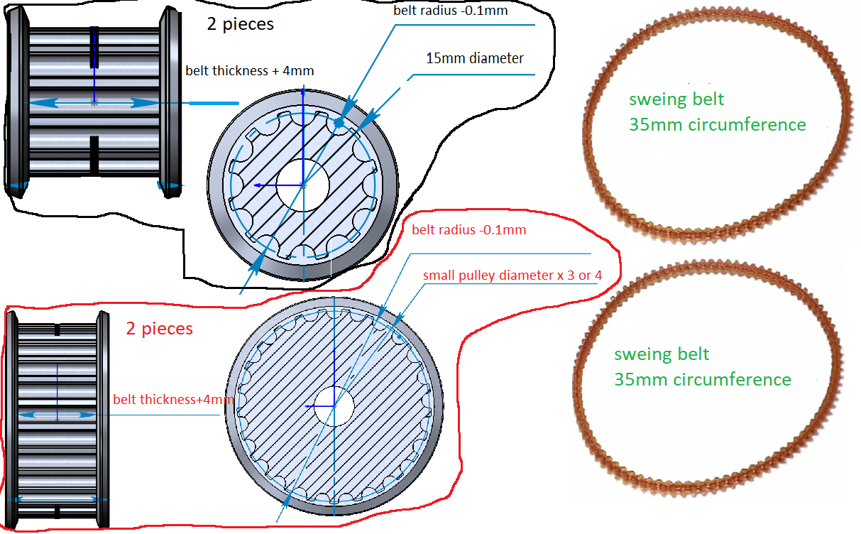

    It's looking good so far to me. I reckon that setup will give you decent torque at the wheel. I think the thrustmaster t300 uses a similar size motor and a dual belt pulley system.
    The only thing I'd check is the type of pulley that you have. I use a 5m timing pulley but you could probably get away with a 3m pulley. If you have any smaller, the belt will slip.
    I've googled seeing machine pulley and it looks like you don't have a timing pulley. The Fanatec CSW is the same, I think. You'll probably need to get some "idler" pulleys so that the belt is tight.

    Guys, follow the progress of my project, take a look, and tell me if it is good, if there is something that is not cool or that can improve, give me tips, my knowledge in mechanics is very good, but in the area of electronics not quite

    the pulleys and structure I will do in my work
