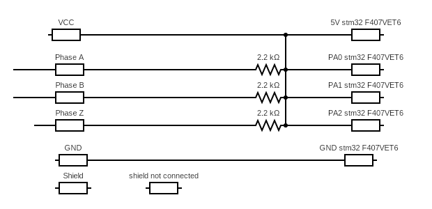

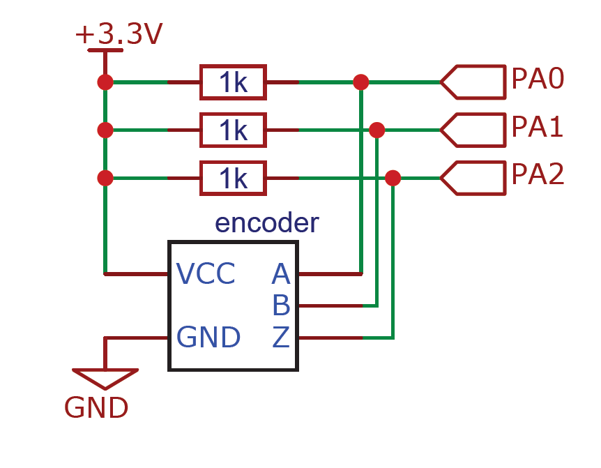

  9. Francisc
    Francisc New Member
    Dec 26, 2020
    17
    90Coins
    DC motor, Arduino
    But the resistors from A/B and Z channels still need to be connected to the 5v wire, right?
    I had this problem with another stm board. I got a new one and the problem persisted
    In the photo I put how I wired the encoder to the stm32 board. I really don't know what I did wrong. Sometimes it's working just fine, no problem at all, and sometimes there is a lot of drift to the right.
  10. Sieben
    Sieben Active Member
    Nov 6, 2018
    391
    2,216Coins
    +115 / 2 / -0
    Wrong connection. Remove resistors between signal wires to stm . Resistors shall be connected from vcc to signal pins of abz channel's. Not in between signal lines. U should put vcc through resistors to signal pins only.

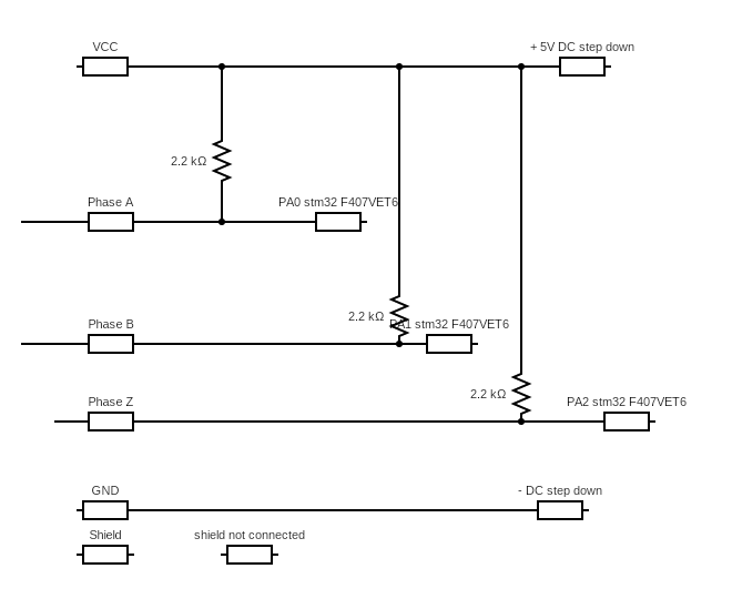

  11. Sel The Don
    Sel The Don New Member
    Feb 10, 2021
    29
    International Sales and Relations
    Bursa, Turkey
    265Coins
    Wire the STM, encoder and resistors like the photo I have attached. Ignore the 3.3v feed, the Omron needs 5 volts to work.
    IMPORTANT! use 2k resistors instead of 1k.

    I redid the wiring, bought a DC/DC convertor and now the encoder power is not connected to the stm32
    Now, if I connect the psu to the plug, I can only turn left and the encoder goes crazy. I'm using cytron https://www.cytron.io/p-20amp-6v-30v-dc-motor-driver as the motor driver
  13. Sieben
    Nov 6, 2018
    391
    2,216Coins
    +115 / 2 / -0
    Plug encoder to the stm 5volts supply. It should work no problem. The step downs can bring alot of noise. And if you put external power supply to encoder, it's GND's should be tight together with a rest of stuff GND's too. Otherwise it won't work. And don't connect the vcc pins of external power and stm then too. It's totally wrong. Only GND's.
  14. Sel The Don
    Feb 10, 2021
    29
    Bursa, Turkey
    265Coins
    I'm using a DC/DC converter powering the encoder and signals with no issues, yes the GND is tied to the DC/DC.
