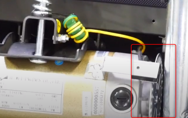

    On re-reading your post - Did you perhaps mean using something like this?
    This example is a treadmill motor. If so, then it's not likely to work well as it will not have enough resolution. You would still need to have a decent ~1000PPR endoder attached. Some motors do have better resolution encoders though.

    Hmmm it's like I'm planning on using a 12v DC 150 watt motor with a custom gear set, which estimating should provide around 6-8 NM of torque, what I was asking before if I could attach the encoder on the back of the motor instead of connecting to the gear system and if so how would do so? The reason I want to attach to the rear is because of I want to have a compact build with a small multi-geared system

    In that case, yes, it is not a problem. The MMOS software is designed for a DD wheel so the encoder is 1:1 ratio of the wheel. All it means is that you need to set the PPR relative to the wheel, not the motor in the setup app.
    i.e If you have a 5:1 gear reduction between the motor and wheel and a 1000 ppr encoder attached to the motor, it would end up as 20,000 ppr in the setup (5 X 1000 but as I mentioned before it detects rising and falling of both A and B so X 4 as well).
    If you are going down this path though, I would recommend a lower PPR encoder and you may end up having to use a manual switch for centering. Others can chime in on that though as I only have DD.
