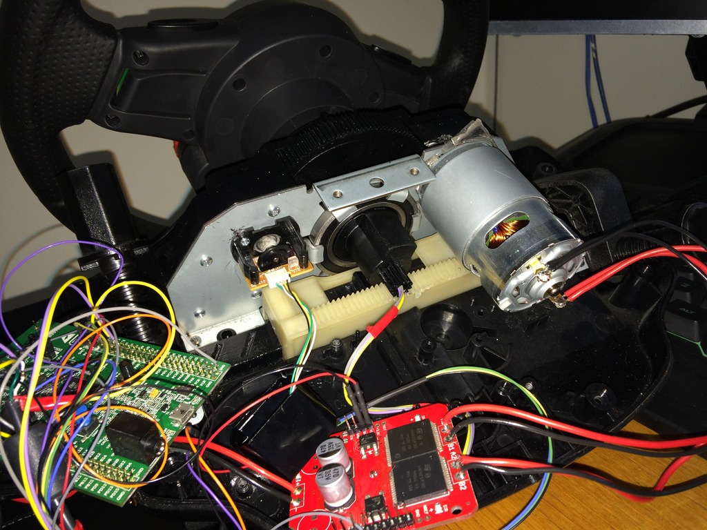

    Introducing my new project, the home build FFB wheel.
    What you see before you is my recently deceased Logitech DFGT (my fault) hacked up and now running MMosFFB USB wheel controller.
    Following this project:
    http://forum.virtualracing.org/showthread.php/92420-DIY-USB-Force-Feedback-Controller
    I decided on trying to build my own FFB wheel and ended up killing my logitech one trying to use the logitech board to control a larger motor with a more powerful H-Bridge. It kinda worked for a bit and then fried. After looking on the net for other projects I came across this one and decided to give it a stab. I'm glad that I did.
    Using the carcass of the DFGT I am able to retain the original optical encoder (60 pulse count, 780 per steering wheel revolution), motor, steering wheel and any other pedals and shifters.

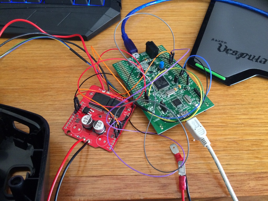

    The brains and the brawn
    The STM32F4DISCOVERY is the brains which controls the FFB PWM and direction of the motor. It can also receive inputs from 3 pedals and up to 16 other control buttons. The beauty of the device is that it is simple enough to set up a simple H bridge or a more complex VFD (argon) style servo motor. So like how I have used it, it is a cheap broken wheel fixer. ($20 for the controller and $7 for the MM).
    The software side of things comes from the link posted above. If you wish to use the software you must sign up to the website, as it is in German you will need to translate the signup page question field as the website translator does not translate that part.
    In the link it contains some pictures about how to connect the device, links to the programming tool and software that tunes the steering wheel and sets its parameters. In my next post I will go over the setup in more detail.
    The FFB feels just as good as the original DFGT only more powerful in some regards and a tad weaker in other areas. This is most likely due to me not really knowing how to tune FFB but I am sure I will get there.

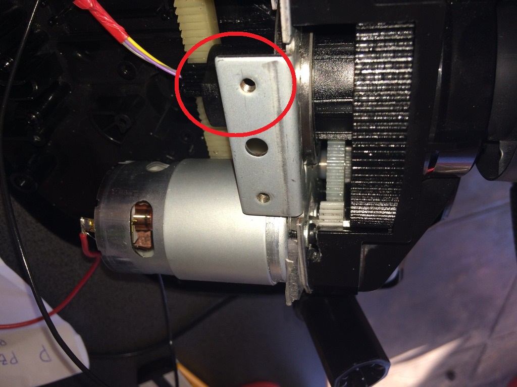

    May I introduce my DFGT BFM (Big F#*^n Motor)
    The new bad boy:
    57W, 57A stall current! This thing is now an absolute beast.
    http://www.jaycar.com.au/Electromechanical-Components/Mechatronics/Motors-&-Gearboxes/Standard-(High-Power)-D-C-Motors-9700-RPM/p/YM2776
    I was getting a bit impatient to start the full custom wheel so I decided to pop down to the local electronics store. In there I found quite a beast of a motor given its relatively small size.
    Of course the tinkerer inside me thought that I could shoehorn the motor in place of the DFGT motor. Boy did it only just fit! After spending most of the afternoon fitting the motor in
    I finally sat down and plugged the wheel in. I didn't bother going into the wheel tuning and just started a game to test out the power. Unknown to me the tuning software re set my wheel to 180 degrees rather than the 900 that it actually is so the steering was extremely sensitive in the game, when i hit the first curb and spun the car out over a curb (intentionally) the wheel just about tore itself from my hands, it was pants shittingly more powerful than I was expecting. Luckily the MM went into thermal shutdown for about 3 seconds which gave me enough time to rip the power cord from the DC supply. It's like a gorilla was fighting me for the steering wheel. After tuning the wheel and setting it's power as low as 30% I was able to give the wheel a few laps and get a feel for it. Boy oh boy is it great. Even at 30% the power is easily double that of the original DFGT motor.
    Unfortunately a few minor things to sort out now, the accelerator pedal isn't registering (think its the pedal side not the controller) and the paddle buttons are't registering on the controller (wiring side, think they need to be pulled high but I set them as pull down to ground). The data provided that I could find from the original project is quite limited and does not explain anything at all. So most of it I have to figure out via trial and error. Fortunately for you guys when I figure it out I shall provide a detailed setup guide, limited to using H-bridge PWM/DIR setup mode. There are a few other modes that can be set to use servomotors like MIGE but I don't have one of those so I cannot try it out :( .
    This is how I modified the DFGT.
    Standard mounting plate stripped bare, ready to modify.
    The original hole for the motor is not large enough to accommodate the new motor so it must be enlarged (17.4mm)
    I used a stepped drill bit attached to my cordless drill to enlarge the hole.
    It only just clears the bearing retainer:
    The mounting holes are almost the same but the larger motors holes are slightly further apart so I slotted the mounting plate holes to fit.
    Once the motor is mounted the original motor sprocket needs to be fitted. The DFGT used a D shape shaft on the motor which means the new motor
    needs to be modified to suit. The original shaft is 3mm and the new motor is 5mm. What I did to fit the gear was I used the mounting plate as a brace and clamped the brace to a bench.
    I then attached a grinder bit to my cordless drill then slowly, forcefully and evenly ground the shaft down to about 3.4mm.
    Then with the motor stationary I used a file to grind out the flat section for the D slot gear.
    I then had to make a spacer to go between the motor and mounting plate as the gear stuck too far out.
    Next up was soldering connections to the paddle shifter. The buttons share a common connection which is why there are only three wires.
    I then fed the wires through the wheel and connected them to the controller. I also connected the original DFGT pedals to the controller. Put it all back together and done!
    The new and the old

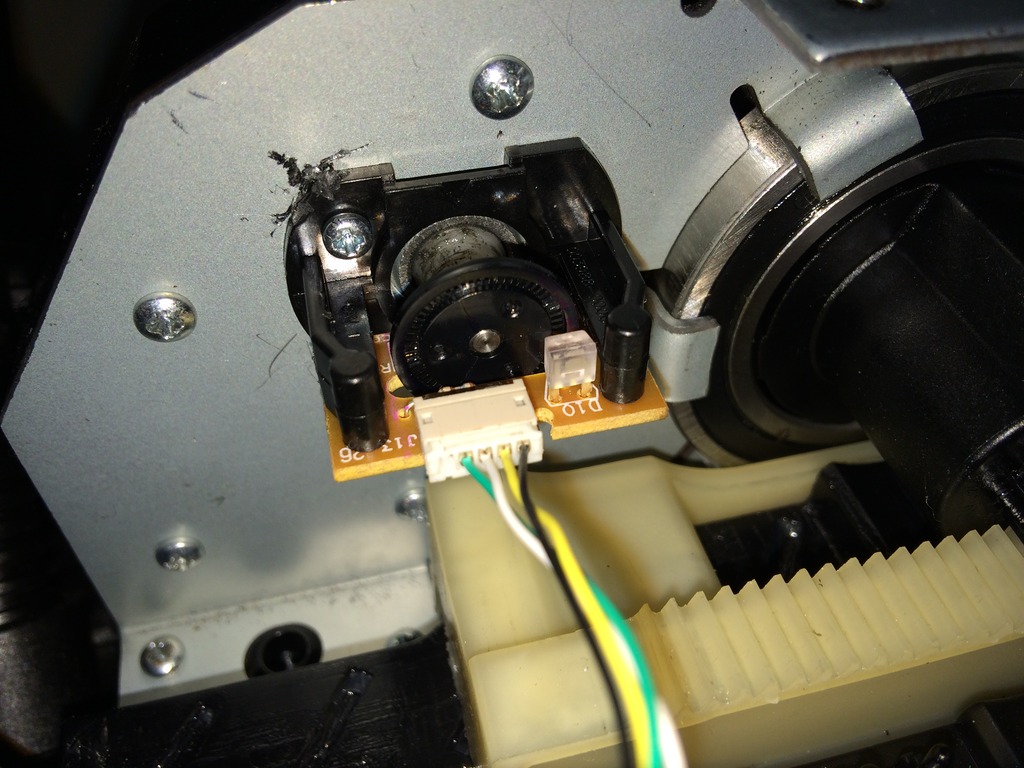

    Here is a better picture and a picture of the internals.
    The DFGT encoder is also a two phase encoder which is pretty much standard for any FFB wheel. I counted the slots to 60 slots per encoder revolution and 12 revolutions per steering wheel revolution bringing the encoder PPR to 720. I then traced the circuitry on the DFGT encoder and FFB controller board to determine the two phase channels and the power and GND pins. I plan to use an encoder almost identical to the one you provided a link to earlier.
