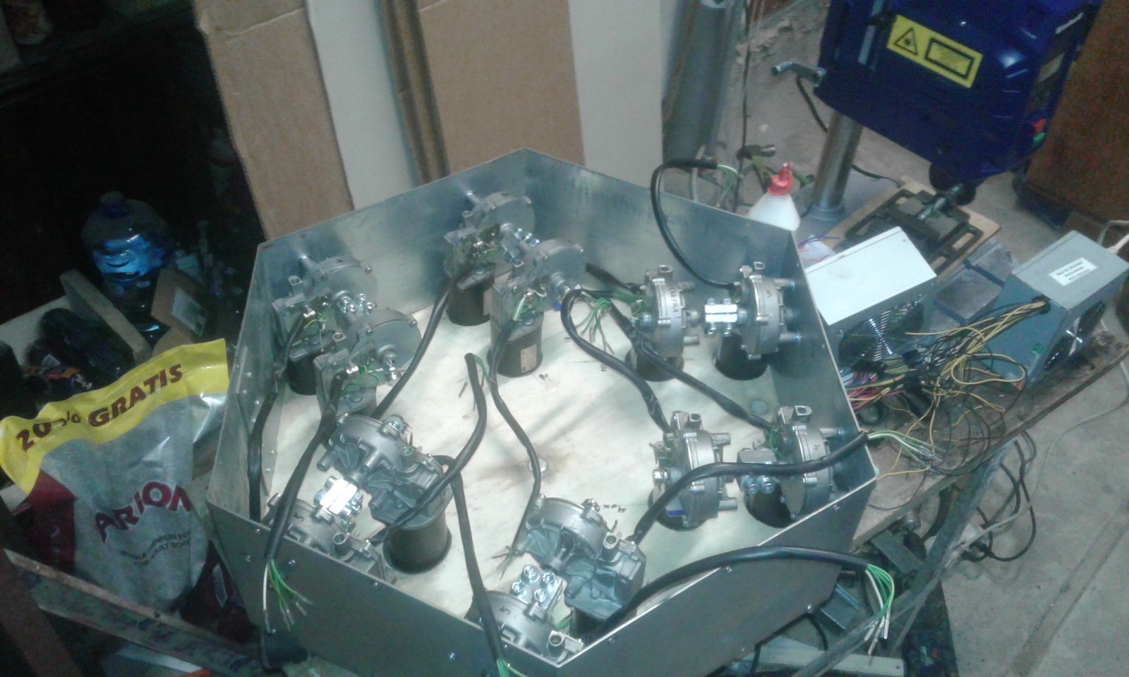

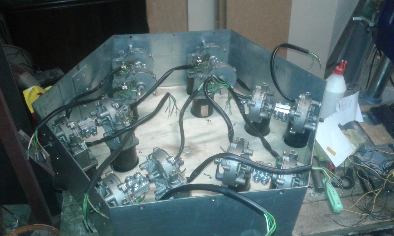

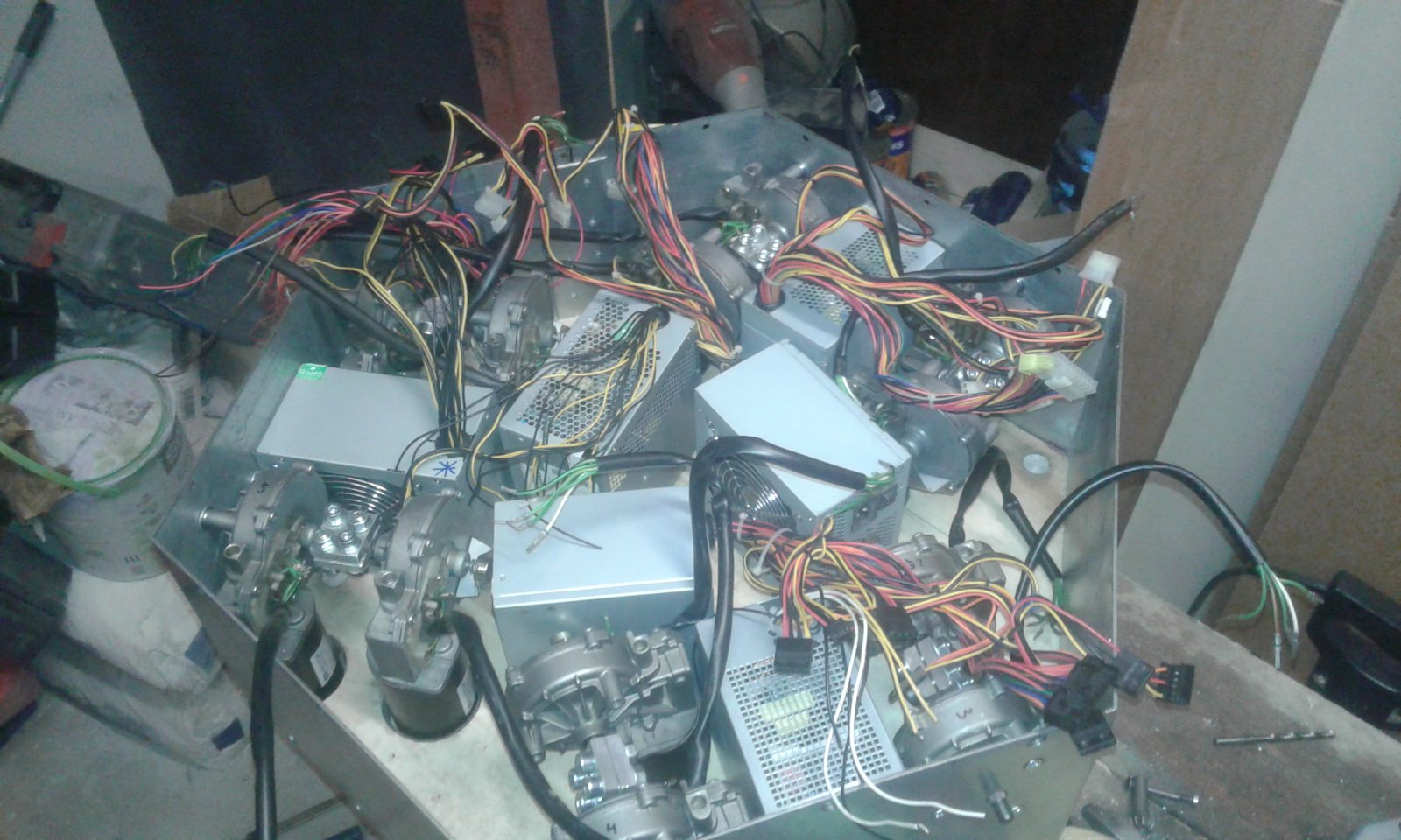

    Hi
    current state of construction
    more and more fears and a lot of doubt ...

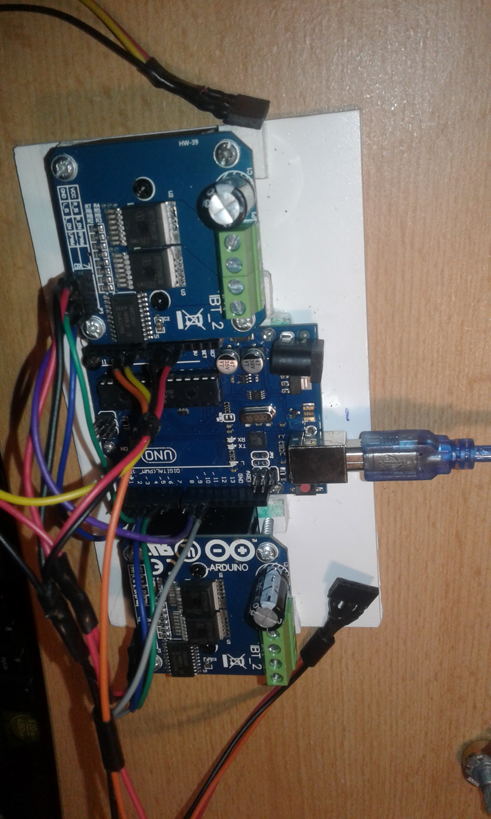

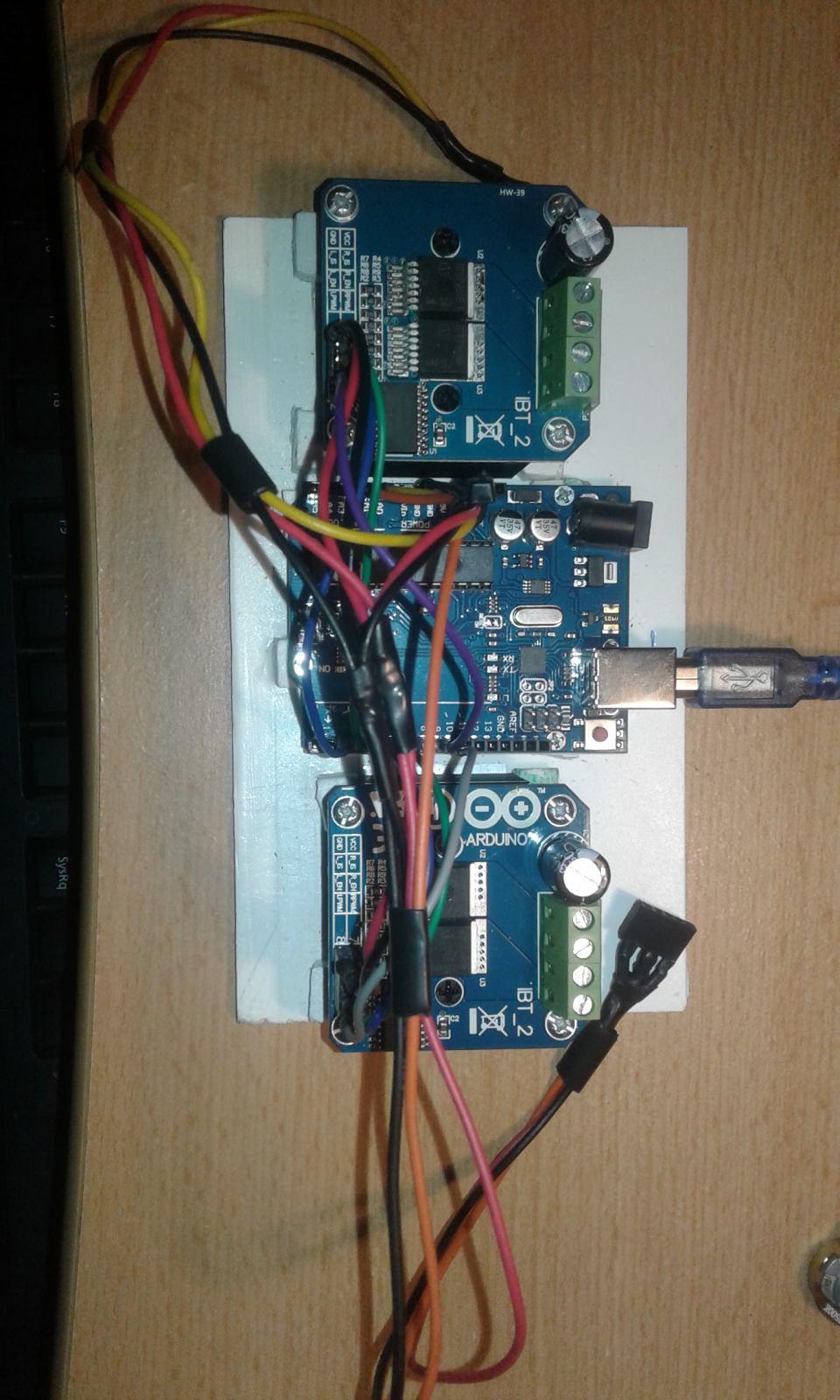

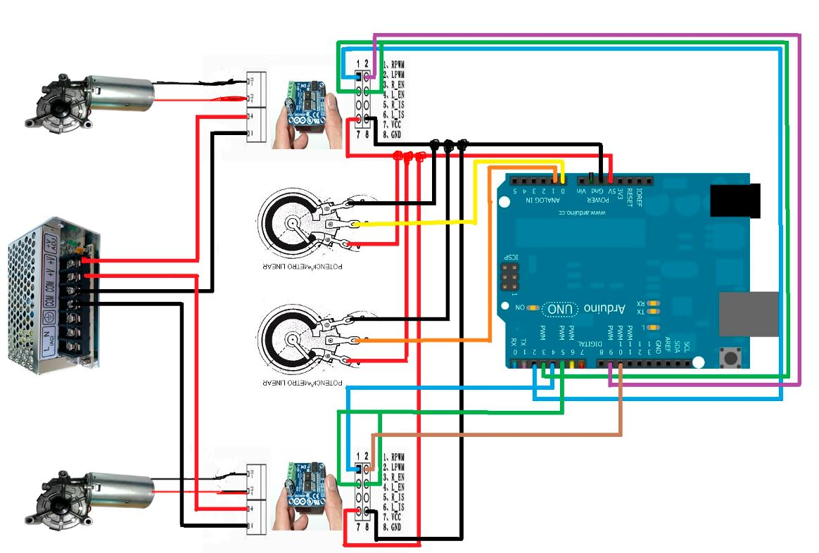

    system for operating 2 actuators
    I have to make 3 such arrangements

  6. tadeusz
    tadeusz New Member
    Nov 4, 2025
    34Coins
    according to the scheme
  7. RacingMat
    2,233
    21,082Coins
    hi!
    A threaded pot directly into the motor shaft, looks quite dangerous...
    During the setup phase, you will have to wire the pots (red and black wires) accordingly to motor rotation (red and black wires), if wrong : the pot will break...
    During the testing phase, many things could go wrong (code, wiring...) and break the pot...
    I'd strongly advise you to use a coupling between pot and shaft.
    have a look there https://www.xsimulator.net/community/threads/from-atoz-2dof-arduino-wiper-playseat.4616/#post-45420
    and there is a flat part against the pot to prevent its rotation ;)
    yours

    Hi
    Thank you RacingMat for the hint
    I know that I can not make a mistake with the electrical connection (polarity) of the potentiometer because I will damage it immediately.
    In the future I want to use Hal's potentiometers.
    greetings

    Friends I have a question :sos
    Which cables should be shielded?
    Is it enough to shield only potentiometer cables?
    Should the cable shield be connected to ground?
    best regards
