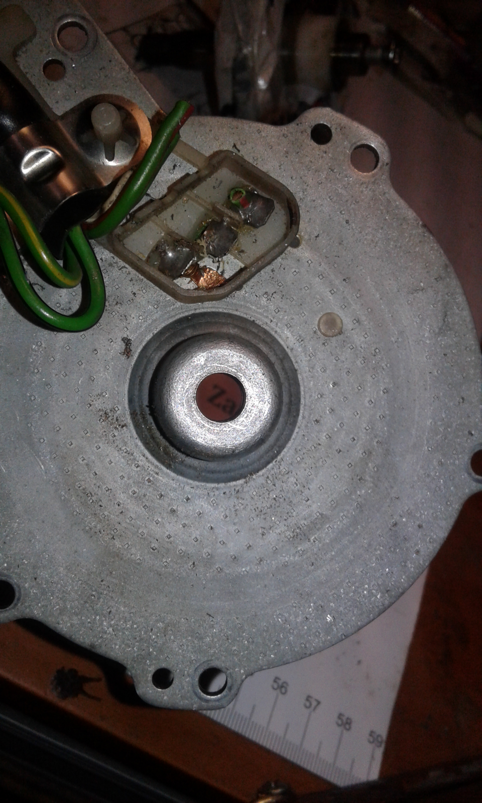

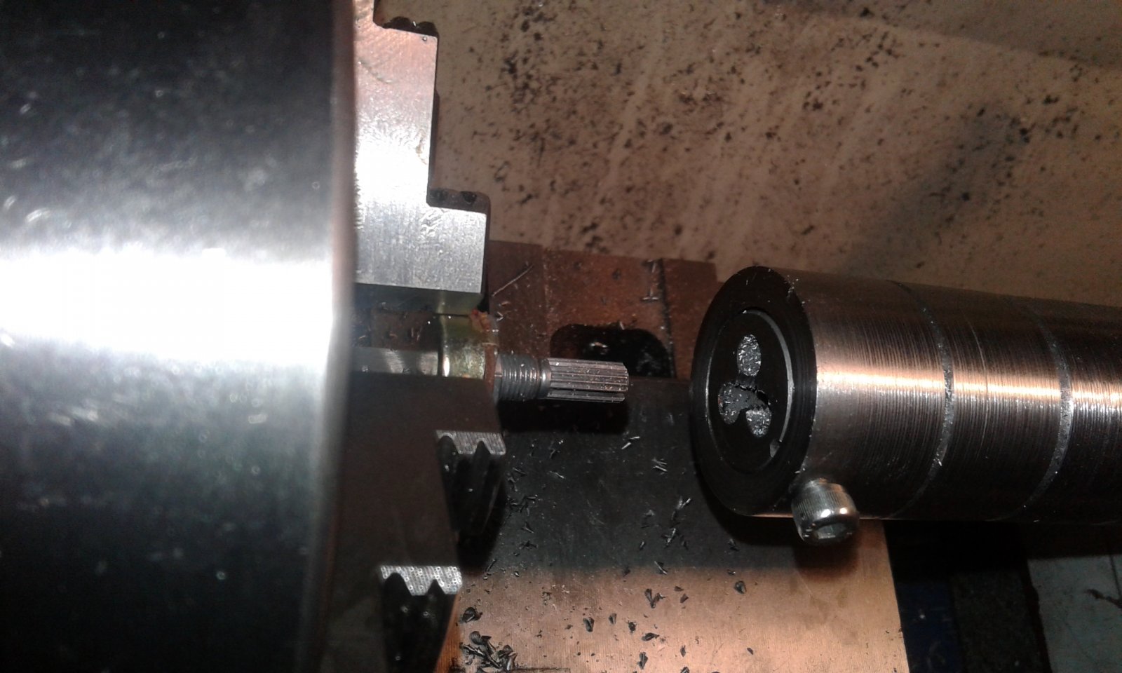

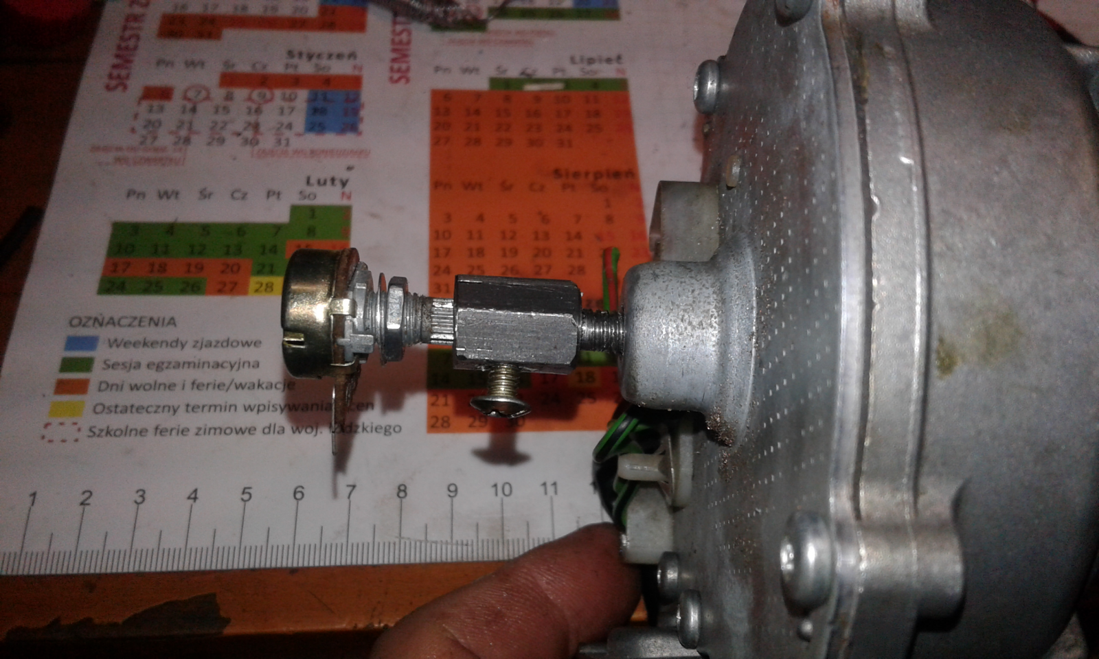

    threaded hole ready for mounting a potentiometer
  2. tadeusz
    tadeusz New Member
    Nov 4, 2025
    34Coins

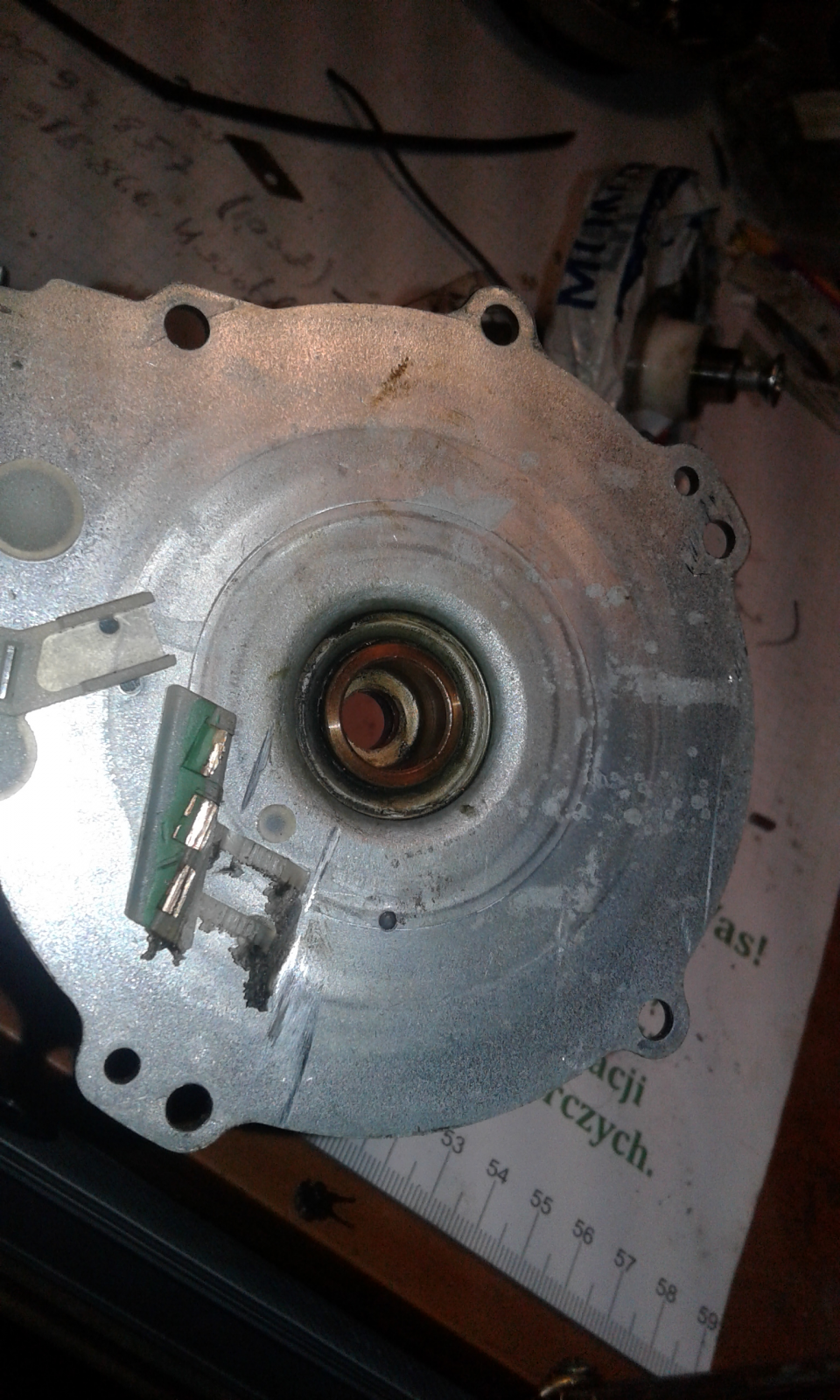

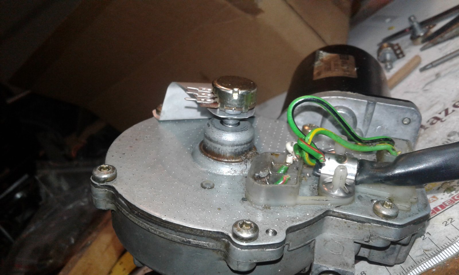

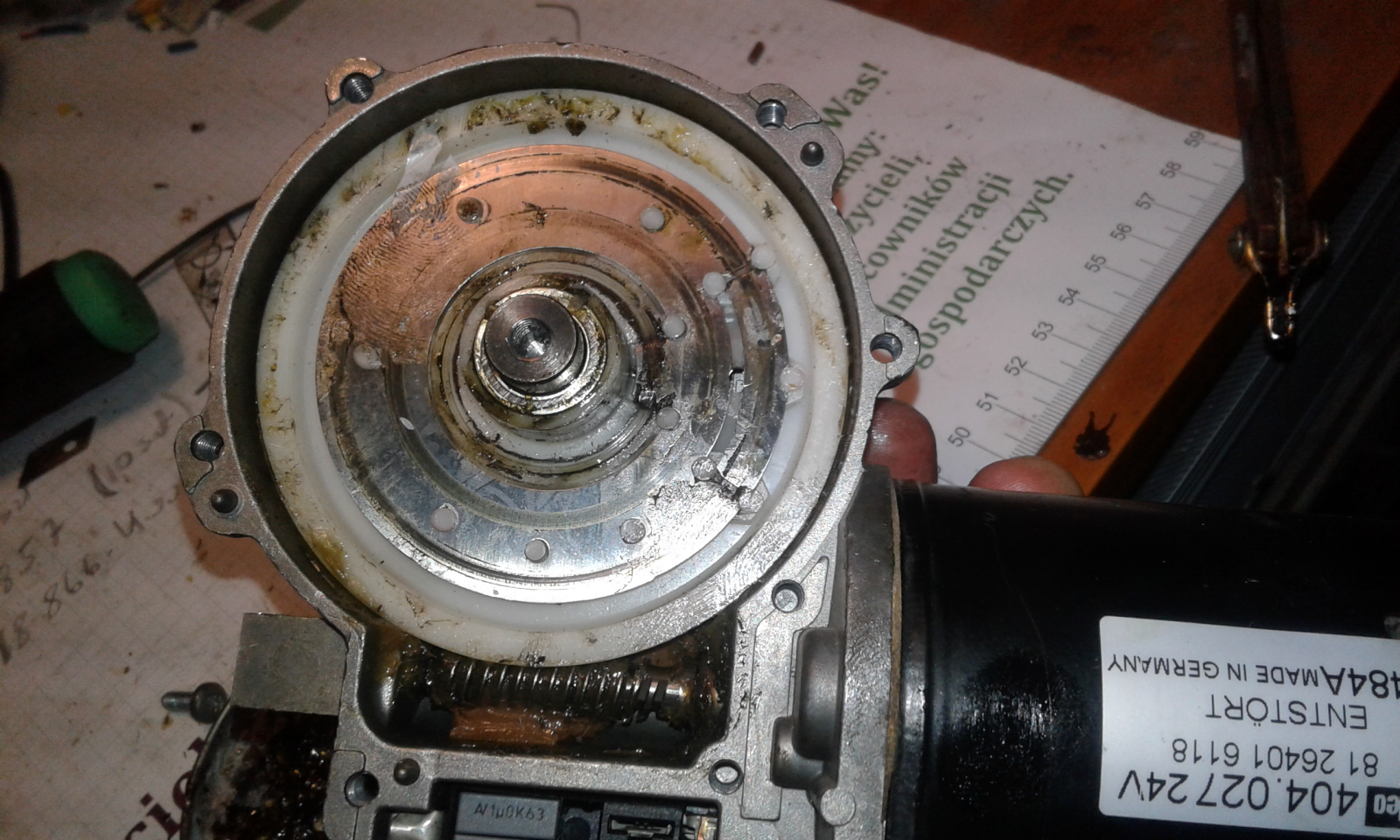

    Gear assembly
    you need to drill a hole in the gear housing
    upload_2021-10-28_21-58-0.png upload_2021-10-28_21-58-32.png upload_2021-10-28_21-57-27.png

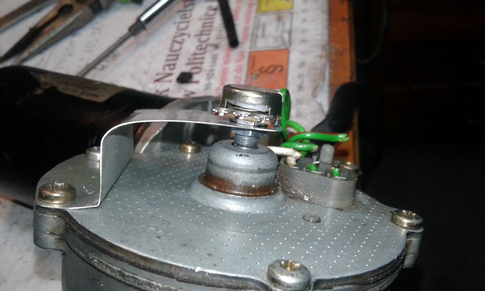

  3. tadeusz
    tadeusz New Member
    Nov 4, 2025
    34Coins

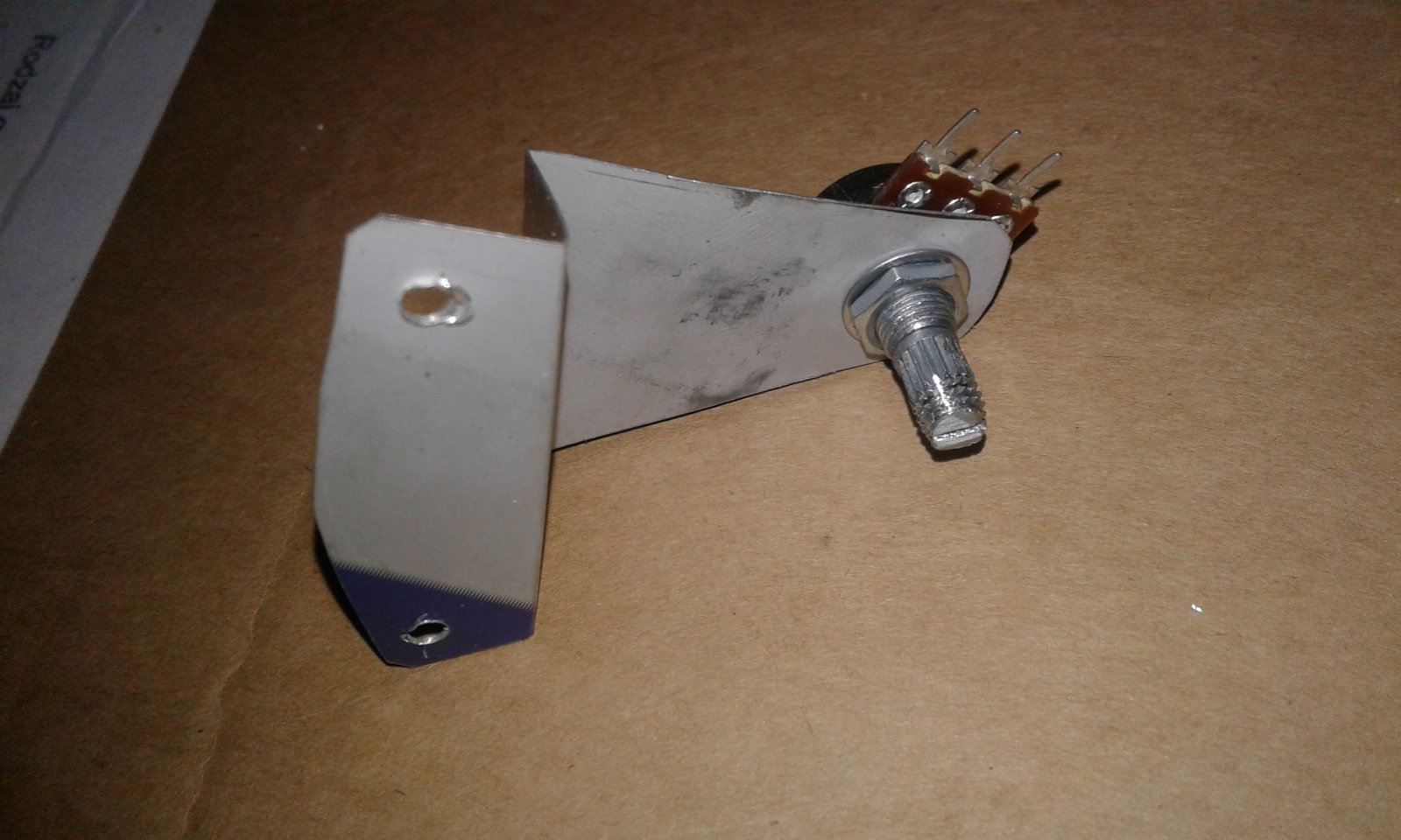

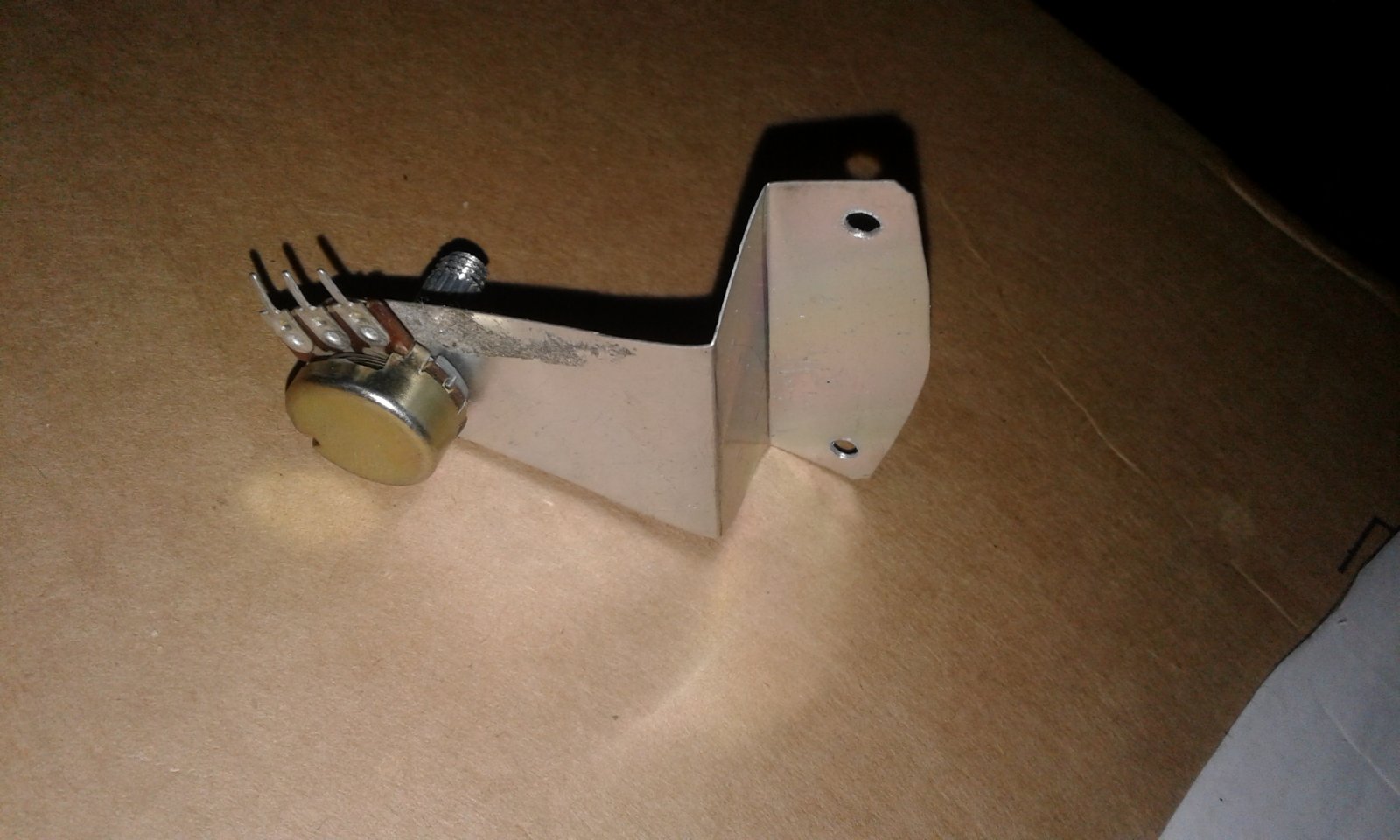

    holder for the axis of the potentiometer

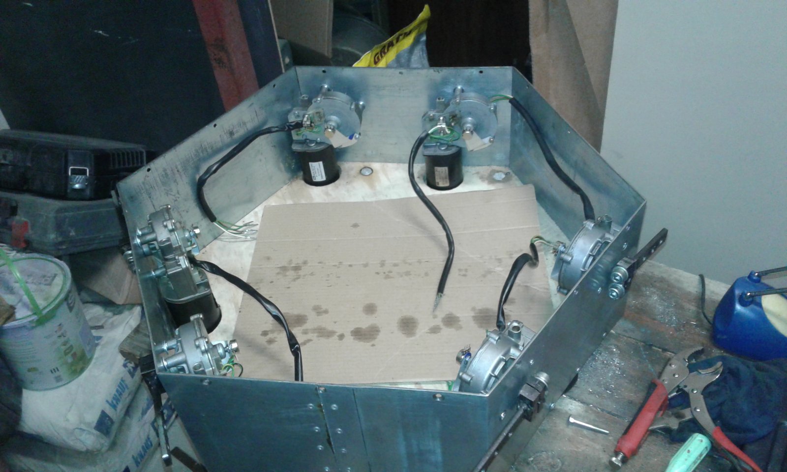

  4. tadeusz
    tadeusz New Member
    Nov 4, 2025
    34Coins
    view of the whole

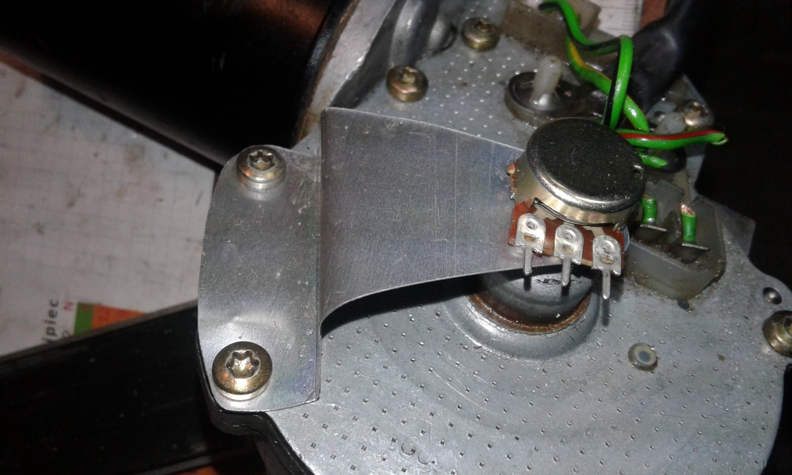

  5. tadeusz
    tadeusz New Member
    Nov 4, 2025
    34Coins

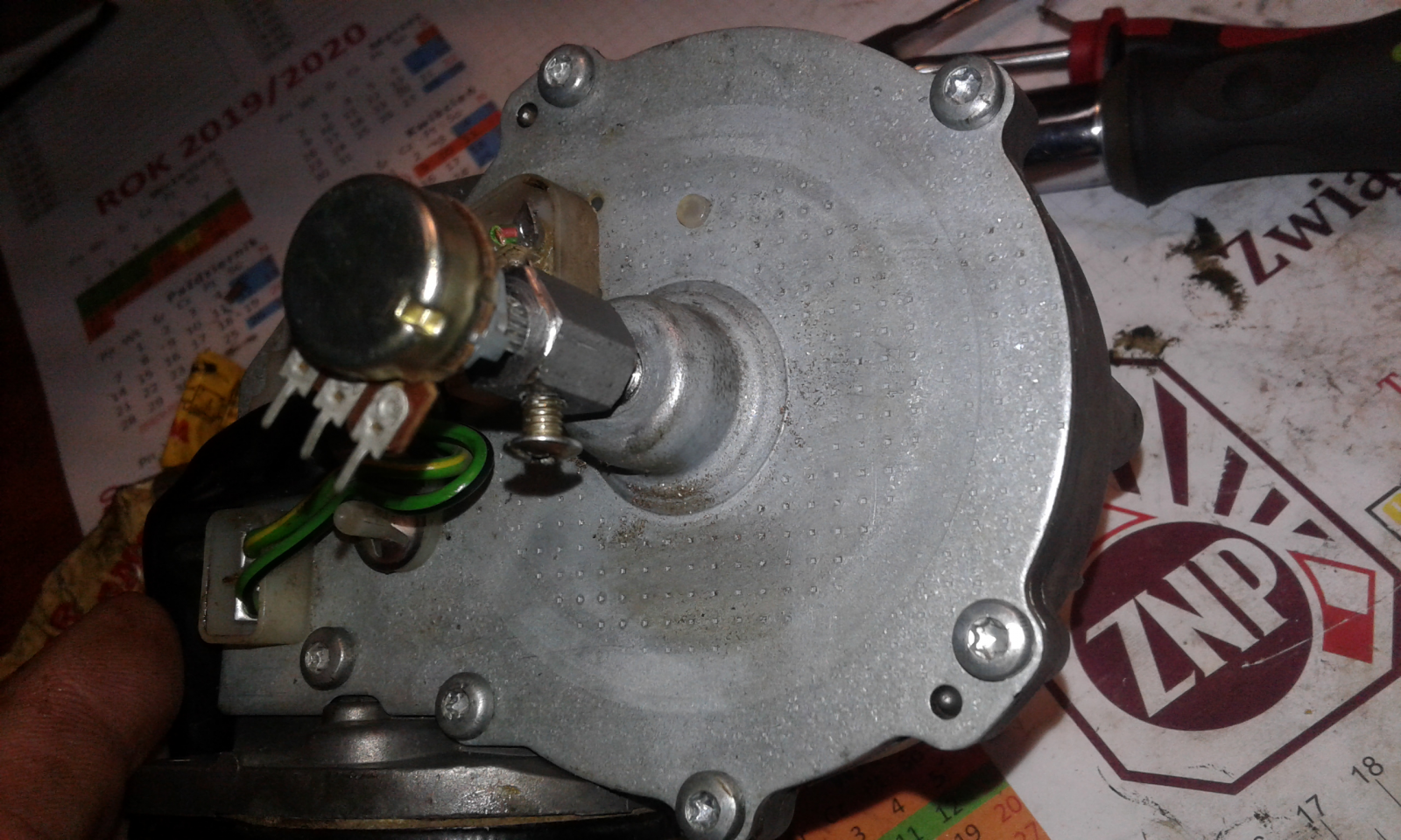

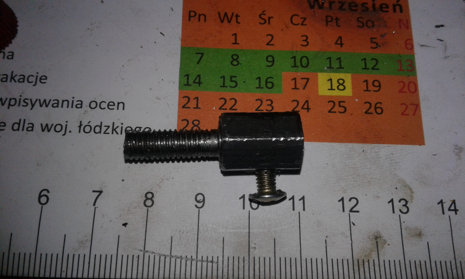

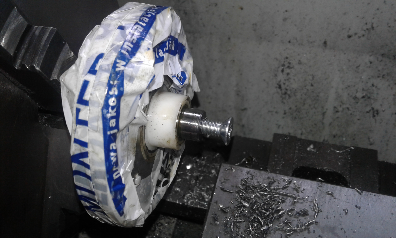

    potentiometer threading

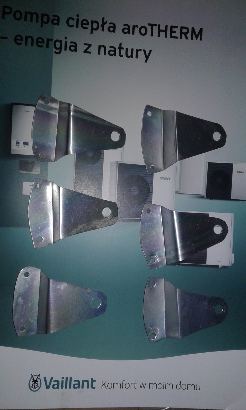

  6. tadeusz
    tadeusz New Member
    Nov 4, 2025
    34Coins

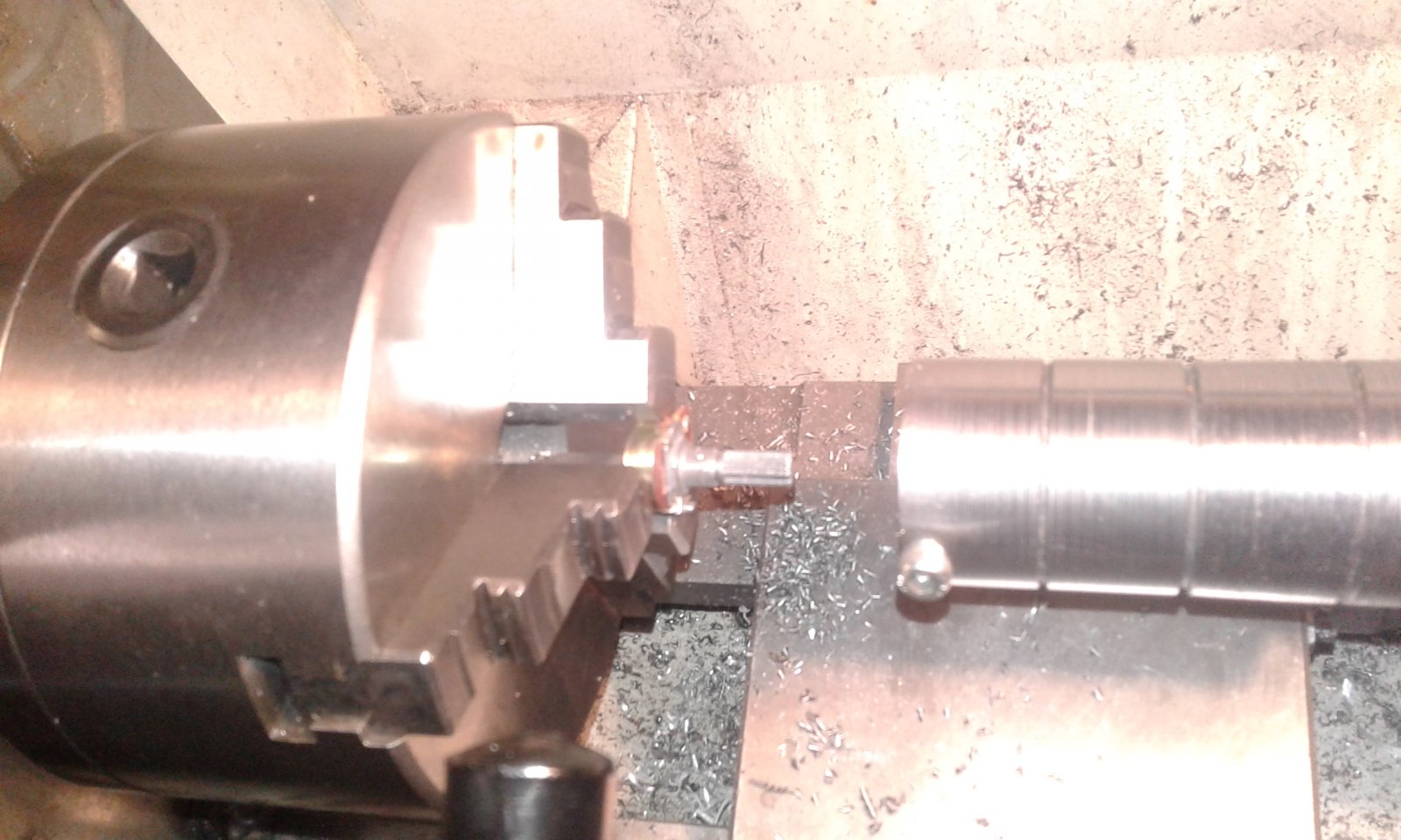

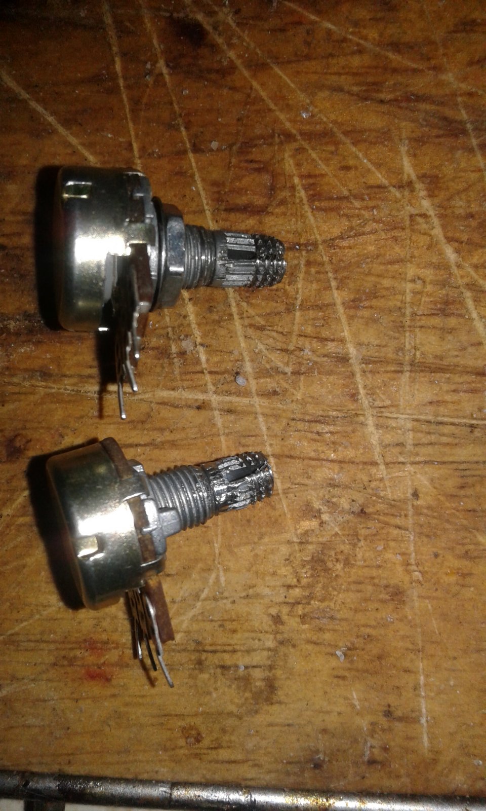

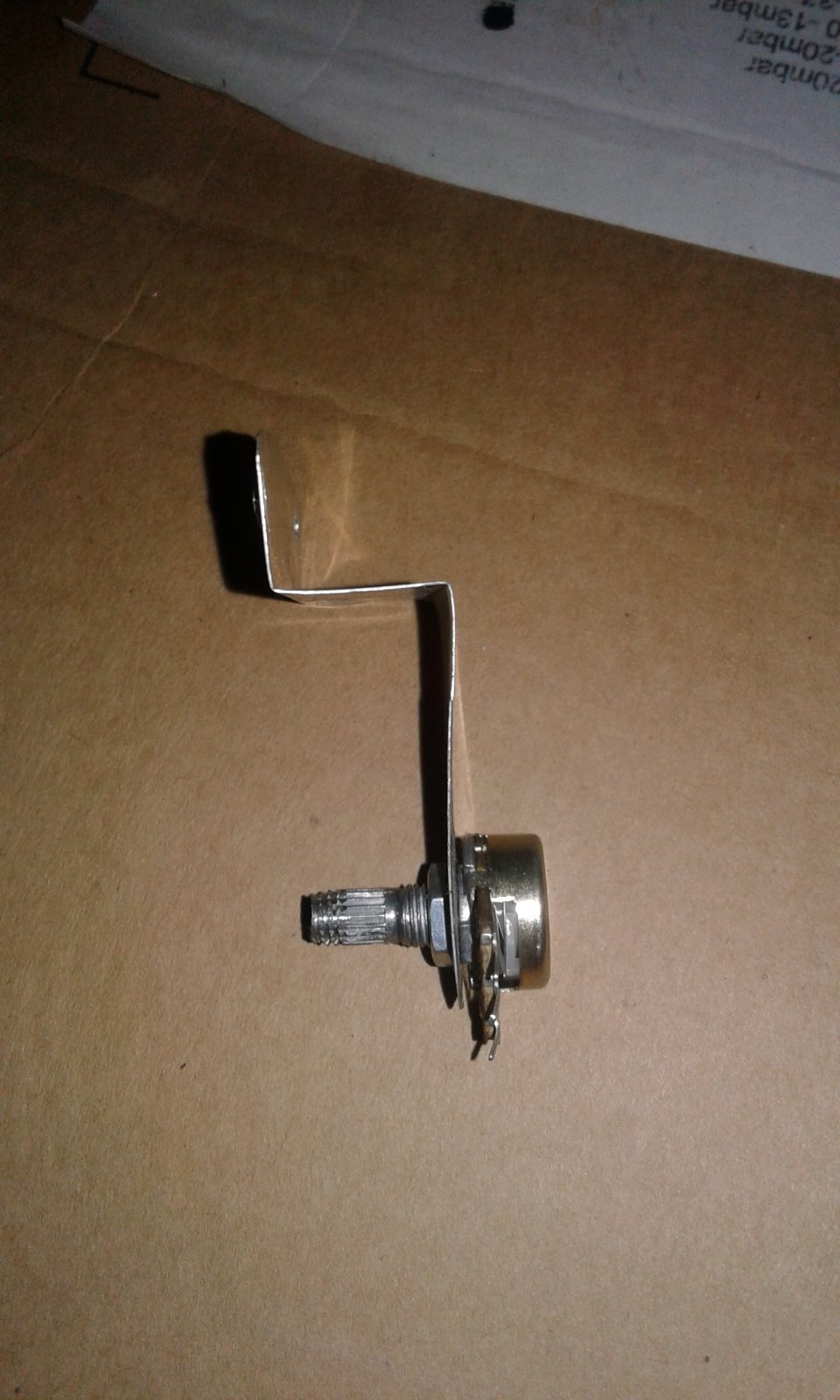

    potentiometer handle

    +11,154 / 57 / -2
    Nice work :thumbs
    Have you tested and determined the load caring capacity?
  12. tadeusz
    tadeusz New Member
    Nov 4, 2025
    34Coins
    Hi
    Thank you for your interest Noorbeast.
    I made the measurements myself for 1 wippermotor,
    I got :
    arm 11 cm
    force : 10 kg,
    first
    I want to check the operation on single motors,
    next
    check the operation on double motors,
    et the end put springs
    best regards
