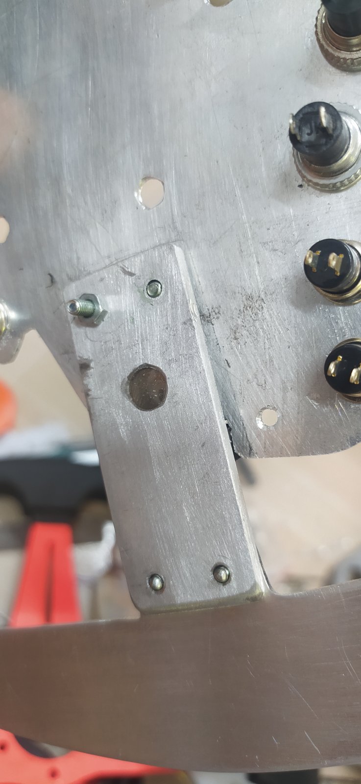

    Step by Step :
    1. accessory:

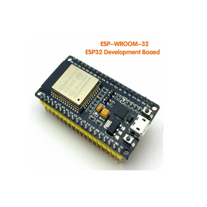

    - 01 Esp 32 board ( cost only 4 USD with clone board in VietNam)
    - 12 press button , 02 limit switch (for pad shifter)
    - Some aluminum sheet
    - 04 magnet (to keep the pad from wobbling)
    - 01 Mini power bank (01 cell batery 18650 ) output 5v ( cost 2 USD)

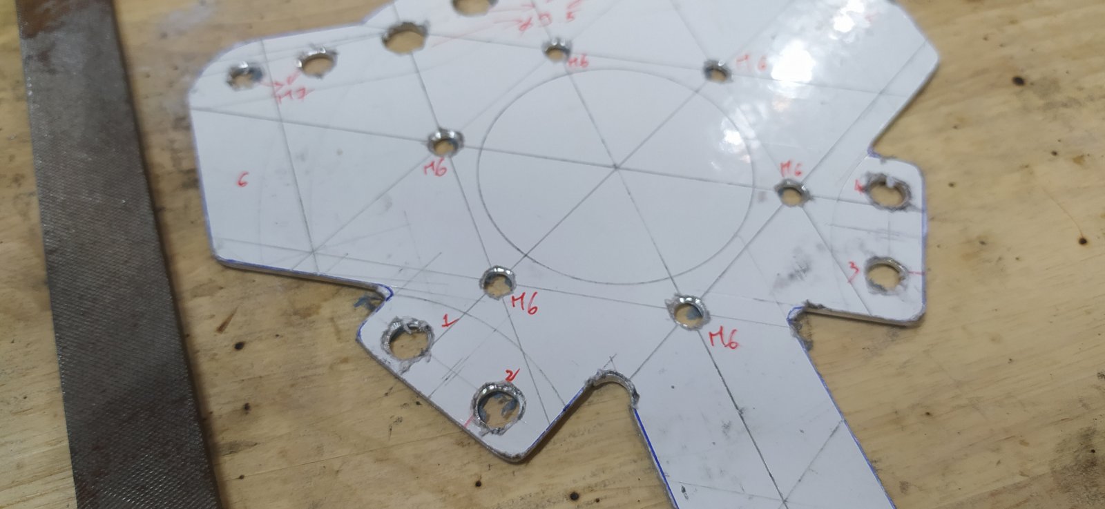

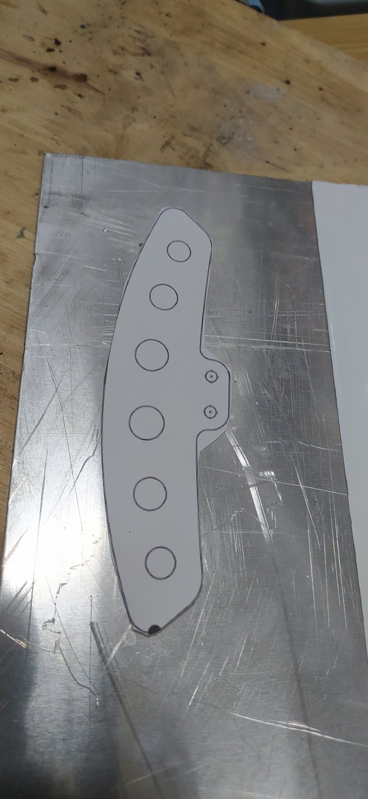

    2. conduct:

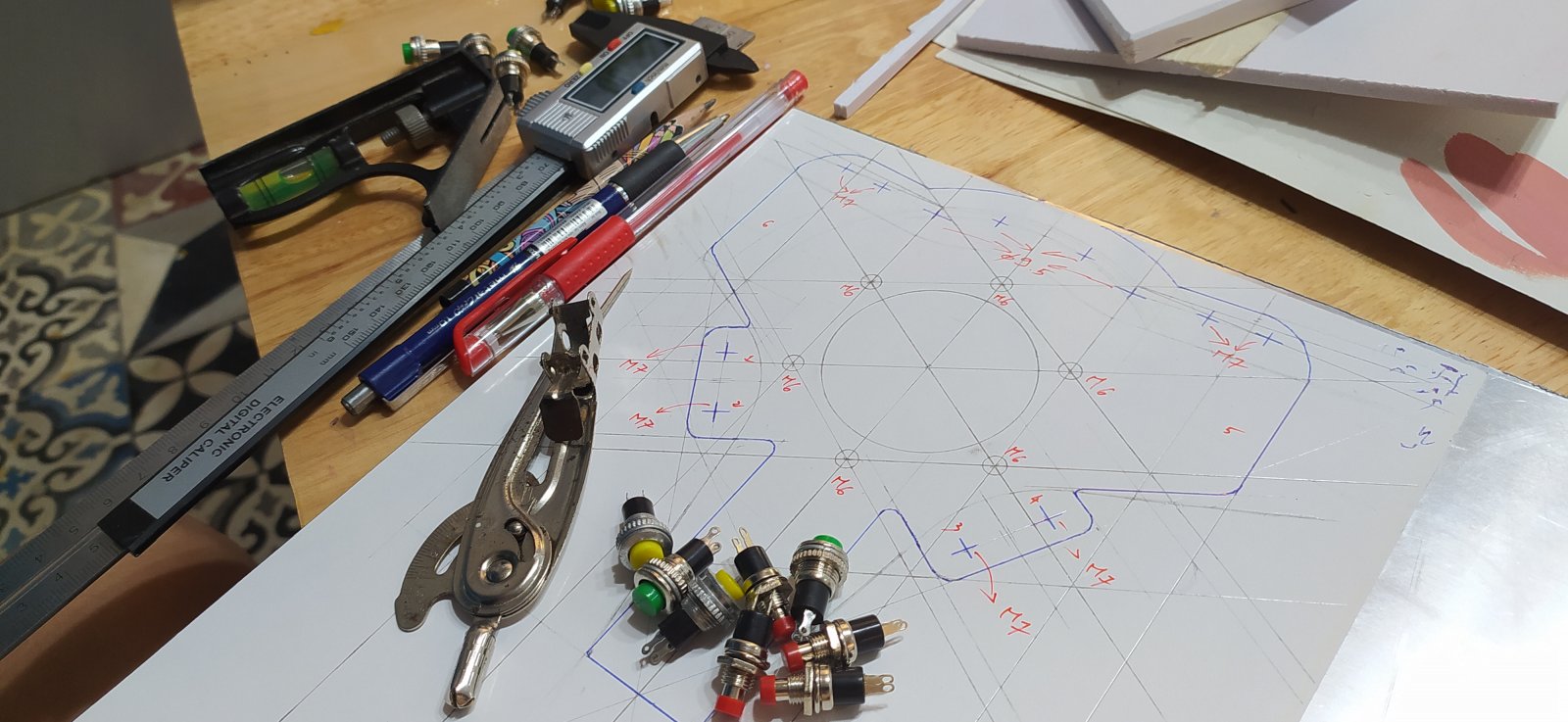

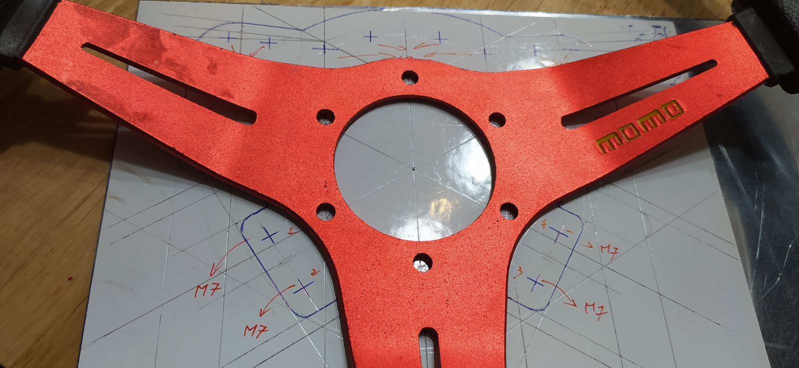

    draw:

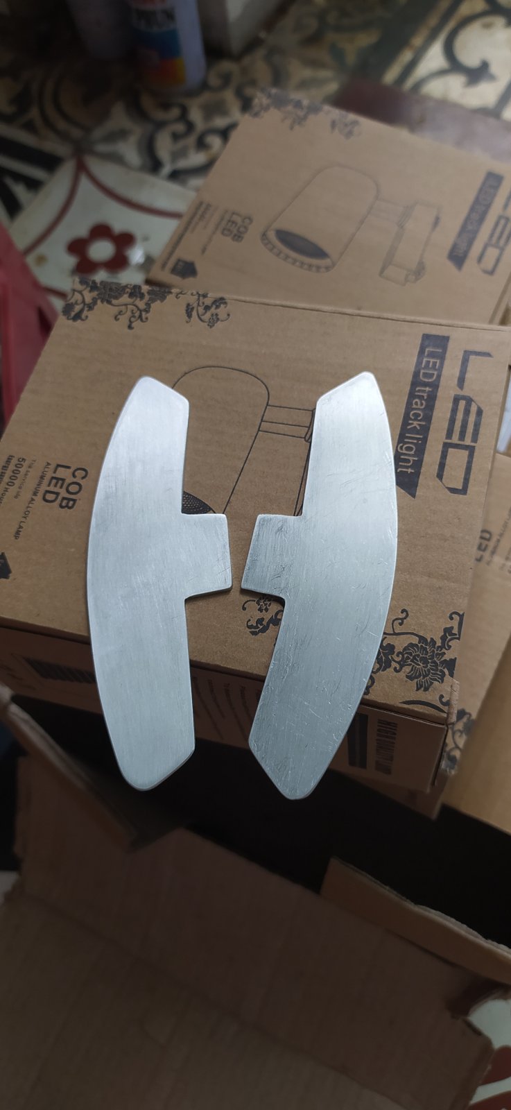

    Cut and drill:

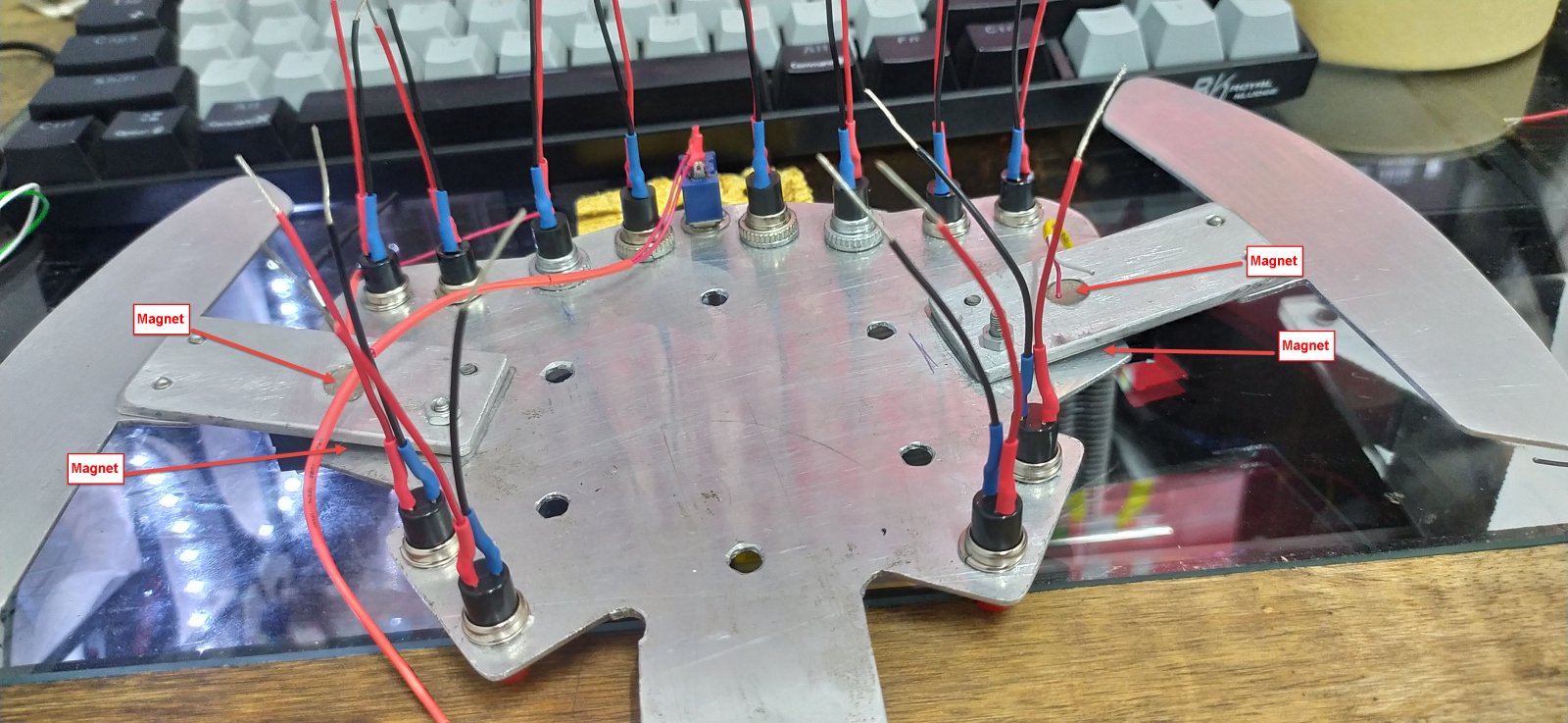

    grinding , weld , connect pad shifter:
    use magnet under pad (push each other)

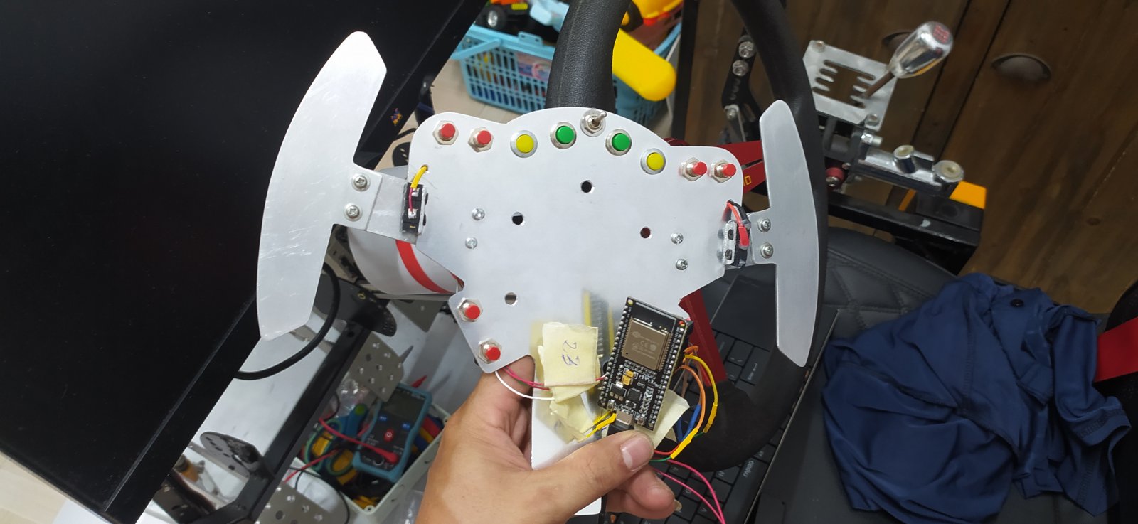

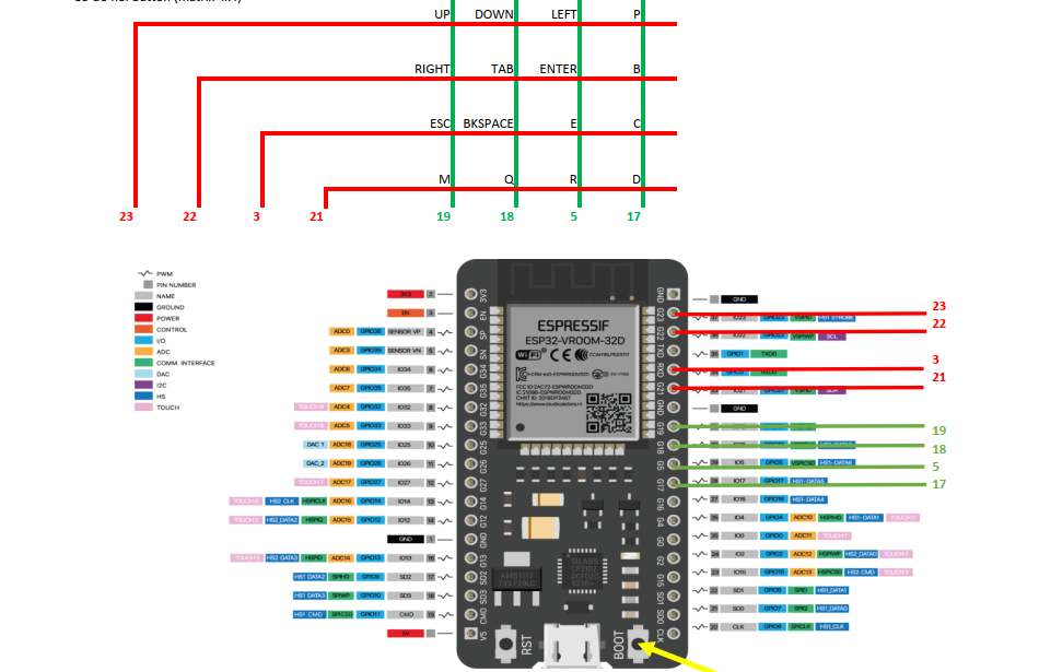

    Wiring and code :
    it use matrix button 4x4 :
    Code and library attached (ESP 32.rar)
    Note: you need install 2 library for Arduino IDE before upload code to Esp 32. If upload error, you need put and hold BOOT button on ESP 32 while uploading
