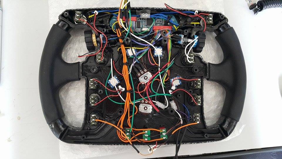

    well.. this project, its exaclty the same i use on 2012, for physical changes on my f1 add for t500rs. works perfect, but wires between platform and wheel still a great problem... some idea how to wirelless project??
  2. paulopsx2
    paulopsx2 Active Member
    Apr 2, 2016
    613
    brasil
    616Coins
    +163 / 2 / -0
    some pics how to
