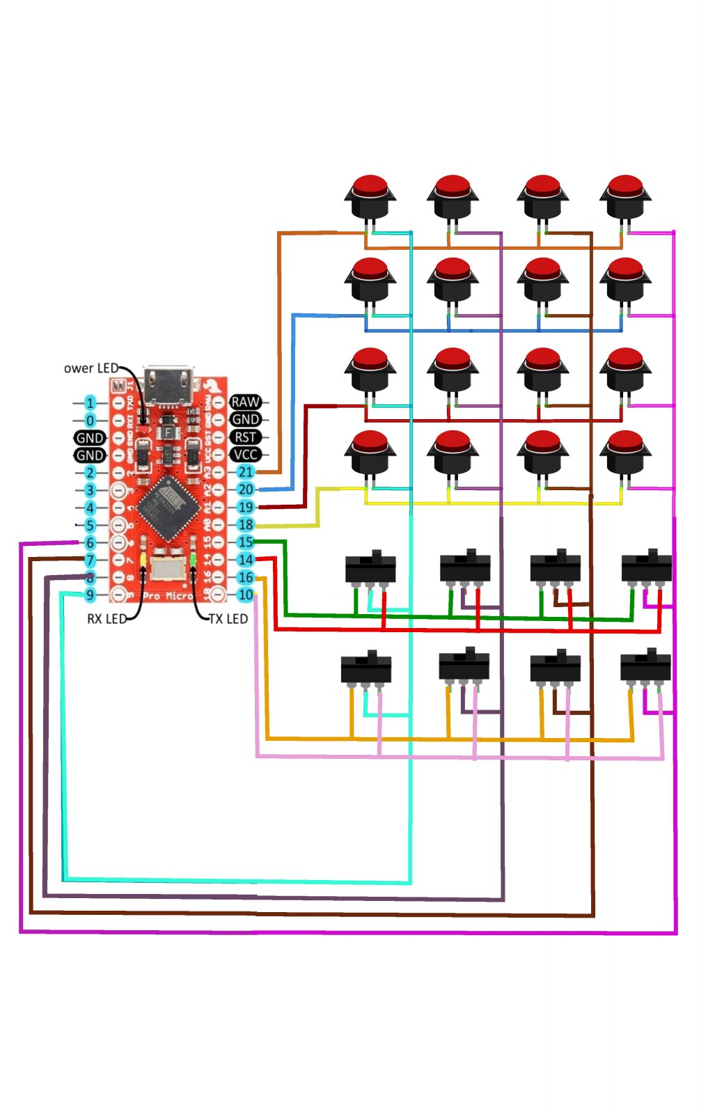

  5. JonBakhol
    JonBakhol Active Member
    Mar 16, 2018
    107
    Netherlands harderwijk
    443Coins
    +46 / 1 / -0
    Hi @tutoveenee ,
    I understand your prob. We all begin somewhere.
    Take a look at my fritzing a few post above. (Here) On right side there are all buttons.
    A simple matrix, (for maybe an Arduino, or some other PCB's who can handle this.) it's easy to program.
    If I understand clearly, you only want buttons.
    Up-Down-Left-Right-Rotating-Always on-Always off. In the end they are all buttons. (I think, kill me if not)
    You can upload my sketch to a Arduino Pro Micro, and only connect the buttons to the right Number on the pro micro.
    My help in the beginning was Amstudio on YouTube. Watch the buttonbox stuff. It will take you by the hand to get your project done.
    Good Luck.
    Ride on
    Bakhol
  6. tutoveenee
    tutoveenee New Member
    May 1, 2020
    9
    51Coins
    I have no other words than thanks. With your simple answer you have done more than many forums, in which I have asked. Many places where I have asked. And in the blink of an eye I already have an answer. Simply thanks. I also started with AMstudios, I have followed that project and now I use that base. I have working the 16 momentary buttons. But my problem is that I don't know how to wire the switches. Since I want each of the two positions of the switch to correspond to a button. And so have the 8 switch x2 the 16 buttons that would be missing. More components appear in your sketch that I don't need. And really, I appreciate your help.
  7. JonBakhol
    Mar 16, 2018
    107
    443Coins
    +46 / 1 / -0
    @tutoveenee
    Hi Again.
    I think you already answered your own question.
    Like you mentioned the switch is like 2 buttons in 1.
    So treat the switch as there are 2 buttons.
    You have to make an matrix of 4x8 (= 32 buttons).
    And most likely the switch has 3 connection on the underside.
    Button 1 (of the switch) is one outside plus middle. Button 2 of the switch is the other outside and the middle.
    I find it convenient to draw the matrix and number the buttons. It will make the soldering also a lot easier, because in the end it is like a bowl of spaghetti, and then the drawing will give you some thing to hold on to.
    Please feel free to ask if you are stuck
    Succes
    Ride on
    Bakhol

    @tutoveenee
    Please take a look at attached drawing (matrix 4x8).
    As you can see the switches are made of two buttons.

  14. JonBakhol
    Mar 16, 2018
    107
    443Coins
    +46 / 1 / -0
    @tutoveenee,
    Sorry I adjust my drawing to your switches. Please take a look again
  15. tutoveenee
    May 1, 2020
    9
    51Coins
    Well, as clear as water. Thank you very much and many times more. Already resolved the doubt. Now I want to think that with this sketch. And of all the arduino codes, that I can see in the Post, some in particular, for this sketch to work?

    @tutoveenee
    I would try this code:
    There is a part for encoders. But just ignore that. When not used, it doesn't matter that it is in there.
    Only the red part is for your buttons
    byte buttons[NUMROWS][NUMCOLS] = {
    {0,1,2,3},
    {4,5,6,7},
    {8,9,10,11},
    {12,13,14,15},
    {16,17,18,19},
    {20,21,22,23},
    {24,25,26,27},
    {28,29,30,31},
    and
    byte rowPins[NUMROWS] = {21,20,19,18,15,14,16,10};
    byte colPins[NUMCOLS] = {9,8,7,6};
    Solder the wires and upload the whole sketch to your arduino pro micro.
    I think it will work

    @tutoveenee
    I tried it at this point with an pro micro and an paperclip. I got all 32 buttons working
    Ride on
    Bakhol
