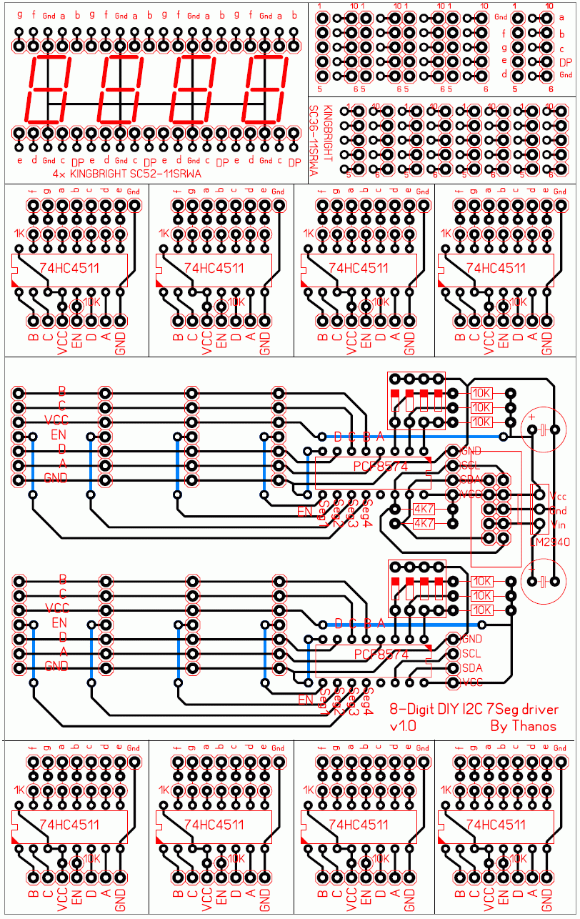

    Some progress I made by designing a simple layout for the 7segment digits drivers. As you can see the circuit consists of two I2C slaves and several smaller boards that hosts the LED drivers in stacks!!!! You cannot possible imagine how all this fit together unless you see it constructed! I could not find myself an easier way to avoid extra miles of cabling!!!! :lol:
    Thanos_I2C_7SEG_display_full_100x160.pdf
    I'll try to make a double-sided version of it to avoid more cables running around...
    Regards, Thanos

    Hey thanos what about the schematic or circuit board for the Gauges bcd displays?
    thanks
  10. tronicgr
    tronicgr
    I had to push back this project for a while. Will make it available some time. Just have to put together all pieces!
