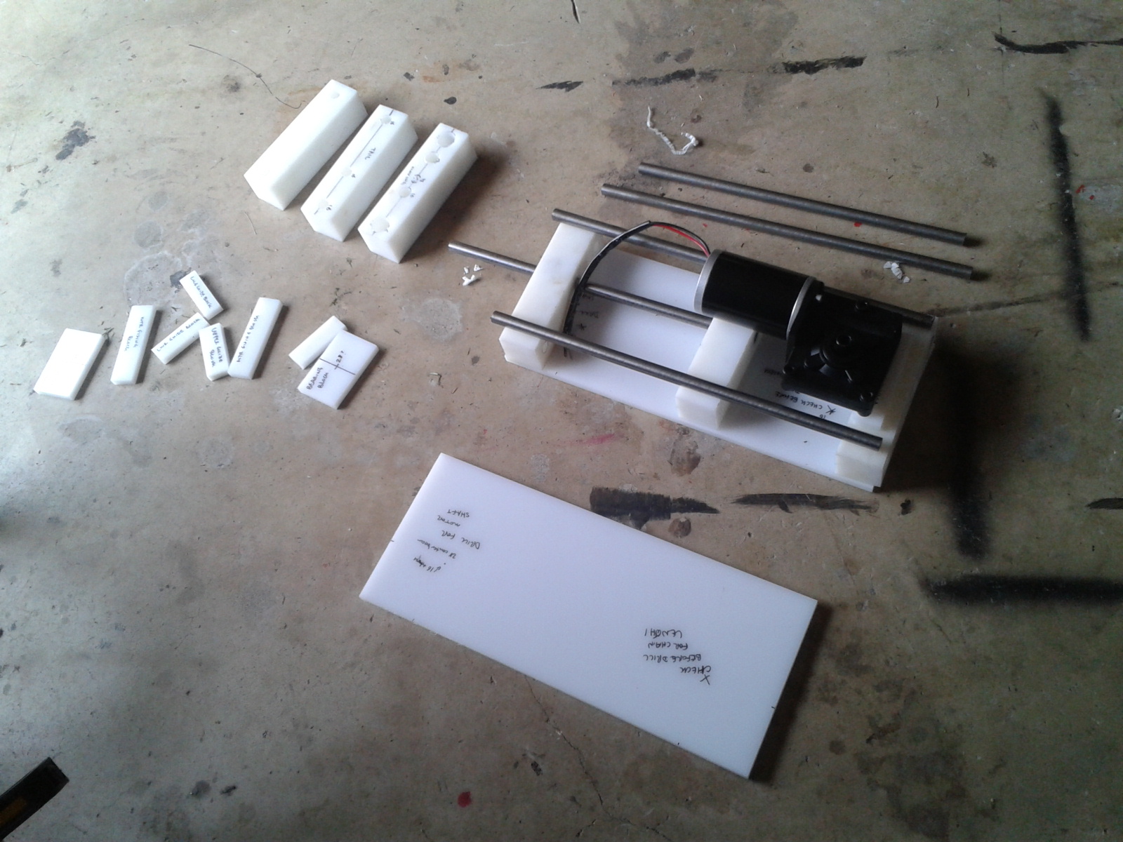

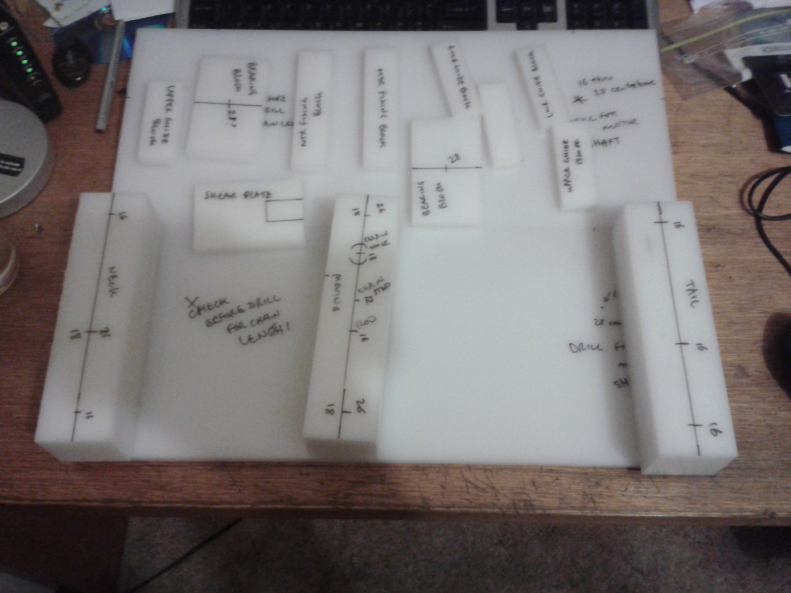

    Here are the start of the photos and pics of the DIY actuators that I PAID for the plans,and I have shortened the throw with advices from @eaorobbie
    2014-03-02 20.34.59.jpg 2014-03-02 20.35.11.jpg 2014-03-06 11.30.27.jpg 2014-03-06 11.30.43.jpg
    The plans are to be bought from here http://bffsimulation.com/linear-act.php , do the right thing like I did and SPEND the money to pay for the plans.
    Then with Robs help we worked out a 200mm throw long unit. and we widened it to 200mm wide, to help overcome our OCD.
    I am using industrial plastic from here http://www.cuttosize.com.au/ , its a HDPE type plastic as it looks to be as strong as aluminium , but a lot less the cost. Mind you, all bits cost me $300 to get done.
    I am using 12mm thick sides and 50mm thick blocks.
    I can drill them out with a drill press and wood boring bits, do that makes it easier.
    I got the list of bearings , chains, sprockets from a local bearing place, cost me $150 for 2 units.
    The motors to be uses are the famous http://www.motiondynamics.com.au/worm-drive-motor-12v-24v-200w-180-rpm-20nm-torque.html
    The bright mild steel shaft I bought cut to size from a local steel shop. $40
    They will have 200mm throw and should move at about 300mm per second.
    They will use a 3 turn pot for feedback on the chain setup. The chain is being used to move the centre block. I havent got that far yet.
    I will use the famous JRK on them, but as they are 12v motors with a pot, you could use any control board.
    The should work out at about $400 each less JRK, still not cheap, but they should move 50 kg and still have 200-300mm per second travel. I will test it in time once I get closer to completion. They may not be strong enough for full lift, so I will stick them on a balanced frame. Although 6 could do a 6 DOF frame.

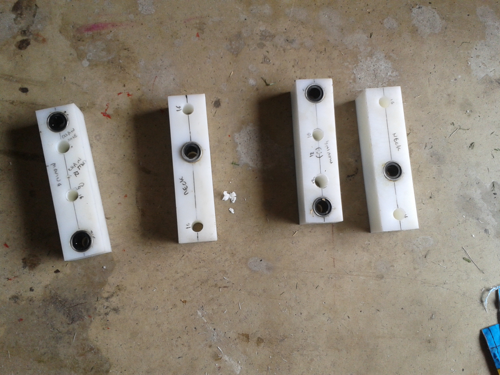

  13. bsft
    I got the neck and moving blocks holes drilled out and press fitted the bearings (press fit BSFT style - piece of 4 x 2 , large hammer, lots of select words)
    Next will be to start drilling out for the motors to mount on and work out where the boss gears and chain will be set up

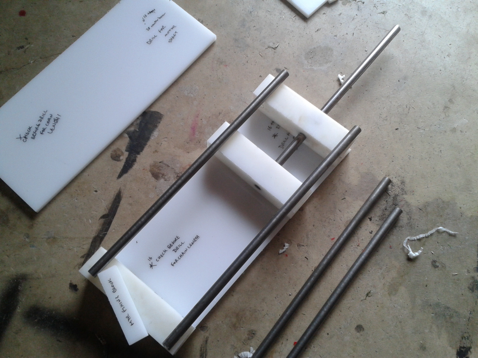

  18. bsft
    I finished drilling out the ends of the rods and tapping thread so now to start putting one together to see how bad my construction and alignment is .

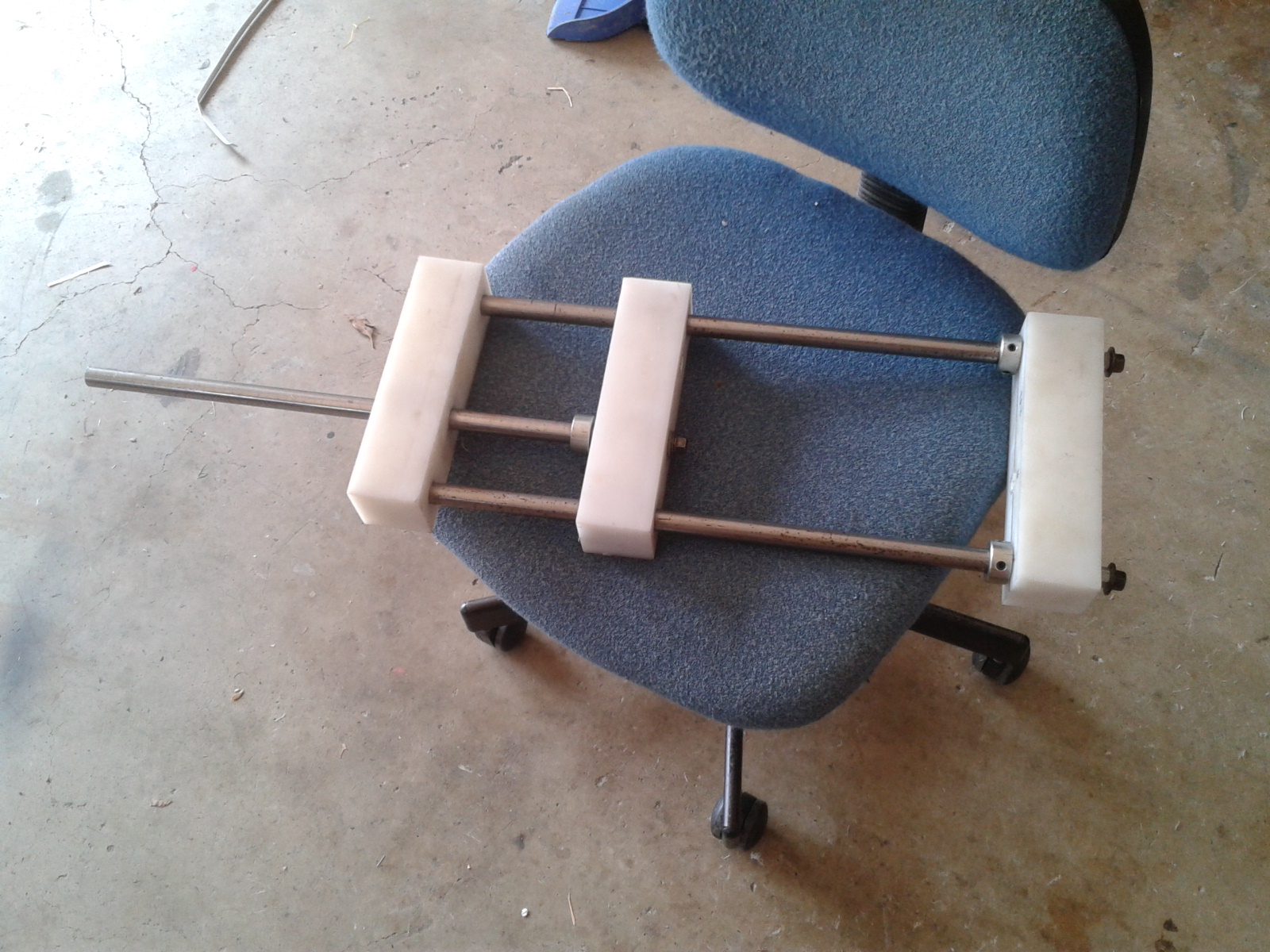

  19. bsft
    I had all of 10 mins to quickly trial fit the parts, a biit of extra drilling to allow more free movement, but its on track, well one unit anyway
