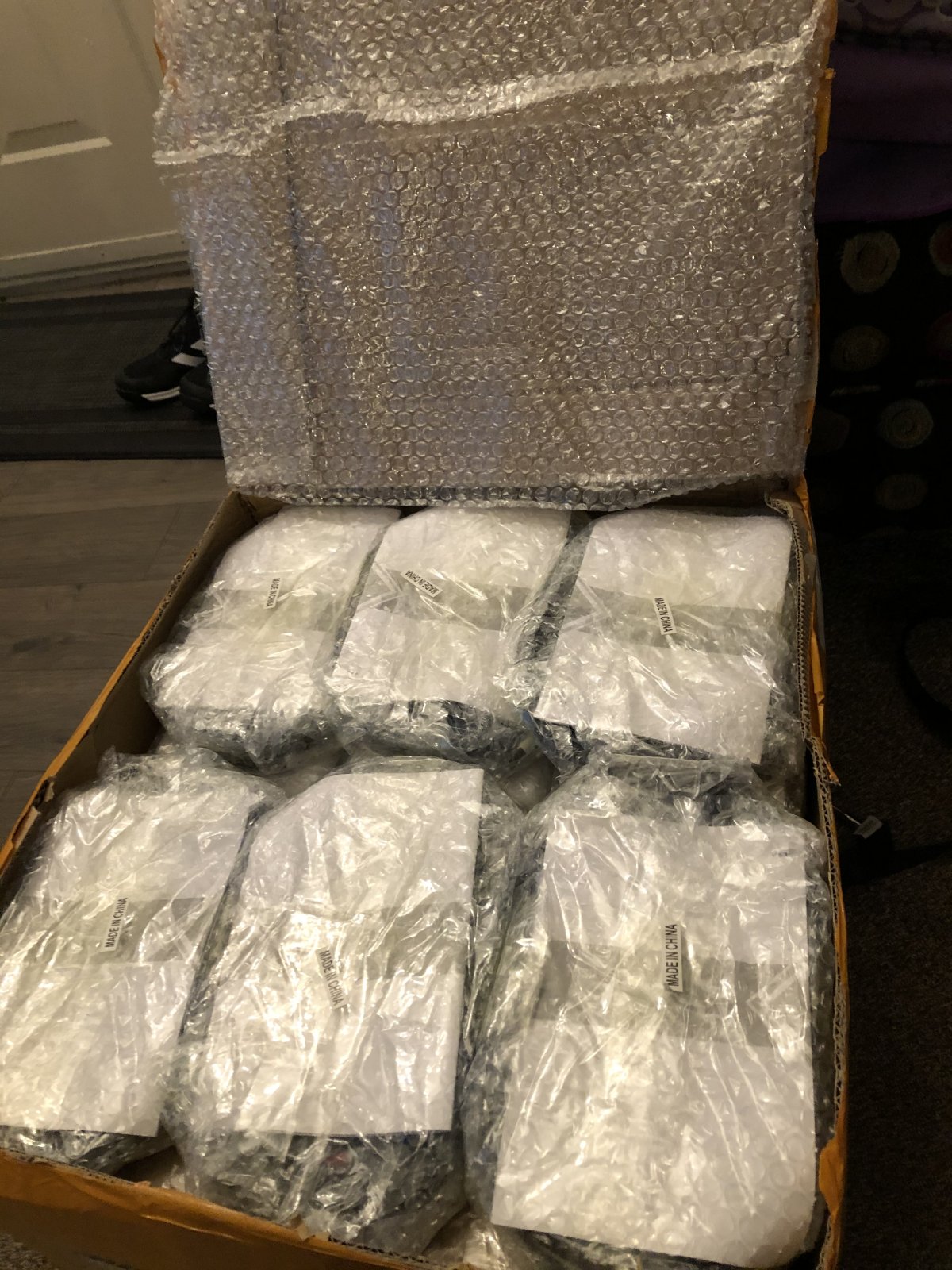

    Wanted to see about starting a thread to get reliable links and pricing to start building an actuator for 6dof units like flypt and peacemakers. I’m looking at all the parts from AliExpress and alibaba but the shipping cost to the US are getting out of hand. I have nothin but time though if it saves me some money in the long run.
    What are your experiences and the like.
    USA - current quoted costs for servo motors 6- 220v 80st-m02430 version a with shipping is $1310 from AliExpress Master Jiang 3SMT store.
    https://www.aliexpress.com/item/328...earchweb0_0,searchweb201602_,searchweb201603_
    Current quote - Ball screw SFU1610-650mm with end machine, nut, support FK12, coupling 10-19mm: $28/set plus $58 shipping on the boat from alibaba.
    https://www.alibaba.com/product-det...74.html?spm=a2700.12243863.0.0.38403e5f4Daex2
    Current quote for aluminum tubing - $216 with shipping.
    https://www.alibaba.com/product-det...83.html?spm=a2700.12243863.0.0.38403e5f4Daex2
    Total rough cost for 6 actuators parts thus far - $1752
    Ordered a Thanoes controller from his new web store. Hopefully all the other parts will ship soon. Add $275 to the total spent so far.
    parallel printer cables for Thanos Controller -
    Ordered from monoprice $30.85
    https://www.monoprice.com/product?c...&p_id=1582&seq=1&format=2#QuestionsandAnswers
    Still need misc screws and need to print the parts when all the pieces arrive.

    Well received the servo’s and thanoes aasd board so far. Need to get power ran to my basement to test them out. Waiting on my aluminum and my ball screws which the latter is on the slow boat, to get here!
    Edit- 1/5/20 got my aluminum tubing and my uv joints are here now to continue printing all the plastic parts. Lots of plastic being used as I’m using 70% infill to keep parts stout. Hopefully it all holds up and are dimensionally correct. Had to reprint a couple pieces as they are coming out a little different sizes using petg vs pla.
    Ok got the uv joints from rockauto.com, they are for a
    1974 LAND ROVER LAND ROVER 2.3L L4 DIESEL
    https://www.rockauto.com/en/catalog...iesel,3438558,drivetrain,universal+joint,2392
    GMB 2100153 (210-0153) for - $35.18
    Igus bearings for top plate -
    https://www.igus.com/search?q=GFM-2528-16
    GFM-2528-16 $28.94
    3” pvc from Home Depot.
    $17 after tax per 10’ need two but had part of one sitting around at home.
    https://www.homedepot.com/p/JM-eagl...pip_alternatives-_-100173538-_-100161921-_-N&
    Threaded rod, nuts, snap rings, and soon I will be buying my metal for my base from coremark metals here in Minneapolis.
    I’m about $50 into all the threaded rod parts.
