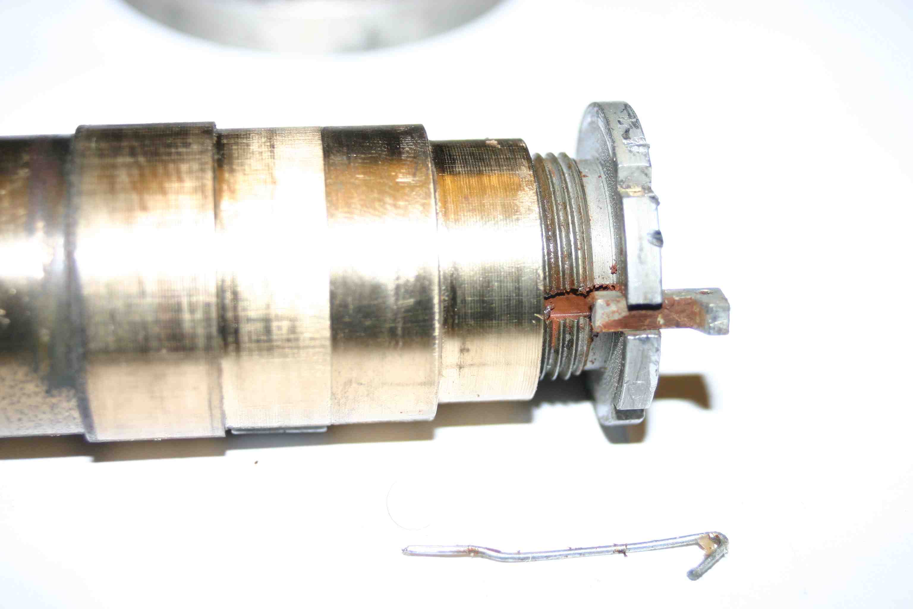

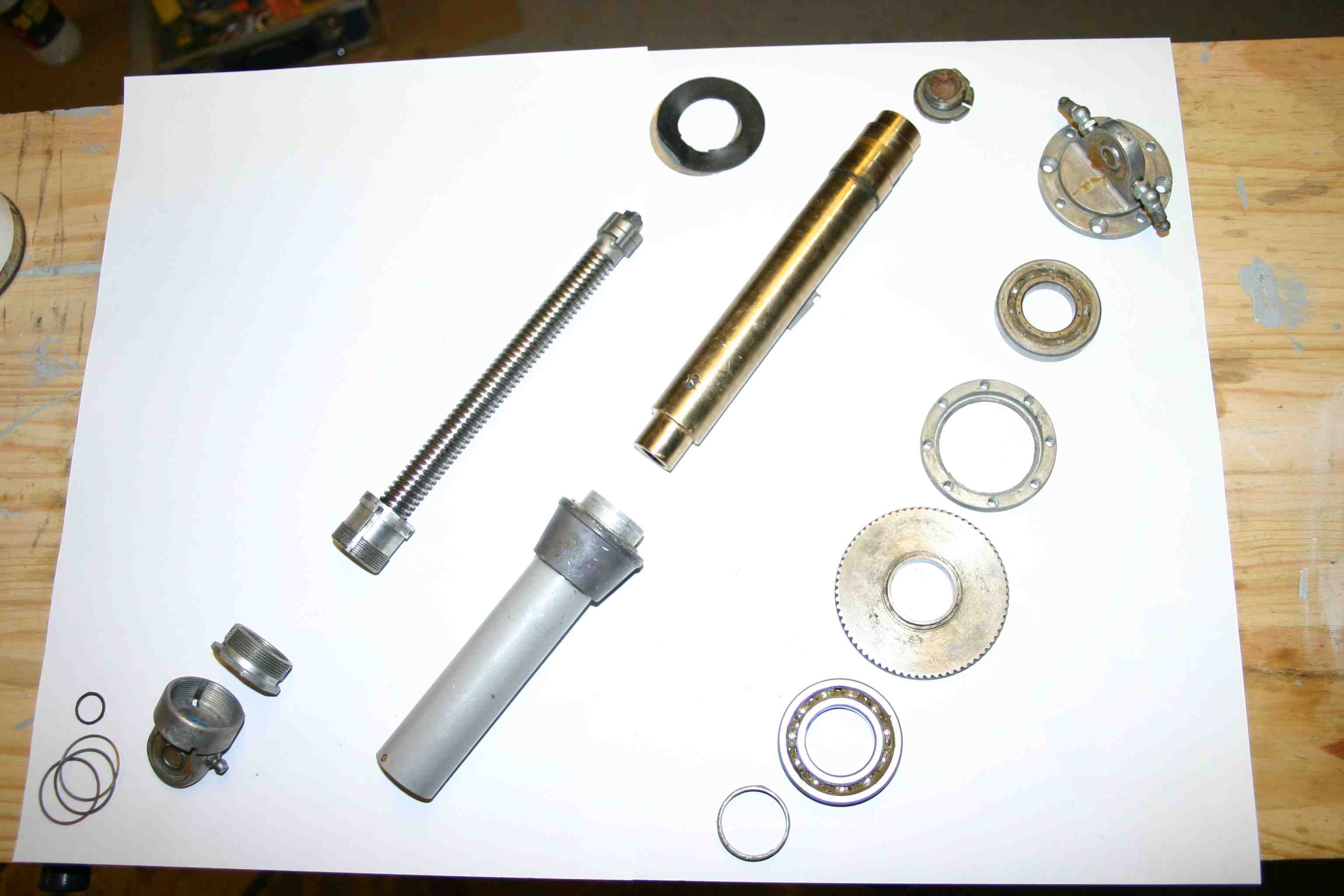

    This is the actuator I got from surplus. First pictures was like I received it.
    Devincox tried to get the 40 degree helical gear out, here it is. No so complex once you found out to proceed.
    I think it can be replaced by a pulley separately, or a pully can be tighten on the helical gear itself.
    Cheers.

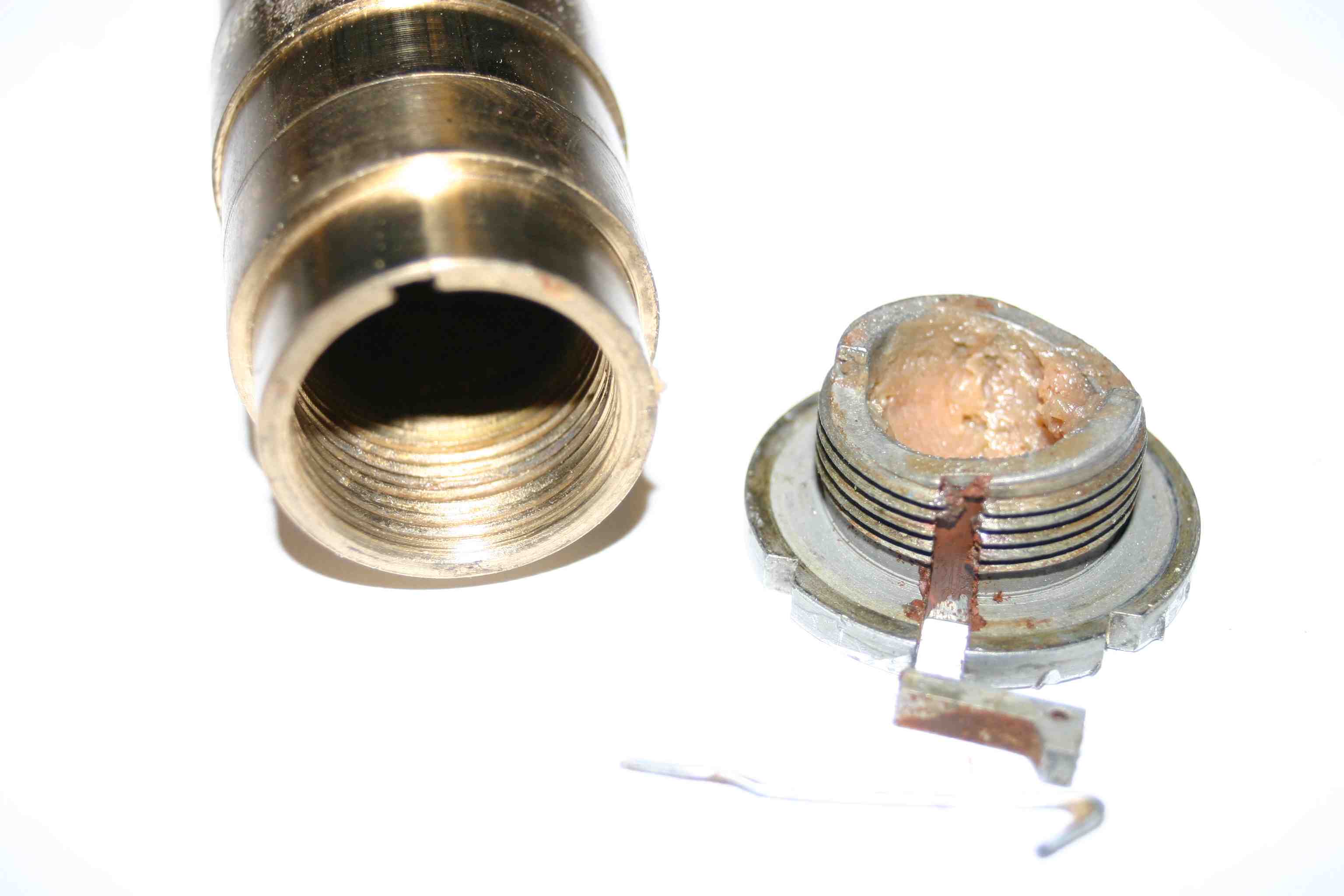

    @OscarH,
    Excellent! I must ask how you got that apart. I am having a problem getting mine apart and don't want to break it.
    I circled the part in red, that I am having problems with.
    I removed the wire and pin and assumed it was a threaded part but can't get it to turn or come loose. How did you remove that part?

    Been caught at the same level until I found how to move forward...
    Remove the wire and the pin, then simply unscrew like a nut. Unfortunately, this is not a hex nut, so you have nothing to hold it properly :-(
    I used my bench wise to hold it on one side, while using a gripper (?) on the other end.
    See detailled picture, so just unscrew...
    Hope this help.

    did you use a press to get the 40 deg. helical gear off? Mine will not budge. I am sick right now so I may be missing something simple. I've been wanting to get a small press, this may be the impetus for such a purchase. (c:
    Devin
  9. OscarH
    OscarH Member
    Jun 8, 2008
    43
    Paris, France
    517Coins
    +9 / 0 / -0
    Hi Devincox.
    I put it on the top of my bench wise, used a piece of wood, and a hammer.
    Side you need to bang hammer/wood on is the side I took close pictures last days in this post.
    Be carefull as the 'tube' can fall on the floor and damage the assembly. There is also a small key /cotter pin on the 40 deg helical gear. Don't lose it if it needs to be re-used.

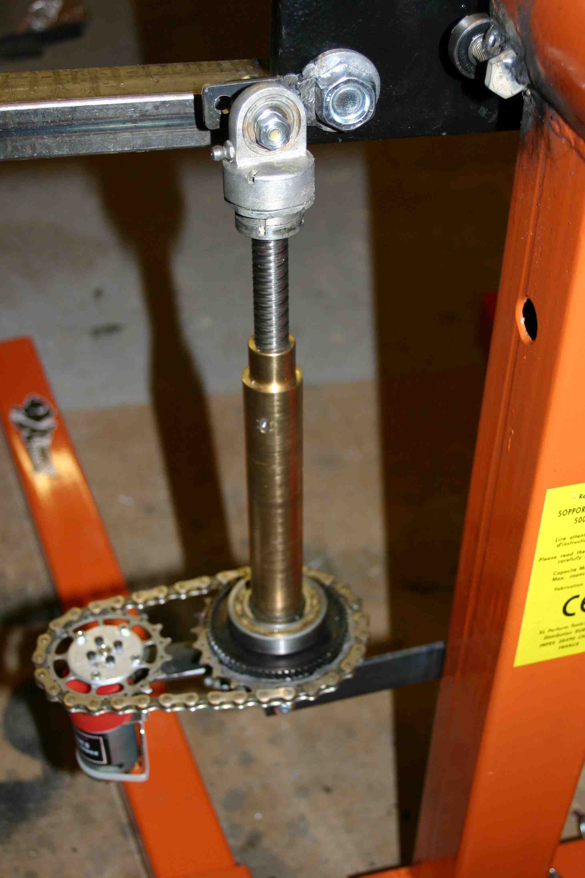

    Hi Folks,
    finally found some time to move forward. Remember this cheap actuator was not motorised.
    I used a standard motor found at Conrad/Selectronic with a 1:11 gearbox.
    I used an old rear gear from my mountain bike, and here it is : working !
    There are some limitations I am still working on : limit switches and feedback potentiometer.
    The limit switches are mandatory as, per design, the actuator lock when reaching the limits, thus motor could burnt :(
    Need also a protection for fingers !
    Cheers.

    Hi folks,
    The motor I am using is a MFA RE-540/1. Loaded, it is supposed to rotate at 13360 r/mn, and driving a 2.85 amps under 12 V. Torque is 154 g.cm.
    Then I had a 1:11 gear box, and the extra ratio using the rear wheel of my mountain bike give an extra 14:24 ratio. Total ratio is then 1:19, not including the screwjack ratio (22 turns give 15 cm translation, but don't know how to convert torque into linear power).
    It take approx 2 seconds for the 15 cm, that's not much, but enough for the setup I currently have.
    Remember in my simulator, the center of gravity of the seat+driver is very close to the center of pitch and bank axis, thus not requiring a huge power/torque to have the seat moved back and forth.
    I am in the early phase, so I need to move the seat from my old setup to the new one (and need to modify the second actuator for the pitch axis).
    More to come when time permit, as usual.
    I had not issue in ordering to Surplus shop. Both attenuators had been shipped within a week, or so, from order. I just had to confirm shipping cost prior the order, and these shipping cost where almost double price than the actuators themselves (total including S&H was approx 60 $), and I didn't had the local taxes to pay (passed through by chance).
    I'm interested to find out if you can connect 2 actuators back to back. May not be easy to use a common gear, but probably not impossible.
    Cheers.
