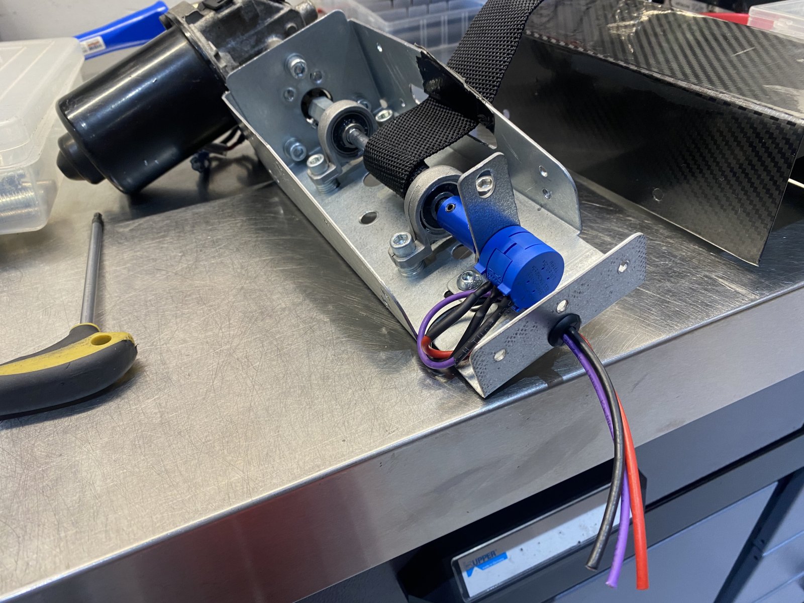

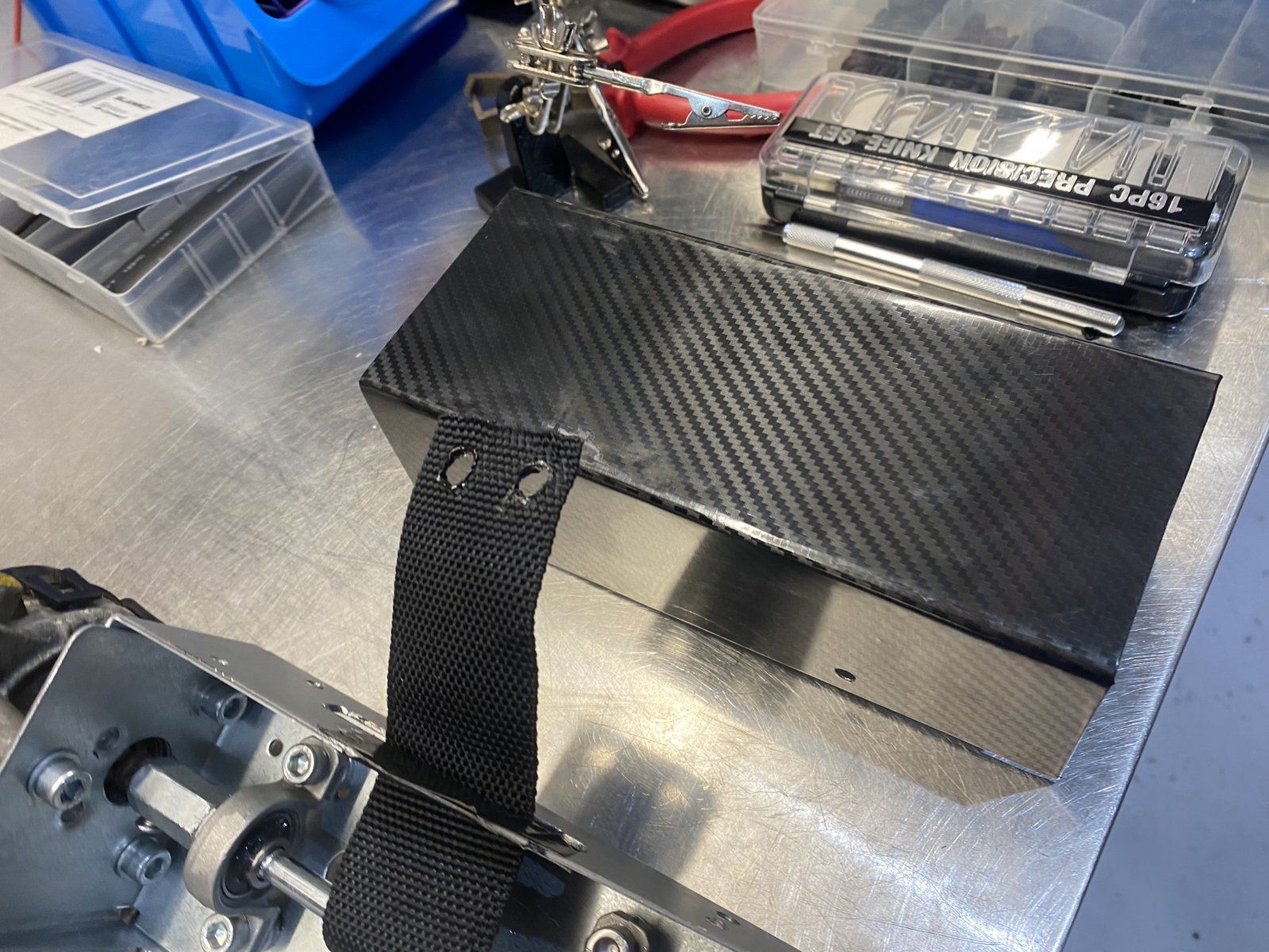

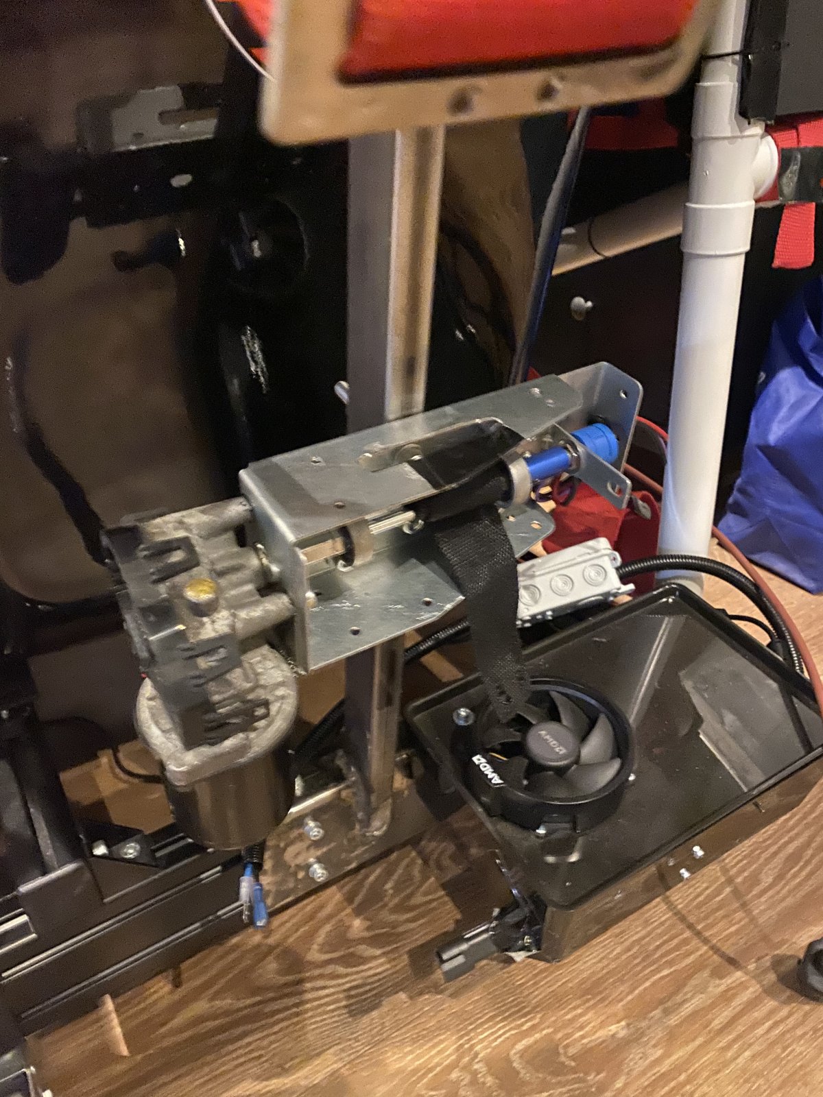

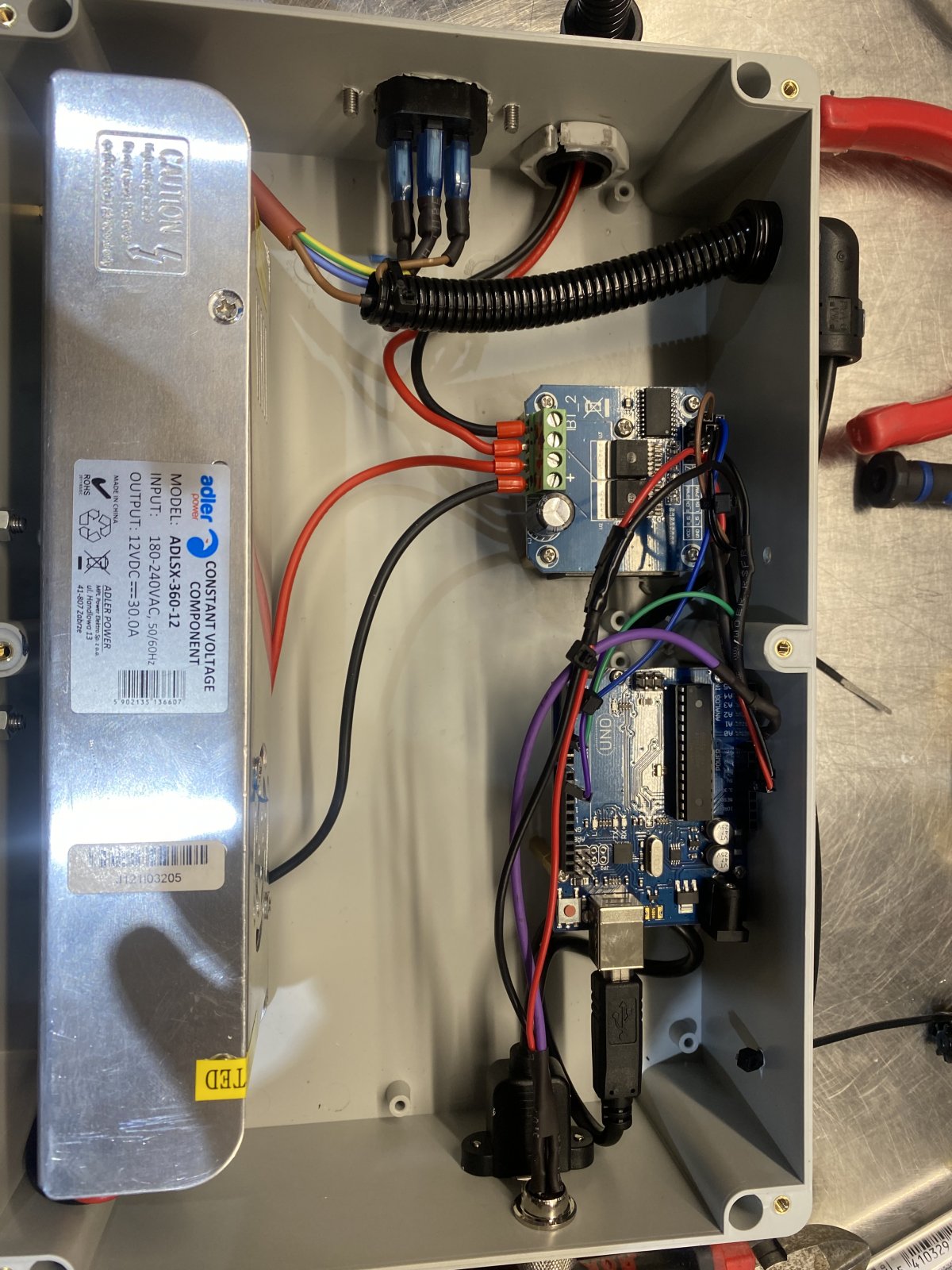

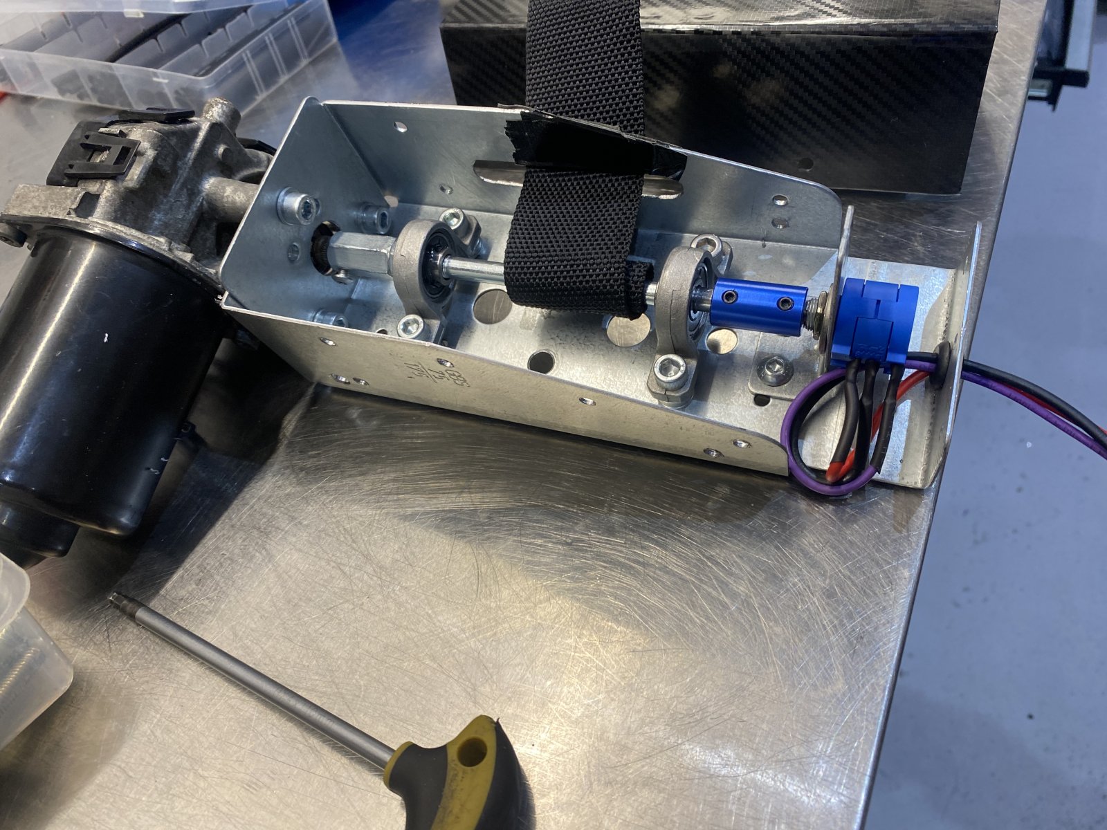

    Done with the redesign electronics are next.
    Its only half the size now D23696C3-ED4E-4F4A-A1EB-AACE2F0202FC.jpeg B98540D7-1FBE-4CD1-B5AA-CBAC2560998E.jpeg 9BDEF6B1-8807-47C0-BEBF-9E1737432024.jpeg F0E1EBB4-4A6C-4F65-9718-8A8D82C63BD6.jpeg

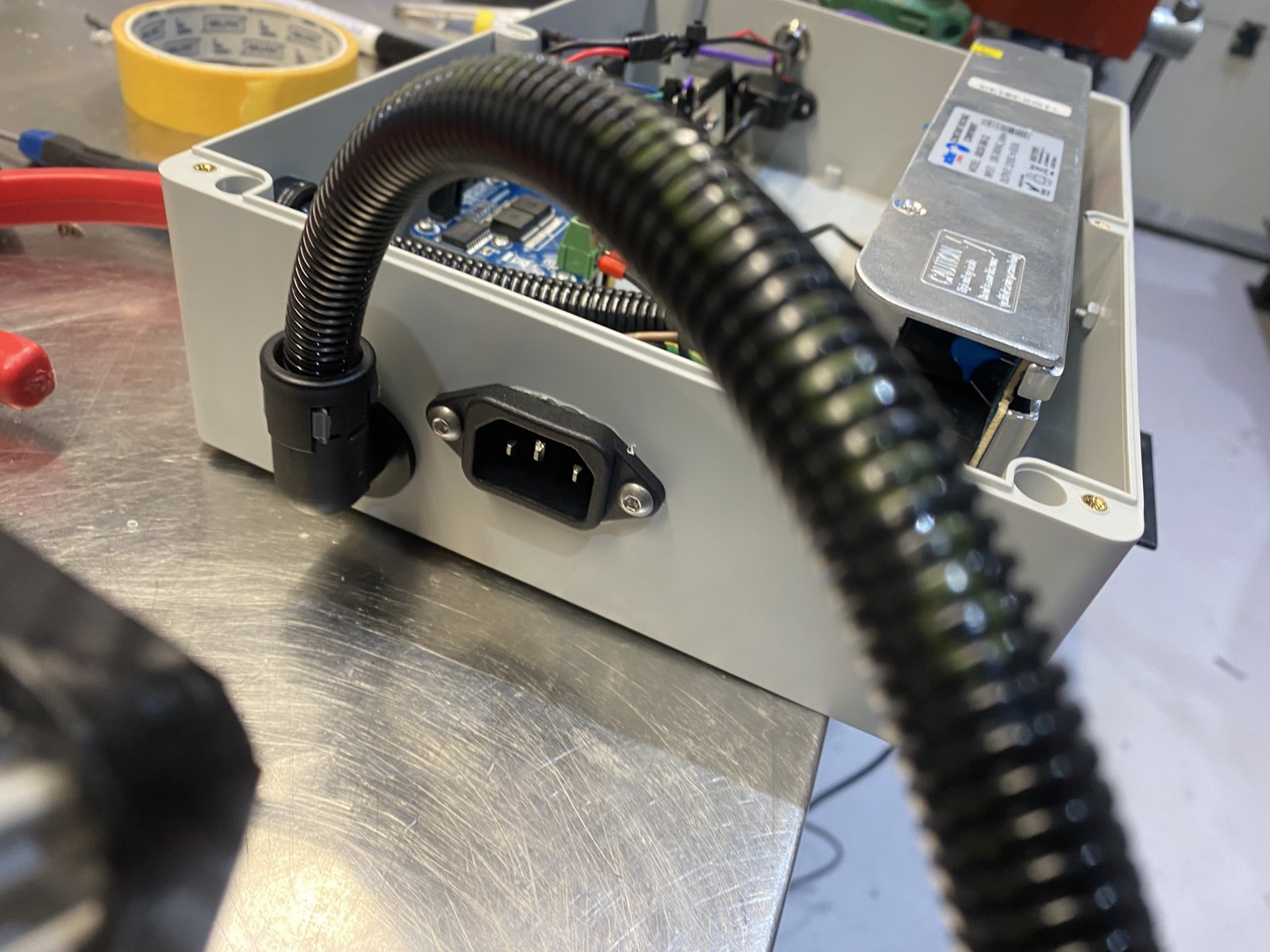

    Wiring is also finished
    It is working with limitation so it only tensions with braking and loose to 0% but doesnt loose with acceleration.
    But There is a problem i want to loose the springs but i cant find to limitate the rotation is it posible because when i limitate axis rotation degree it doesnt make a big difference and then when i drop the springs it wil tension to much 9966F29A-F5E0-464C-BD4C-6BAFF713595C.jpeg F6D9A407-1625-43E3-9345-28B812C21FCE.jpeg 2ACBB863-6854-442D-8B20-5BC7365BF32F.jpeg

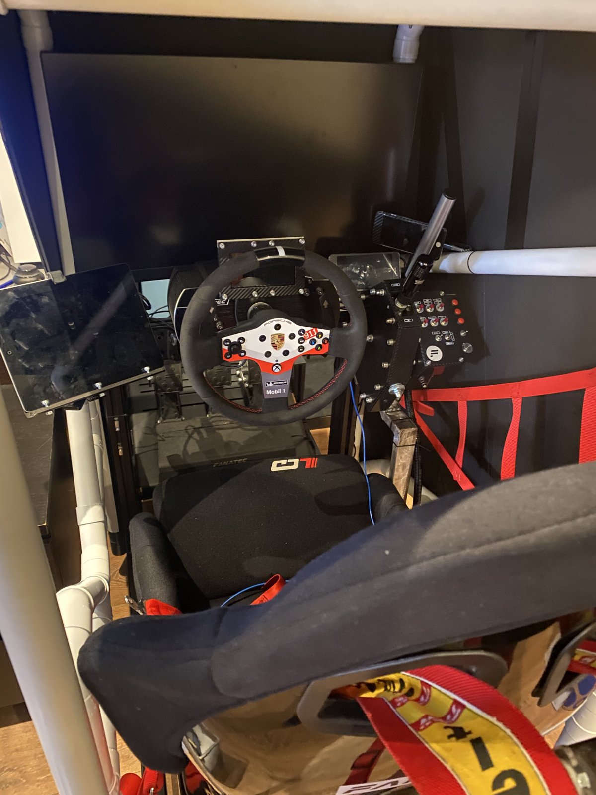

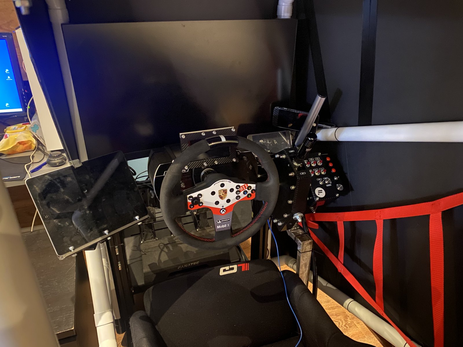

    Last two weeks i also got a little crazy on the rig E9BFA5DA-A9EA-424C-B352-4181F359507C.jpeg 3D76329B-F0B4-4E3E-979E-9D525870B25B.jpeg 610D7B35-2A4C-4B7E-80F0-A9172AA4F7DD.jpeg 6718B3FF-15CA-44B3-93D0-6B360A981550.jpeg 2D847ECE-E1D3-4371-ABE4-5AAD8F67A27F.jpeg

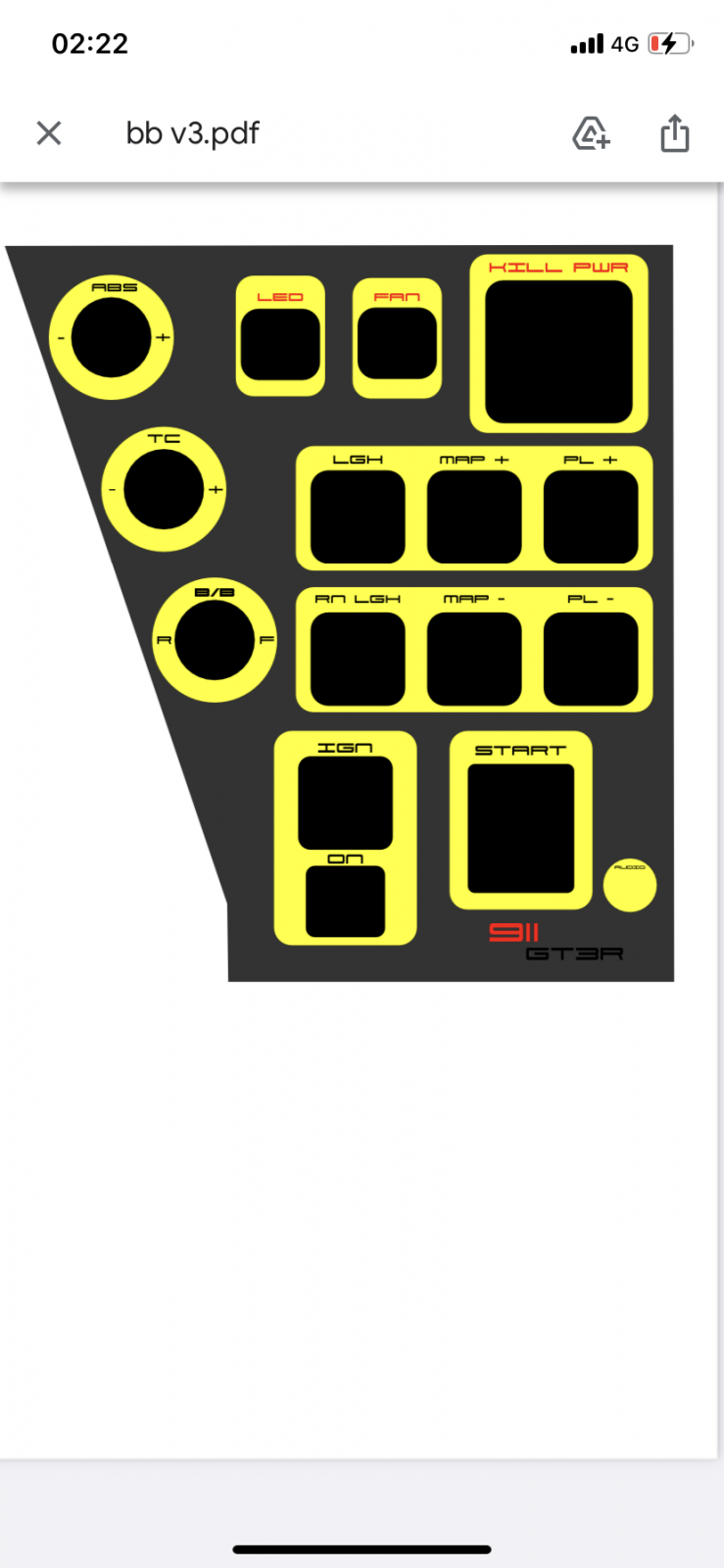

    And Made a Nice layout for my new to make buttonbox
    going to try to print it in a clean vinyl and make the gray Clear so i can wrap it in Carbon fiber and then the clear vinyl with the layout. 200D0129-C05E-49F4-9E2F-23C5927F12AF.png

    I am not sure I fully understand, but would suggest the range and behavior of the motors can be set in SMC3, and in the SimTools Tuning Center you can set 0 so movement is only one way, but perhaps I am missing something in what you are hoping to achieve?

    Simtools tuning center i set to 0 on one way and that is working fine.
    but i want to limit the degrees of rotation say that for now 0% to 100% uses 360 degrees i want it to use 90degrees Wich i need to adjust to
    Limit it.
    also i have al lof of sound from te motor when Its nog moving when i set deadzone to 12 it wil reduce the
    Sound a bit where can i seak for this problem.
    20,555
    145,148Coins
    +10,780 / 52 / -2
    SimTools will use the available range available as 100%, but that does not mean that is 360 degrees rotation, SimTools also has Axis Limiting to further restrict whatever it has available as a range.

    Mine is working also but i need a lot of deadzone of else Its making weird noises i hoped with the redesign it would be beter.
    i was thinking for a Seatbelt tensioner maybe Its a good idee to use the readings from the loadcell of the brake pedal (of u got a loadcell brake) then Its possible to get constant readings for braking it was just an idea

    If u have noisy sygnal try to set fpid 3 and fpwm like 25-30 kHz it may helps
