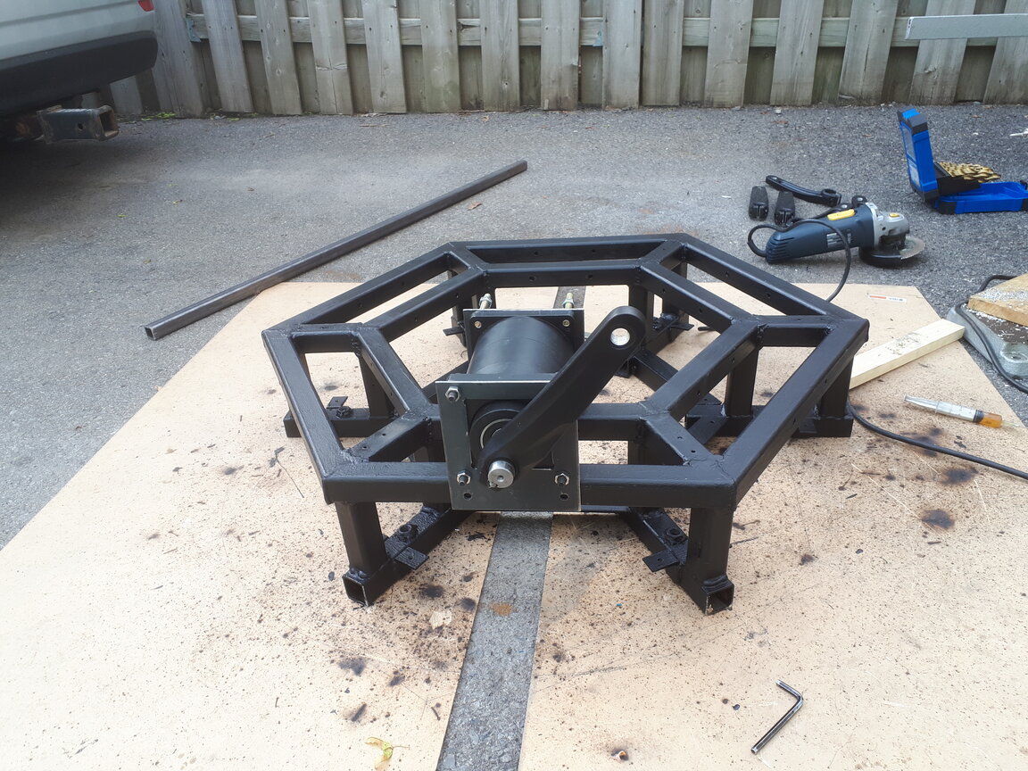

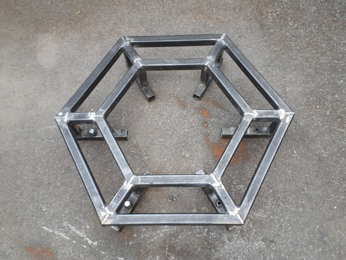

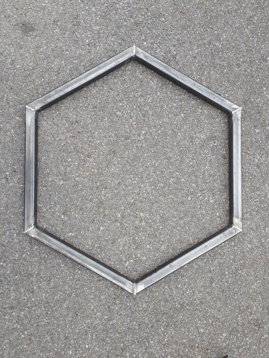

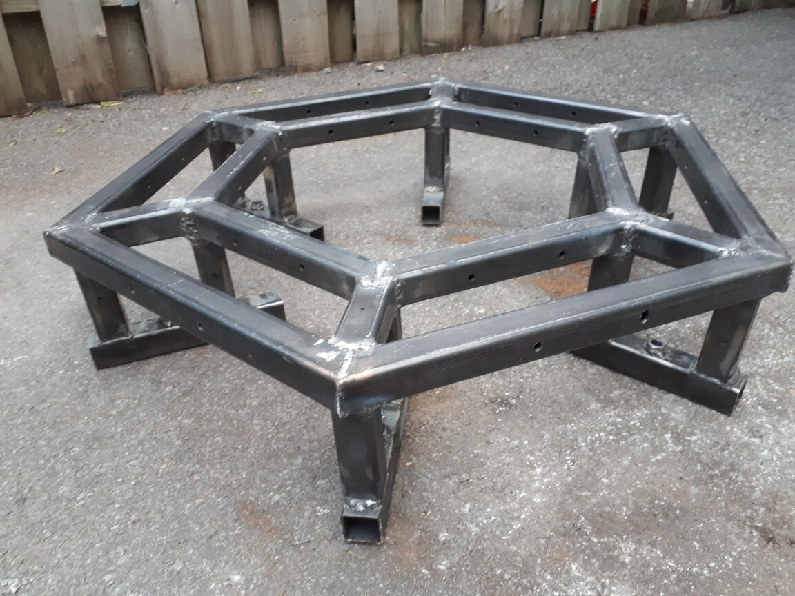

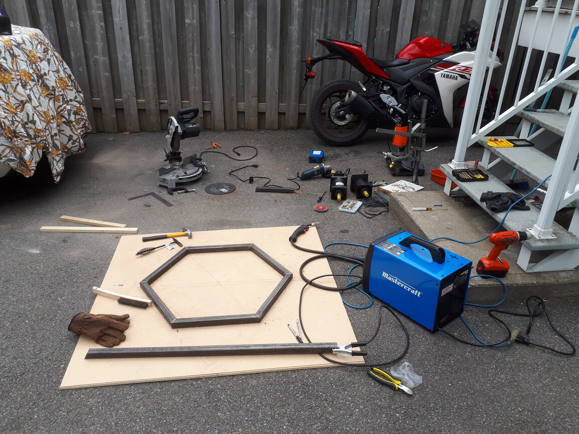

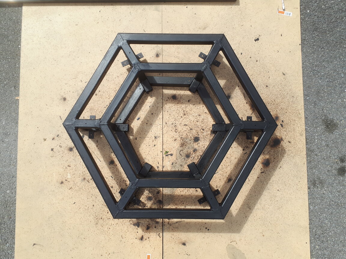

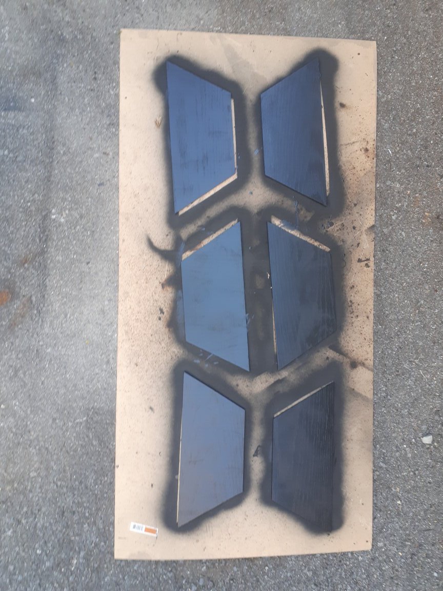

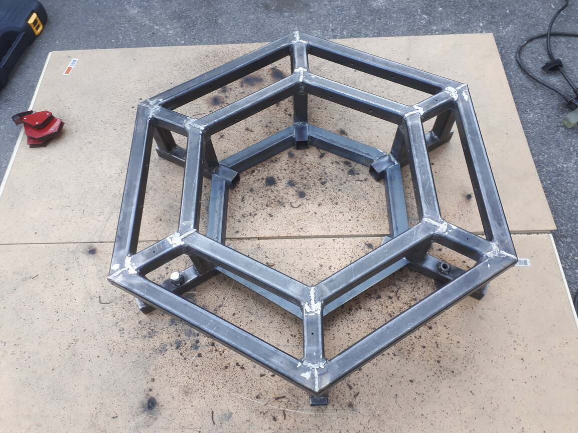

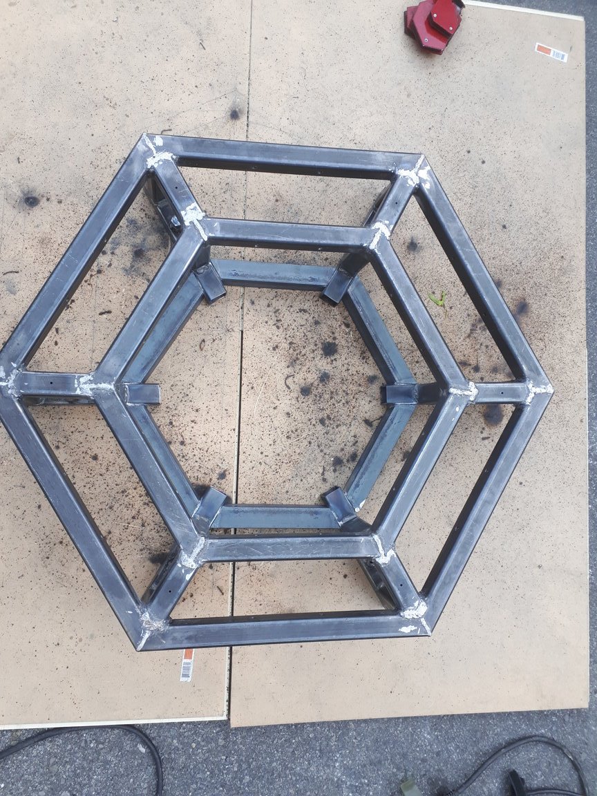

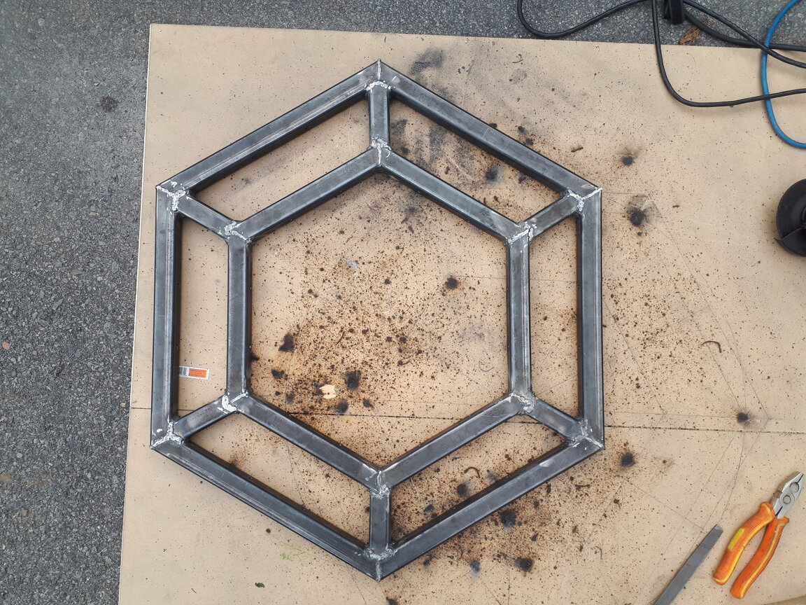

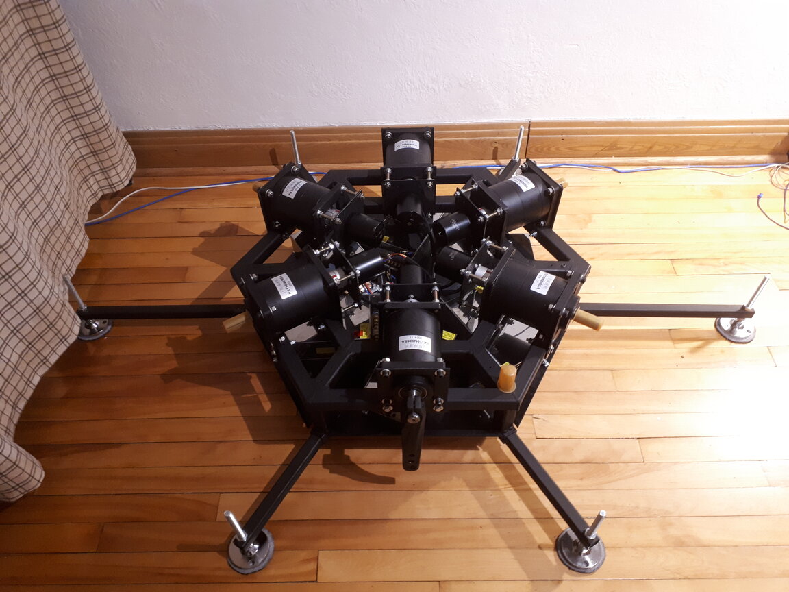

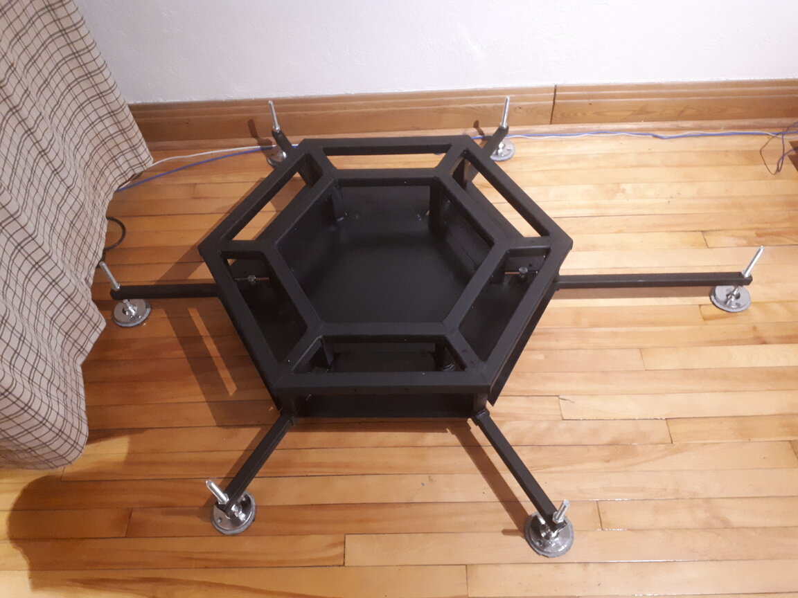

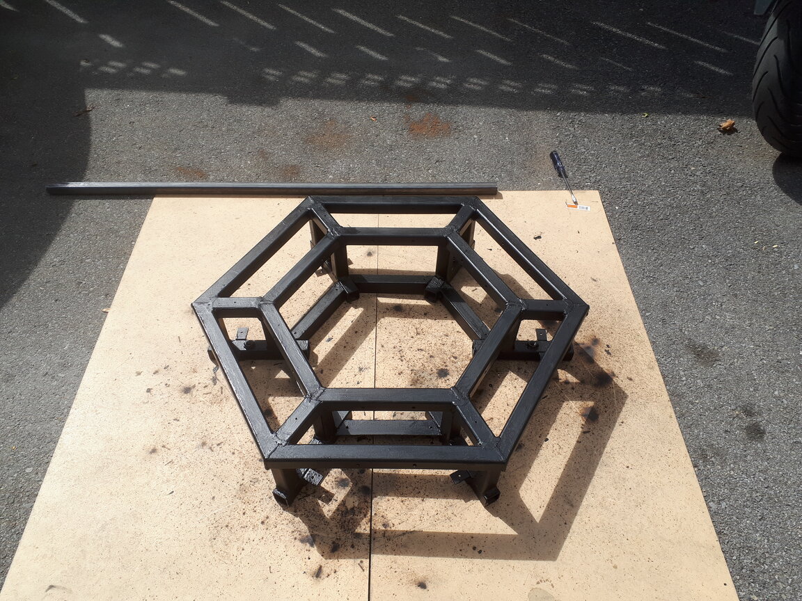

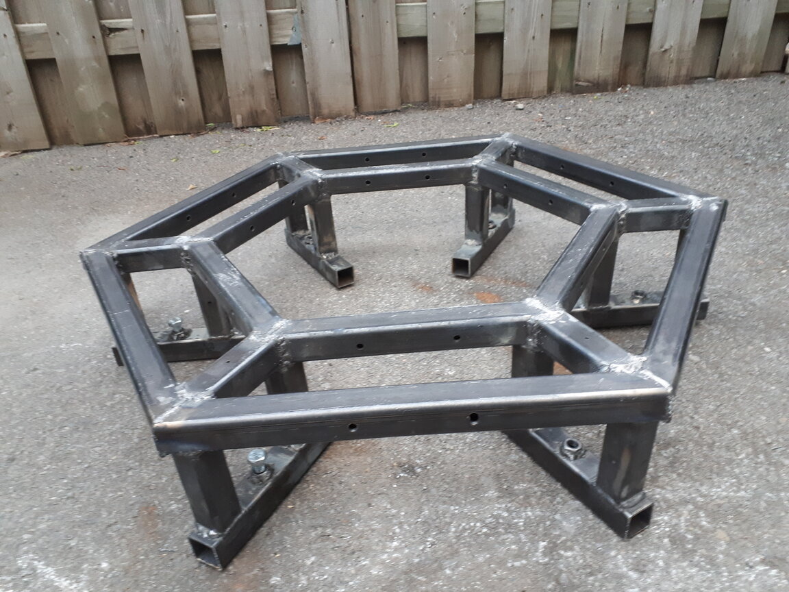

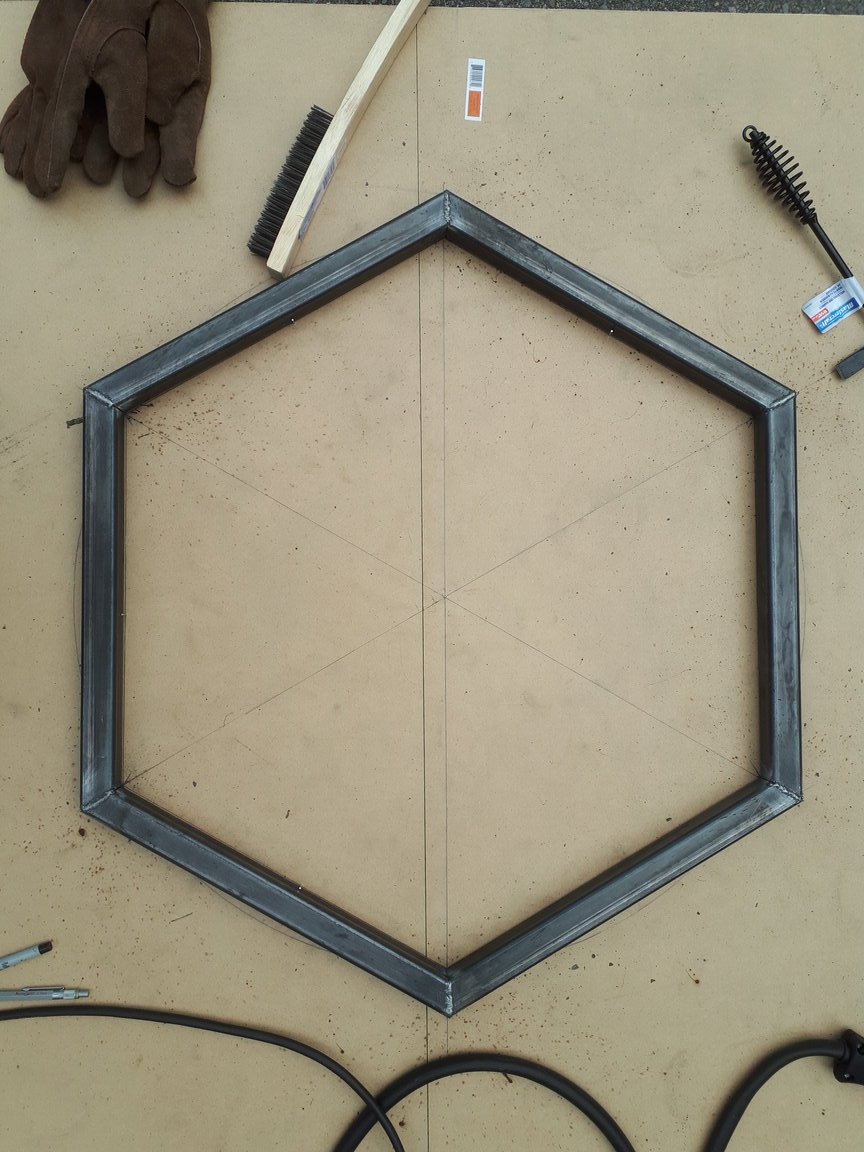

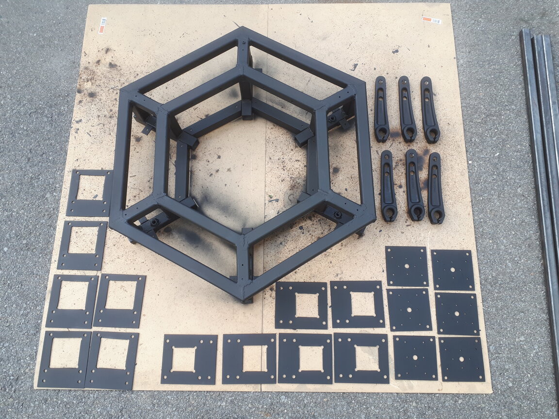

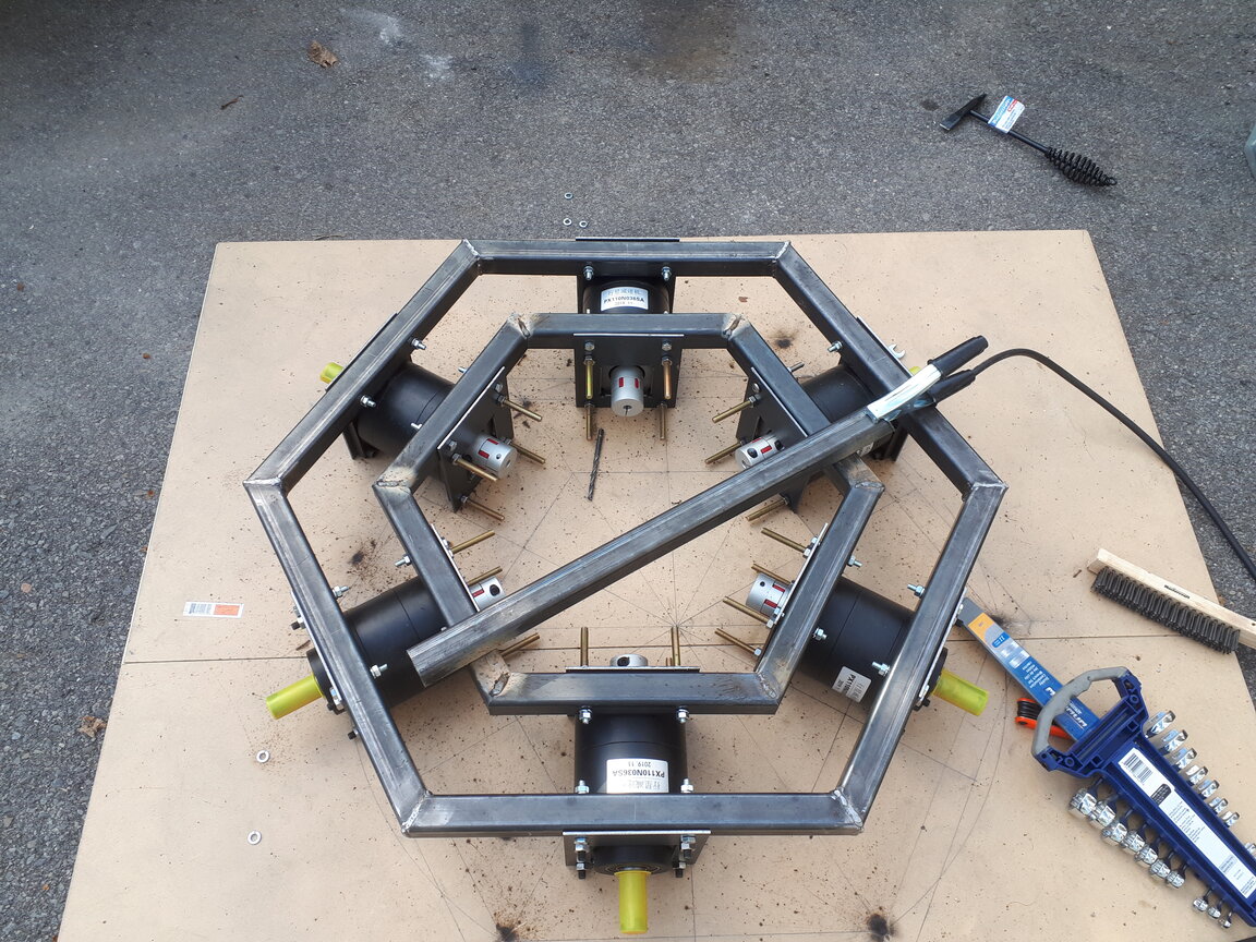

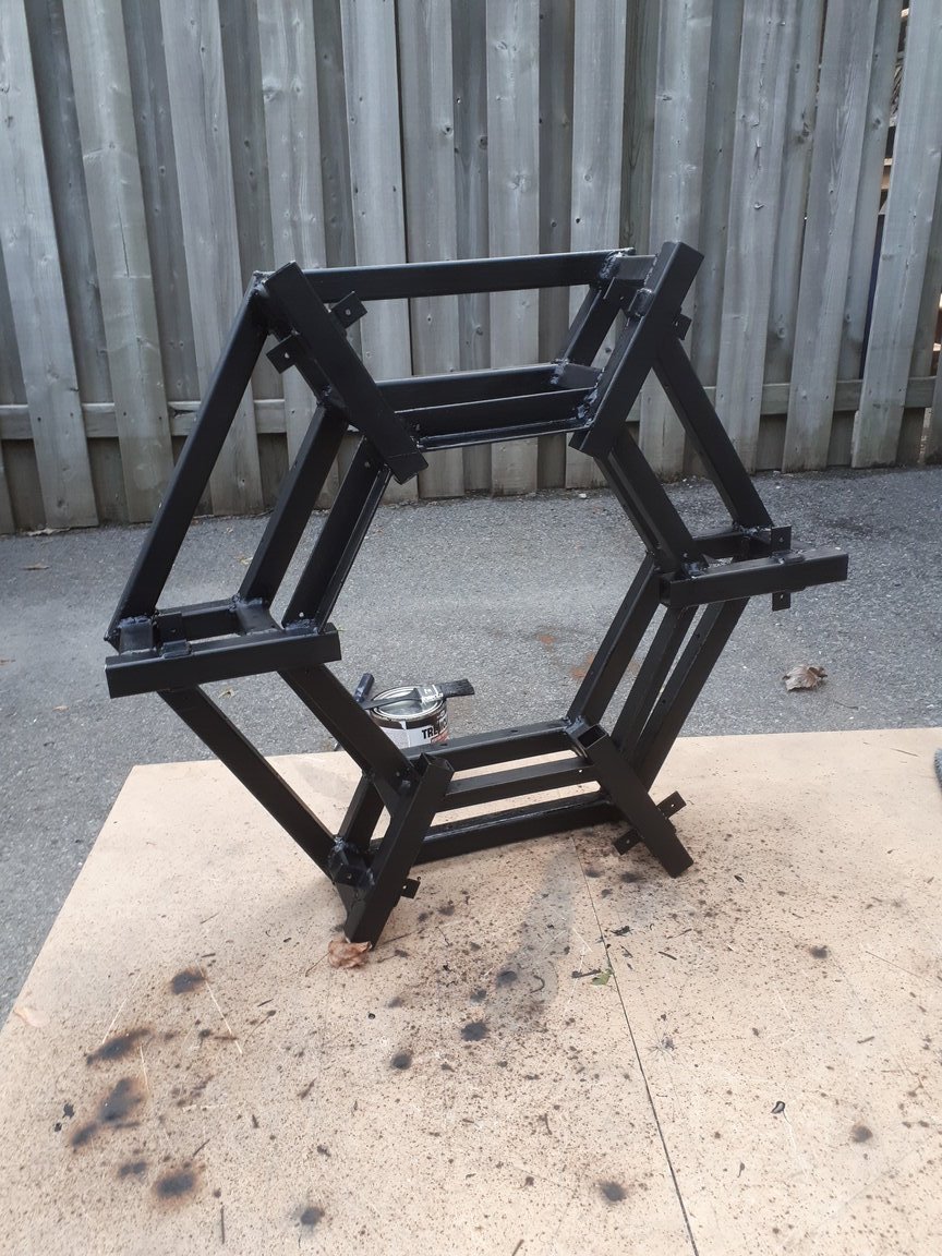

    I started working on my simulator this spring. It is a relatively difficult task and I needed a lot of time and patience.
    The base is welded. I did not have previous welding experience but the result is acceptable.
    I opted for rotating actuators because I do not have space in my apartment and I tried to make it relatively small.
    I’ll post some photos to show the progress.

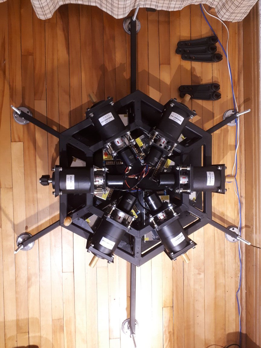

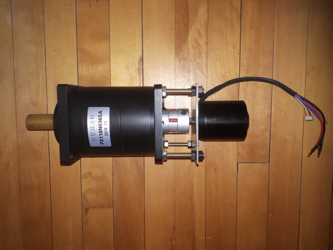

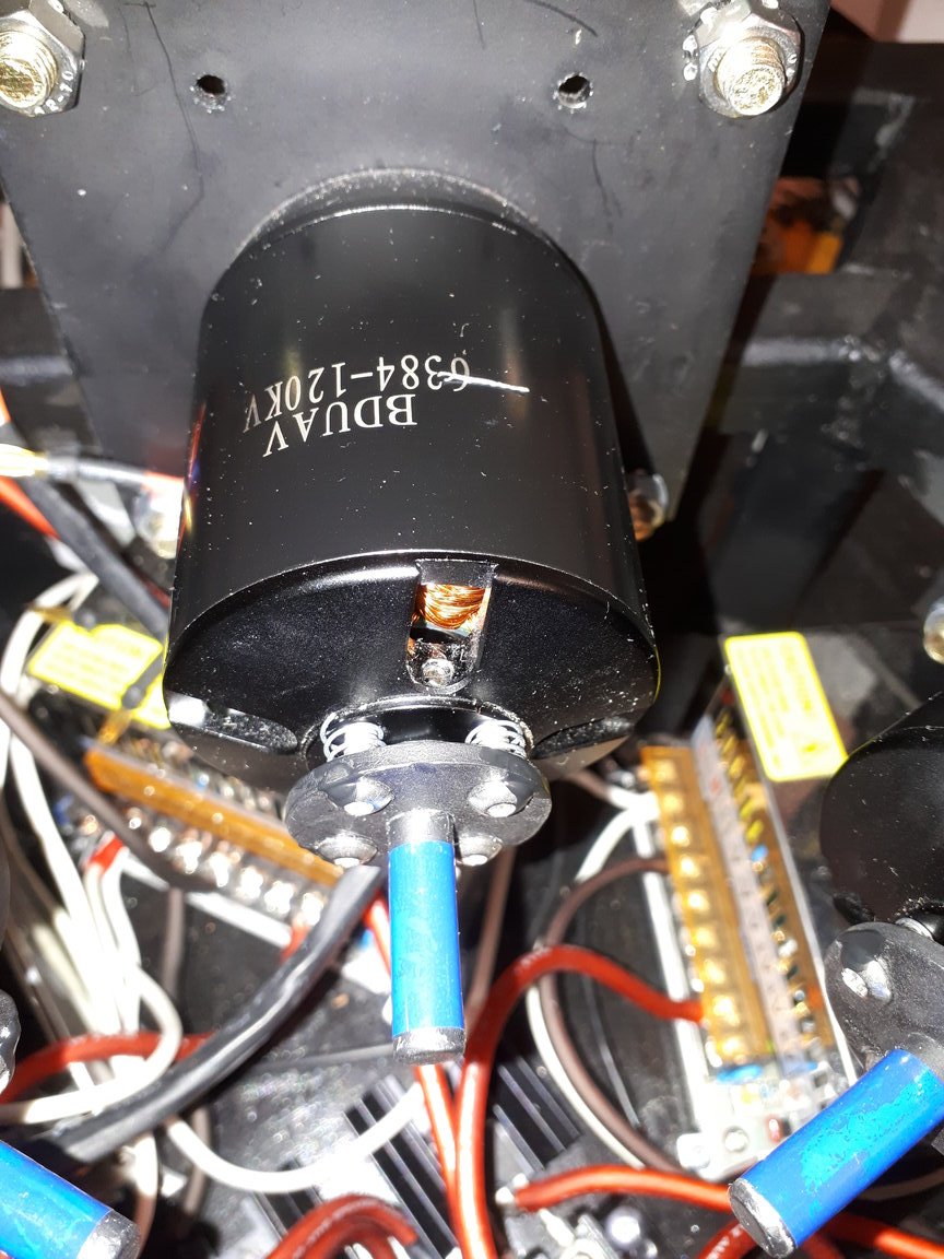

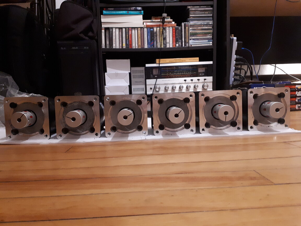

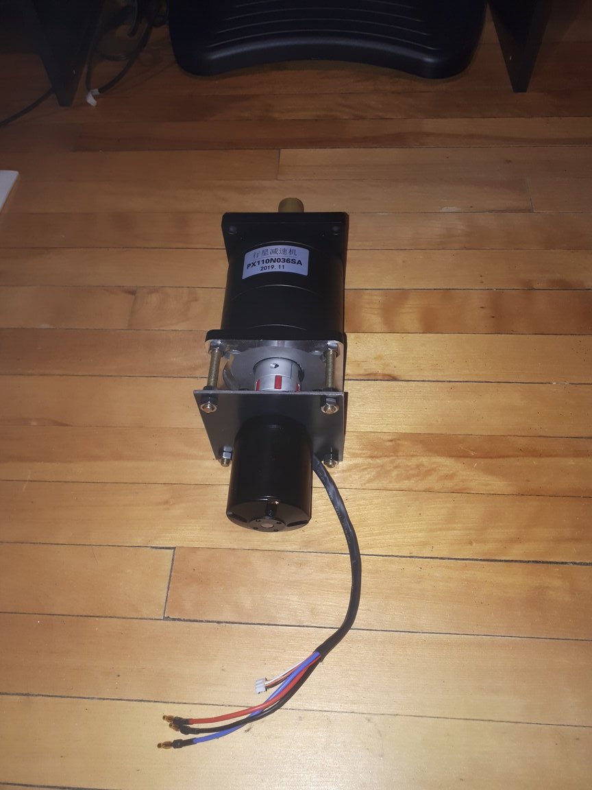

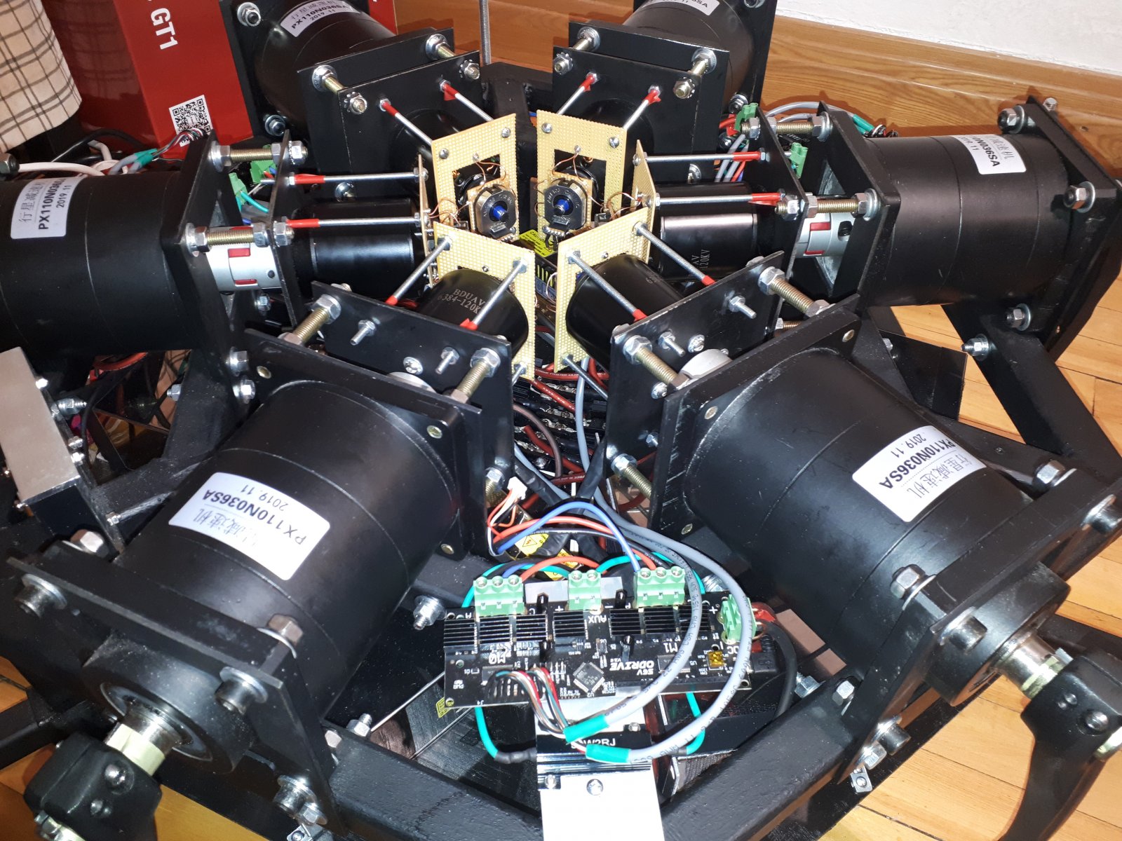

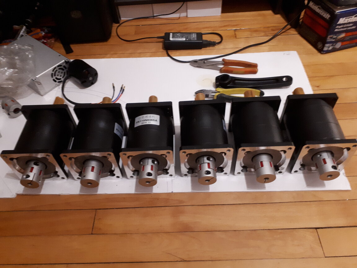

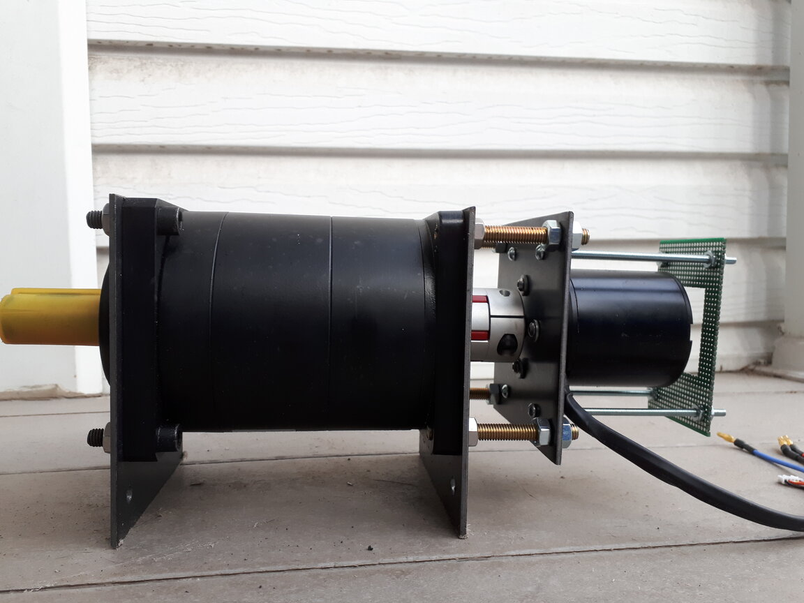

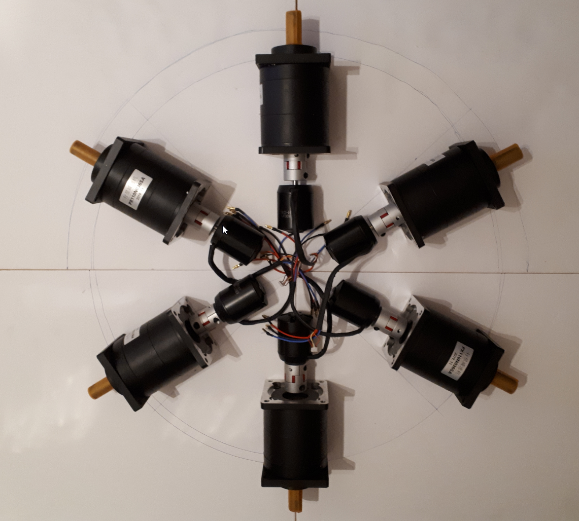

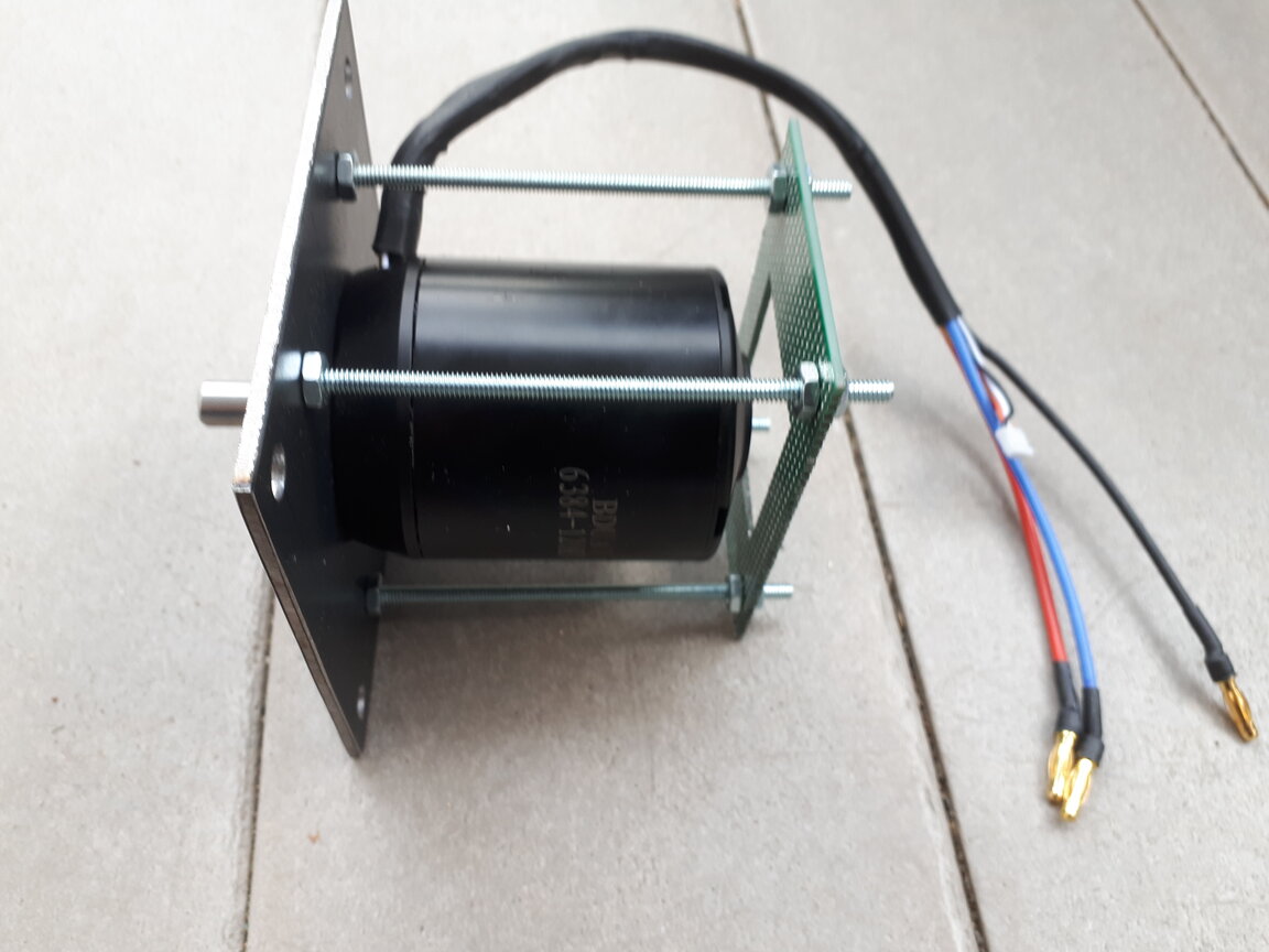

    The motors are 6384 120KV. Nema 42 36:1 Ratio Planetary Reducer. All from Aliexpress.
  3. kunkurus
    kunkurus Member Gold Contributor
    Oct 10, 2019
    27
    Canada
    263Coins
    +63 / 2 / -0
    DC motor, 6DOF
    The shaft couplings are 10mm to 19mm.

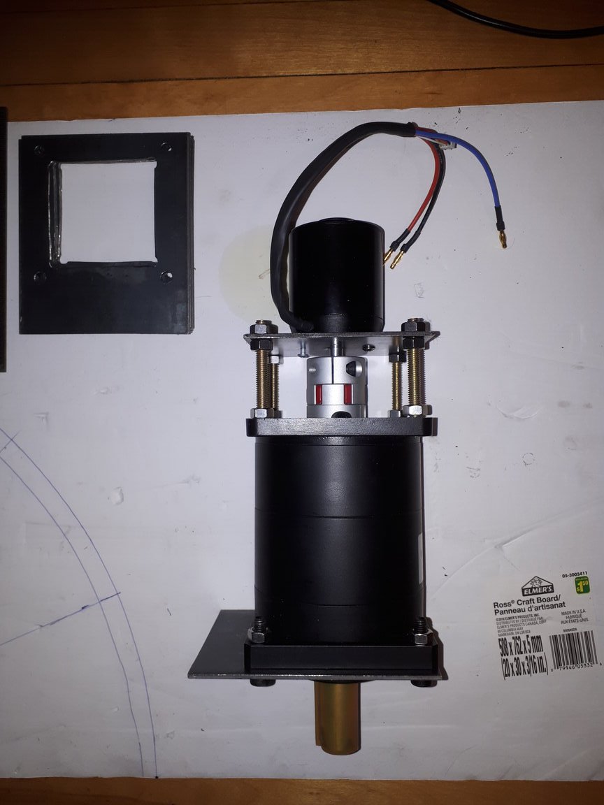

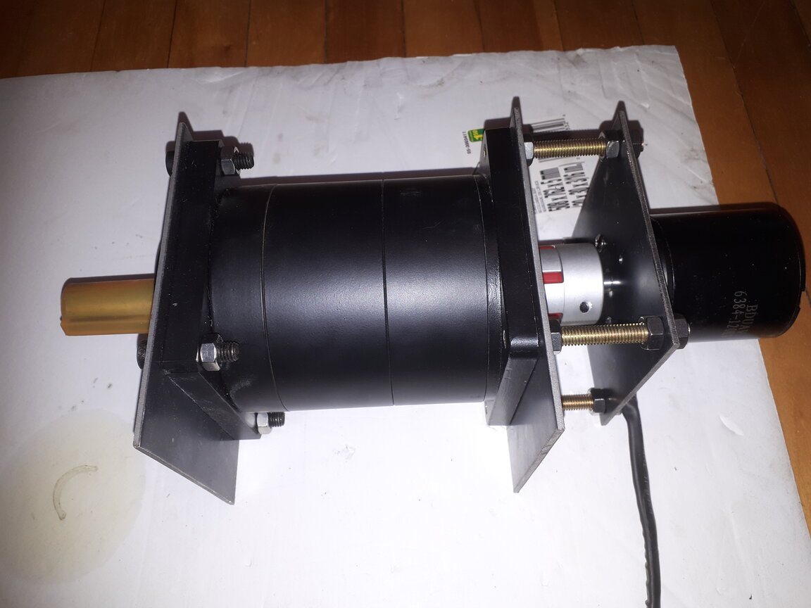

    Mounting the motors on the planetary reducers.

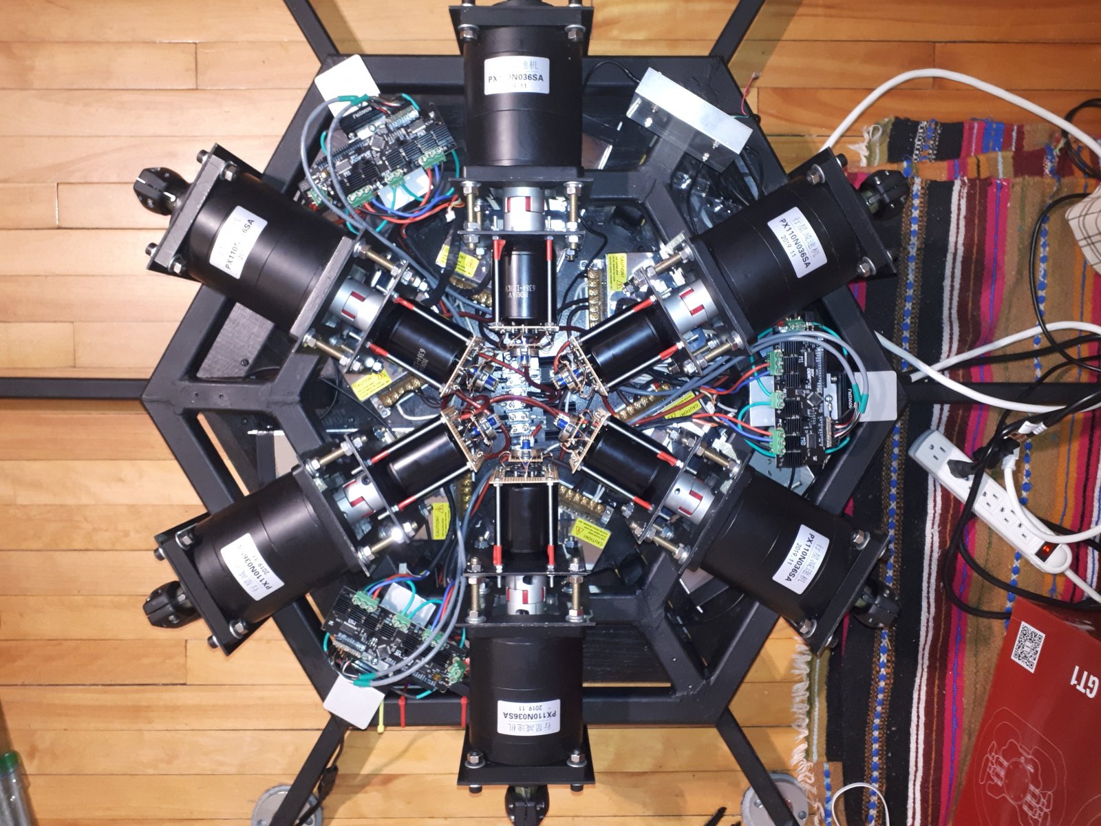

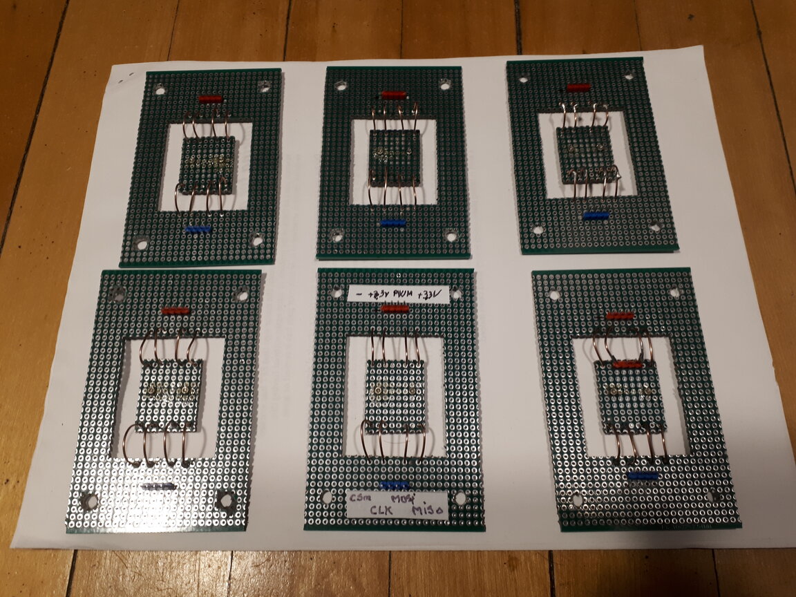

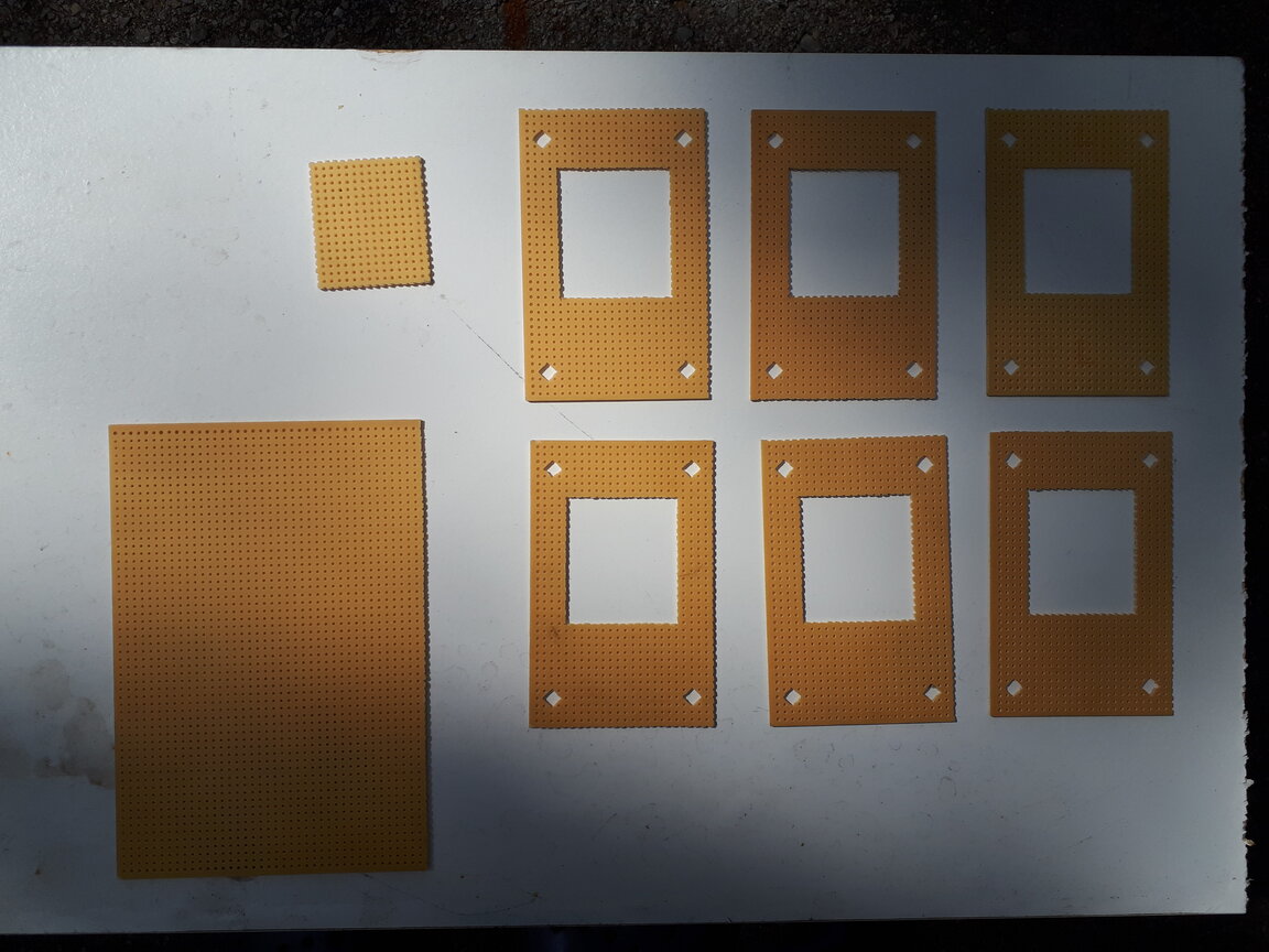

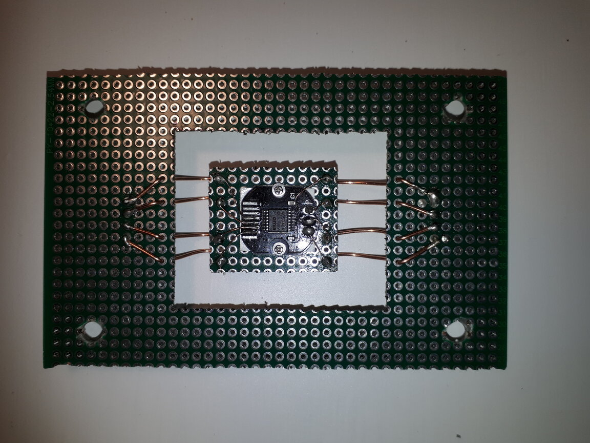

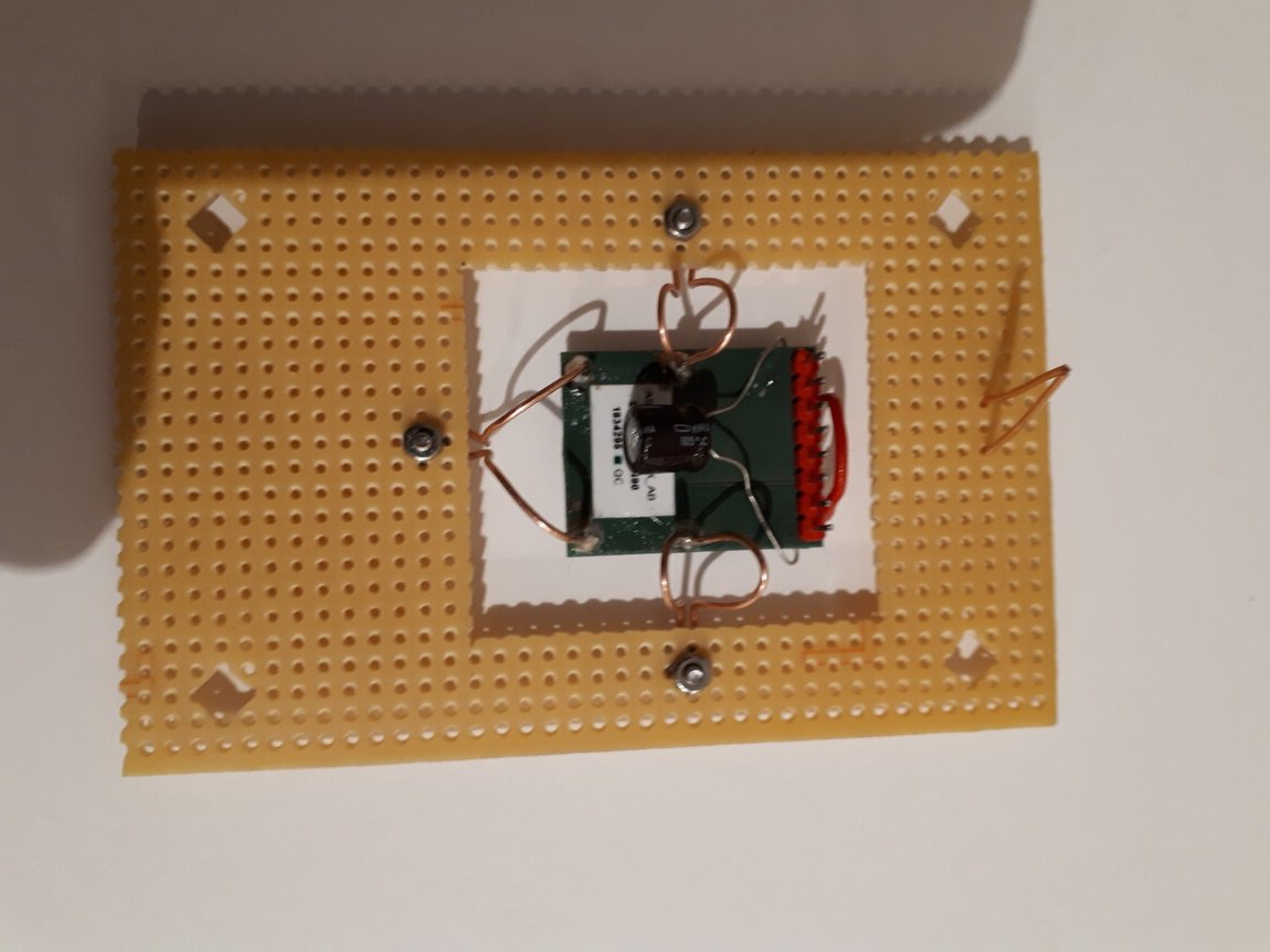

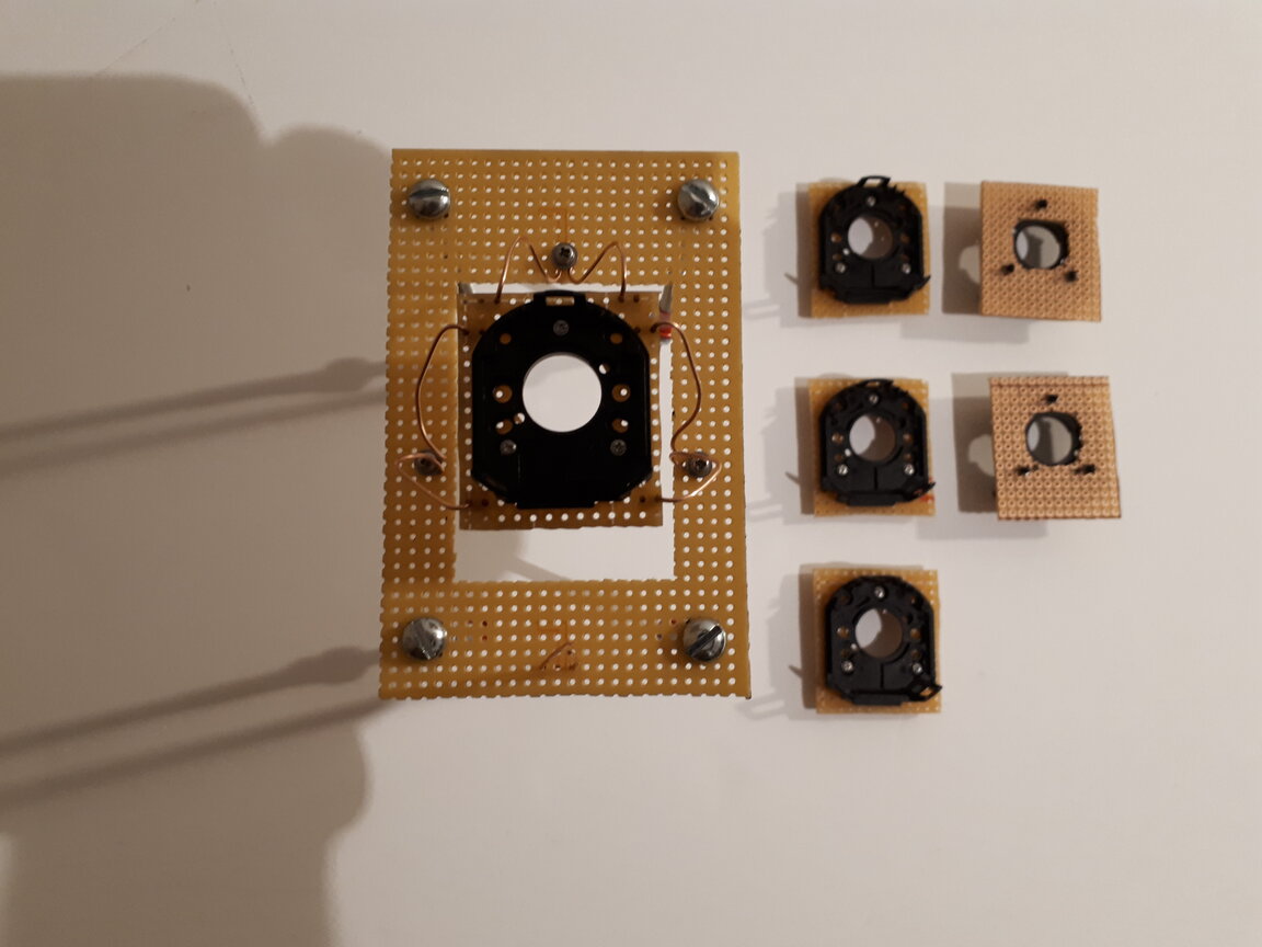

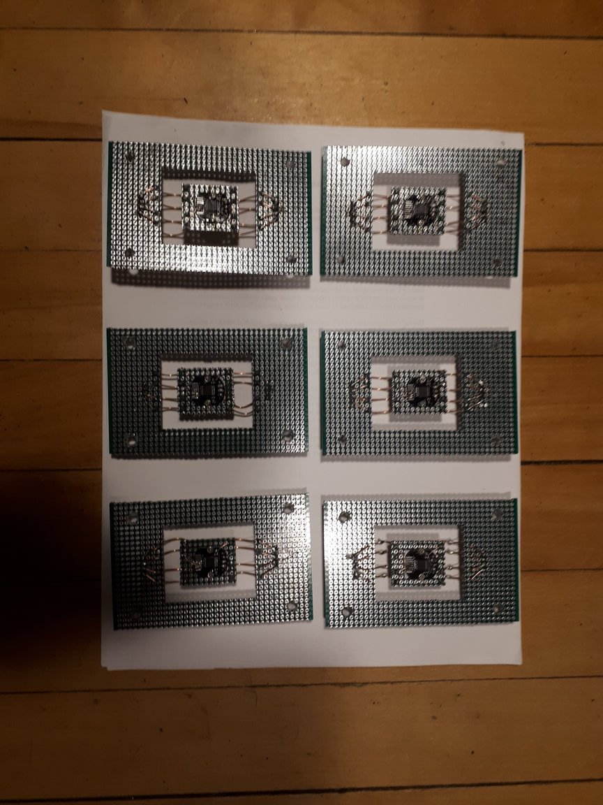

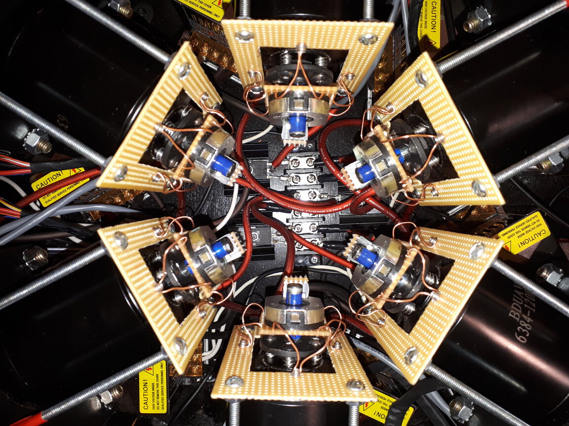

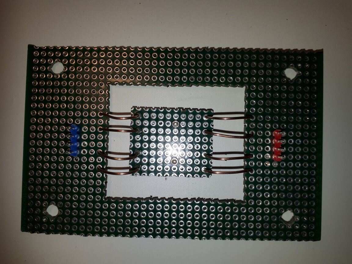

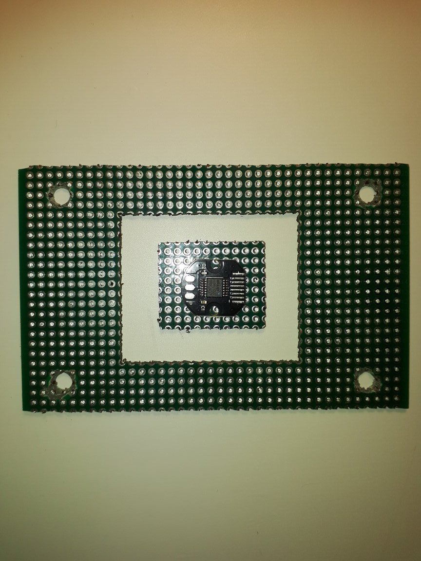

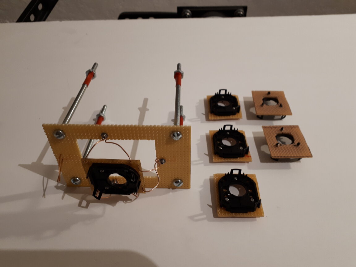

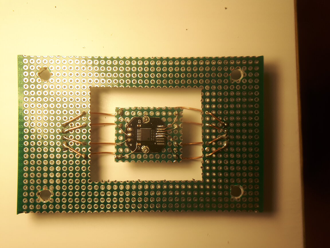

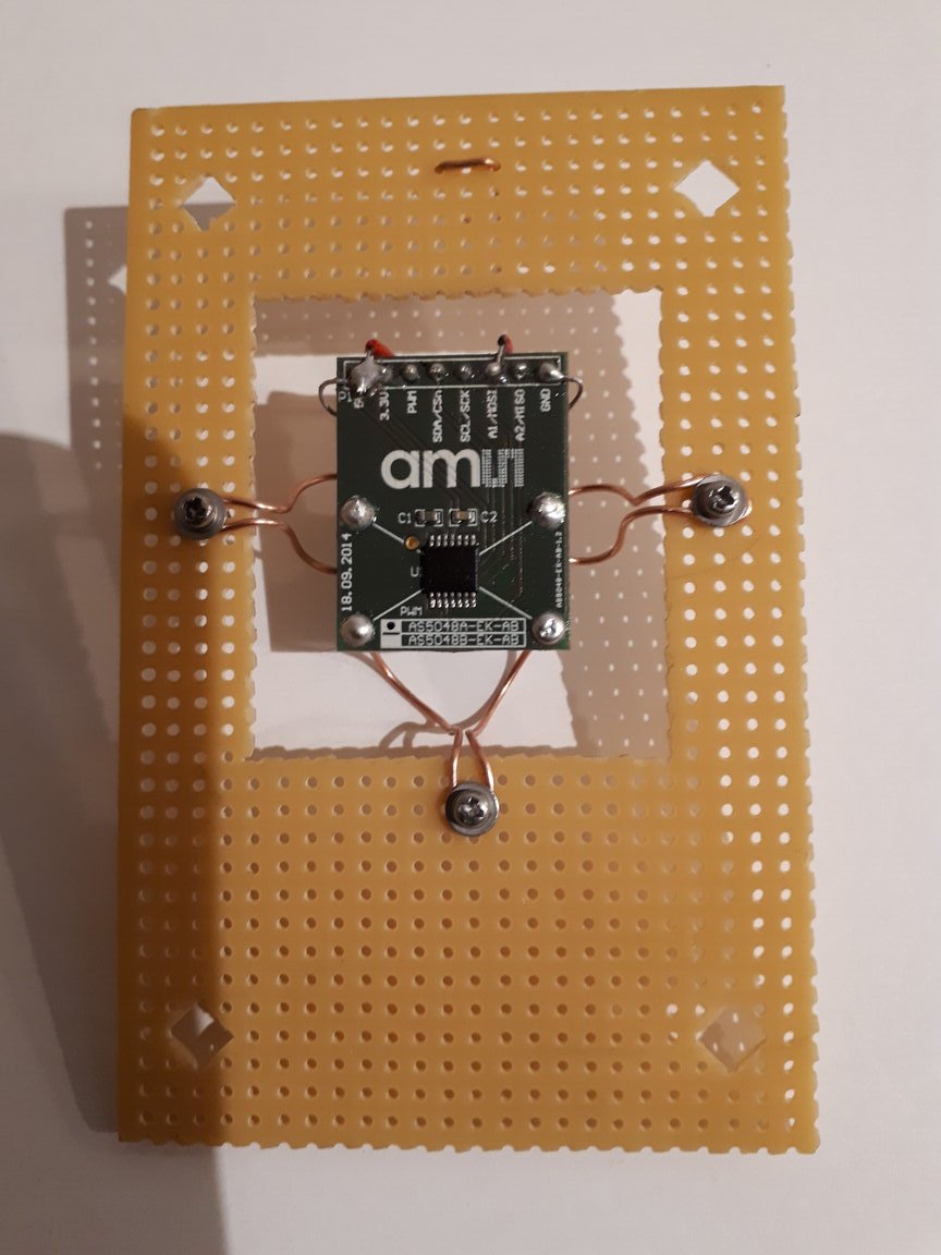

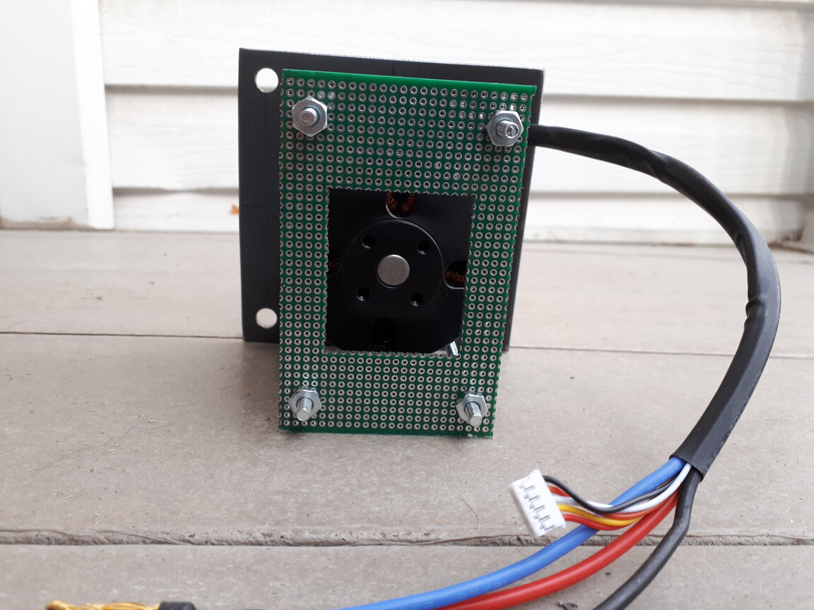

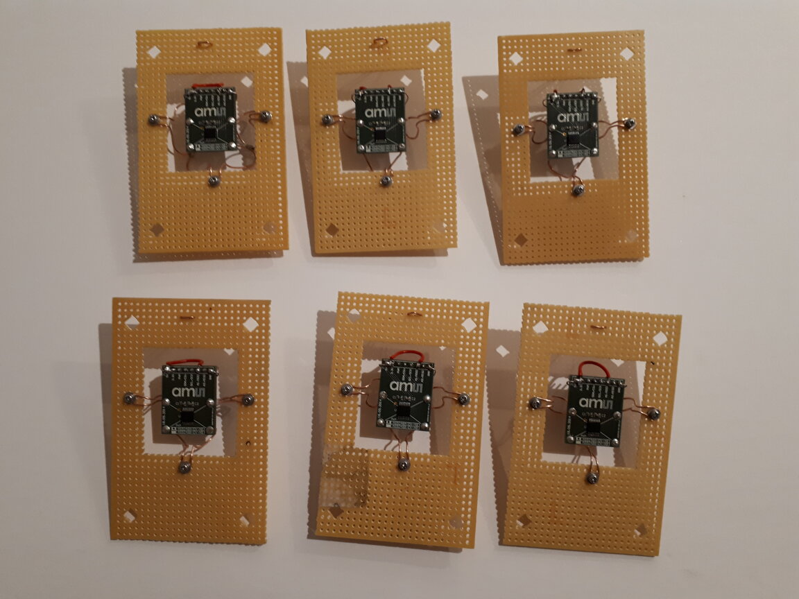

    Initially I opted for AS5048A magnetic encoder. This how I thought to mount them on the motors.
  6. kunkurus
    Oct 10, 2019
    27
    Canada
    263Coins
    +63 / 2 / -0
    DC motor, 6DOF

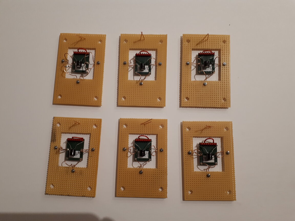

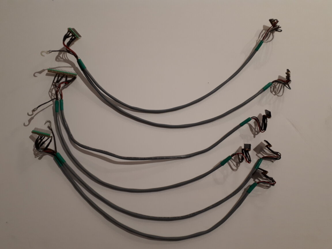

    The problem with AS5048A encoder is that it is affected by electrical noise. I tried using shielded cables for the connection to ODrive but no success. I had always encoder errors difficult to solve. After multiples attempts, I abandoned this path and choose AMT-103 CUI encoder.

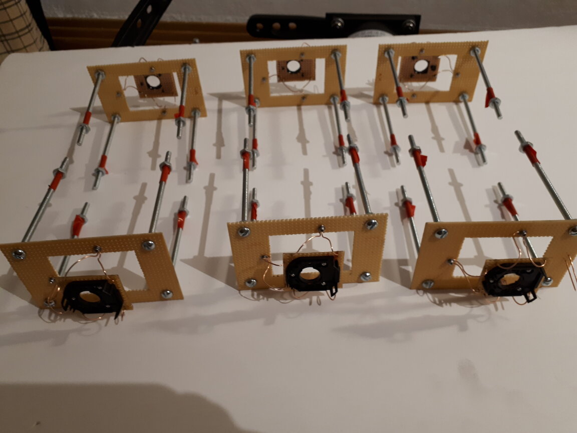

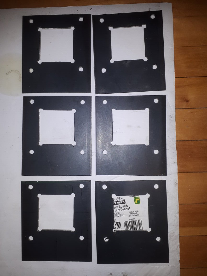

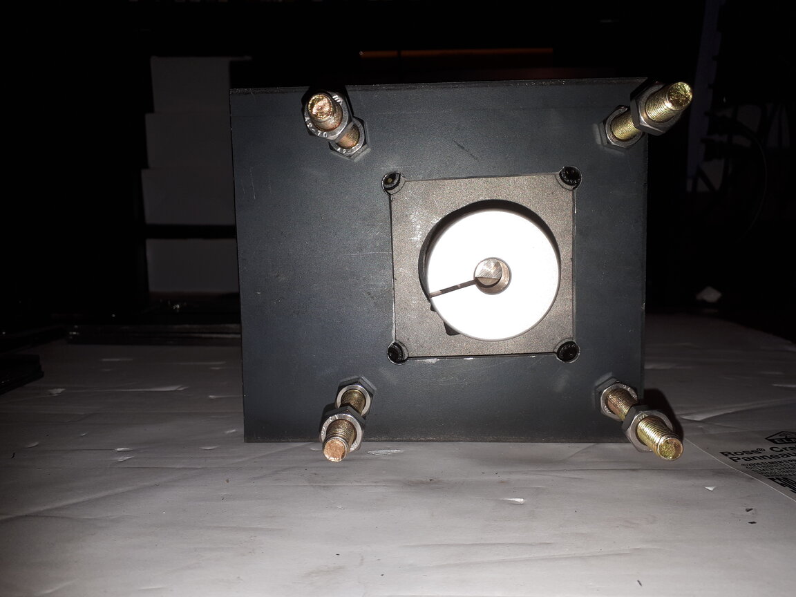

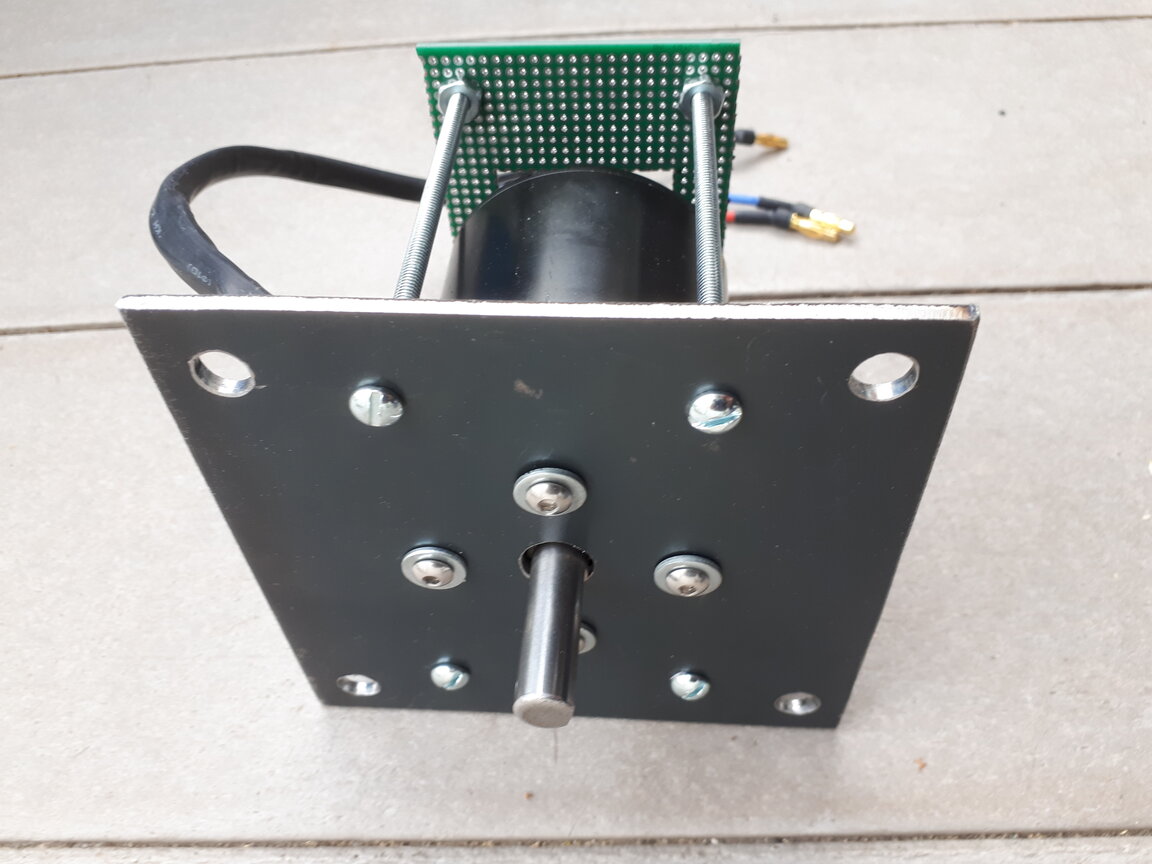

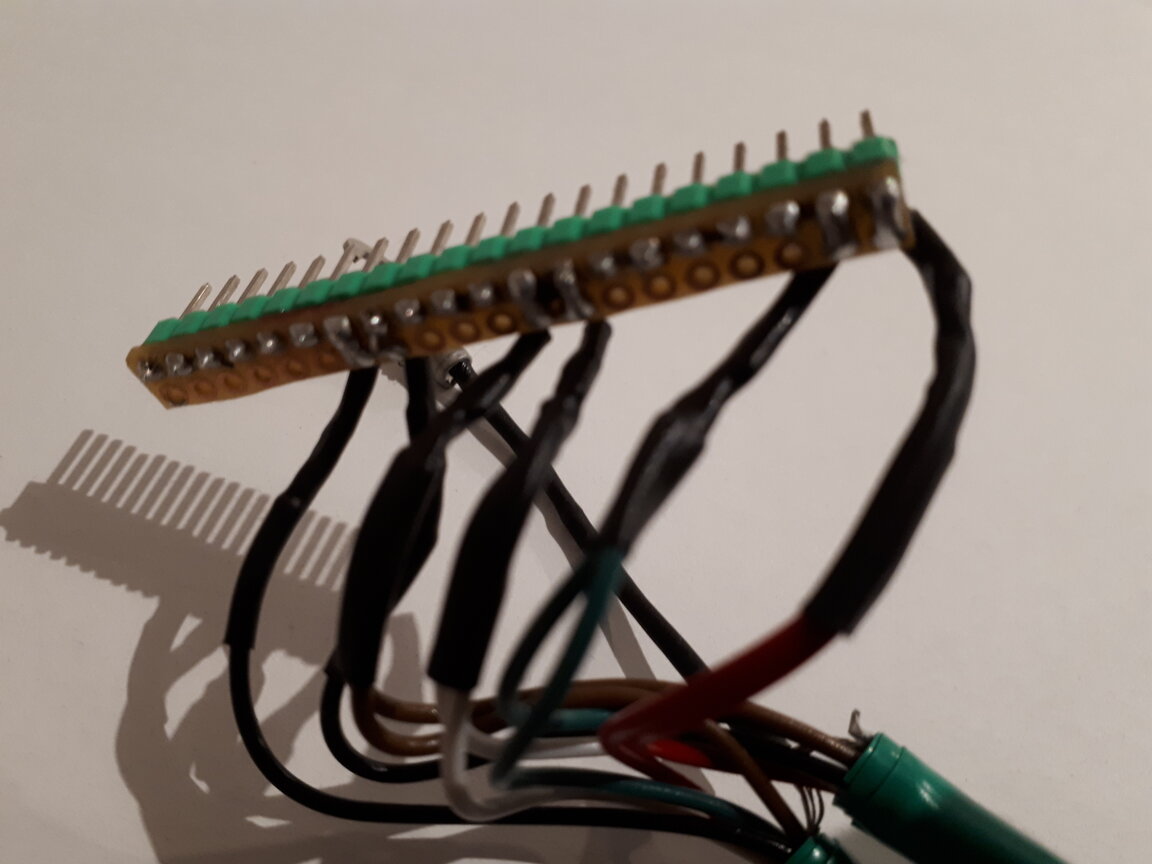

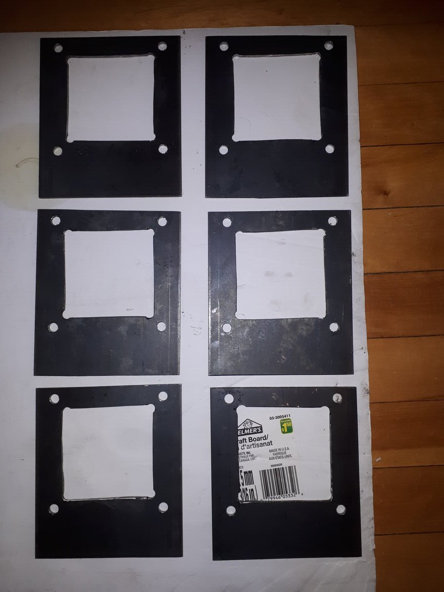

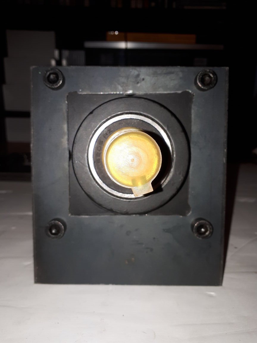

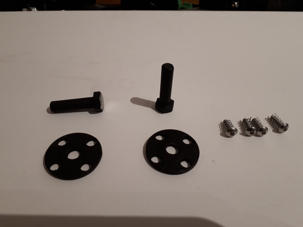

    Because the motors are not dual shaft, I needed to add the missing shaft for AMT-103 encoders and change the mounting plate for the new encoders.

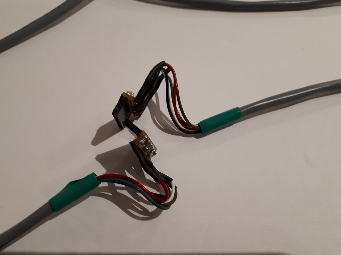

    Some lessons learnt from my attempts to use AS5048A magnetic encoder.
    1. Read the specs in detail before attempting to use it in your project. If you think having difficulties respecting the specs, go with another option.
    "The AS5048 sensor should be centered on the middle of the package with a tolerance of 0.5mm. The airgap between the magnet surface and the package should be maintained in the range 0.5mm to 3mm. The magnet holder must not be ferromagnetic. Materials as brass, copper, aluminum, stainless steel are the best choices to make this part."
    2. Use high quality flux paste for soldering. There are soldering flux paste that become conductive when burnt.
    3. Clean the flux paste with isopropyl alcohol before checking for short-circuits.
    4. When verifying for short-circuits do not use your digital multimeter in continuity mode only. Check using the resistance mode also. A resistance of 100Ko does not register in continuity mode but the encoder can malfunction because of that. The resistance between isolated conductors/terminals must be greater than 1Mo to be sure.
    5. Be prepared for failure at any time
    This was my last attempt to use AS5048A encoder from Mouser instead of Aliexpress. I had a surprise when I found that one of the Mouser encoders was DOA.

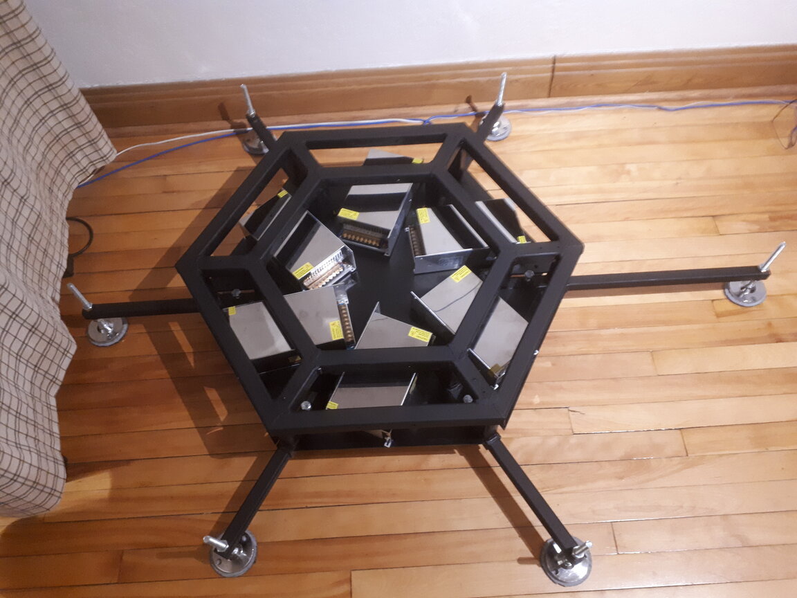

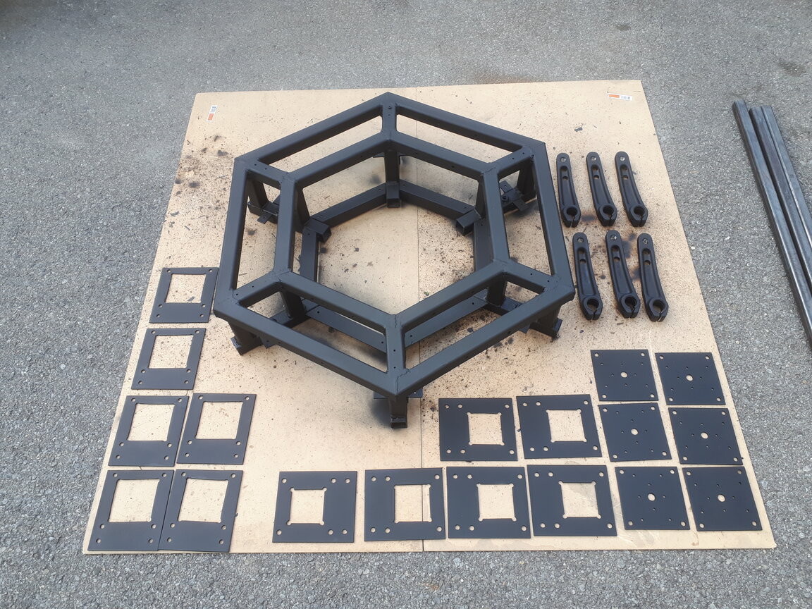

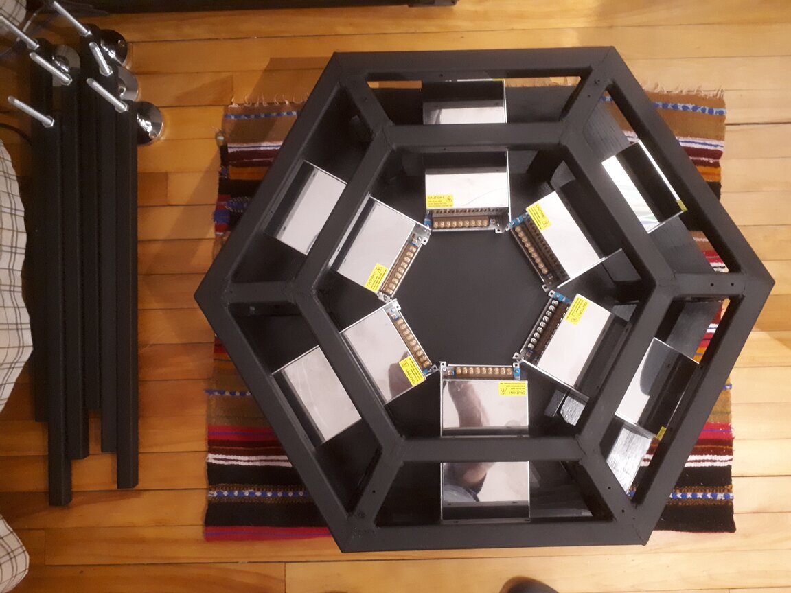

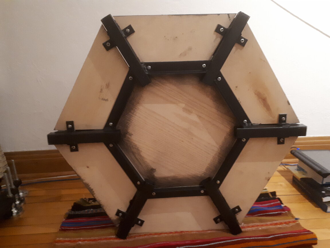

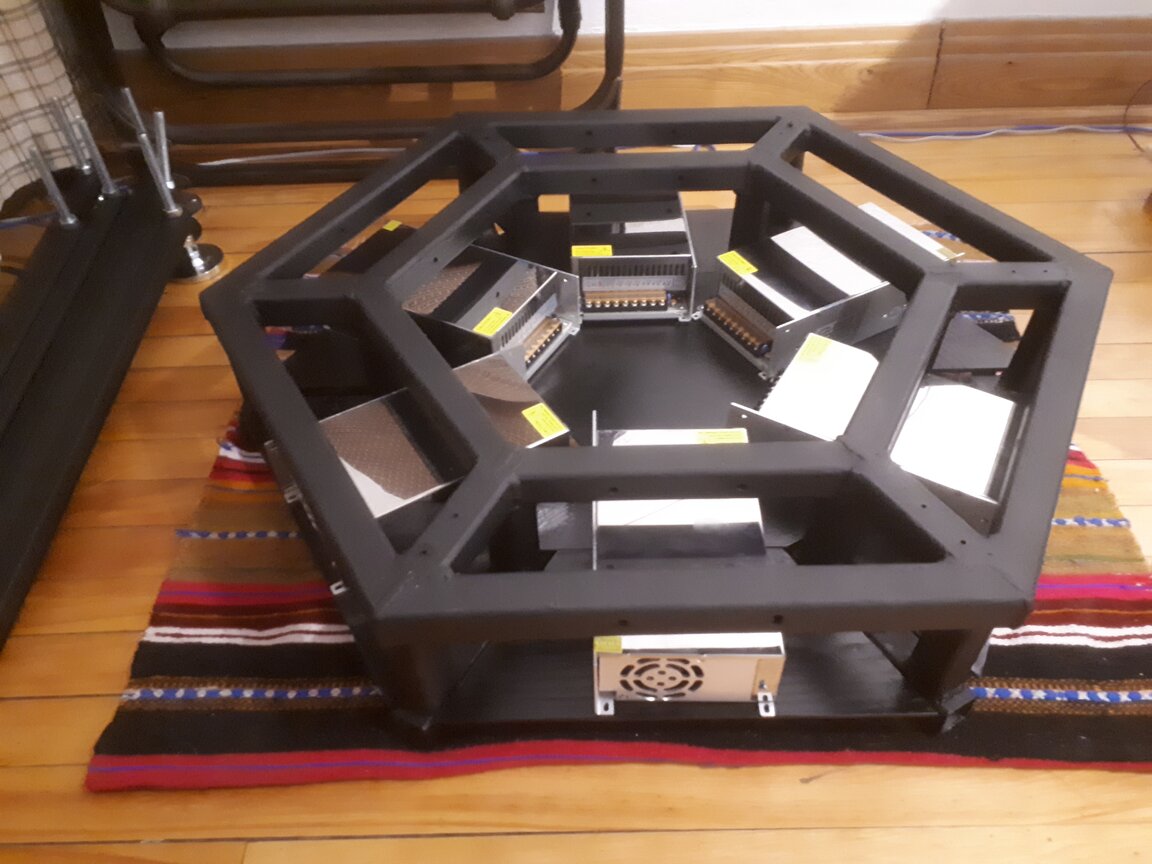

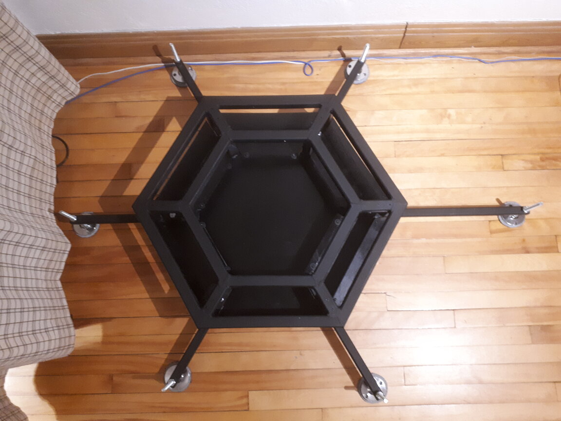

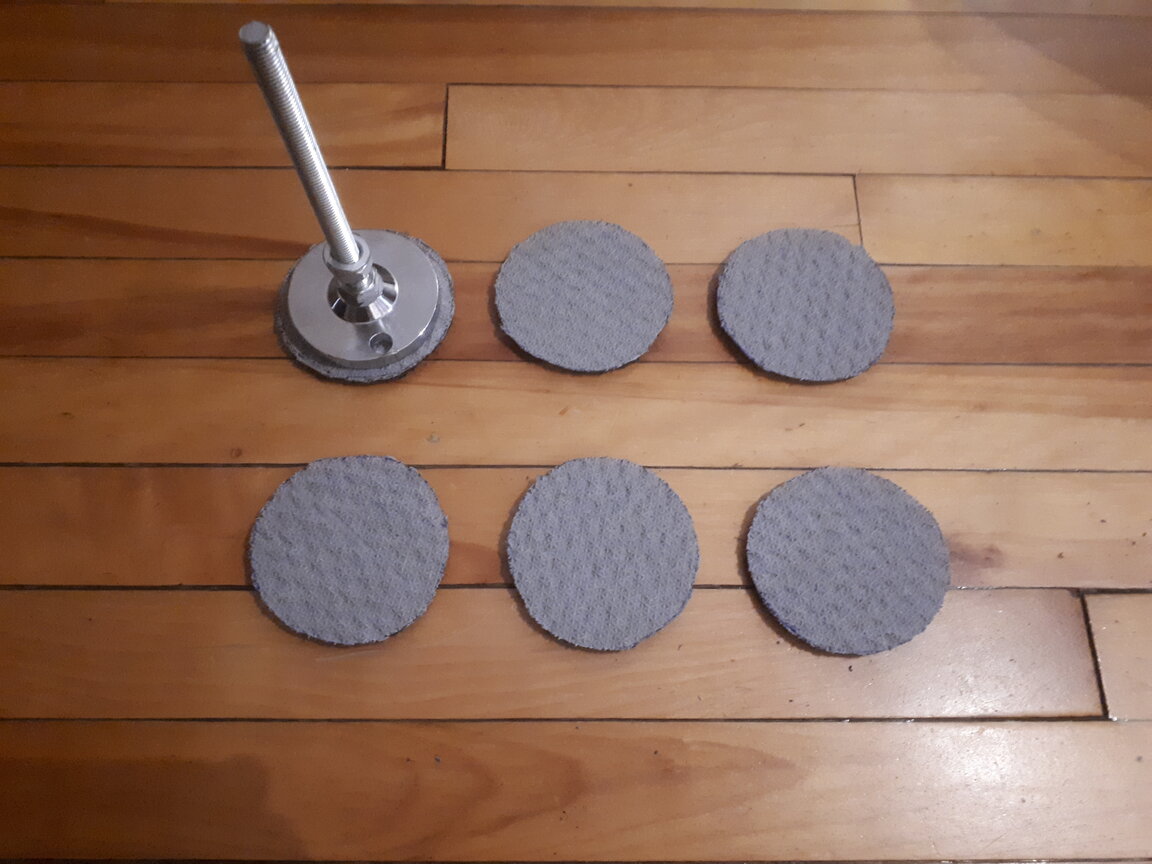

    Working on the base... The legs are ajustable. I'm using 6 LED power supplies 36V 1200W 110/220V from Aliexpress.
    • Optimistic Optimistic x 1
  10. kunkurus
    Oct 10, 2019
    27
    Canada
    263Coins
    +63 / 2 / -0
    DC motor, 6DOF

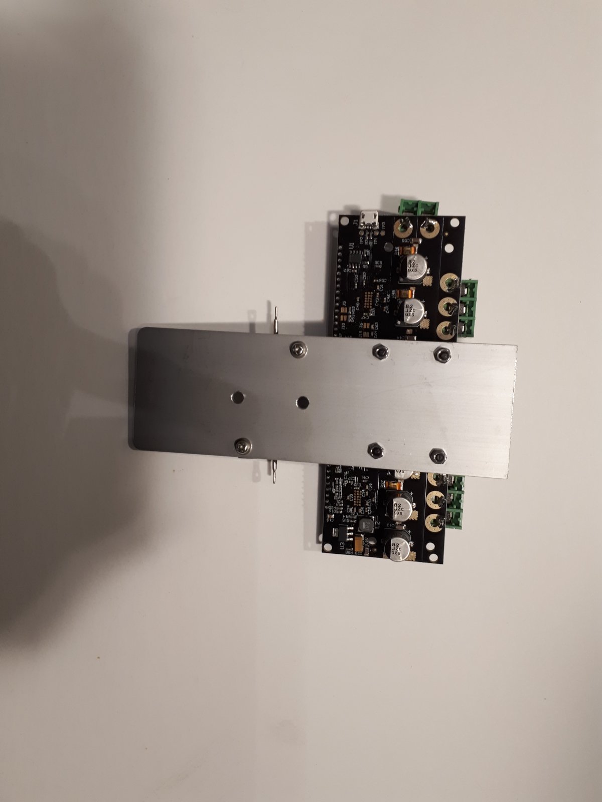

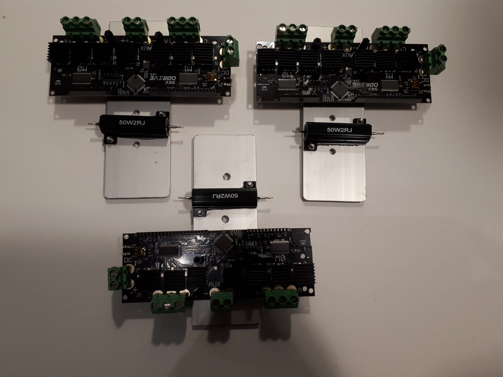

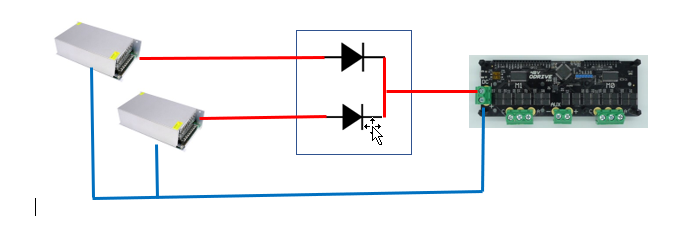

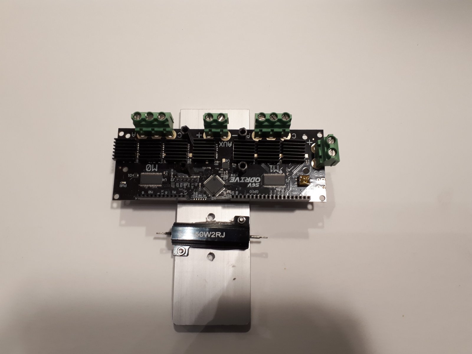

    Where I live, the max power at the outlet is 120Vx15A. Converted to 36V gives me only 55A (1980W). I need two separate circuits to have 110A x 36V = 3960W for all the drives.
    ODrive can drive two motors from one power supply. I needed to use two powers supplies for each using schottky diodes – DSA90C200HB - https://www.mouser.ca/datasheet/2/240/DSA90C200HB-1547547.pdf
    When working, the power supplies were very loud and I changed the fans for Noctua NF-A6x25 to reduce the noise.
  11. kunkurus
    Oct 10, 2019
    27
    Canada
    263Coins
    +63 / 2 / -0
    DC motor, 6DOF

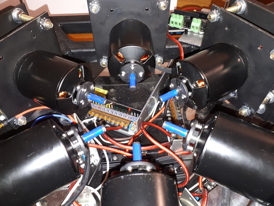

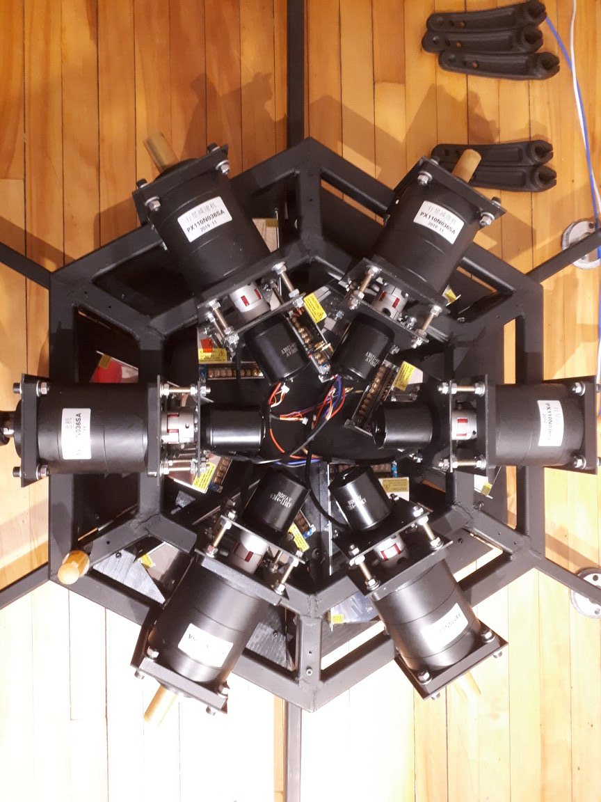

    Mounting ODrive and the full assembled base.

    Got to ask.. Where did you get those levers.?

  15. kunkurus
    Oct 10, 2019
    27
    Canada
    263Coins
    +63 / 2 / -0
    DC motor, 6DOF

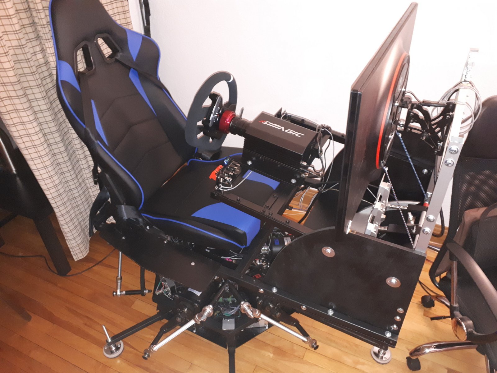

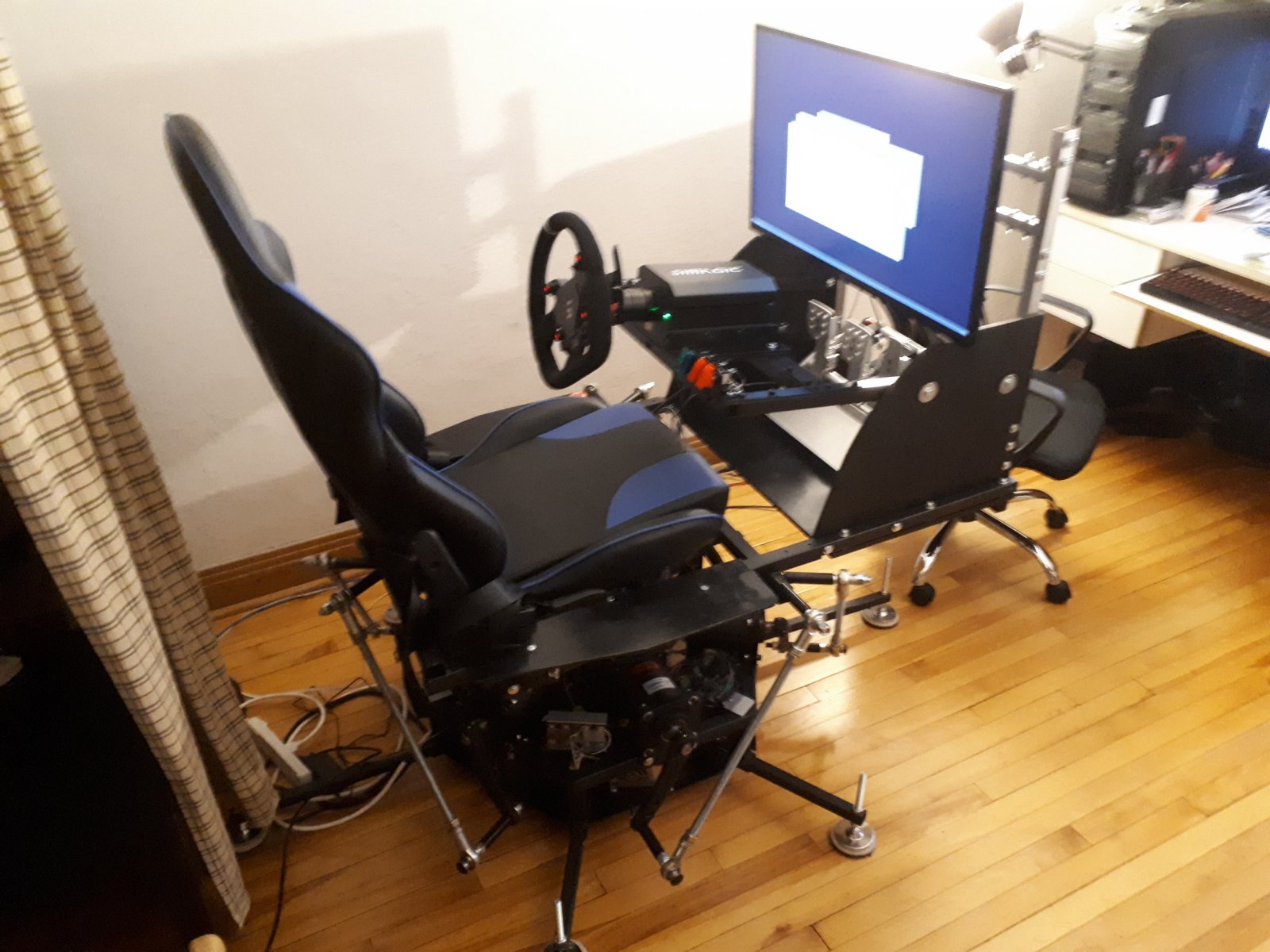

    IMG_20201010_163841.jpg IMG_20201010_163852.jpg The final result.
