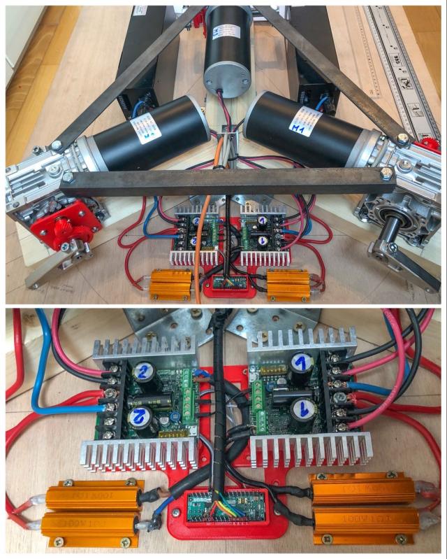

    - 4 DC motors (400W) with reduction gears
    - 2 Sabertooth 2x32
    - 2 24V 40A 1000W power supplies
    - Arduino Micro
    Most of the motion stuff wiring is now done. I will soon power it up to do the first settings and tests (without the top platform). The 4th motor at the back is for the traction loss effect.

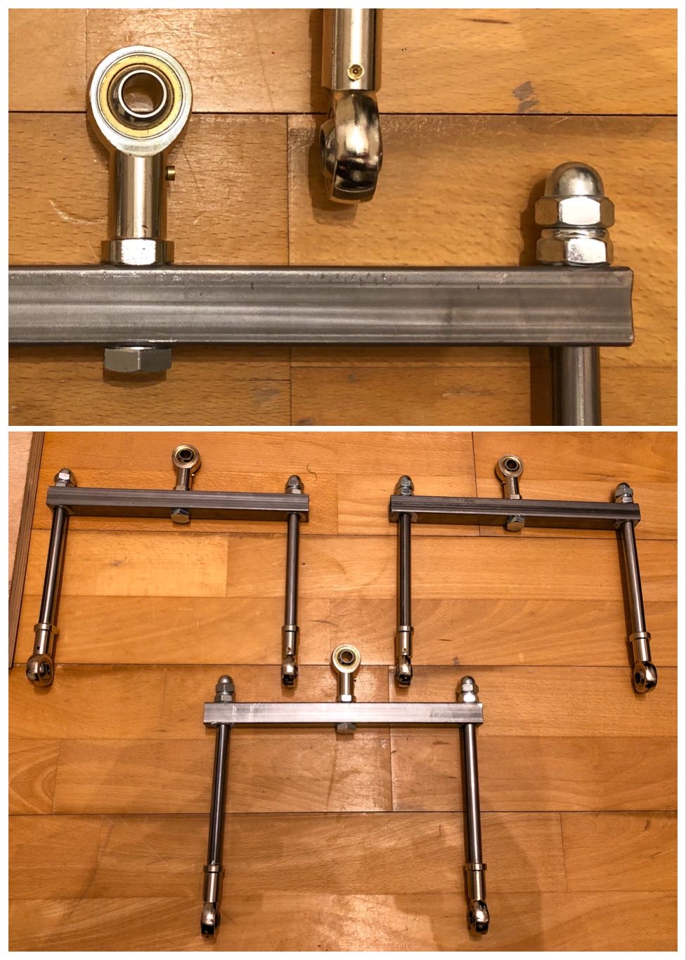

    Today I made the 3 connectors:

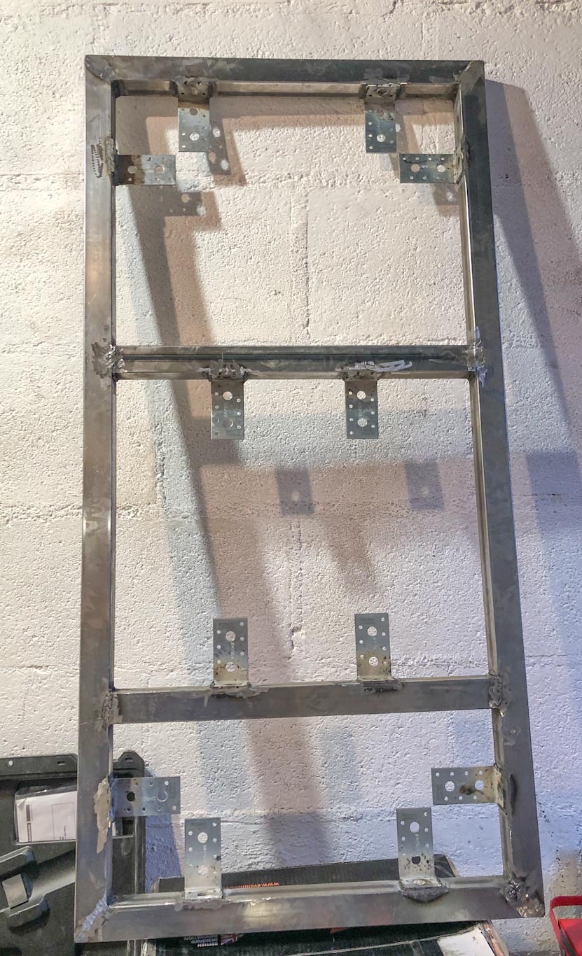

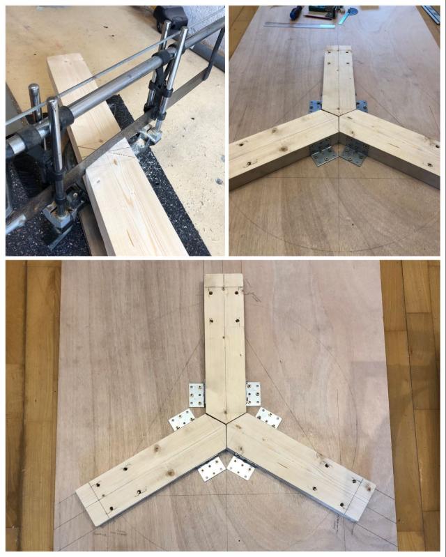

    Mobile chassis is now done. I’m a noob in soldering, so I hope it’s gonna be solid enough ;), it should (40mm steel tubes).

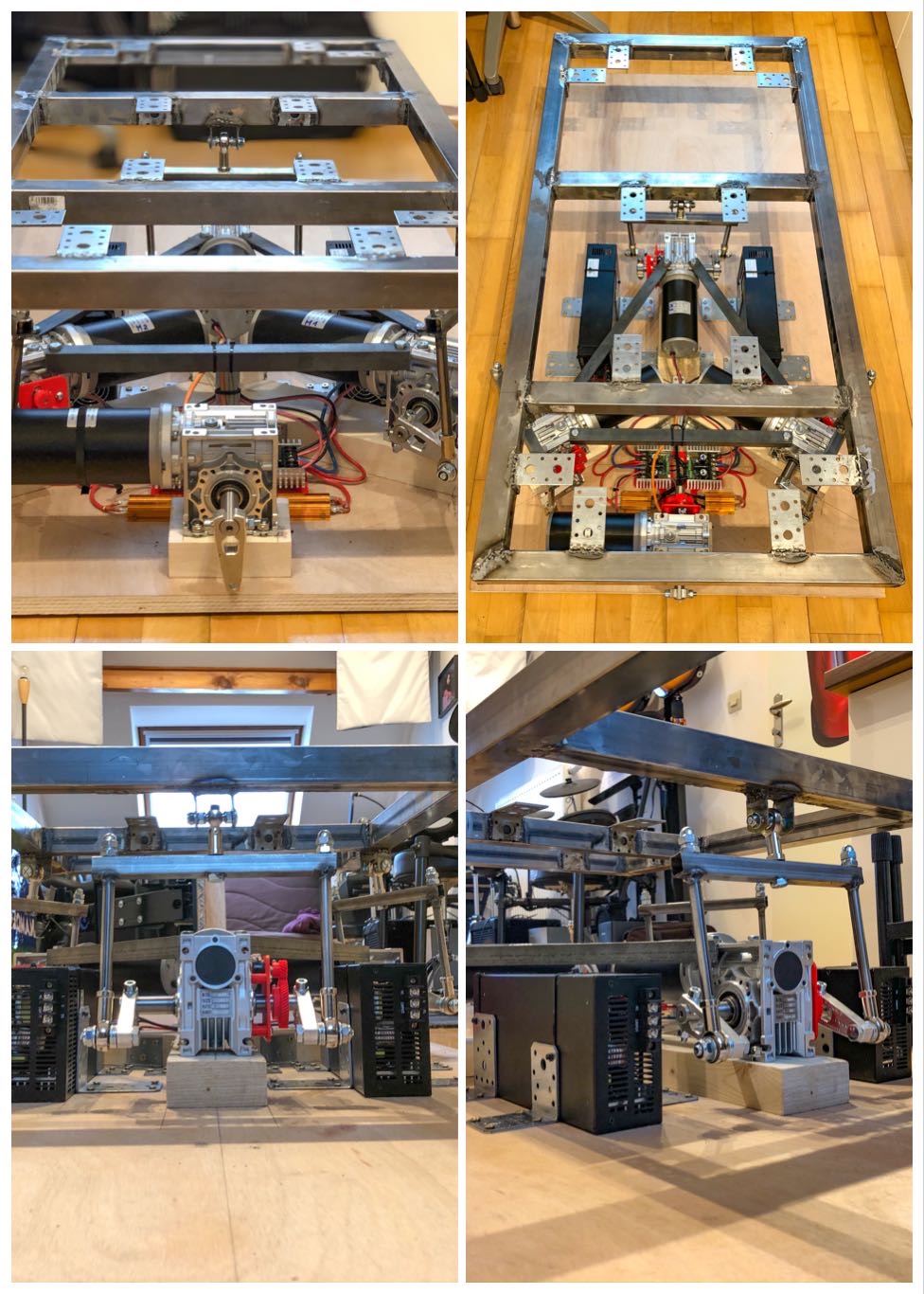

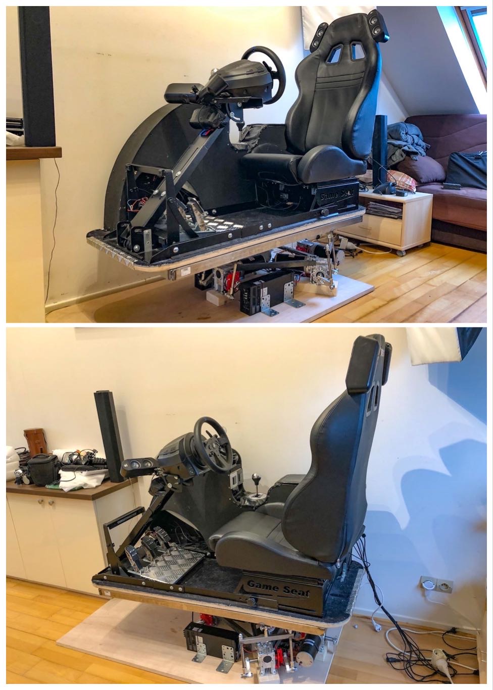

    Chassis is now installed, everything fits perfectly, I’m happy :)

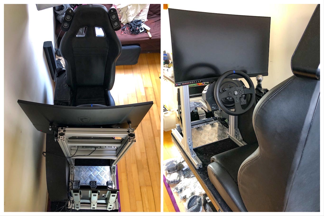

    I’ve just positionned my original cockpit on the dynamic chassis to have a global look at it. Everything on the cockpit will be lowered (seat, wheel, gearbox, and probably the pedals by making a case under le metal chassis.

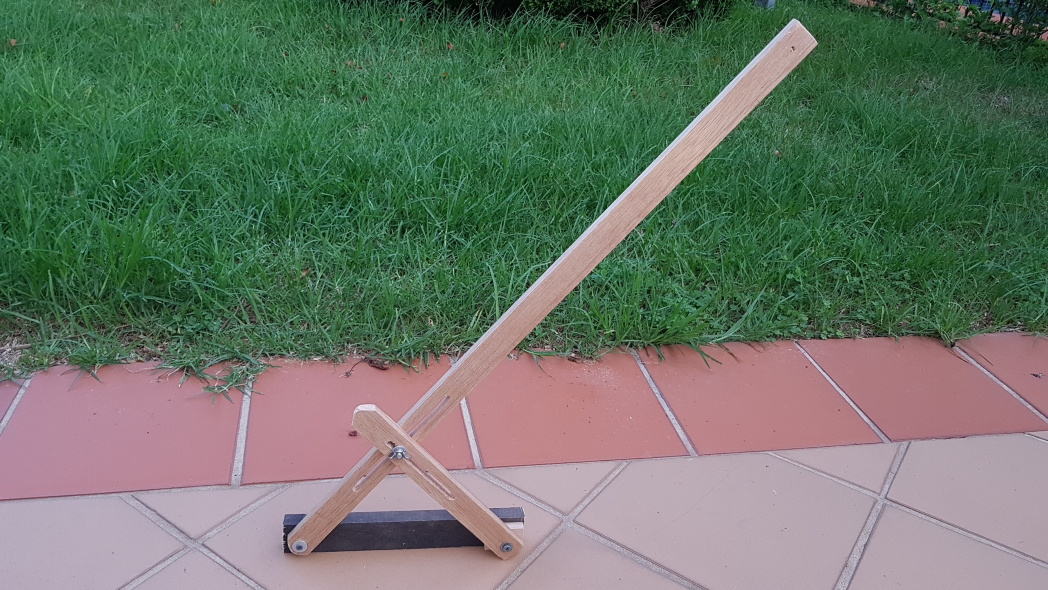

    Thanks mate. Users of my car racing motion sim ranges from 4 to 85 year old!
    Since it's not practically possible to move the seat due to it being solidly fixed to the uni joint and the actuator rods.
    Instead, I wanted to make the pedal and the wheel to be able to move in both horizontal and vertical directions.
    I tried the scissor lift arrangement by first making one with timber to get the geometry correct (ScissorLift.jpg). It didn't work out well.
    So, I am now trying with the mild steel 25 mm SHS (Square Hollow Section) and 20 mm SHS. The 20 mm SHS glides easily with in the 25 mm SHS. One pair for the vertical and another for the horizontal directions. They can be moved independently and held in place by a bolt and wing nut inserted via a series of holes spaced every 50 mm.

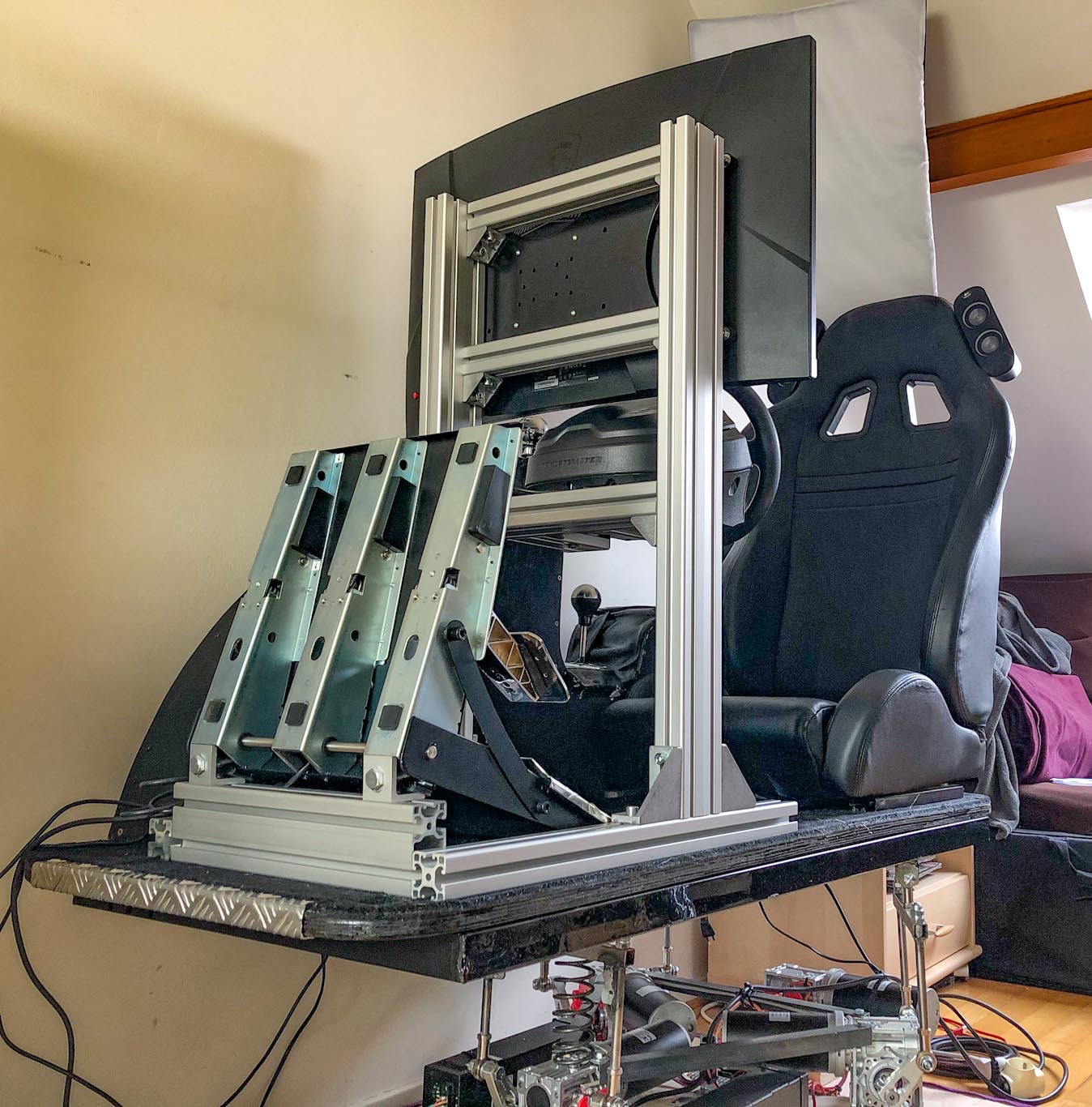

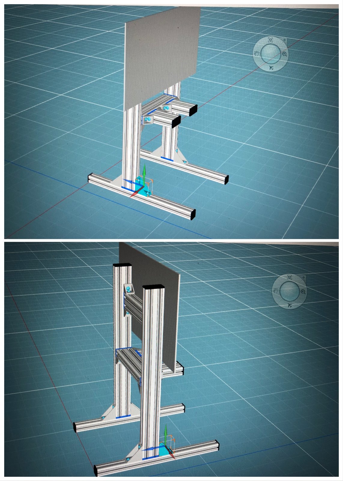

    Progression : 1st dynamic test ;)

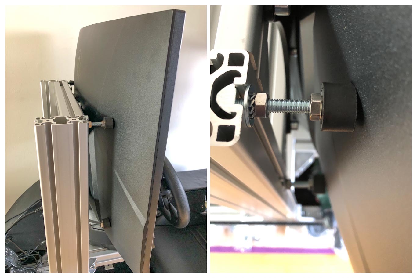

    cockpit design has been made, and extruded aluminum ordered.
    Seat and « furniture » have been lowered to meet dynamic requirements:
    Next steps: re wiring of audio transducers, 5.1 sound system, wheel, pedals etc... and aluminum stand mounting. I have a 32inch curved screen also.

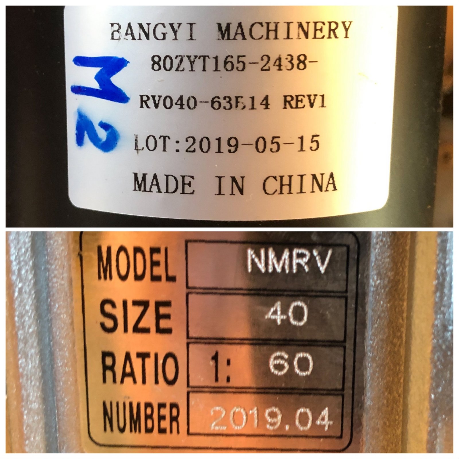

    Pls tell me nominal RPM of motors and gearboxes' ratio.

    DD6AB224-2E3E-47F0-BAFC-13C1CD6AD330.jpeg Hi victor, here are the motor references:

    I’m mounting the cockpit right now:

    Mate, I noticed that in your recent picture, there is a spring (looks like a car suspension coil spring) underneath the seat platform. What's the purpose of this spring?
  14. the2jakes
    the2jakes Member Gold Contributor
    Jul 19, 2009
    44
    125Coins
    +39 / 0 / -0
    DC motor, Arduino, 4DOF
    Hi, there will be 3 of these springs. They help the motors a bit, because they support a part of the weight.

    Well I don’t know. I weight 65kg and I had to drill the motor cranks at 5.5cm instead of 7cm because my mobile cockpit is heavy. Now it’s perfect, no motor stall anymore.
