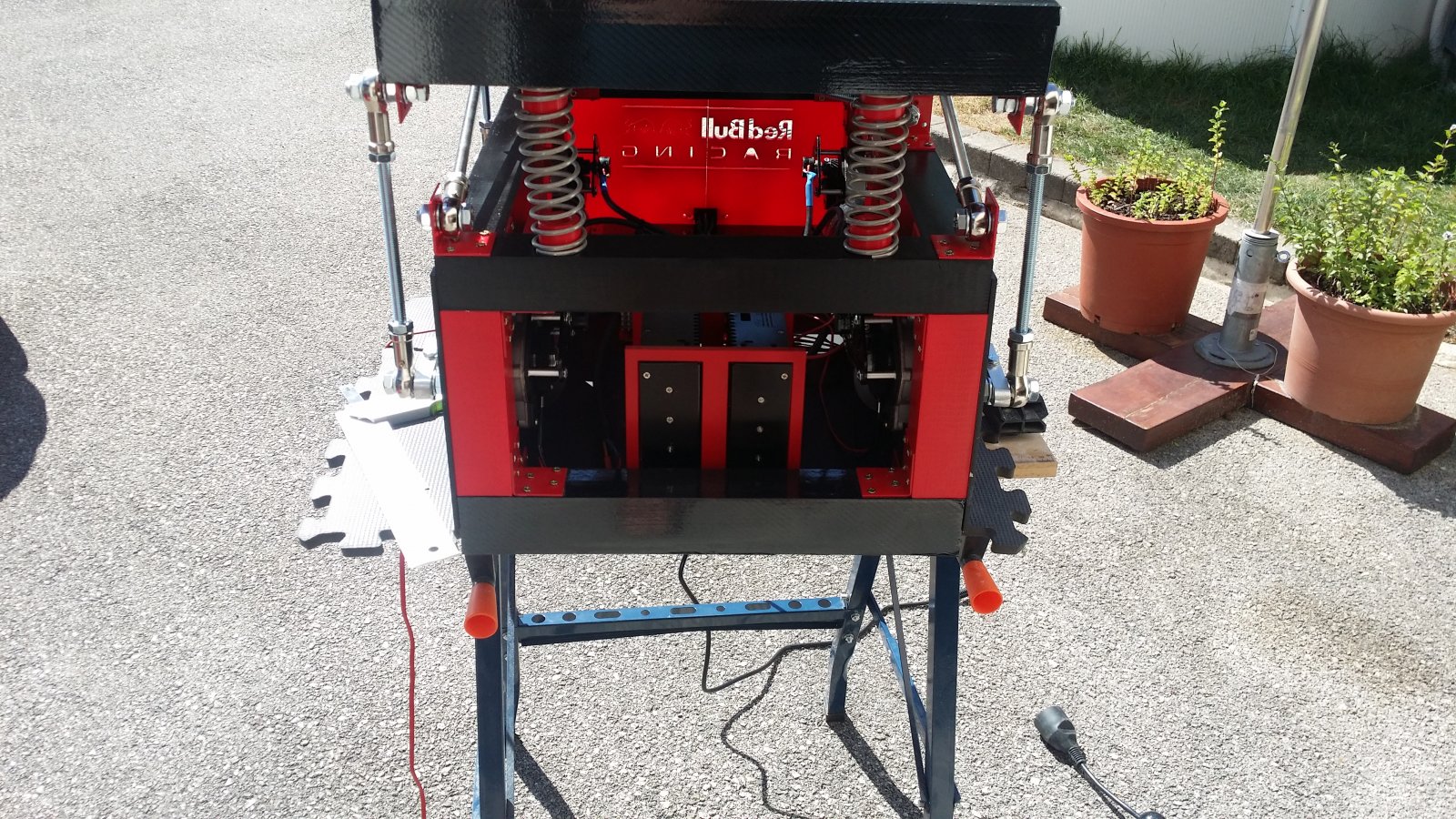

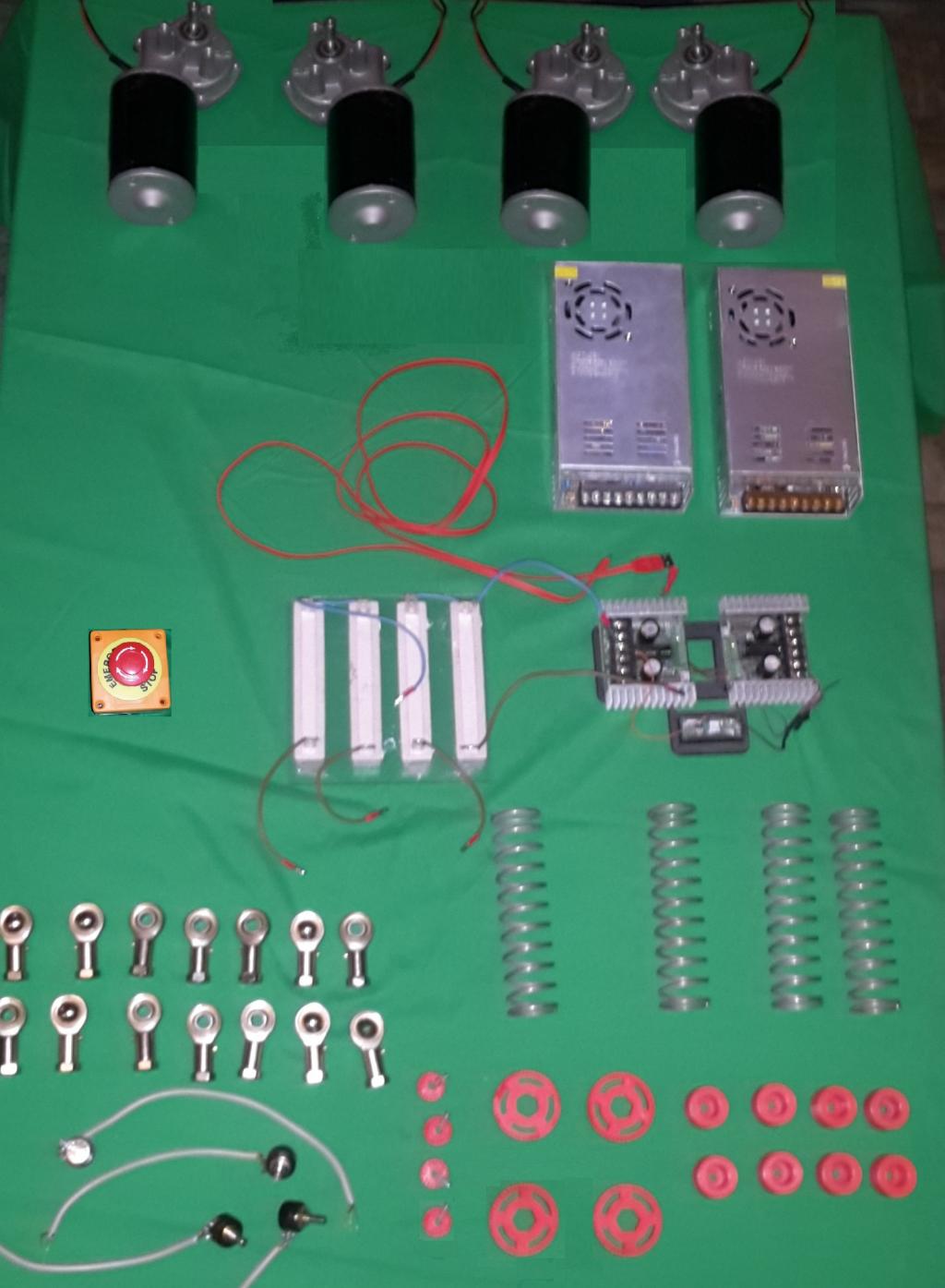

    After 5 years of good and loyal service of my 2 Dof, it is following the purchase of a 3 dofs kit that I decide to redo a new simulation.
    This is the k[​IMG]it:

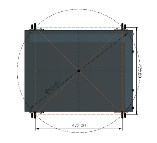

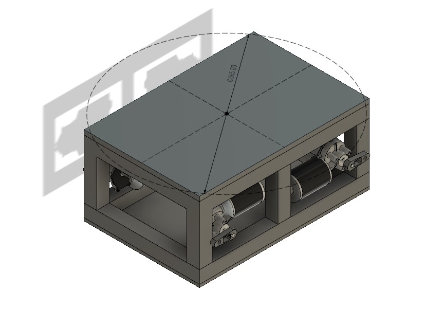

    I started to draw my project in order to prepare the necessary material and redo the parts damaged by the previous owner

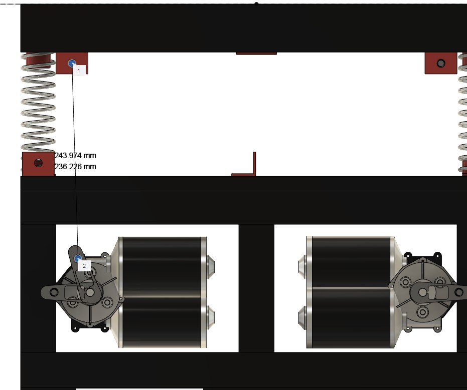

    Here, I finished my plans.
    The location and length of the connecting rods are defined

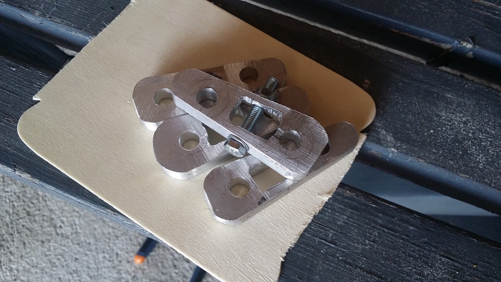

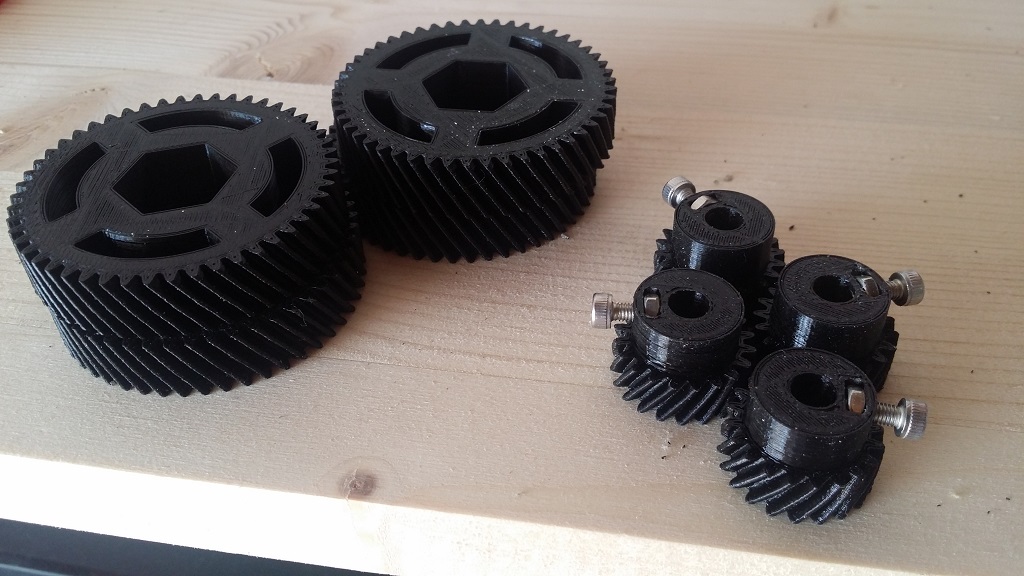

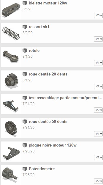

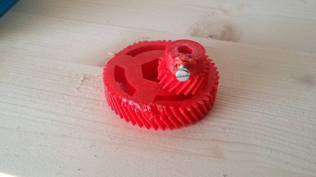

    [​IMG] As I indicated, I bought a second-hand kit, the cogwheels being damaged, I modeled and printed new wheels.

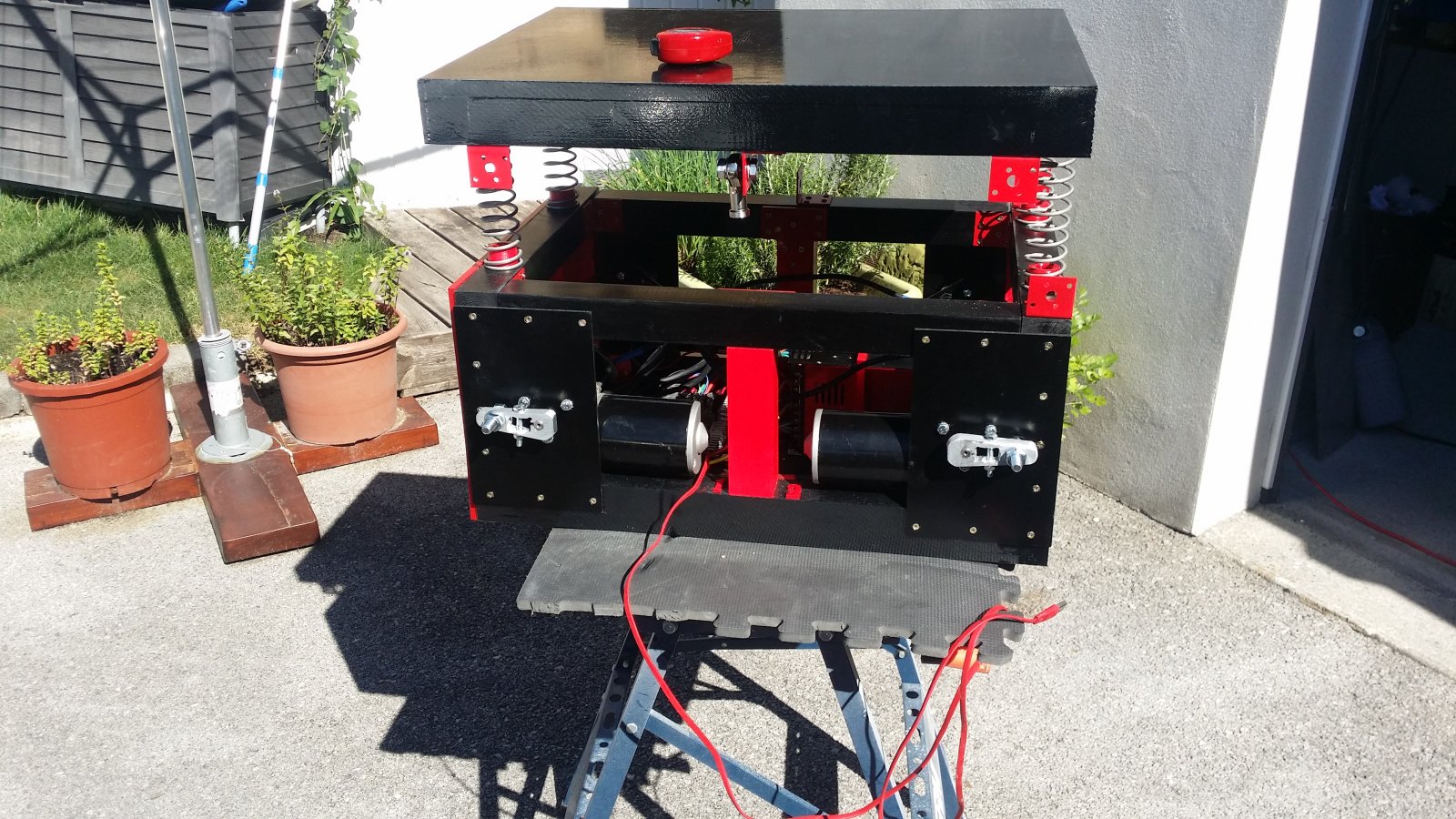

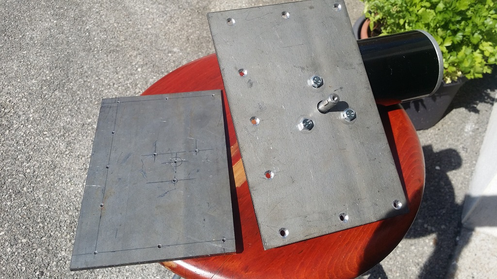

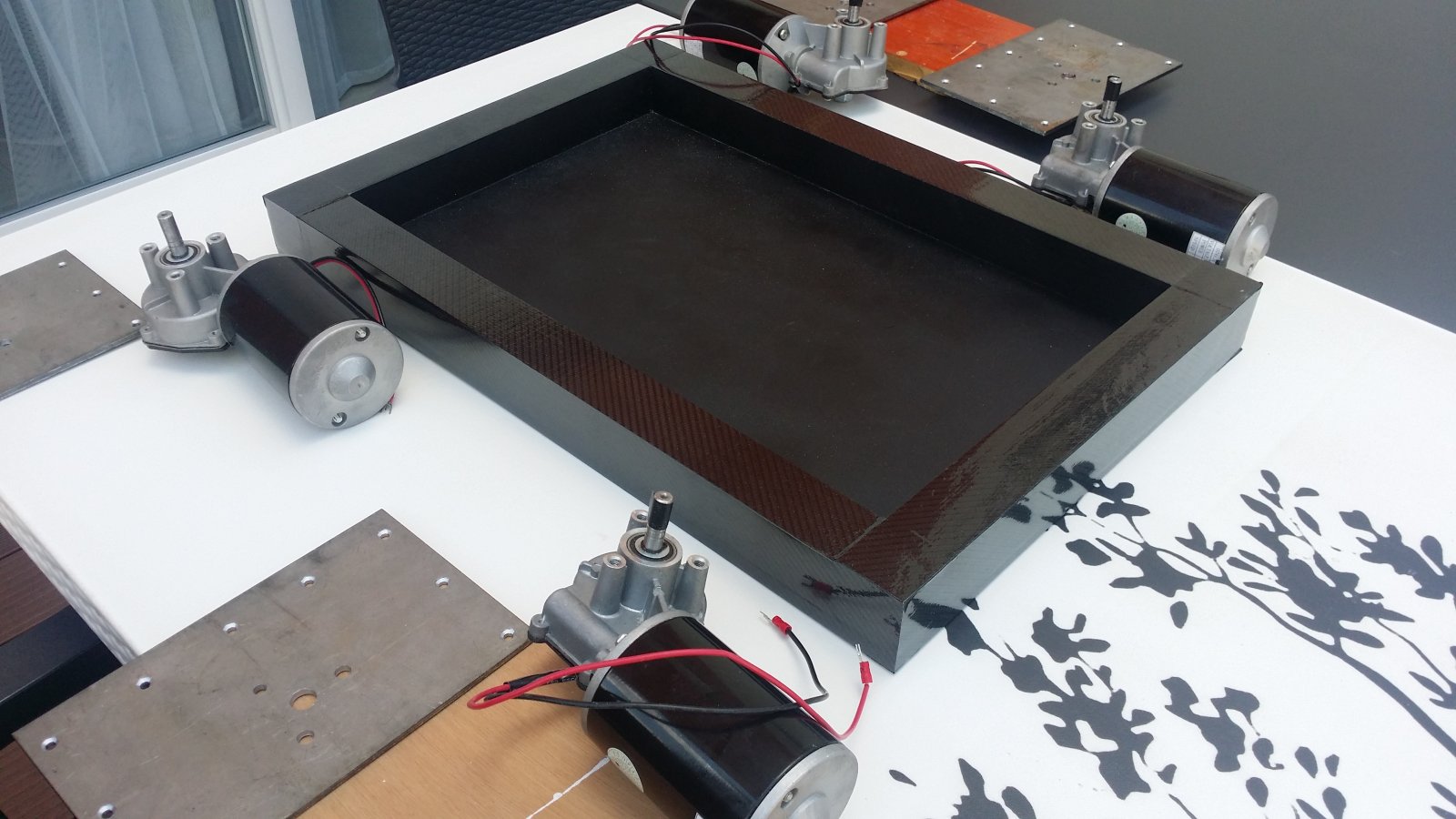

    Preparation of engine and cam supports.

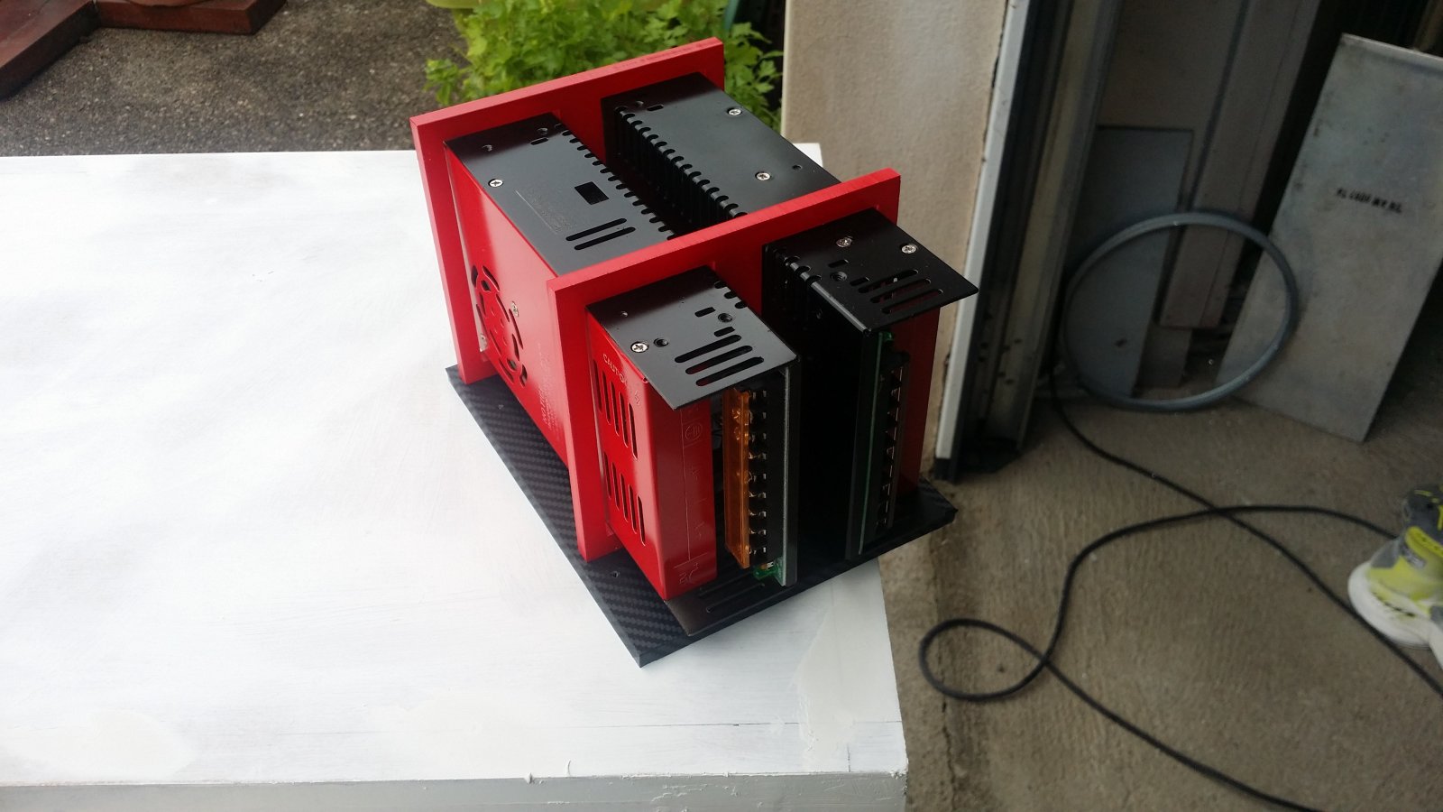

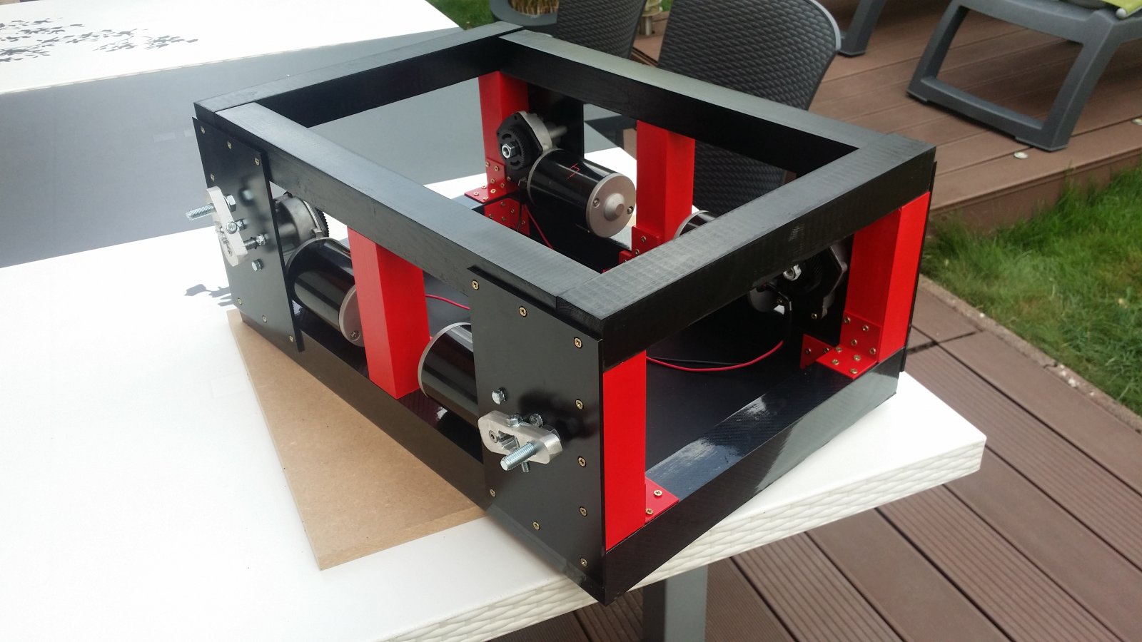

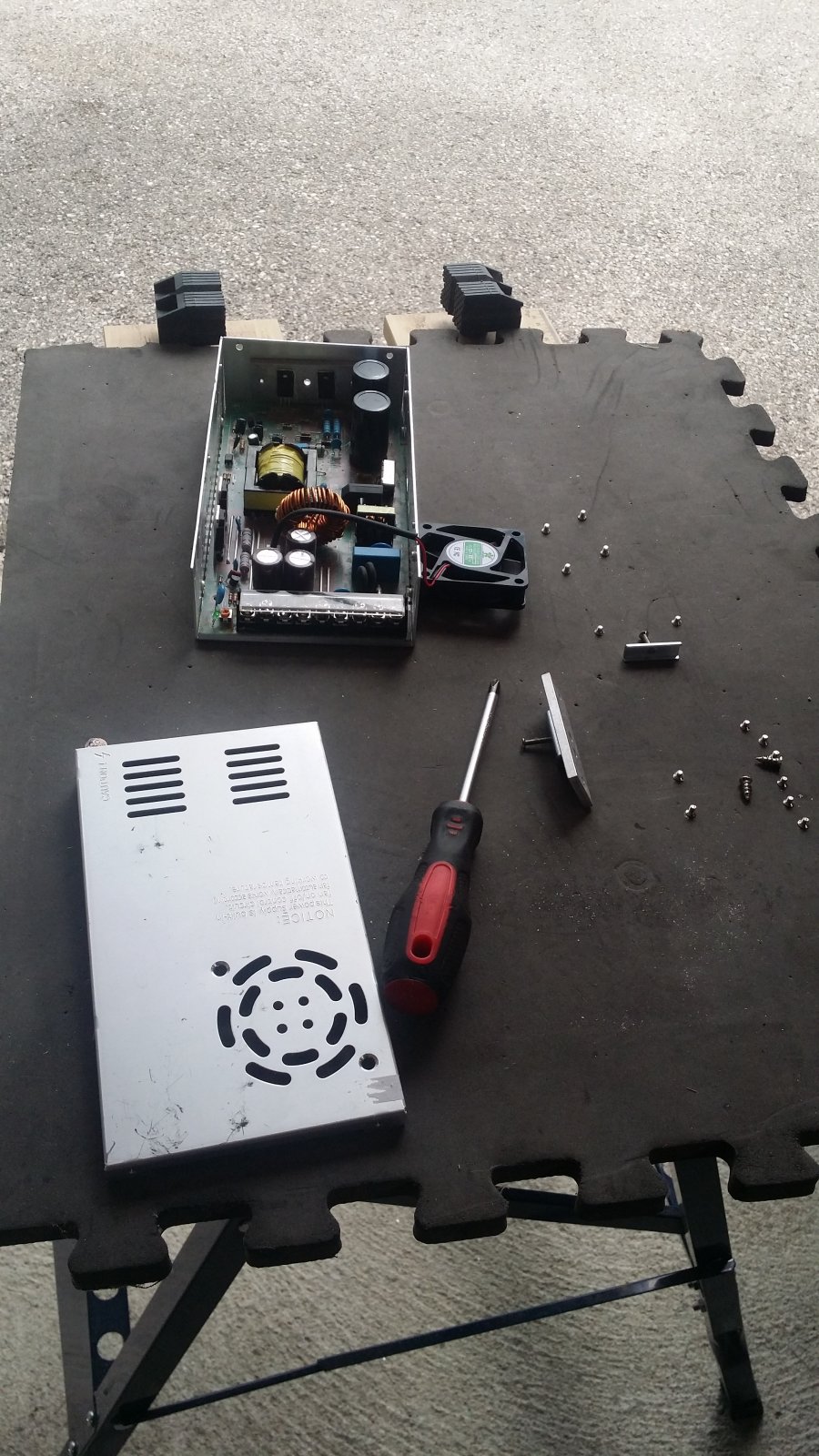

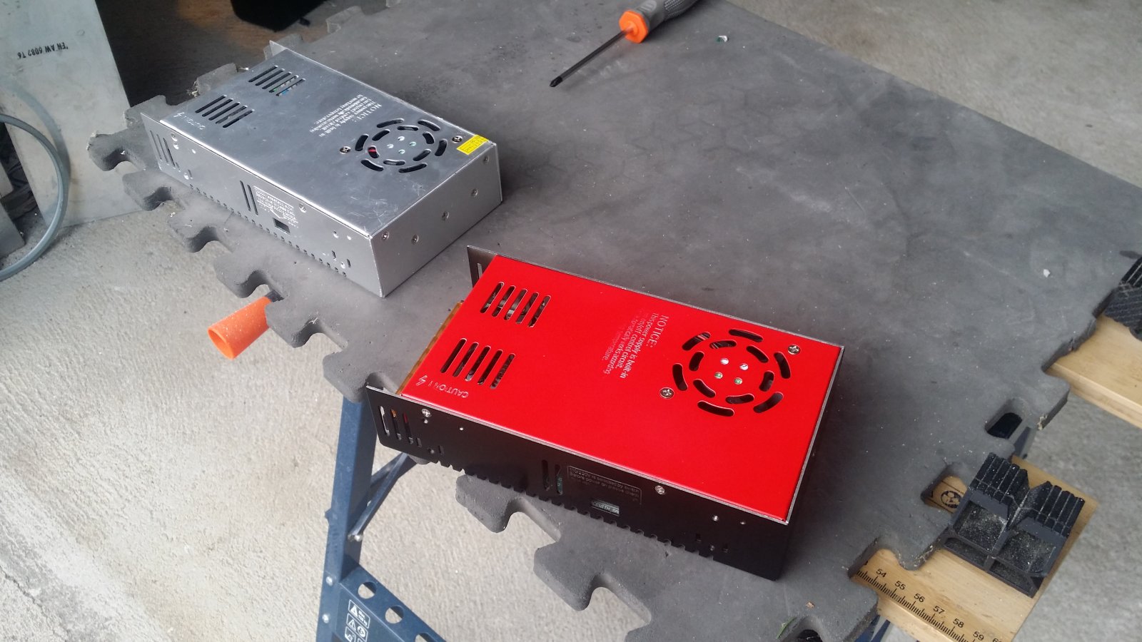

    Updated construction.
    for aesthetic reasons, I painted the power supplies

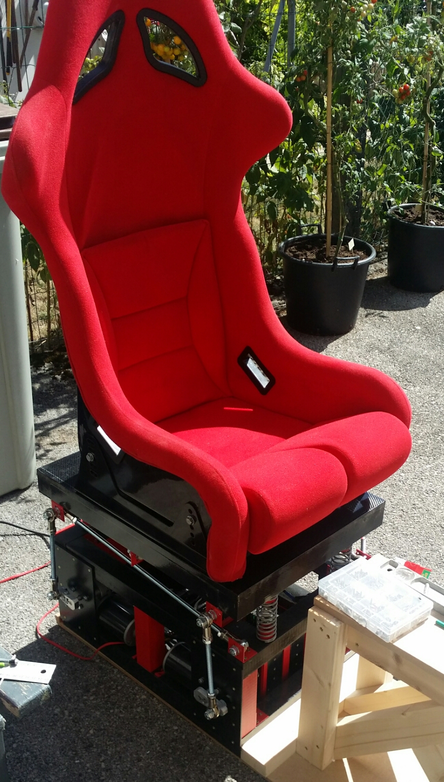

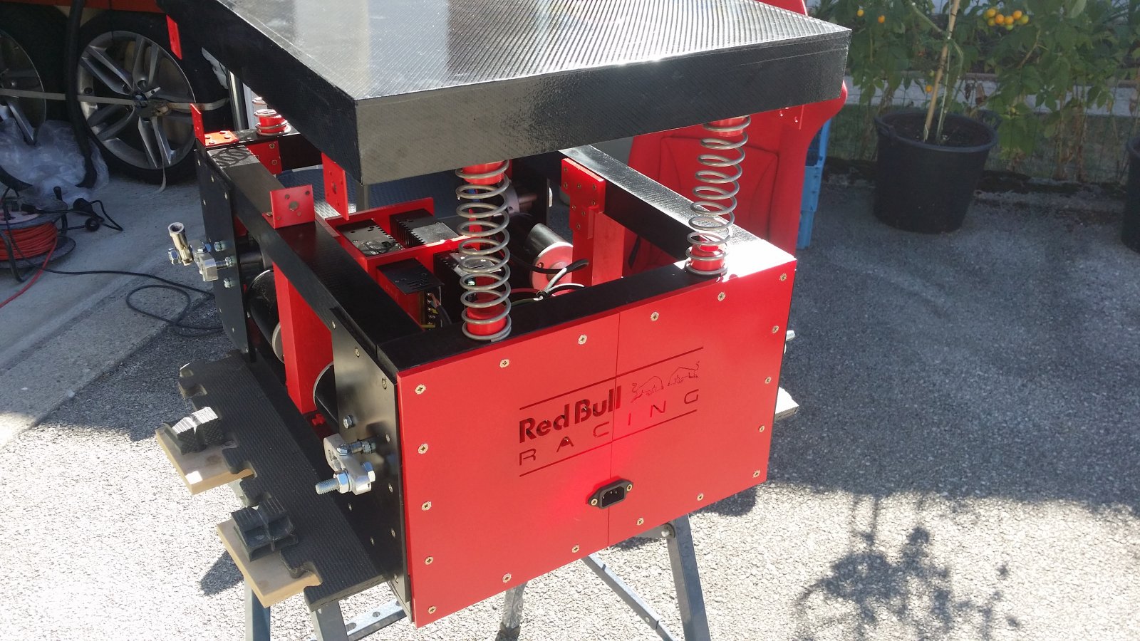

    Anti-twist bars, connecting rods and seat installed :) 20200919_095809.jpg

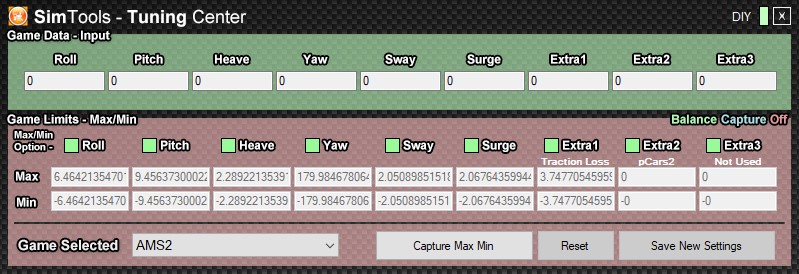

    First test this afternoon. The simulation works well.

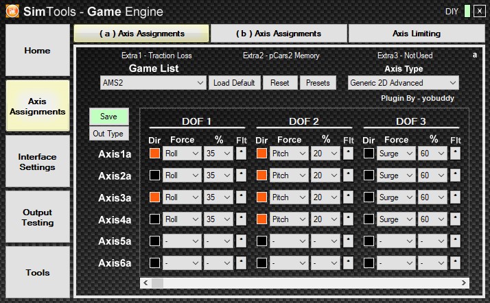

    For the settings, I find it difficult to understand the tunning center, because if, as indicated, I do a few laps by activating the max and min capture then by saving, my effects are almost zero then ...
    21,723
    152,051Coins
    +11,063 / 56 / -2
    Did you Save after capturing Min/Max?
  15. Lgars39
    Lgars39 Member
    Aug 13, 2015
    39
    Jura
    208Coins
    +17 / 0 / -0
    Yes, I saved well before stopping the capture.
    I'll relaunch the game and send you the pictures.
    thank you very much for your help

    Hello, here are the screenshots: capture tunning center AMS2.jpg

    The game is tasteless ... there are a few small movements in the acceleration and braking, but the heave for example is imperceptible
  19. BlazinH
    BlazinH Well-Known Member
    Oct 19, 2013
    2,145
    Oklahoma City, USA
    16,665Coins
    +1,839 / 32 / -1
    Try this. Don't do a few laps, just drive a little way, don't hit anything or go off the road, and don't go real fast. Turn the wheel right and left a few times and brake and accelerate moderately. Then save. After some time experimenting and adjusting how you drive when tuning you will figure out what works best for you. You still need to fine tune the numbers manually though for best results.
