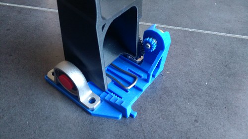

    New accelerator v5.4 online !

    I should have add a changelog :
    Changelog v5.4 :
    - 12mm metal axles replaced by plastic ones
    - the lever is now in one piece, saving two screws, and strengthening the lever.
    - The preload and the end stops are now sliding, and kept in position by a spring printed in the base
    - Add an anti-tear system for the potentiometer cable
    - KP001 are now plugged into the base.

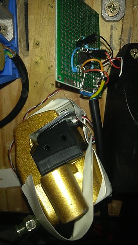

    BRAKE :
    1) I am adding a load cell to the brake pedal.
    + less expensive hydraulic circuit and sensor
    + less space needed
    - need an amplifier circuit. Nothing complicated, but some people would fin easier to use the hydraulic pressure sensor.
    - the load cell acts like a spring in the brake calipper, it changes the feel a bit
    2) I will try to add a plastic preload screw
    3) I will try to add a plastic spring on the master cylinder rod
    ACCELERATOR :
    the metal spring is being replaced by a plastic one. It's cheaper, we can make it the size we want (the accelerator pedal will be less wide) and the strength we want.

    Hi, I'm slightly confused by the change of direction, going from a pressure sensor to a load cell. Thought you had tried lots of different load cells but didn't think they were as good as yours with a pressure sensor, even said that they were better than the simtag pedals?
  13. Lebois
    Dec 10, 2018
    353
    Math teacher
    2,567Coins
    +210 / 3 / -0
    Not that much. Load cell are still hard to use, they need an amplifier circuit. Hydraulic sensors are plug and play, but because of the threads differences between the MC, the T 3 ways, the pressure sensors, we need a lot of adapters, it makes a big circuit, and it's expensive.
    About the Simtag, my opinion is the same : you can't have a real feeling if you don't have a real brake calliper (that I still use).
    Now I just want to give the opportunity to fine tune the feel. It was the point of the preload, that removes the soft part. Bu we could now make that soft part "not that soft" by adding a spring.
