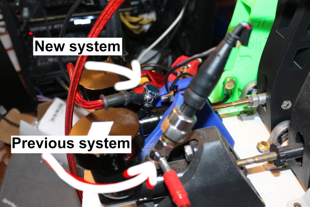

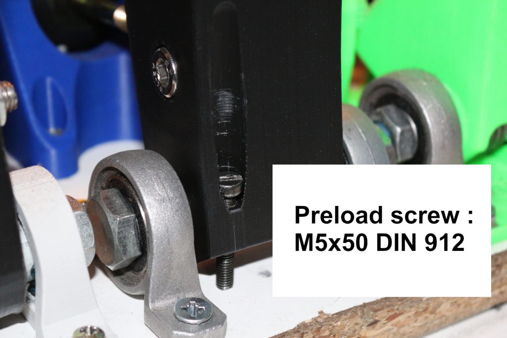

    Brake v5.3 REV2 online :
    BRAKE PEDAL SRT P1 V5.3 REV2
    The SRT P1 v5.3 brake pedal evolves to REV2. The goal is to correct the hydraulic circuit, optimise the lever and prepare the transition to higher versions.
    NEW LEVER :
    • More space at the ball joint, which allows more angle.
    • The preload screw has been moved to be more accessible. We also changed from an M6 hexagon screw to an M5 hexagon socket screw (allen).
    • Slight modification of the design to harmonize the pedals (especially with the future P1)
    • Print informations are now placed below the lever
    DIFFERENT HYDRAULIC CIRCUIT :
    • The pressure sensor is now mounted on the caliper. Therefore a banjo bolt with sensor holder M10x1.25 is required instead of the banjo bolt with sensor holder UNF 3/8-24UNF. A new banjo bolt must also be ordered for the master cylinder. The advantage is to ease the bleed procedure (air bubbles were more easily trapped in the top of the banjo bolt that holds the pressure sensor), and also to clear the space behind the lever. This is particularly necessary for the clutch pedal, which can have a long stroke.

    @Lebois, how do you bleed the slave cylinder if you put the pressure sensor in the slave cylinder?
    I have the slave cylinder from china, ordered by aliexpress, it is motorcycle slave cylinder.
  12. Chris Indeherberge
    Chris Indeherberge Designer / dreamer
    Aug 1, 2018
    13
    Graphics Designer
    Belgium
    184Coins
    I guess you bleed the air out with alternating pumping the slave and the pedal a few times. Air can get out via the master cylinder into the reservoir when you pump with the slave.
