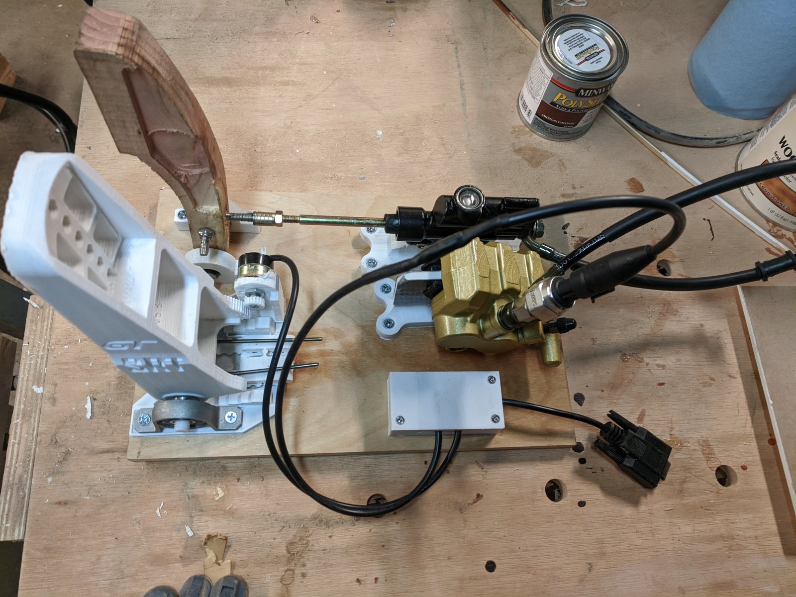

    I finally had time to test what I have so far with my setup. I have everything set up with a wooden brake lever and the GT throttle pedal.

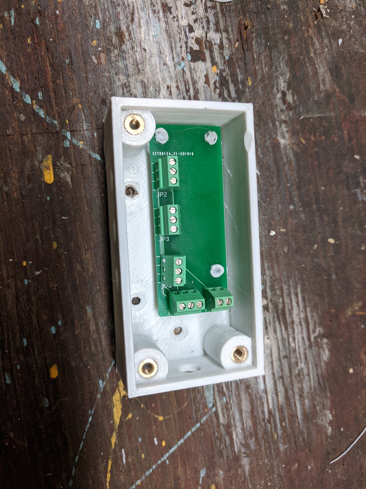

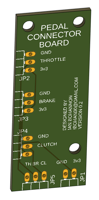

    I decided to make a connector board because I hate soldering wires together. Its a very simple board with terminal blocks. Its makes connecting all the wires together a lot easier, but I underestimated how small the wires are in the DB9 connector I used. I think next time I'll design the board to have the DB9 connector on the board (or whatever connector I decide to use). I have 4 more I don't need. If anyone is interested and wants to pay for shipping, I can mail them. I can also order more.
    I did a quick test with an Arduino to see if everything was working. The throttle works great. The brake though is only ranging from 100 to 300. The throttle ranges from 30 to 1000. I need to look into it, maybe 100-300 is fine. The pedal feels fine to me, but I'm having a hard time with the cheap threads leaking on the caliper. Both the banjo and the bleeder is leaking brake fluid. I definitely don't want to bring this into the house until I can fix the leaking.

    @ibohan00 thanks for your feedback !!
    Did you put joints between the pressure sensor and the banjo bolt ?
  7. 7HUND3R
    7HUND3R Active Member
    May 25, 2020
    154
    1,159Coins
    +41 / 1 / -0
    you have to put Teflon or sealant on the threads of each piece.
  8. ibohan00
    ibohan00 New Member
    Oct 5, 2020
    13
    Engineer
    CA, USA
    102Coins
    I put new gaskets around the banjo. I think I'll need to take them off and clean the area and replace the gaskets again.
    NPT threads and bleeder valves are designed to be sealed without sealer and *shouldn't* need any. The brake fluid actually dissolves Teflon, but I may end up using a different thread sealer. I'm guessing the cheap caliper wasn't threaded correctly.
  9. 7HUND3R
    May 25, 2020
    154
    1,159Coins
    +41 / 1 / -0
    I have Teflon on it. If I don't put Teflon there are leaks. And if that is true, the brake fluid breaks the Teflon. But as I mentioned, if I don't put Teflon on it, there are leaks.
