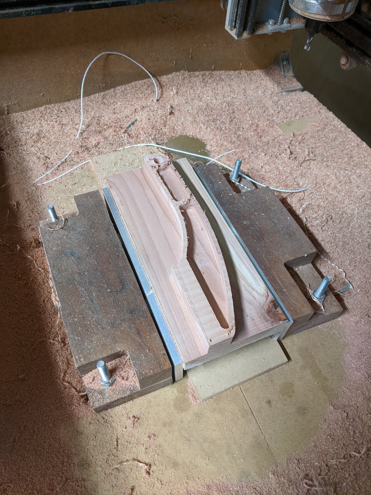

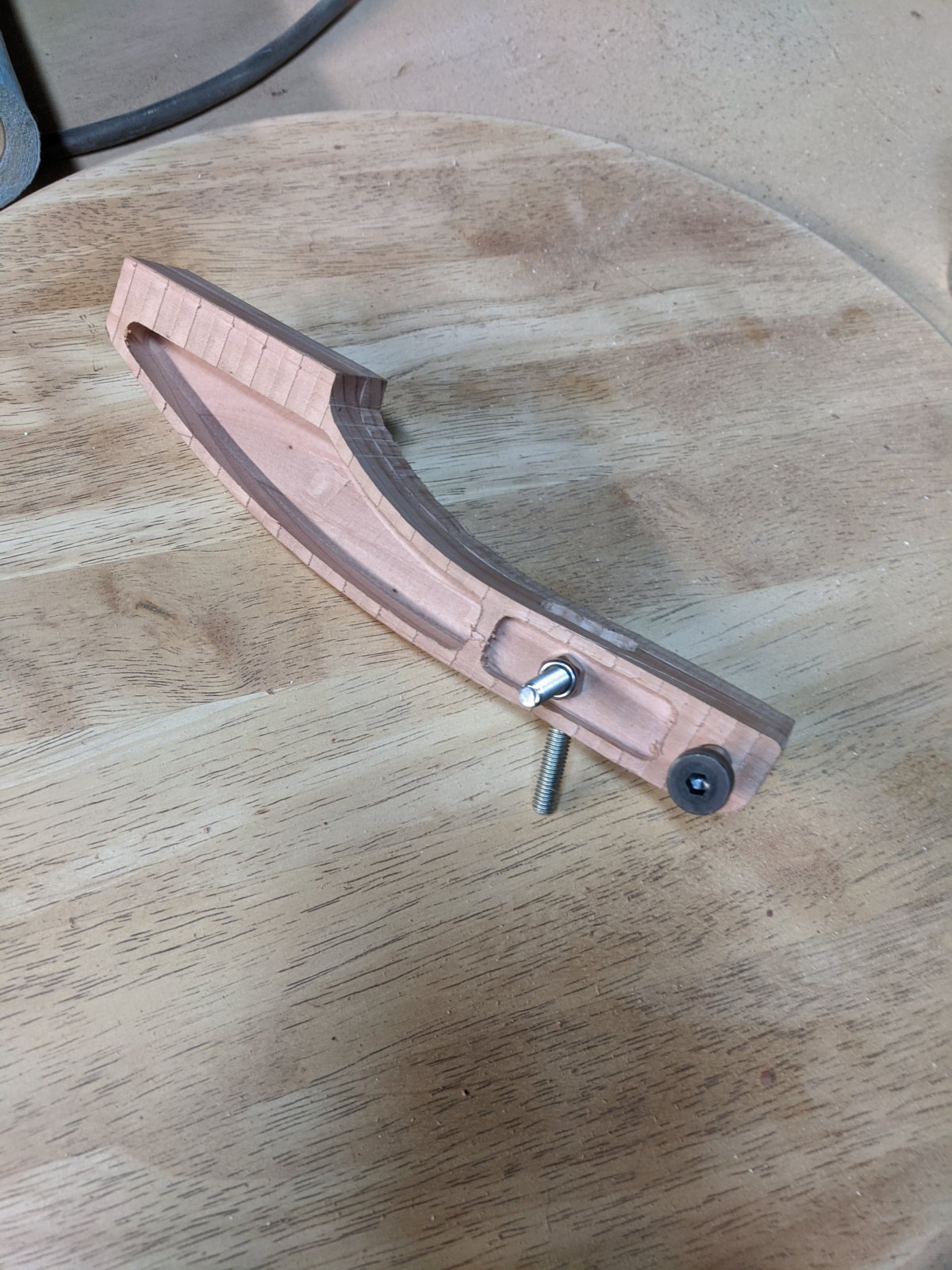

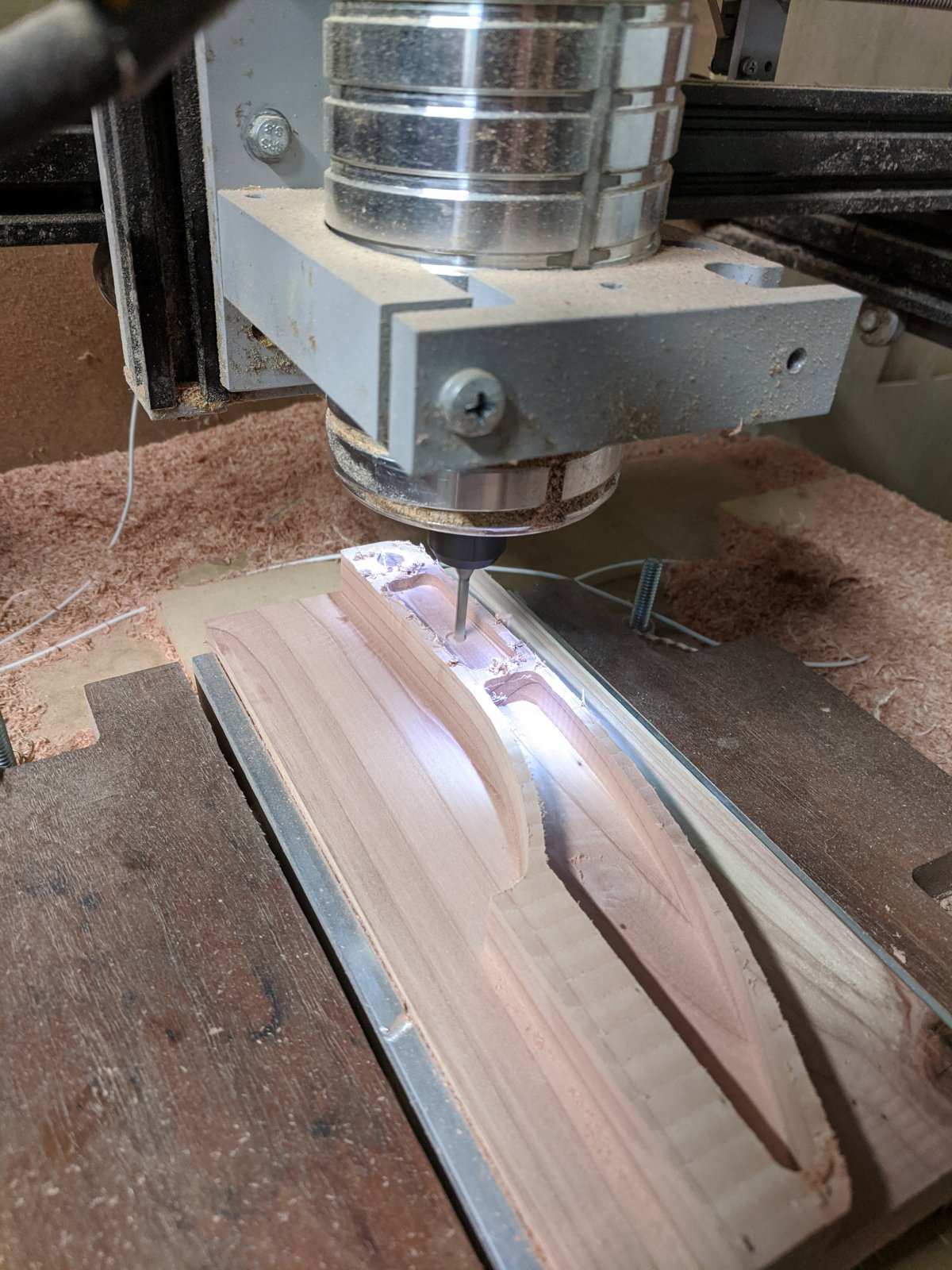

    I decided to test the CNC pedal using wood first. Good thing I did because it somehow didn't come out right. Possibly user error. I'll try again tomorrow.
    Most of the parts I ordered arrived today except for the banjo adaptor and gaskets. I'm getting excited!

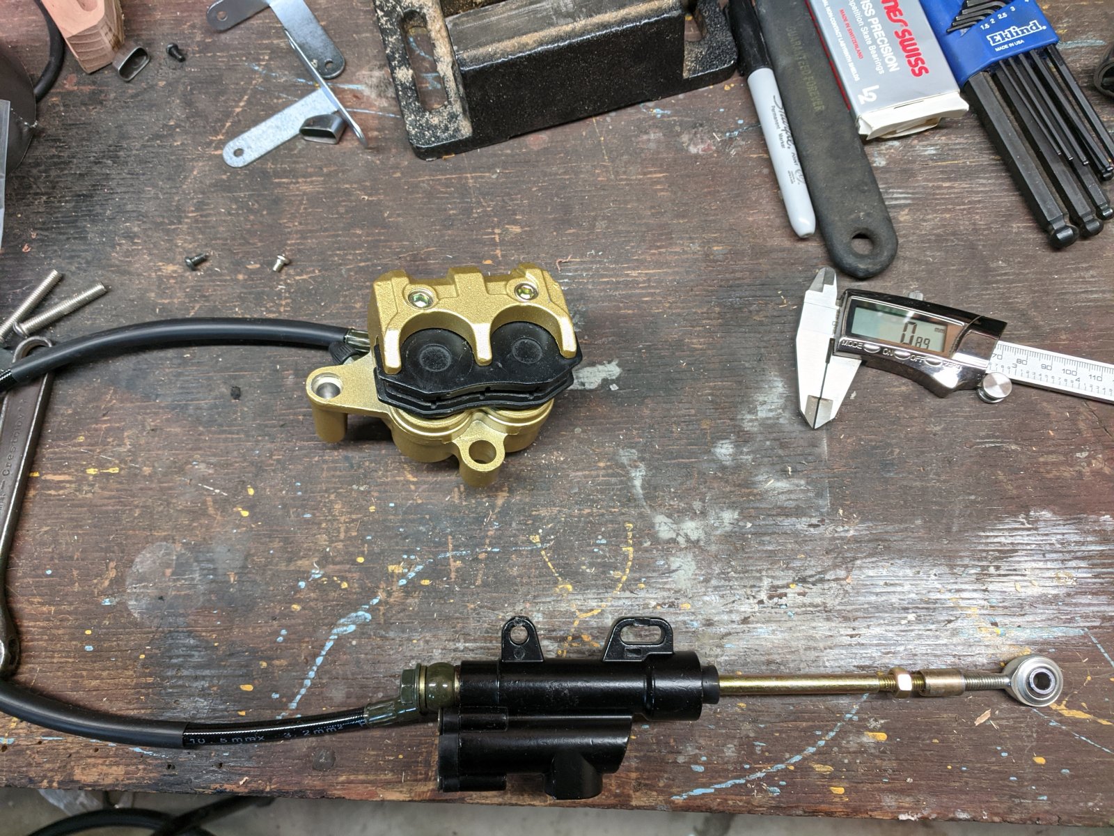

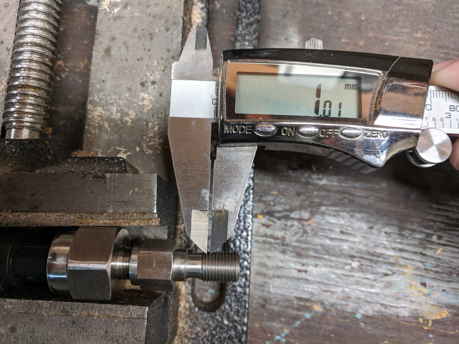

    I finally got the banjo adapter. Unfortunately the MC that comes with the 2 cylinder caliper uses a 10mm x 1.25 thread and the banjo adapter uses 10mm x 1..
    I'm thinking the easiest thing would be to order another adapter and wait another 2 weeks for shipping unless someone has a better idea?

    I just checked the slave cylinder (brake caliper) and it looks like that also uses an M10x1.25 thread.
    What's the reason for not having the banjo adapter on the MC side?

    The company that sells the adapter also sells imperial to metric sizes
    https://ebay.us/ZWL9YM - M10x1.25 to 1/8 NPT
    https://ebay.us/JIYkci - M10x1.0 to 1/8NPT
    My problem was that I ordered the M10x1.0 assuming that was the correct thread pitch for the 10mm banjo. It's actually M10x1.25.

    The thread pitch is the spacing between each thread. If your parts fit together then they're the correct size. A banjo with a 1mm thread pitch won't physically fit into a 1.25mm pitch hole.
    Here's a picture of what my M10 x 1mm banjo looks like.

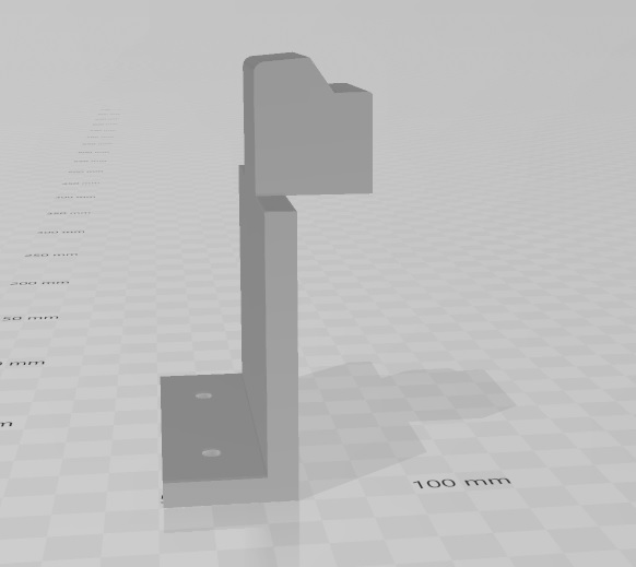

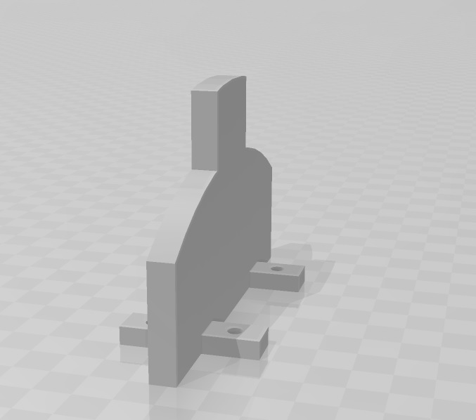

    I think a quick request might be to put washers under the master cylinder bracket or under the KP001 to raise either the pedal or the master cylinder. It is that they do not coordinate well in a straight line between the pedal lever and the master cylinder bolt. When the brake pedal travel reaches 100%, the master cylinder bolt bends down a little.
    I have created 2 brackets for the brake caliper of the 1 piston and 4 piston model.
    I have to buy them.

    I already added a support for the 4 pistons, but thanks :)
    I don't think that it's a problem that it's not perfectly aligned, it's designed in order to work good this way.
