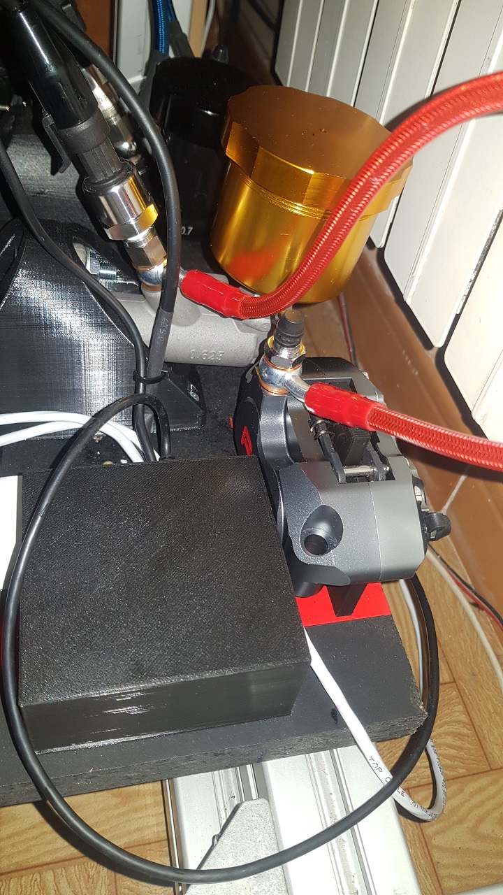

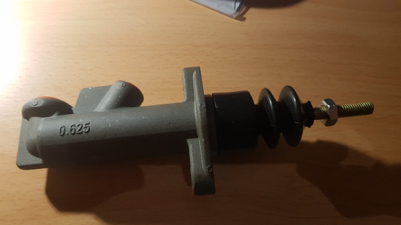

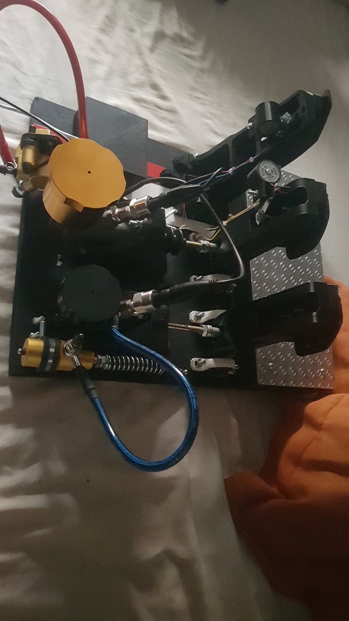

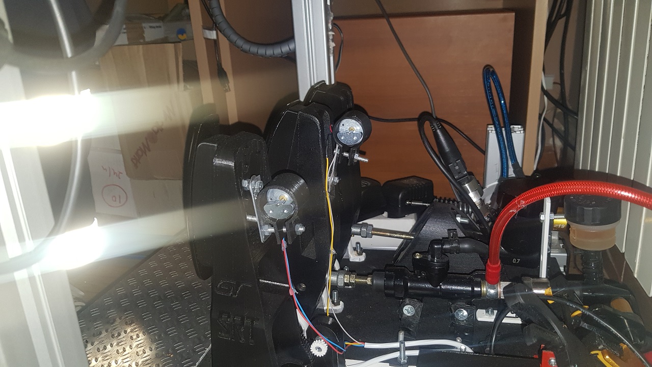

    Thank you lebois for exposing the work. I got a 0.625 master cylinder today. I have asked for a smaller diameter just to test. I like to try. Now I have to print the bearing of the master cylinder to be able to fix the master cylinder.
    On the other hand I am attaching images of the cylinder and the rumble motors that I install on the pedals. The cables remain to be sheathed.

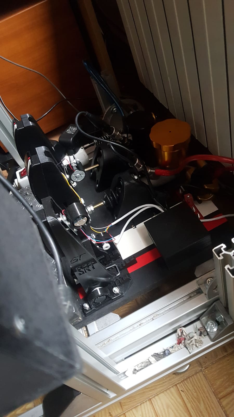

    The I have changed the master cylinder to the brake, tenworm one of moto and I have put a car one. I need to put a 4-piston brake caliper.

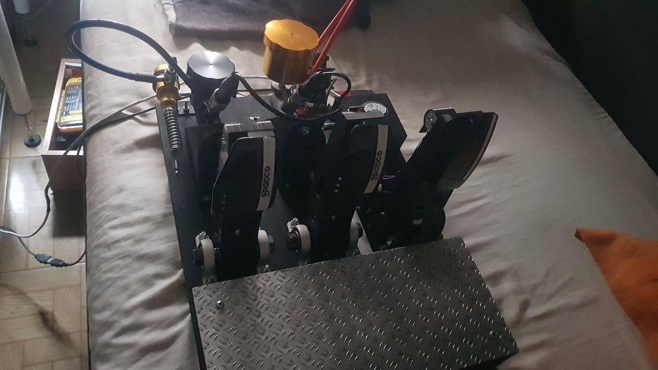

    I already have them in place. it has an incredible touch.

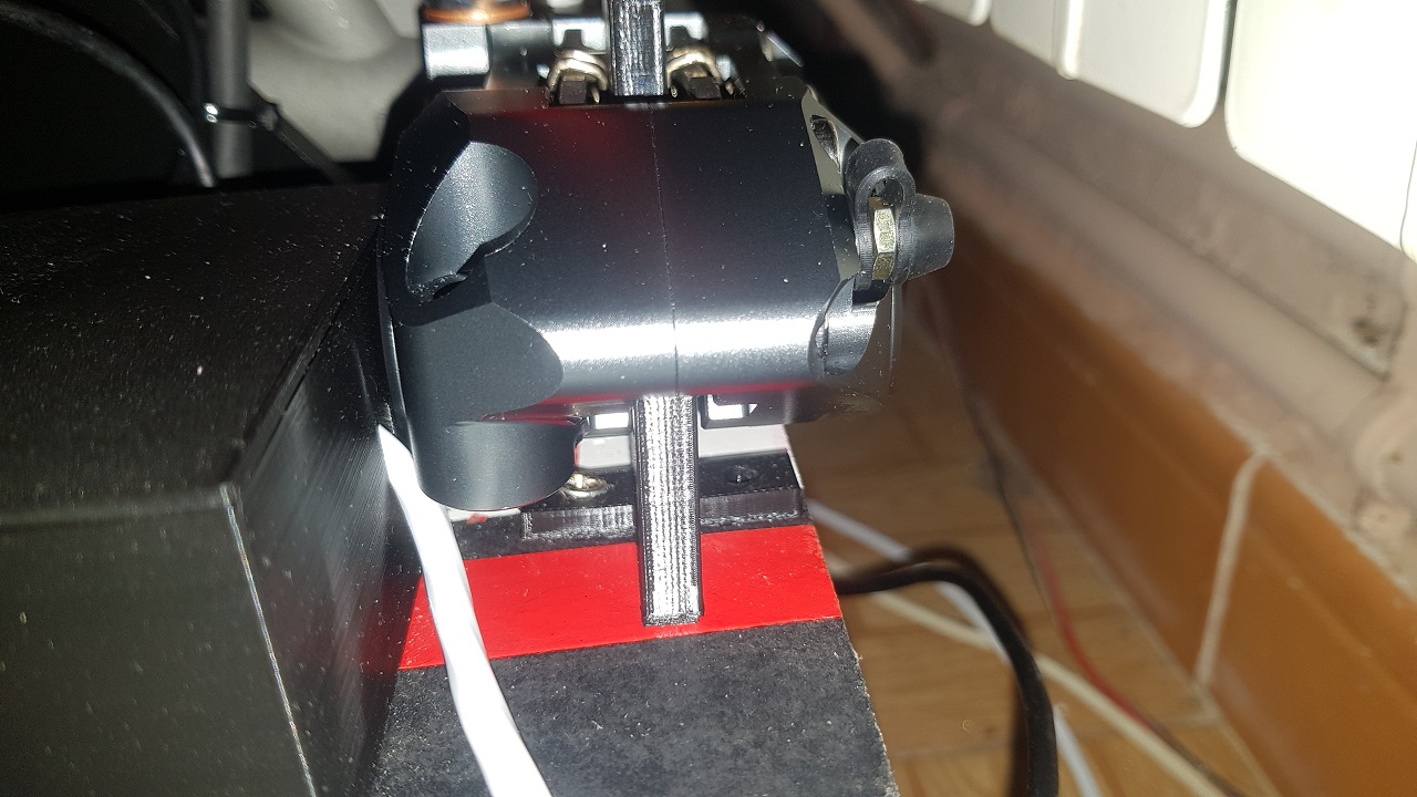

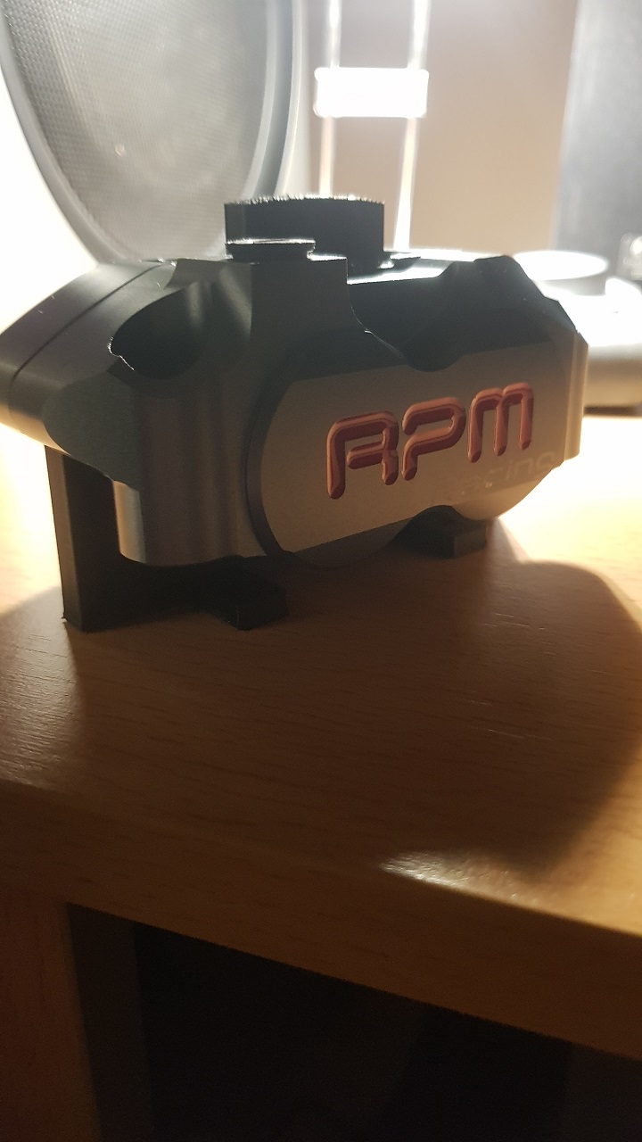

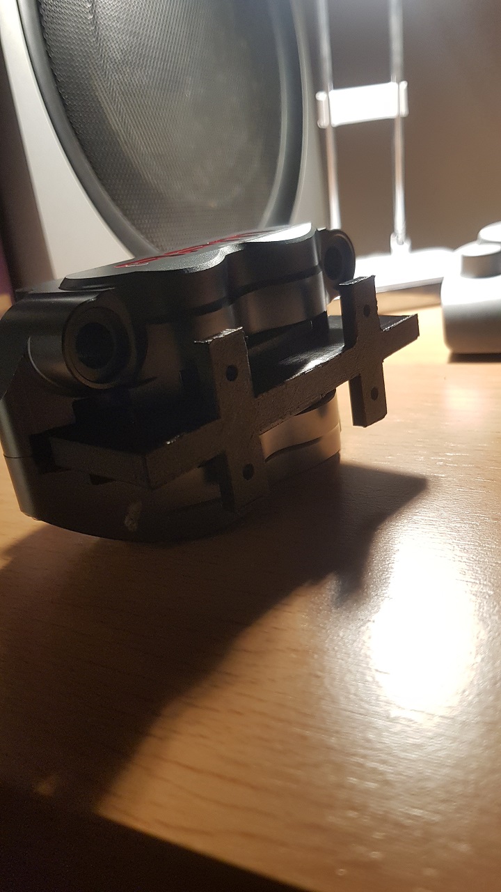

    I got the 4 piston caliper, it is dark gray. I have designed a kind of clamp in 3d to hold the clamp on the pedal board.
    I already assembled the 4-piston caliper and here is a video showing how it performs when pressing the pedal. Nor do I notice differences in the pedal compared to the 1-piston inza. I think the difference is noticeable if you put a slave cylinder or a brake caliper or if you bleed the system well. The 1 or 2 or 4 piston caliper is fine for in real life, here if you notice differences since the caliper is made to brake and not to improve the feel. I think a slave cylinder would be better, it gives more play, you can adjust the hardness of the pedal.
    The part printed 3d with PLA and 30% that holds the clamp I think it supports the cladding well.

    If the clamp is attached to the base of the pedals. It is very safe.

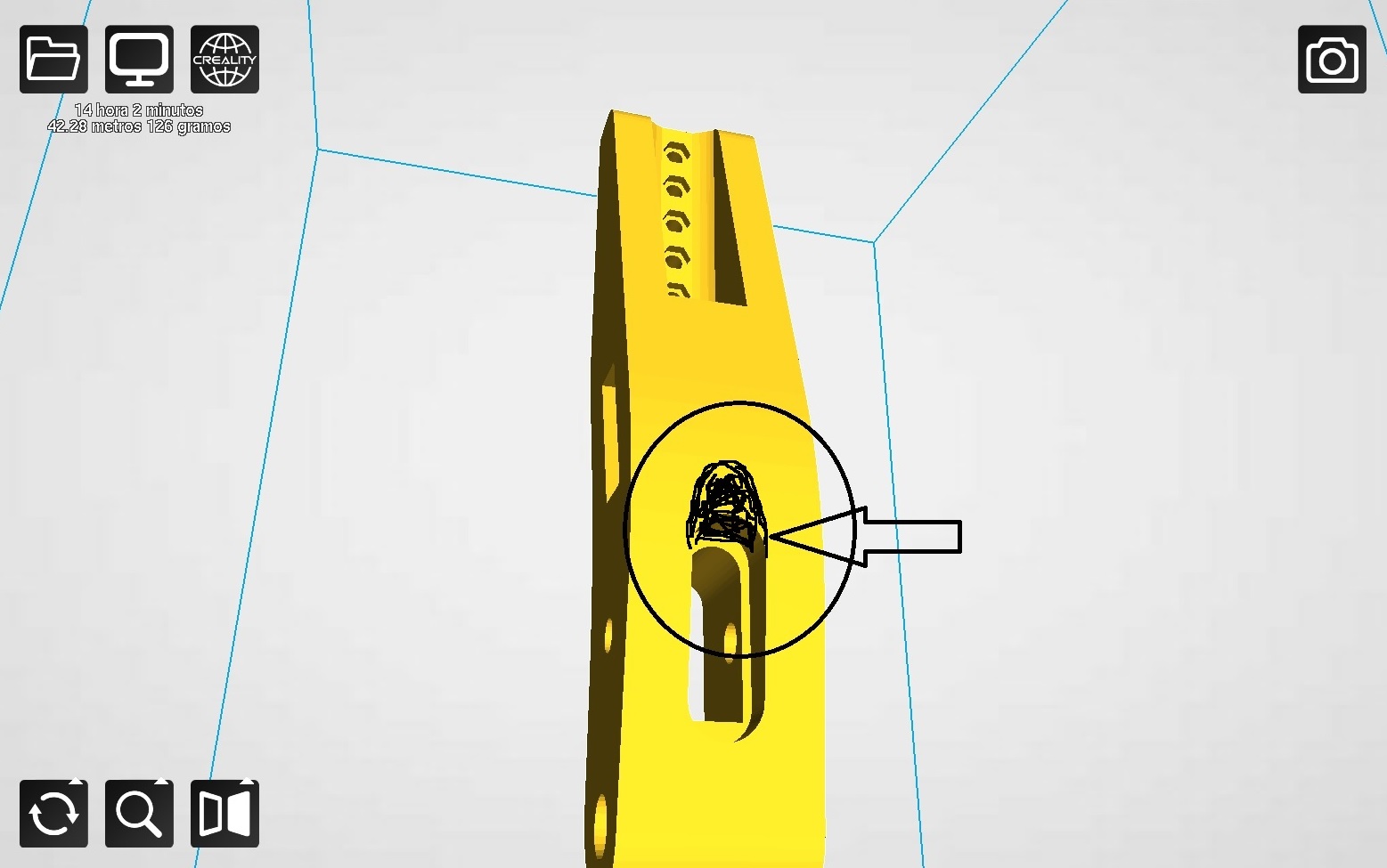

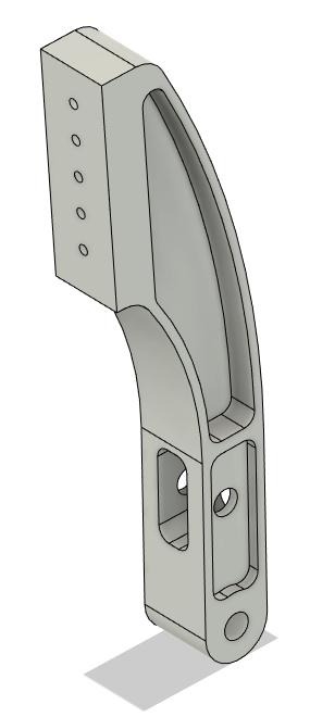

    I have made a bad and fast drawing xD to show that that part should be edited and made bigger. The master cylinder shaft touches that area when the pedal is fully depressed.
    I tried to do something myself with sketchup8 but I have not achieved anything.
  17. Lebois
    Dec 10, 2018
    353
    Math teacher
    2,567Coins
    +210 / 3 / -0
    Hi ! It's not meant to go that far, you don't have any resistance...

    ok @7HUND3R I will address this issue soon. Still working on the gearbox for the moment :
