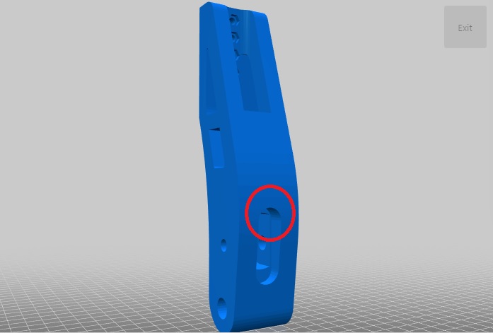

    It would be good if you modified this part of the lever. The bolt where the cylinder rod is held collides with that part of the pedal and shortens its travel. I tried to fix it with a dremel but I am afraid that the lever will lose consistency.
    That part you would have to make it higher, longer.

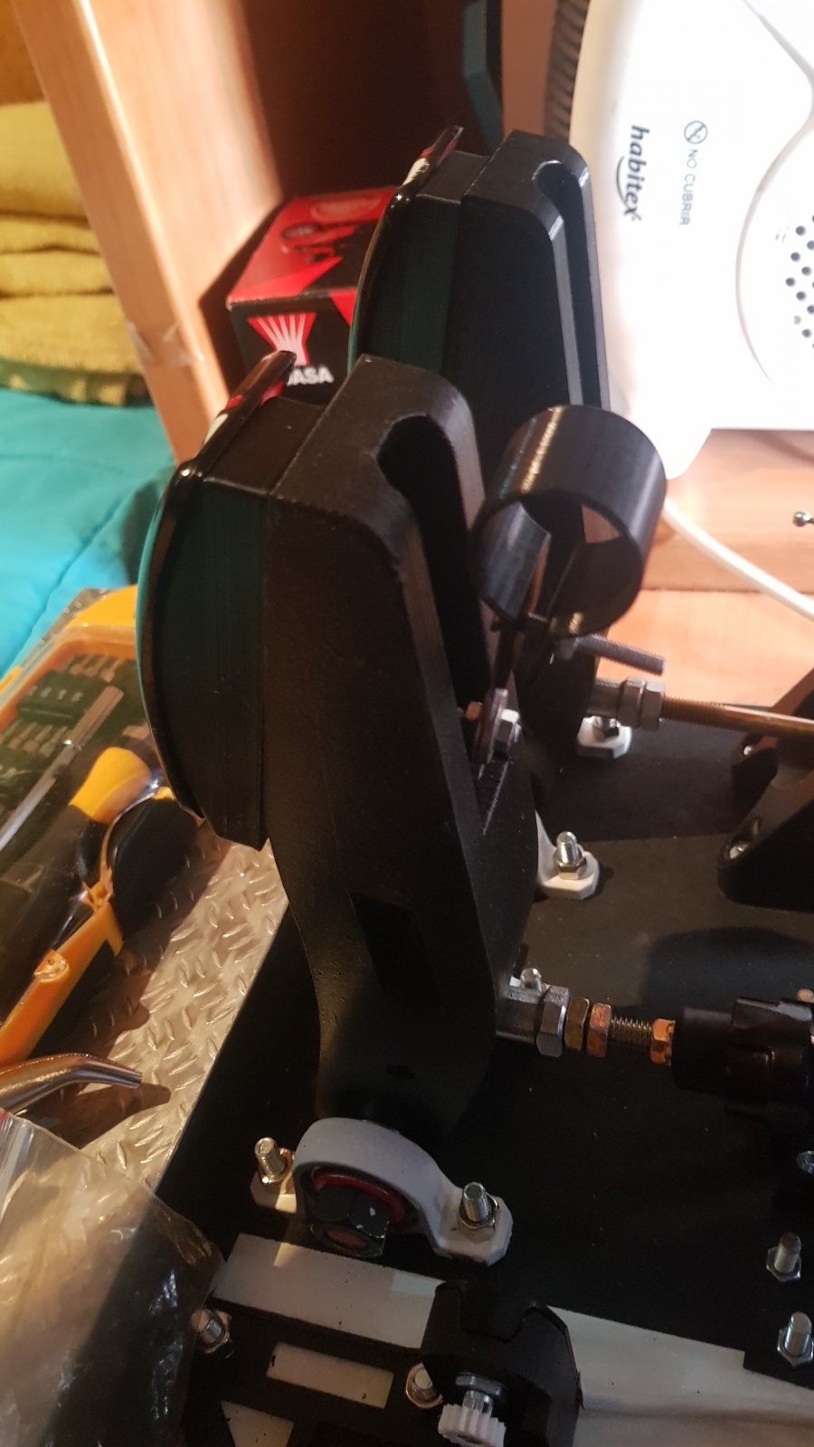

    I have already put the adapters to the pedal. they are perfect.

    Normally, the rod touches it if your pedal is press down too much. Can you show me in which situation the rod touches the top ?
    Please note that there is two adapters, one from the throttle pedal, one for the brake pedal.

    I have the clutch and the accelerator with the same system and the same thing happens to both. I've had to eat a bit with the dremel but it keeps playing. I thought the top was marked by the master cylinder.

    Ok I see.. It wasn't meant to go this far, but it's true that the clutch pedal goes further... I will update the design later.

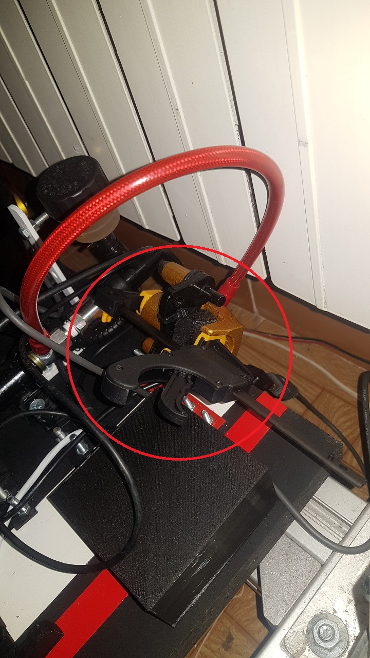

    @Lebois, there is a problem that I cannot solve. Soon after you press the brake pedal, the car brakes a lot. I have touched the minbrake and maxbrake rates but cannot reduce the sensitivity of the pedal. And if I hit the top 100% of the brake, the car stops braking.

    I show you video. Here you will see that I begin to press the brake progressively. When it is almost 100% pressure it stops sending signal. Then I start to release the brake little by little and the signal comes back. You can see it on the monitor.
    In the second video I show the clutch but it shows a lower value but when pressing the pedal at 100% it continues to send a signal.

    Ok, I already found the problem. The problem was with the brake caliper and the pedal travel. The solution that I have put is to place a sergeant tightening the brake caliper so that the piston of the brake caliper has less travel. Now the brake pedal is somewhat softer and has less travel but when you press the brake at 100% it continues to send the signal.

    hm...quite strange...did you print the right part to put in the caliper ?
  14. 7HUND3R
    7HUND3R Active Member
    May 25, 2020
    154
    1,159Coins
    +41 / 1 / -0
    the truth is that the calppier is not correct.
  15. 7HUND3R
    May 25, 2020
    154
    1,159Coins
    +41 / 1 / -0
    I have placed the correct calppier but it continues to happen, I put the previous calppier with a sergeant and the problem is solved, but the pedal travel shortens and softens.
