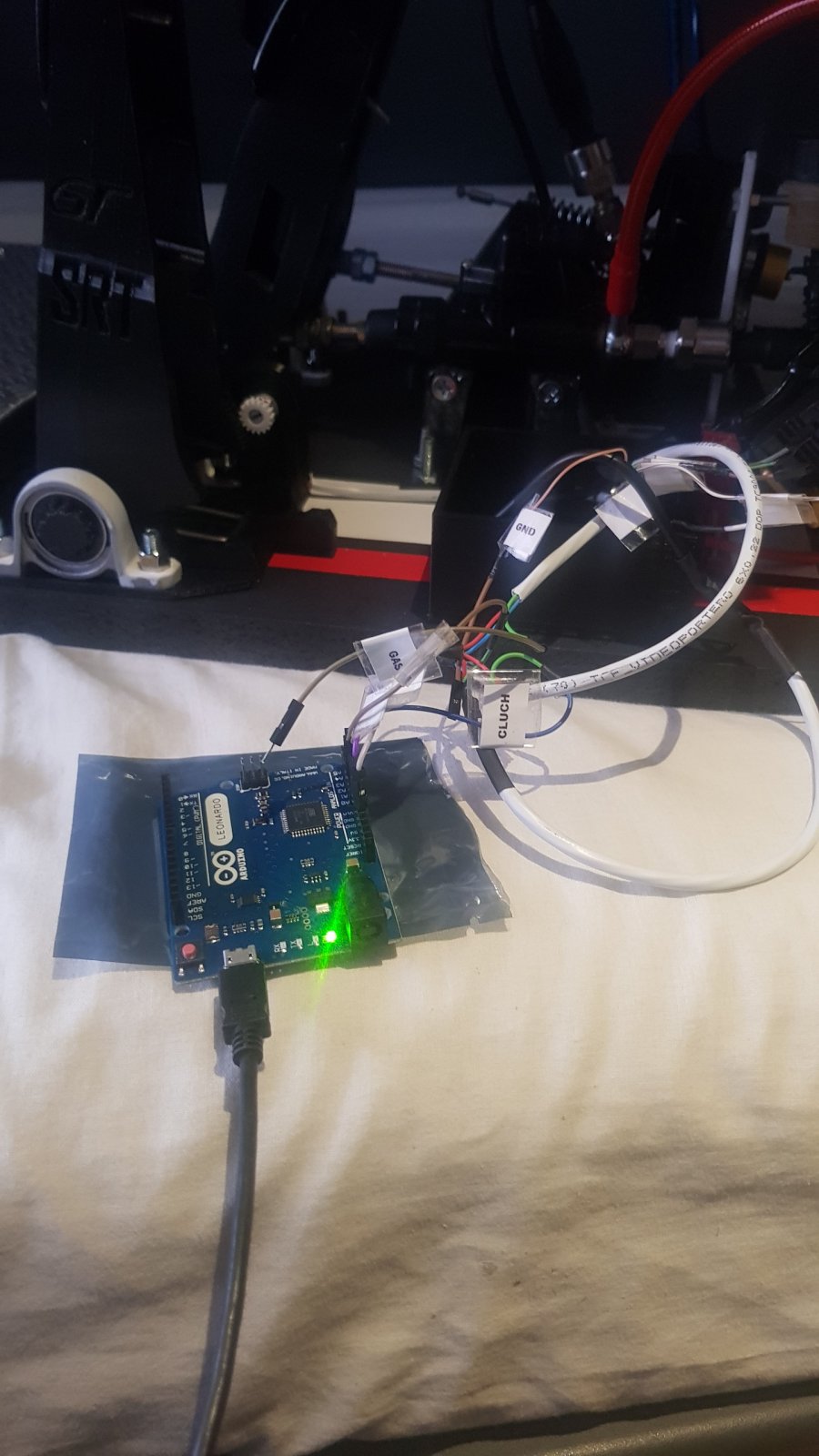

    Even with hand it should work. Can you post pictures of the wiring ?

    I can pass you a photo but there are many messy cables. I summarize you.
    I have 3 pedals, clutch, brake, accelerator. the accelerator goes with potentiometer and brake and clutch with pressure sensor. the brake has a 500 psi sensor and the clutch has a 300 psi sensor. both the potentiometer and the 2 sensors I have the 3 red wires attached and I suppose they are VCC the red one. then the GND (black wire) of the 2 sensors and potentiometer are linked. then the green cable that would be the signal vam separately each one on a pin of the VGA connector.
    In short, the 3 red wires (vcc?) I have jumpered and the 3 ground wires (black) I have jumpered. The 3 green signal cables are separated.

    I leave you some attached images. in the first you can see the wiring. It's very messy. You can see how I have it soldered with pins. this way it lets me connect it either by arduino leonardo or by vga connected to the base of the g27.

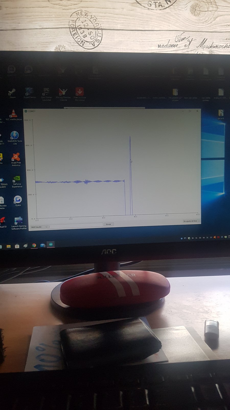

    In the second image, see what it does when connecting only the brake and clutch to the arduino. and in the third image is what it does when connecting the throttle.

    Hi ! Please try the following code with each pedal :

    On the first picture, where does the gas wire go ?

    In the first image of the gas cable I have it disconnected because at that time I only had the clutch connected to the arduino to test. the gas cable that is the accelerator is soldered to the signal pin of the potentiometer.

    @Lebois. Placing the parameters that you tell me in the arduino IDE, the pedal of both the brake and the clutch already responds to me. It goes perfect. But I do not understand anything about arduino so I do not know what I have to put so that the 3 pedals respond to me.

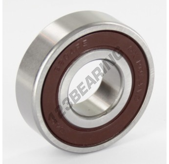

    I can print the shafts but I would need the bearings even if right?

    You need the KP001 or the M12 axle ?

    The kp001 is made up of 2 pieces, the k001 which is the outer casing and the p001 which is the bearing. What is 12mm, I have the k001. I am missing the p001.
    I have this
    https://www.thingiverse.com/thing:4496045
    I am missing this
