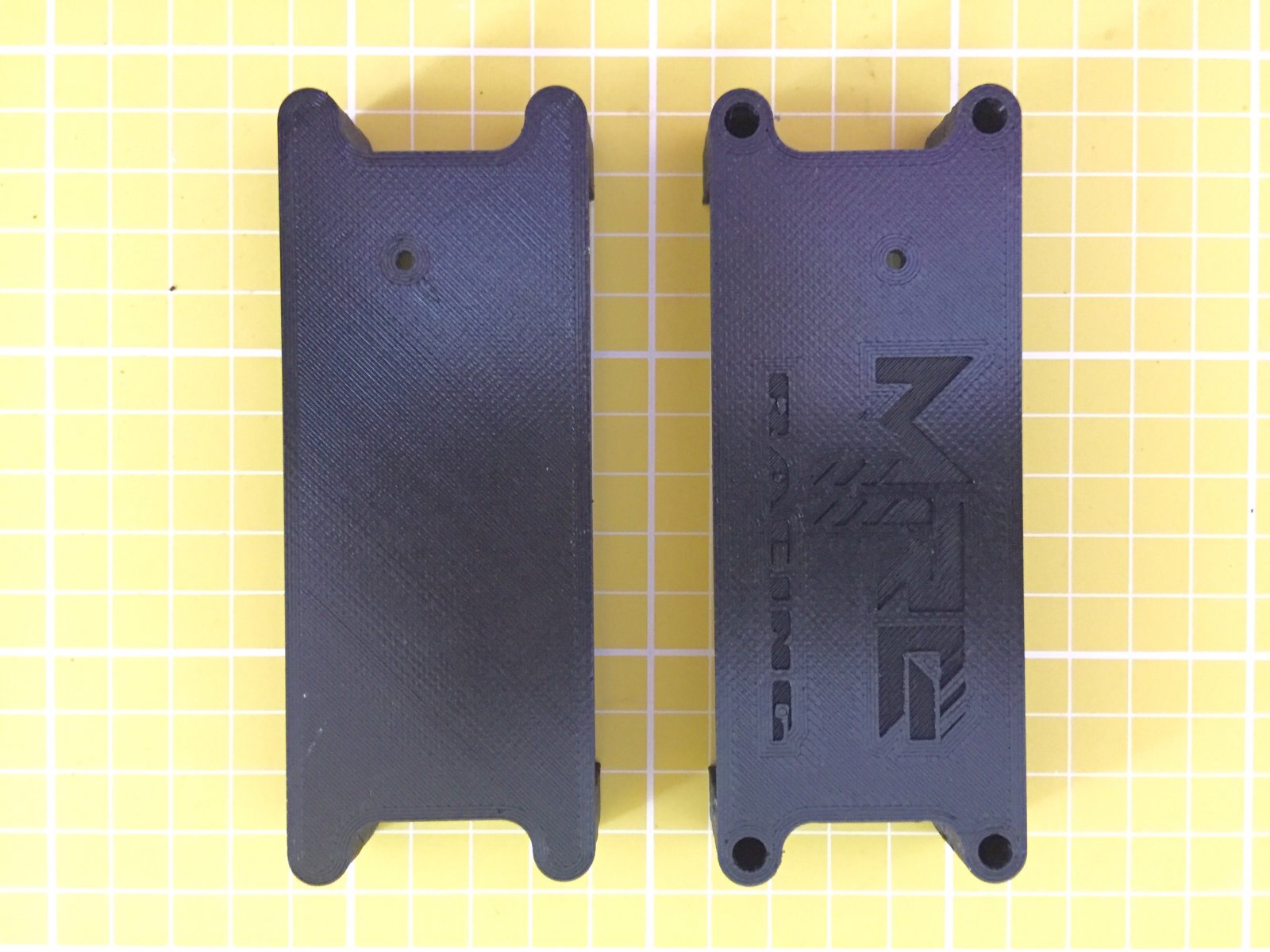

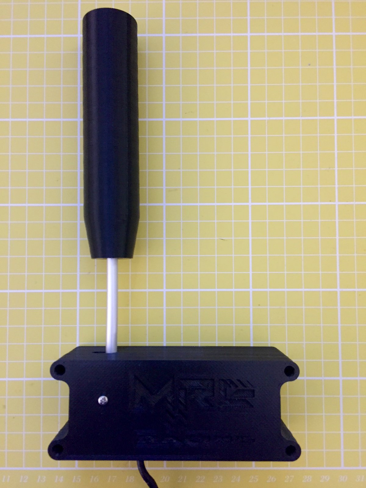

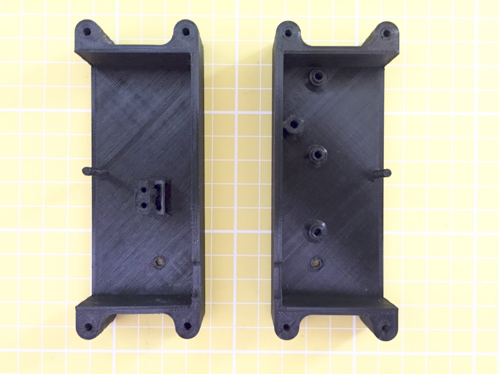

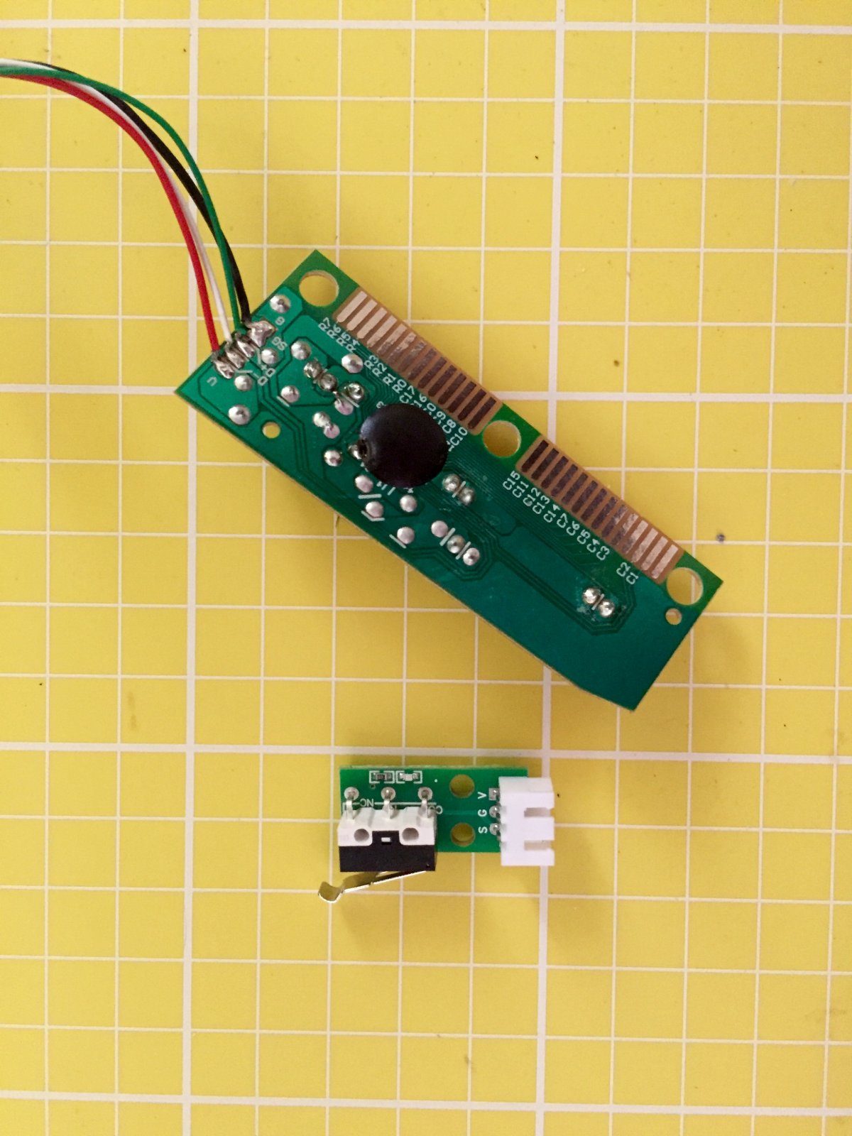

    Using and old USB keyboard I made a handbrake / e-brake for my rig. Wanted to 3D print as much of it as possible.
    USB Keyboard PCB £0 (old keyboard)
    Switch £0 (spare from 3D printer)
    6mm ali rod £3
    Spring £1
    Screws £0 (reused from keyboard and PC hardware)

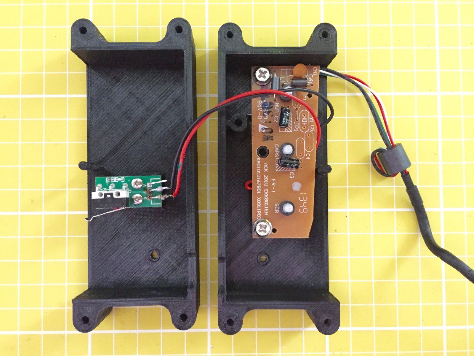

    USB keyboard pcb and switch:
    Housing:
    PCB and switch installed:

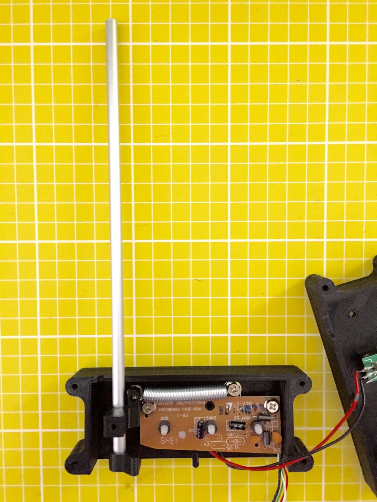

    Shaft assembly:
    56814

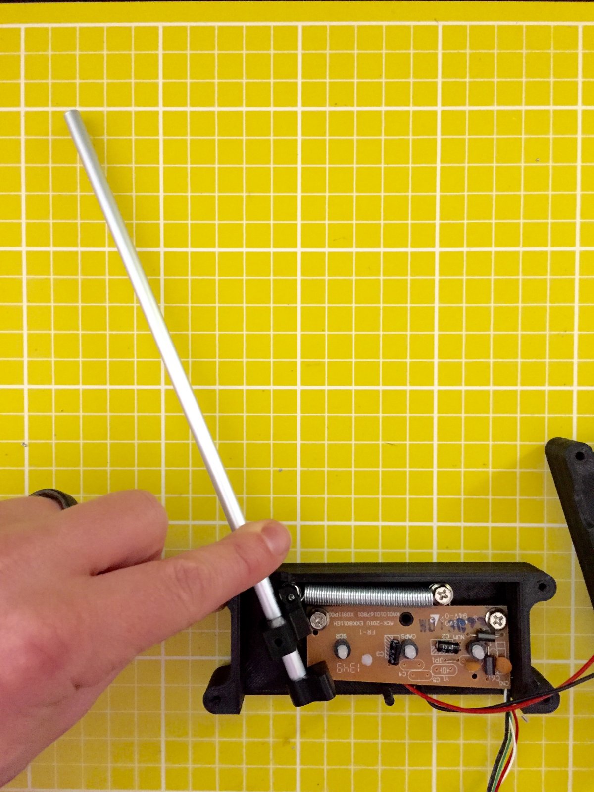

    Shaft install and movement:

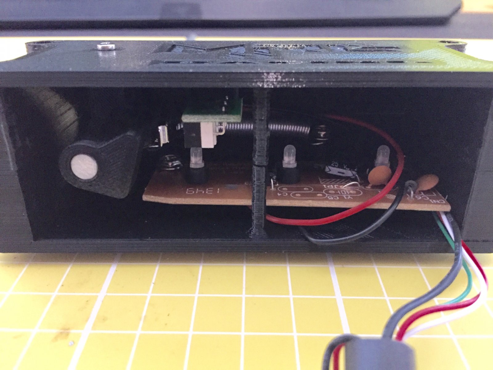

    Bottom internal view:
    Finished assembly:
    21,493

    Yes, really very budget, congrats to the builder. To be honest I fear when I pull hard (and in a real car I do so) the brake will blow up in my face ;) Please do not understand this as an offense @early_m, just my thoughts in terms of stability
  4. early_m
    early_m Active Member
    Jul 28, 2016
    328
    Chelmsford
    855Coins
    +351 / 4 / -0
    I cringe a little when my 19 month old starts pulling on it, but its actually pretty robust and there's not much force going through it as it's an e-brake.

    I didn't think it was too shabby for less than a fiver! (ignoring filament costs)
