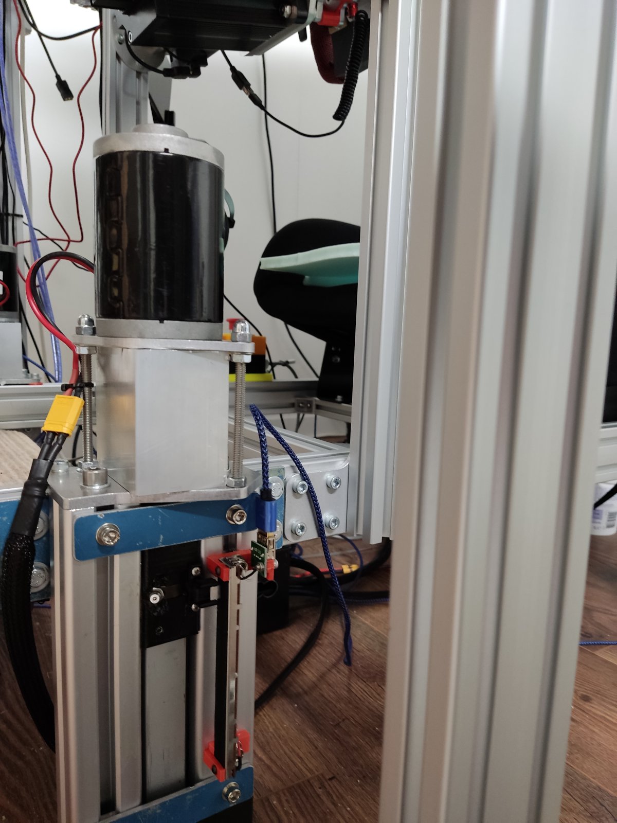

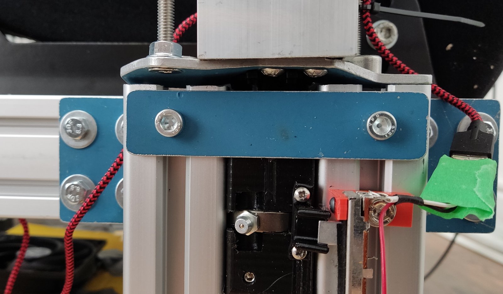

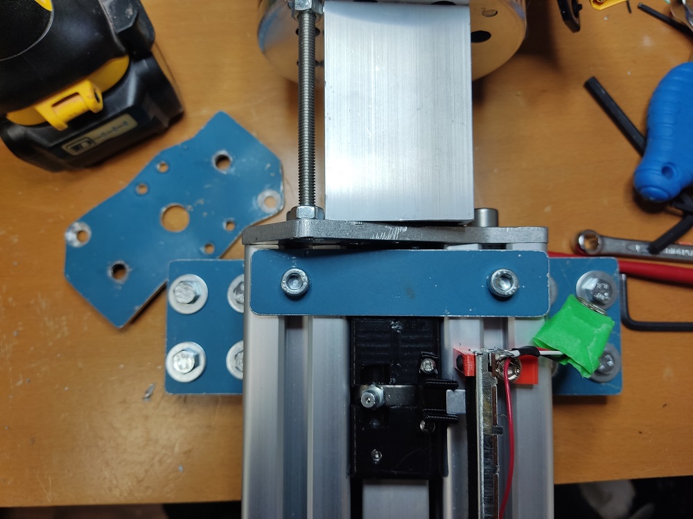

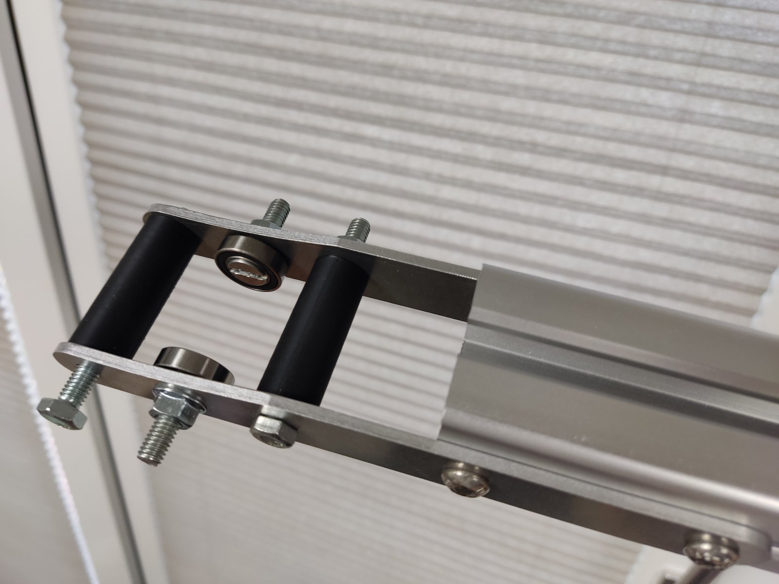

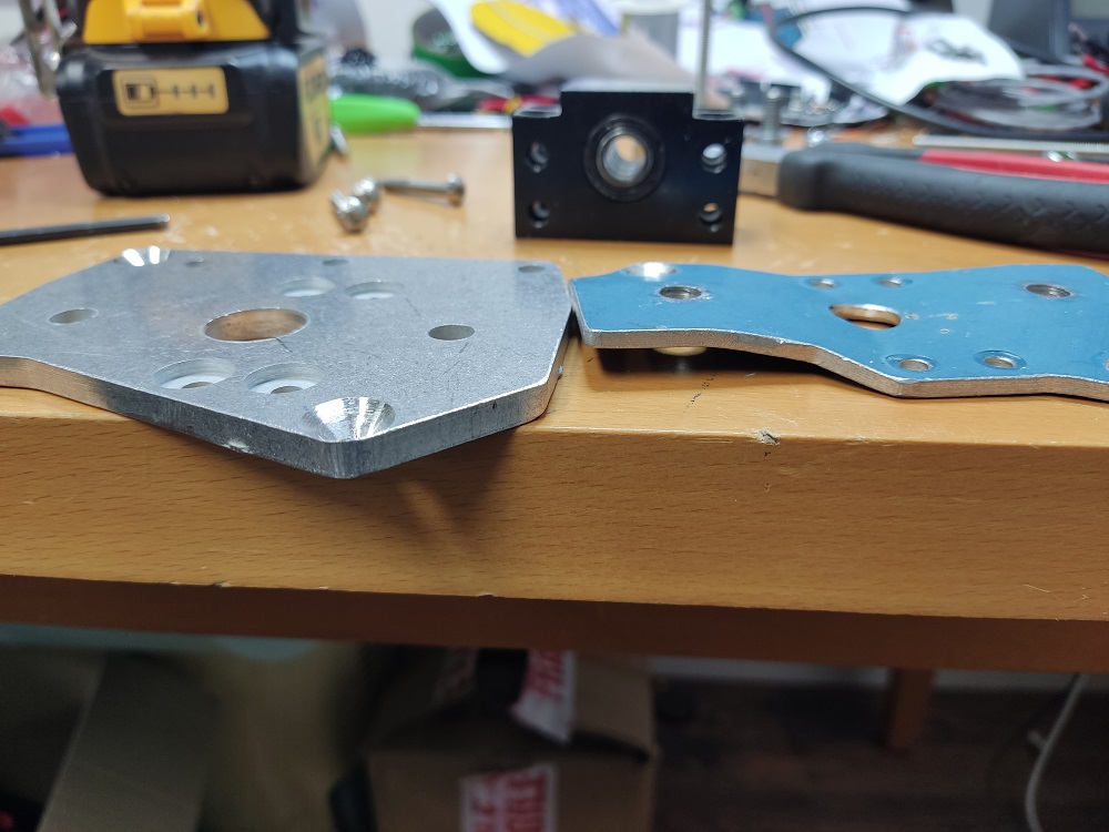

    Whilst the actuators haven't actually failed at any point in the last few weeks, there have been opportunities for improvement.
    Continuing to work through the list of identified improvements, the top plates of both left actuators have bent at some point in testing.
    I'm not exactly sure when this happened or why, so have machined some stronger ones.
    I replaced one of the ballscrews that was noisy, this one was noisy from the start. When i first built the actuators i didn't have the correct size tube to flip the ballnuts on the ballscrews, i think a ball bearing or 2 got somewhere they shouldn't on this one.

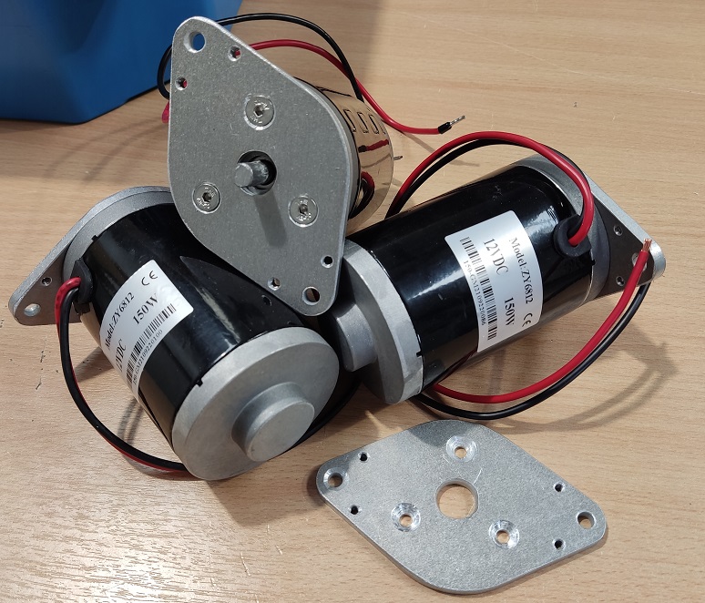

    I replaced the motor on the rear right actuator with one of the 150W (zy6812) motors i have, these are 12V 0.57Nm rated.
    At 12V it struggles a bit compared to the 500W motors used on the rest of the rig but at 16V it matches or beats the larger motors for speed and motion seems more responsive.
    Unfortunatly it gets a bit warm without a cooling fan directed at it, more testing is required on this one and maybe with some assistor springs to take some of the load.

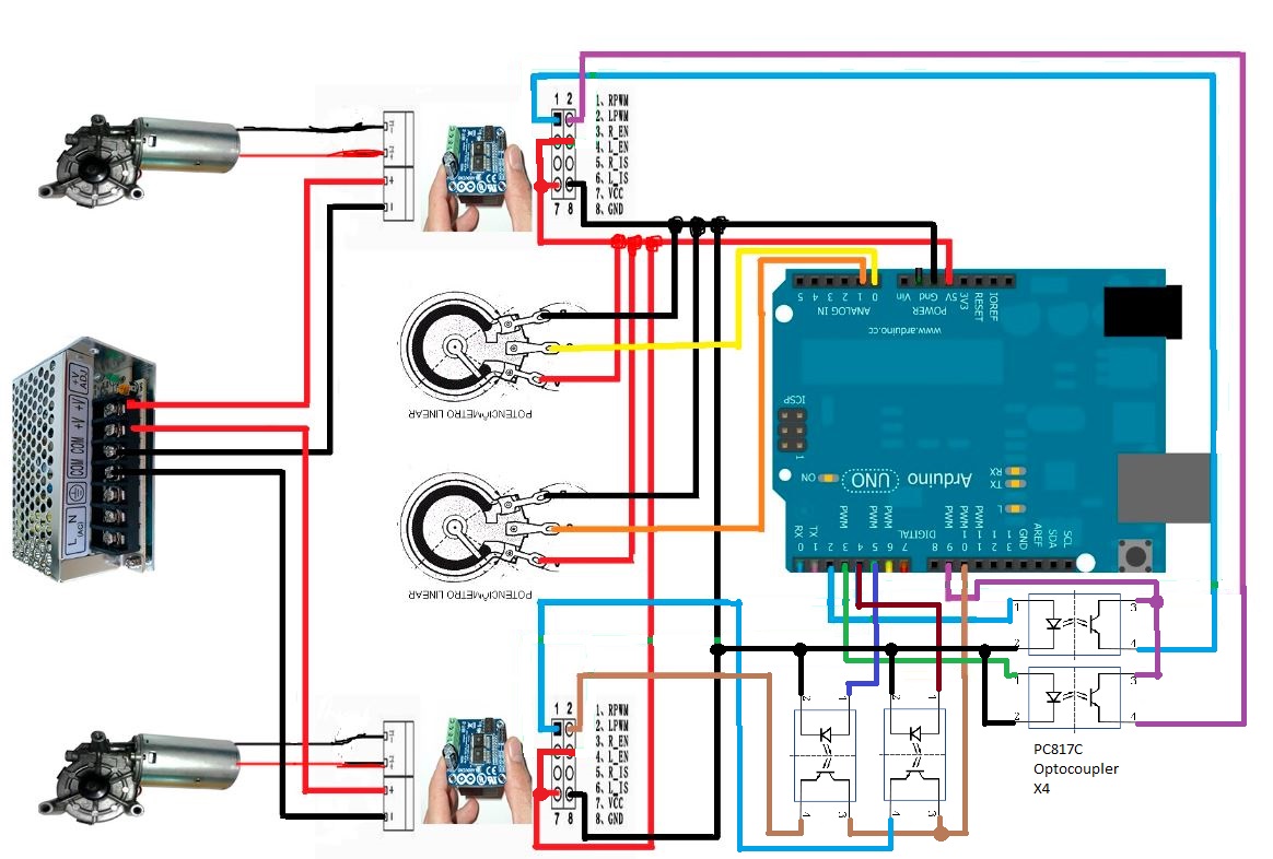

    Hi. Brother, can you share your wiring diagram.

    Wiring diagram is slightly modified version of SMC3, can be seen a few posts back. Only thing not shown there is the power supply which is 2 HP server power supplies in series, a diode and some capacitors with a simple precharge circuit, I'll post a drawing of that in a few days.

    The other 150W motors arrived yesterday, brackets made to fit them in place of the 500w ones.
    Completely reversible if it doesn't work out, just the PID tuning to change.

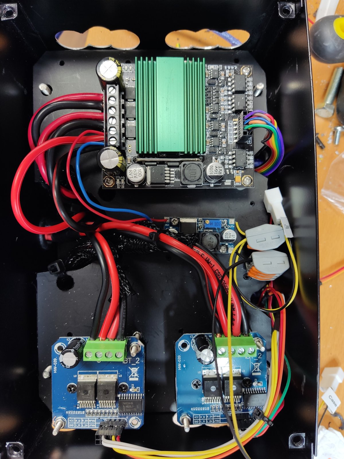

    I do have another of these H-Bridges on order and plan to use 1 for each rear motor (Both channels for 1 motor).
    This is the big H-Bridge i'm using, it's 2 channel so does both the rear actuators. This is the second one, the first blew up within 2 seconds of power on, i assume due to too much current.

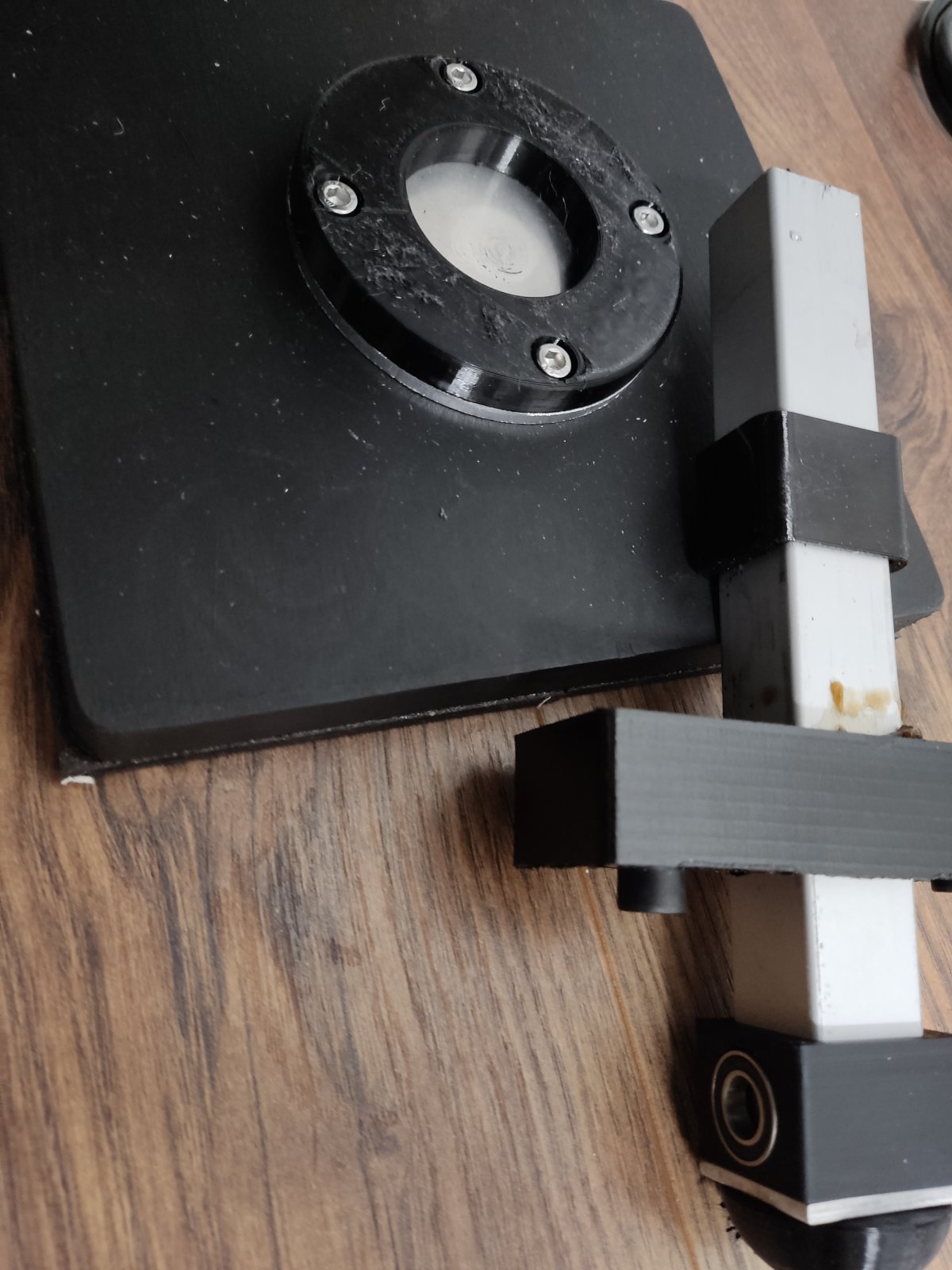

    The photo below shows the floor pads i made during the season to spread the load and allow the rig to slide slightly within the cups to prevent binding, to the right is an actautor leg with a bearing bracket ready for adding spring assist. Hopefully testing that later today.

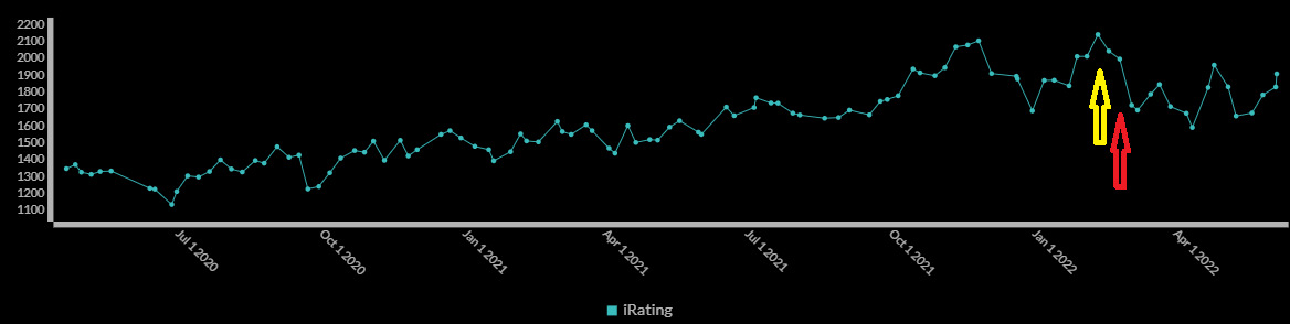

    Above is my iRating from the begining of time. The yellow arrow indicates when i added motion, the red shows the start of 22S2.
    Yes it looks bad for motion but that's not quite the whole story, i started racing Radicals this season as well as my normal 2 X GT3 series and ajust don't have enough seat time in the Radical to be competitive. The low participation in Radicals also hurt my iRating with generally ony 1 or 2 splits making a top half finish challenging.
    GT3 also had the biggest shakeup since i joined iRacing, tyre model was updated and completly updated aero.
    The changes made the GT3 cars much easier to drive, now unless you put a wheel on the grass under braking spins are a thing of the past (although Porsche, Lambo and Audi drivers still had issues).
    The downside of all this grip was a massive loss in terms of force feedback which made extracting decent laptimes really hard to do consistantly. I struggled with this all season.
    By week 10 i was still stuck for exactly why i was struggling to match my old times with a much grippier car, not helped by having so many weeks racing on tracks i'd never driven before.
    Interlagos was a bit of a turning point, a track i was previously fast on and now 1.5 - 2s off my pace, i tried running a medium downforce setup and the force feedback came to life telling me what the front end was doing for the first time all season. (Had other issues at interlagos including 3 races with a 40s penalty for speeding in the pits and another ruined by a driver blocking and taking both of us out).
    Week 11 at Virginia international raceway, another track i'd never raced. Whist medium downforce wasn't ideal here it was still worth it for the feel and ended up with some decent results.
    Week 12 the last week of official racing was at Donnington park, the only track on Iracing i've driven IRL.
    Running Medium downforce here gave me decent laptime but i was a sitting duck on the first half of every straight due to poor exit speed so it worked for qualifieng but not in the race.
    Back to square 1, out of desperation i disabled iRFFB(a program that sits between iRacing and FFB wheels to add fidelity and effects to FFB) and turned up the FFB to 12Nm (Usually run at 10Nm). This gave me a resonably reel as to what the front was doing and achieved some decent finishes.
    Not liking the harsh feel of Iracings native FFB so this is still a work in progress.

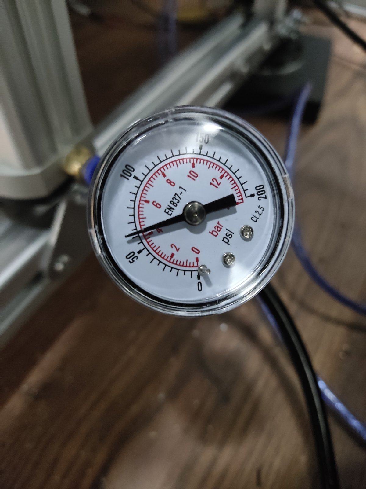

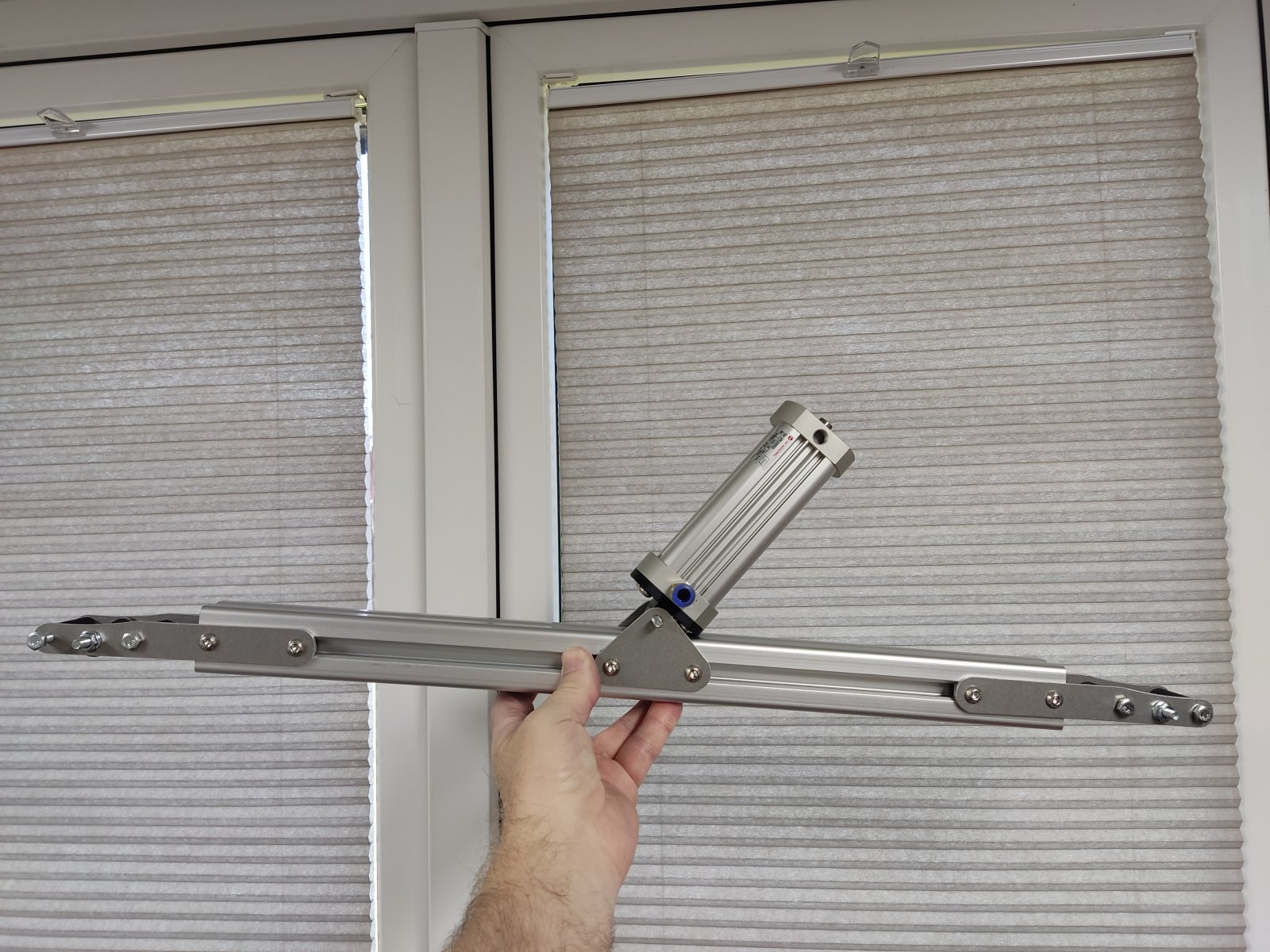

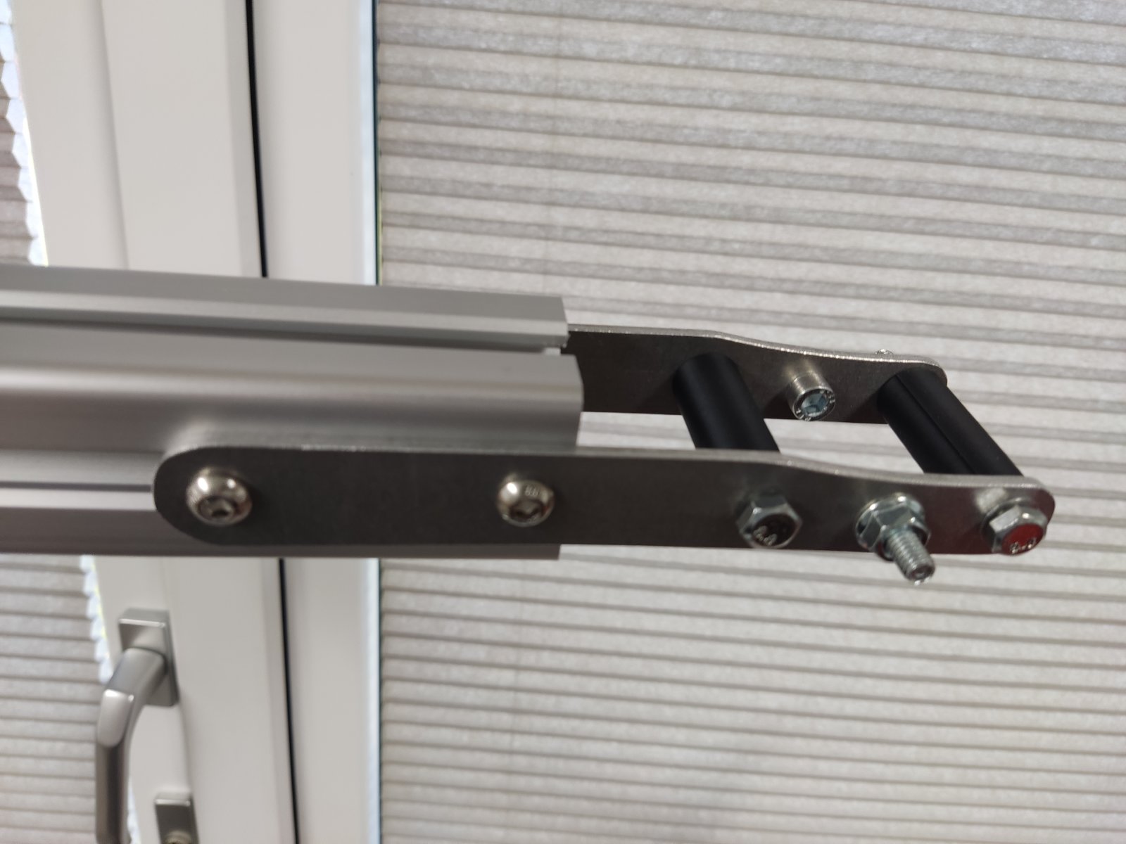

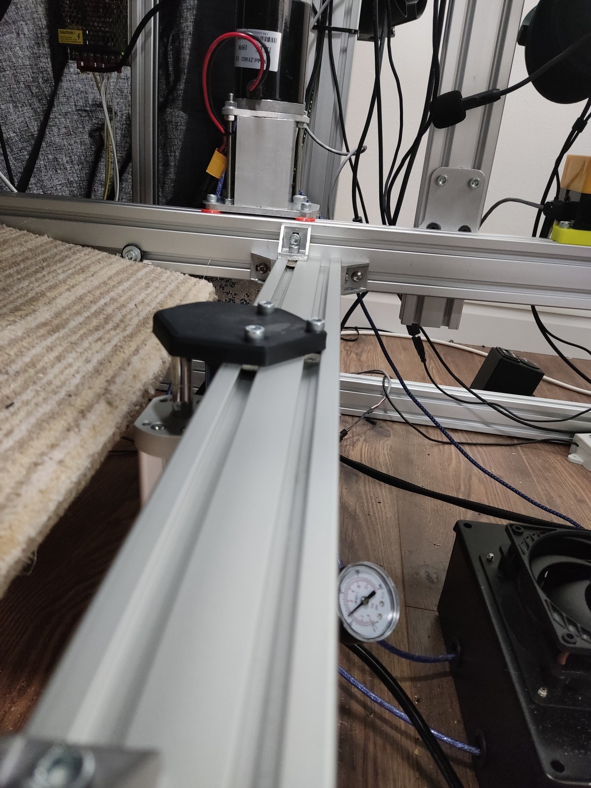

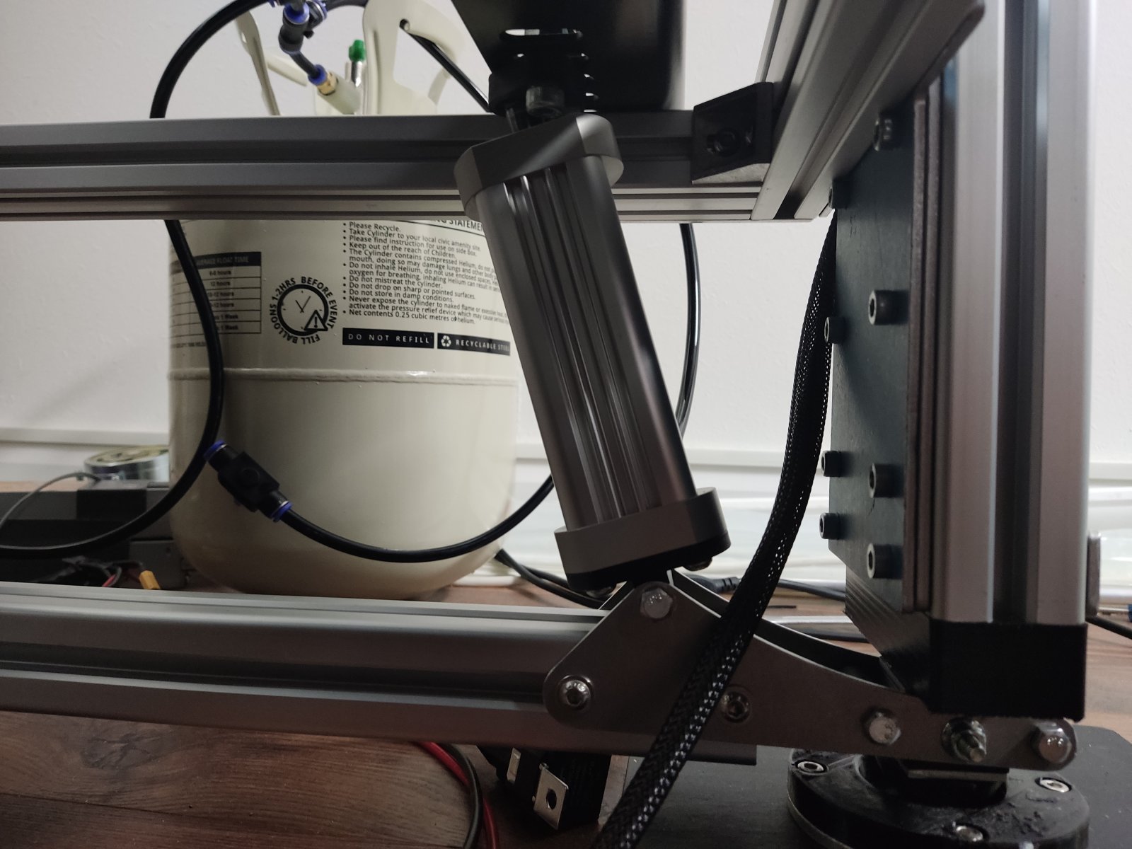

    Finally fitted my spring assist to the actuators, it's taken a couple of months to figure out exactly how and what to use and a bit more time to make the brackets to install it all.
    I initially was going to use springs, however springs are not easy to find in the required rate and suffer with the issue of the ammount of assistance they provide changes with how far they are compressed.
    Second idea was bungee cords but there was no obvious way to mount them that wouldn't cause other issues.
    So i settled on pneumatic cylinders, 2 at the rear and 1 at the front. Due to not wanting them to lift the rig off the ground when i dissmount the rig, they had to be fitted in parallel with the actuators pushing down against the same feet as the motors.
    Below is the beam between the front actuator legs with a single cylinder in the center.
    Front cylinder assembly installed.
    The rear uses 2 cylinders which push against the underside of the seat frame.
    In the background of the above image is an empty helium tank i am using as an air receiver.
    Due to the volume of the receiver compared to the cylinders the pressure should only change by 3 PSI from fully compressed to fully extended so the assistance provided will only vary by 1.5Kg (from memory) over the full range.
    I tested the rig for a couple of hours last night with just the rear cylinders pressurised.
    I now have the front cylinder working as well and have refitted the small 150W motors to the rear actuators as they now have much less work to do.
    A quick 10 min test and all is working fine with the small motors all round, much more motion on the rear actuators than i had before due to the small motors being considerably faster.
    Just have a massive mess to clear up and a lot of cable managment to do (the cable management can wait).
