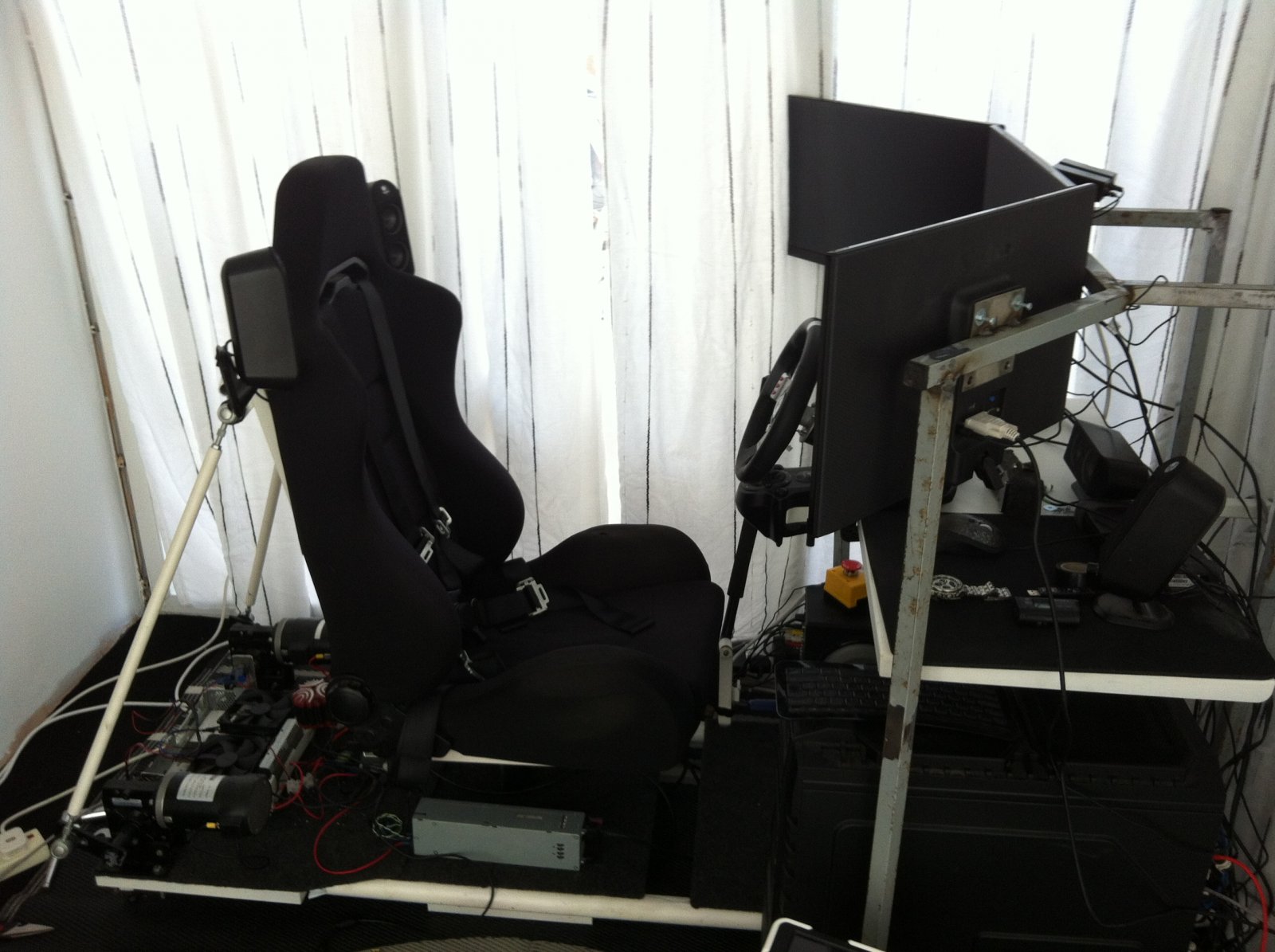

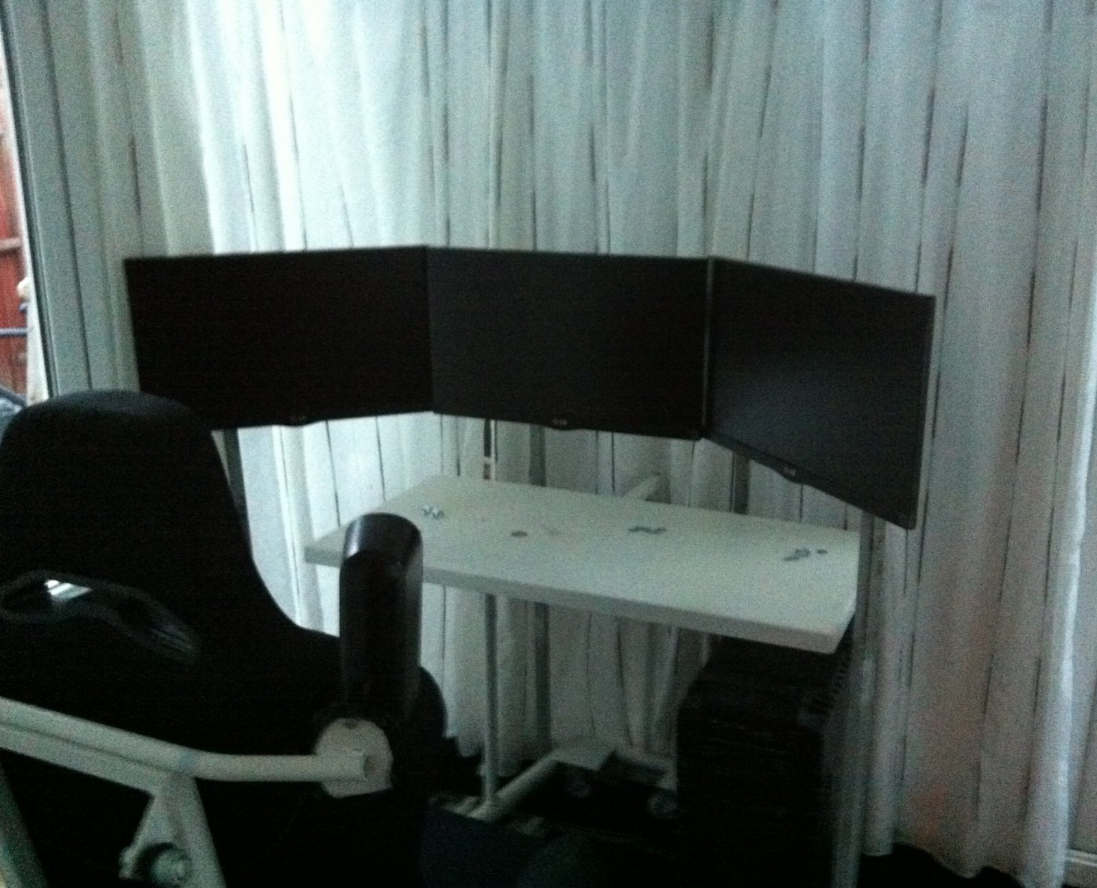

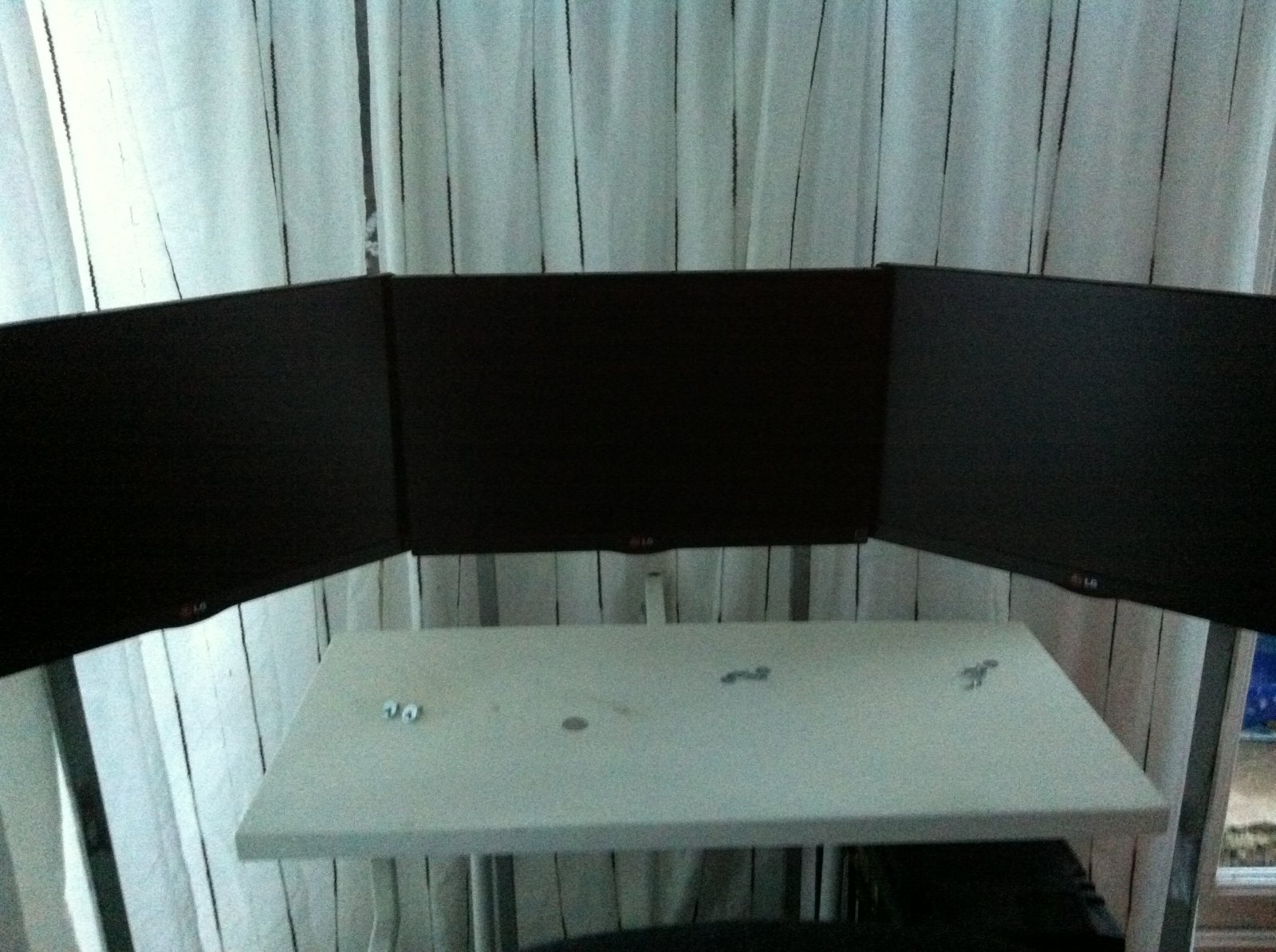

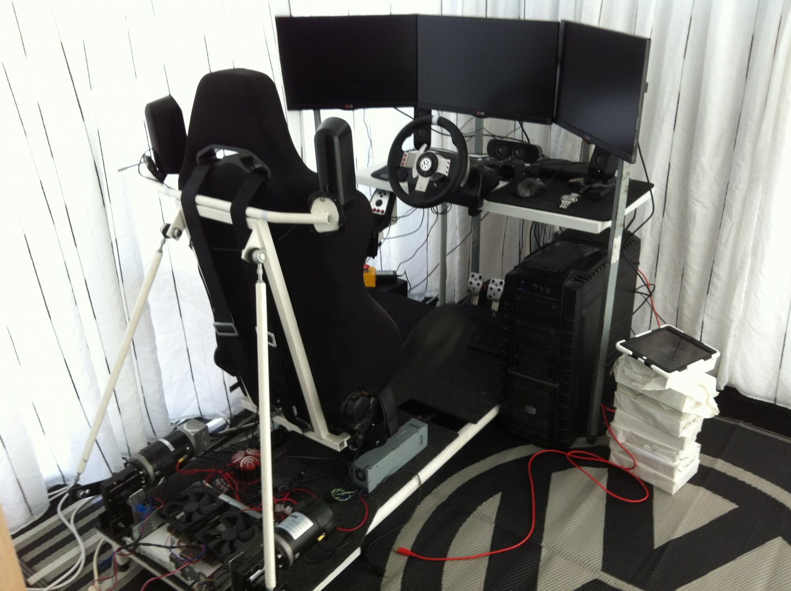

    so not a lot of progress theses days been having a blast using it, fine tuning profiles etc. ;)
    anyway I have moved it into a different part of the house "Man Cave Time lol:cheers"
    So I used to have my triple screens on stacks of paper lol see vid below
    time for an upgrade
    so made a stand it still needs painting but im waiting to see if I need to mount anymore stuff to it first, living with it for a while so to speak
    also had an harness as a gift from my kids so mocked that up too
    just got to do some cable management and sort the fans etc the rest is just cosmetic :thumbs

    Nice upgrade @Daguru :thumbs
    I see the stacks of paper are now a tablet stand...does a mount for that come next ;)

    @noorbeast wow Great minds think alike I was actually thinking about should I mount it lol

    Better make a stand for the paper too!:p
    Seriously though, good work on the monitor stand. I personally think that having your monitors mounted securely is definitely a good idea.

    @GIB SimRacing lol yeah cheers they are totally separate from the rig so no movement at all which is what I wanted and they are at a much nicer height.
    I think I might have more paper somewhere that I could use to make a stand for this paper, watch this space lol

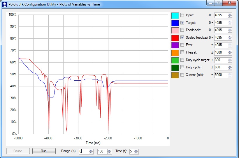

    Hi, need help with a problem that's just happened getting the clicking I had before but this time there's no errors the one motor is moving very small crazy movements sometimes on its own, (my guess is the pot is on its way out) can anyone confirm this ? hope its not the JRK (I've not done any testing yet and got no spare pots) I did check the pots connection to the motor and its all good
    the second motor its all good.
    thanks in advance

    What kind of pots do you have, and Are you 100% Positive the pot didn't "Spin a little" in its mount and might possibly be RIGHT on the edge of its acceptable range ?

    I would order up some Nice Hall effect's and be done with it. They are Super tough as far as im concerned when you have thing's set up properly.
