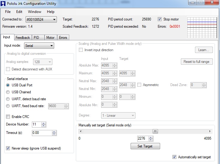

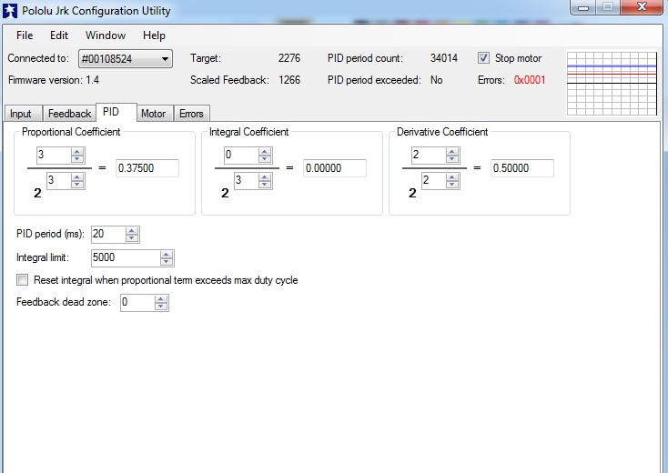

    Hi
    been off the project for a while but need help badly right now,
    I now have 4 MM (did have 5 returned one as it didn't work at all)
    Out of the 4 I have only one that works the motor both directions the others either cut out under load or only work one direction, so about 30mins from me there's a stockist of pololu jrk 12v12 so I went and picked 2 up and now I am getting motor drive errors by the bucket load:(
    There's like a clicking sound from the motor when it errors both in game and when I use the slider in the input tab this happens if I am in the seat or not, settings are as follows
    Thanks in advance

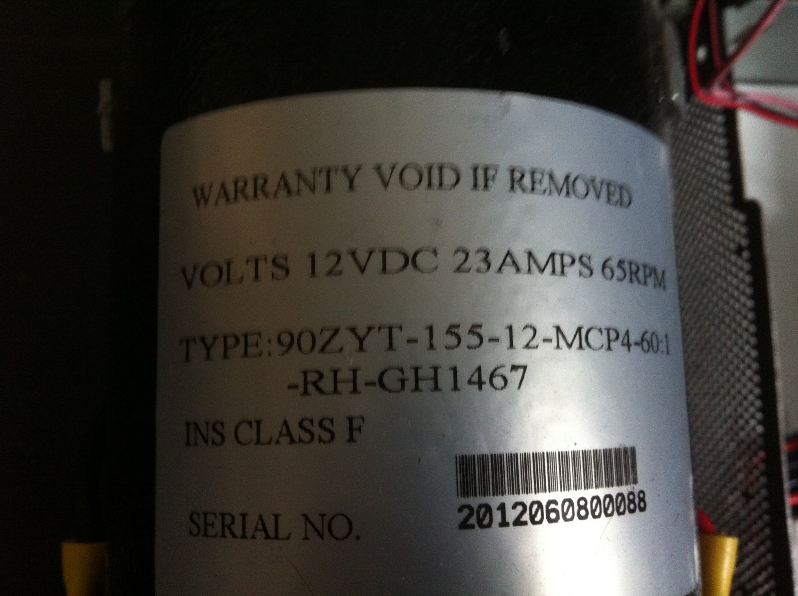

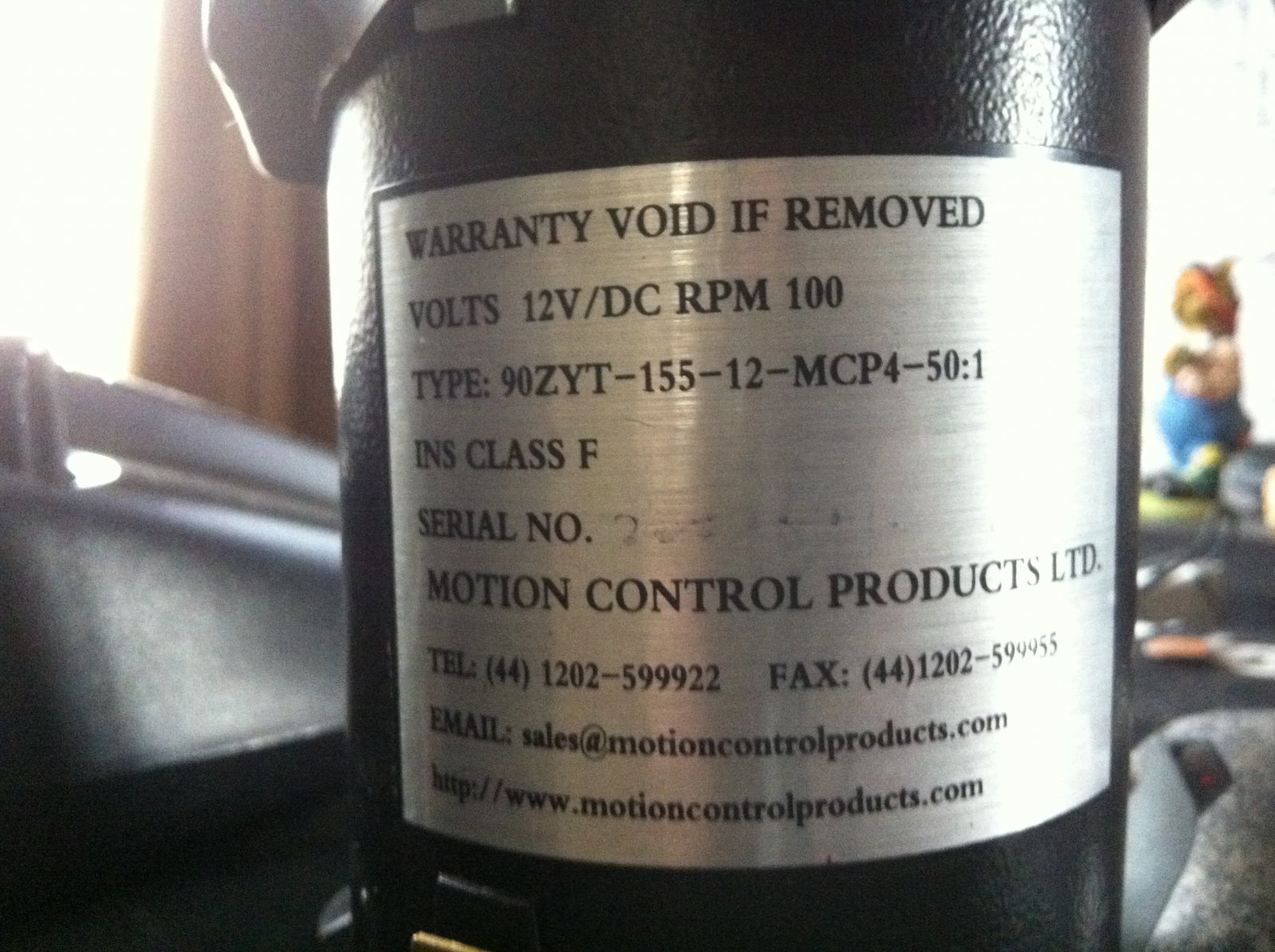

    got choice on motors have 2 pairs
    this one has 50:1 gearbox (can swap gearbox over with each motor if needed)
    or this one 60:1 gearbox
    thanks again :)

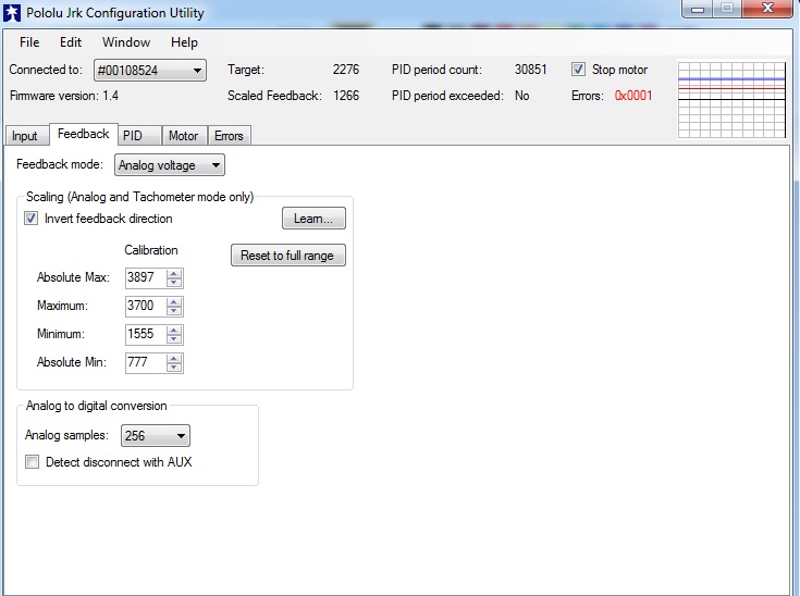

    On the feedback tab set the Analog Samples to 512.
    Are you sure the pots are not going out of range, the graph looks like they are not centered.
    What are the actual error messages, you have not shown the error tab?
    What CTC are the motor levers?
  8. Daguru
    Sep 4, 2013
    725
    Kitchen installer
    Wales uk
    233Coins
    +634 / 1 / -0
    Motion platform
    @noorbeast
    Feedback has been set at 512 in most of the testing been trying lots of different settings
    Yeah pots have been centred I've clicked detect motor direction and you get a tiny jolt to show they are centred, just before I took screen shots I was re-doing the feedback max and min setting using the learn button and might not have centred it for the pictures

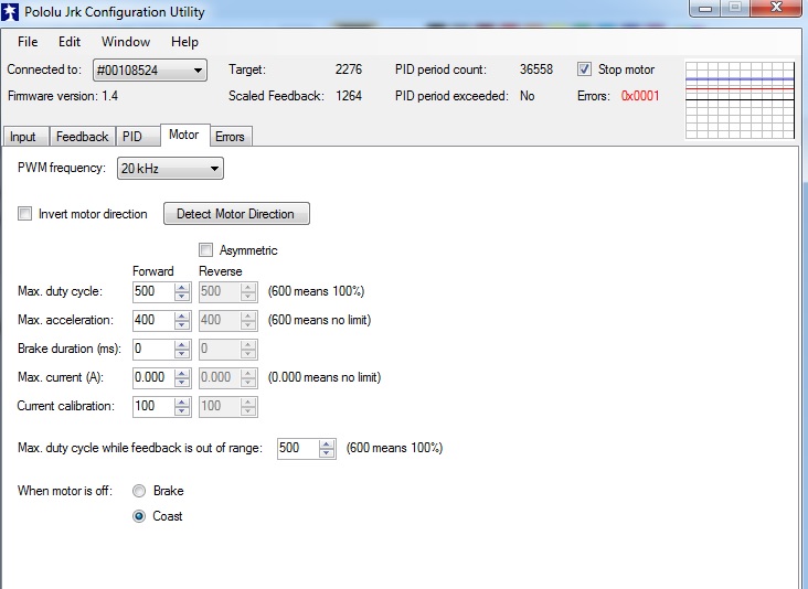

  11. SeatTime
    2,572
    +2,854 / 40 / -0
    It looks to be a high speed 5000RPM motor (50:1 at 100 RPM), unfortunately these have been shown to generate a high back EMF when driven hard even from just the armature load (there is a thread somewhere that goes through this) and overload the motor driver. I would recommend you try one of @Pit high current MMs setups (two MMs driving 1 motor) http://www.xsimulator.net/community...bridge-60a-continuous-and-120a-peak-12v.6537/- all you can do on a JRK is turn down the acceleration and duty cycle until it stops.

  19. Avenga76
    Avenga76 Well-Known Member
    Jun 29, 2014
    518
    Network Engineer
    Auckland, New Zealand
    3,262Coins
    +859 / 6 / -0
    I have this exact same problem with my 50:1 ratio motors. It seems like motors over around 4,500RPM draw too much current when you try to reverse the direction of the motors.
    Have a read of my build thread and I talk a lot about it. I have some videos of some of the testing I did with the gearbox removed. In the video you can see that the motor driver error only occur when the motor are spinning fast, if you reverse the direction at slow speed they are fine.
    Have a read of my build thread from about here. http://www.xsimulator.net/community...er-gs-4-simvibe-gauges.5596/page-8#post-68644
    In the end I got it going nicely by lowering the duty cycles and adding some brake duration.
    I found that 250 duty cycle and acceleration with a 20ms brake duration gave me very few driver errors, some games have smoother motion so I am able to go up to around 300-350 duty cycles but I would start at 250 then work your way up until you start getting too many motor driver errors.
    Here is a post with more about the brake duration.
