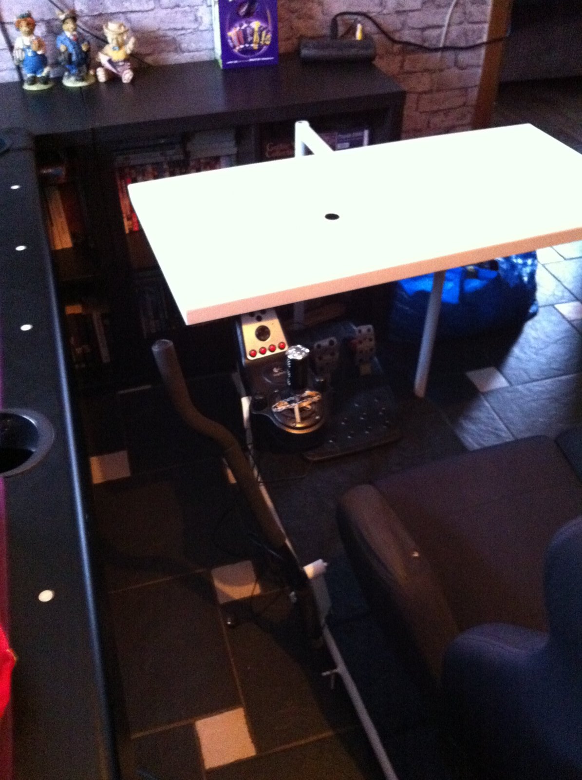

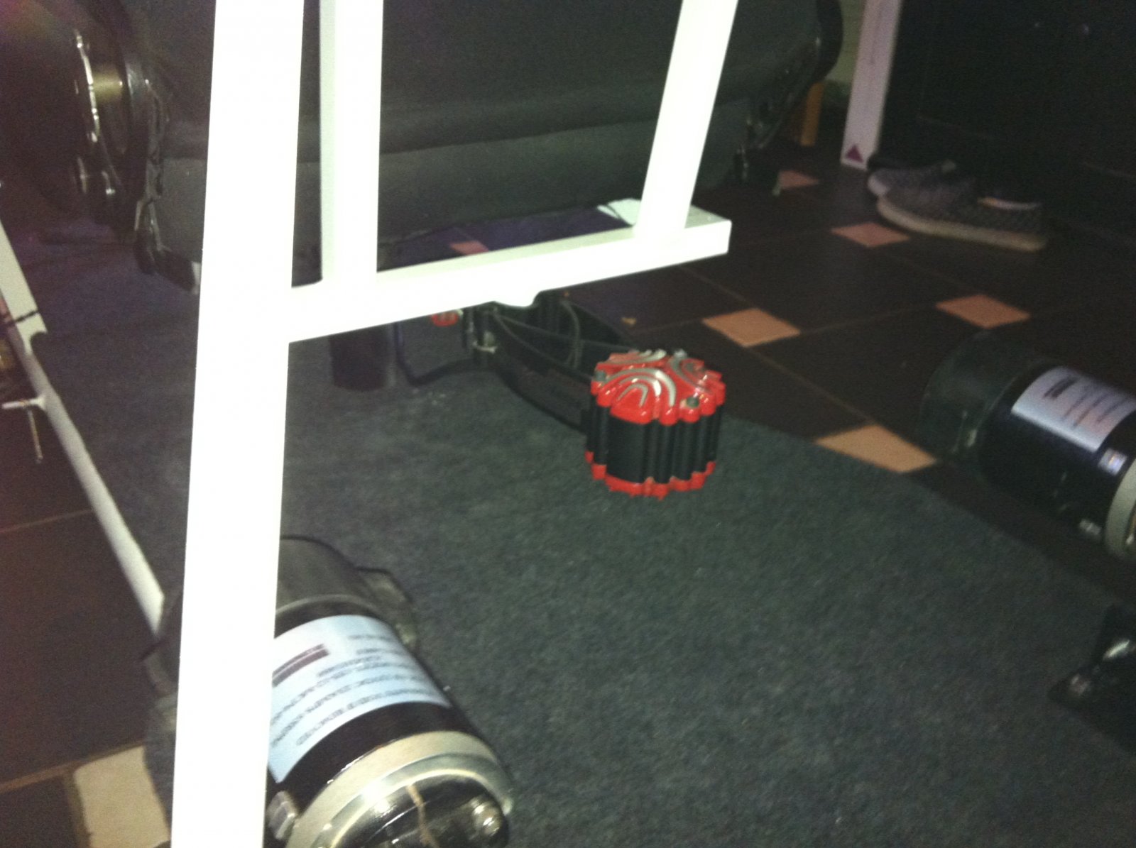

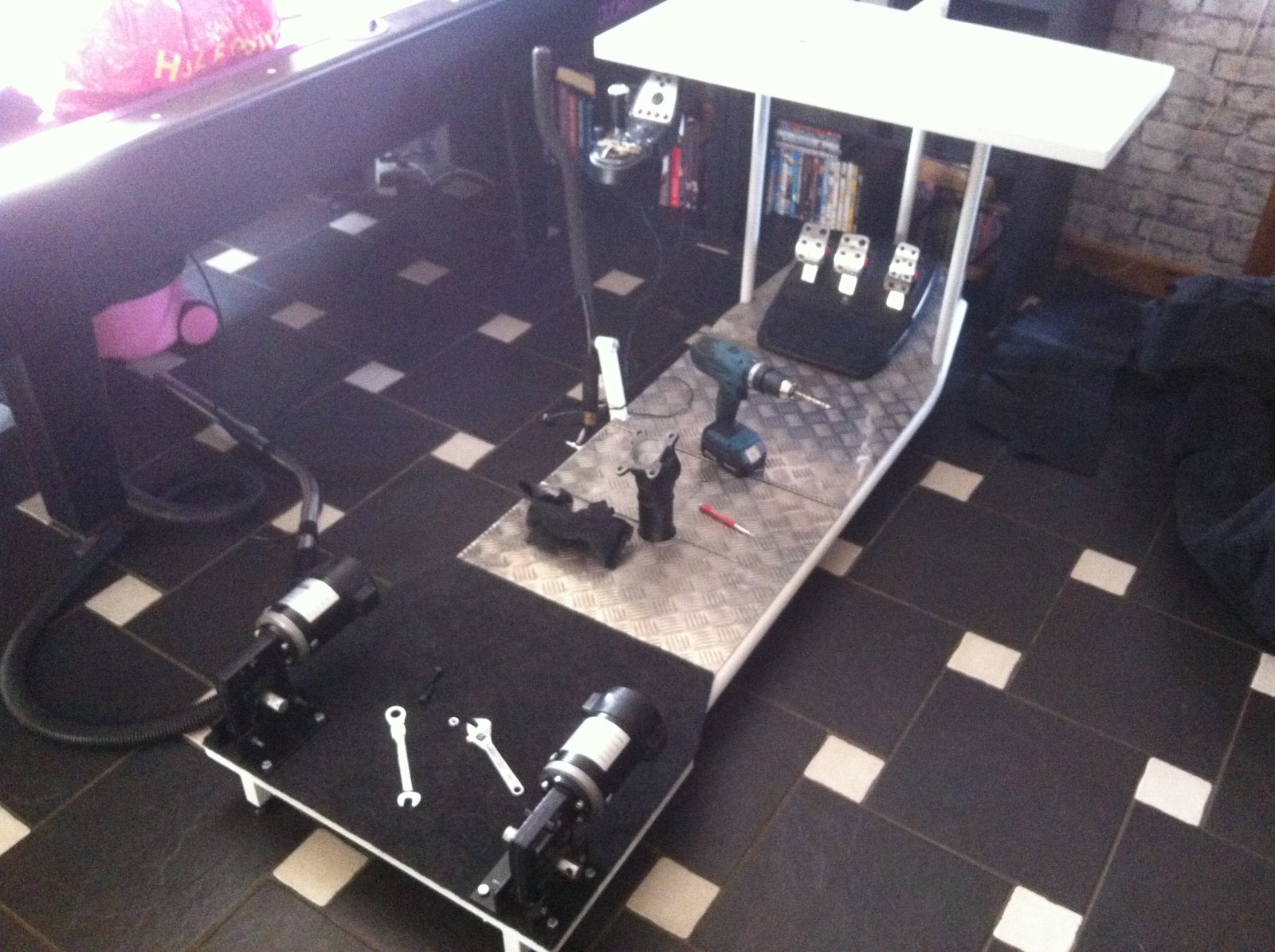

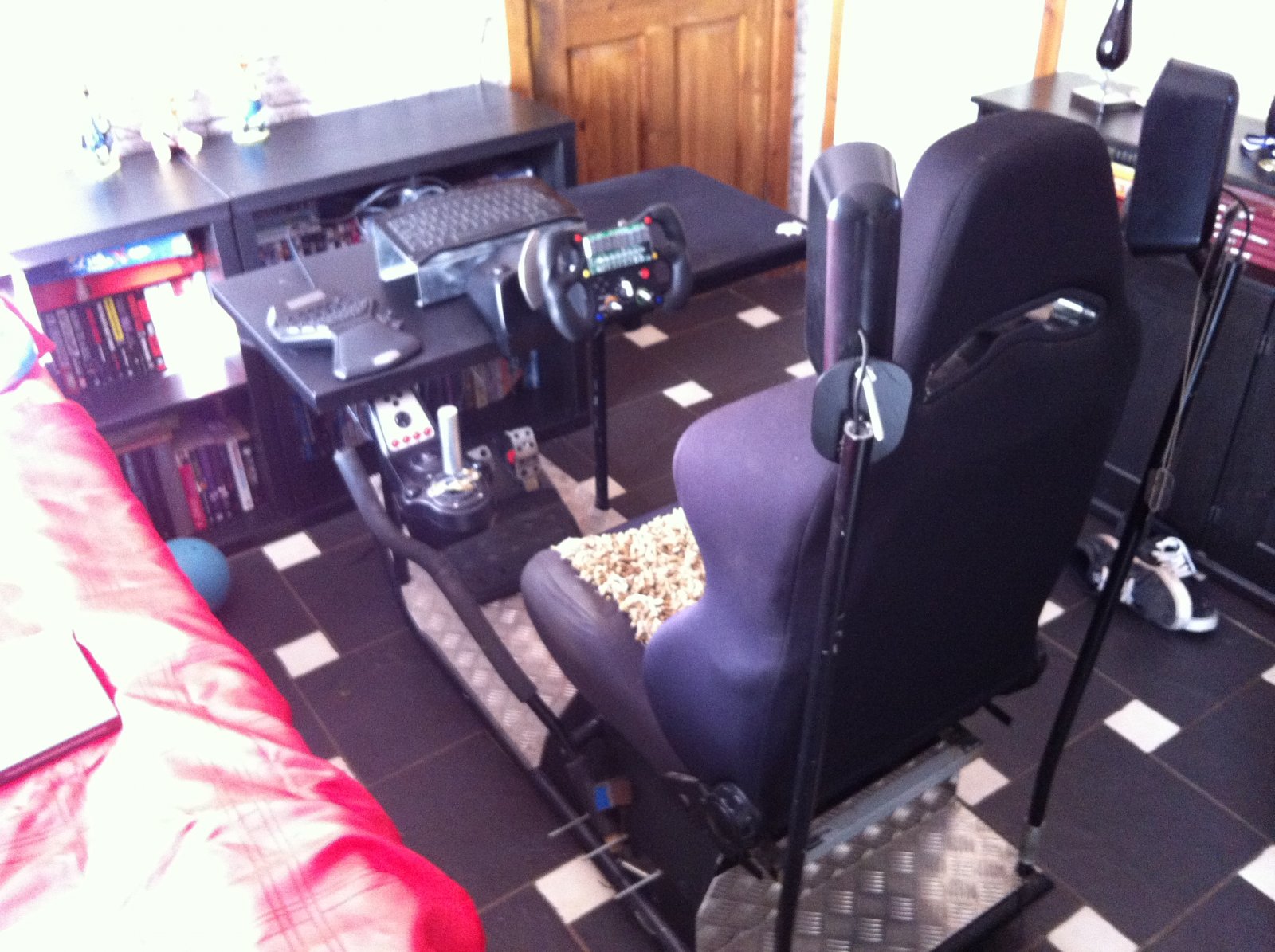

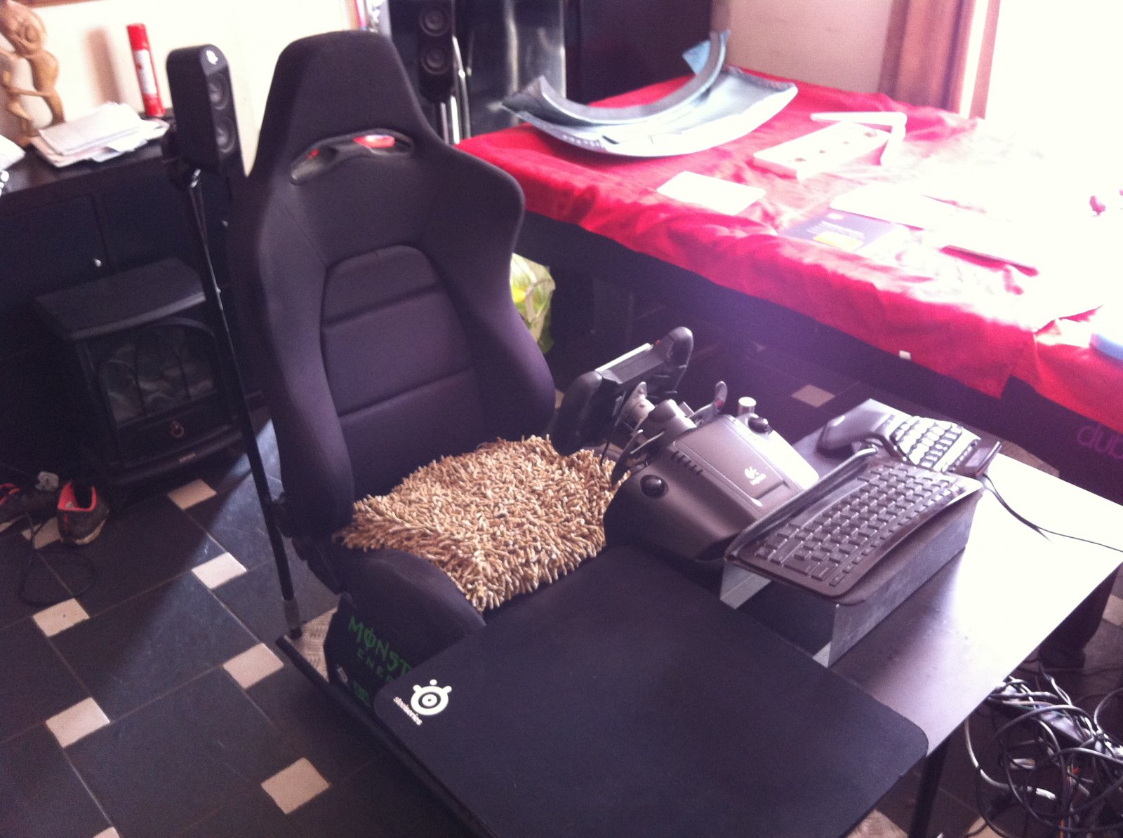

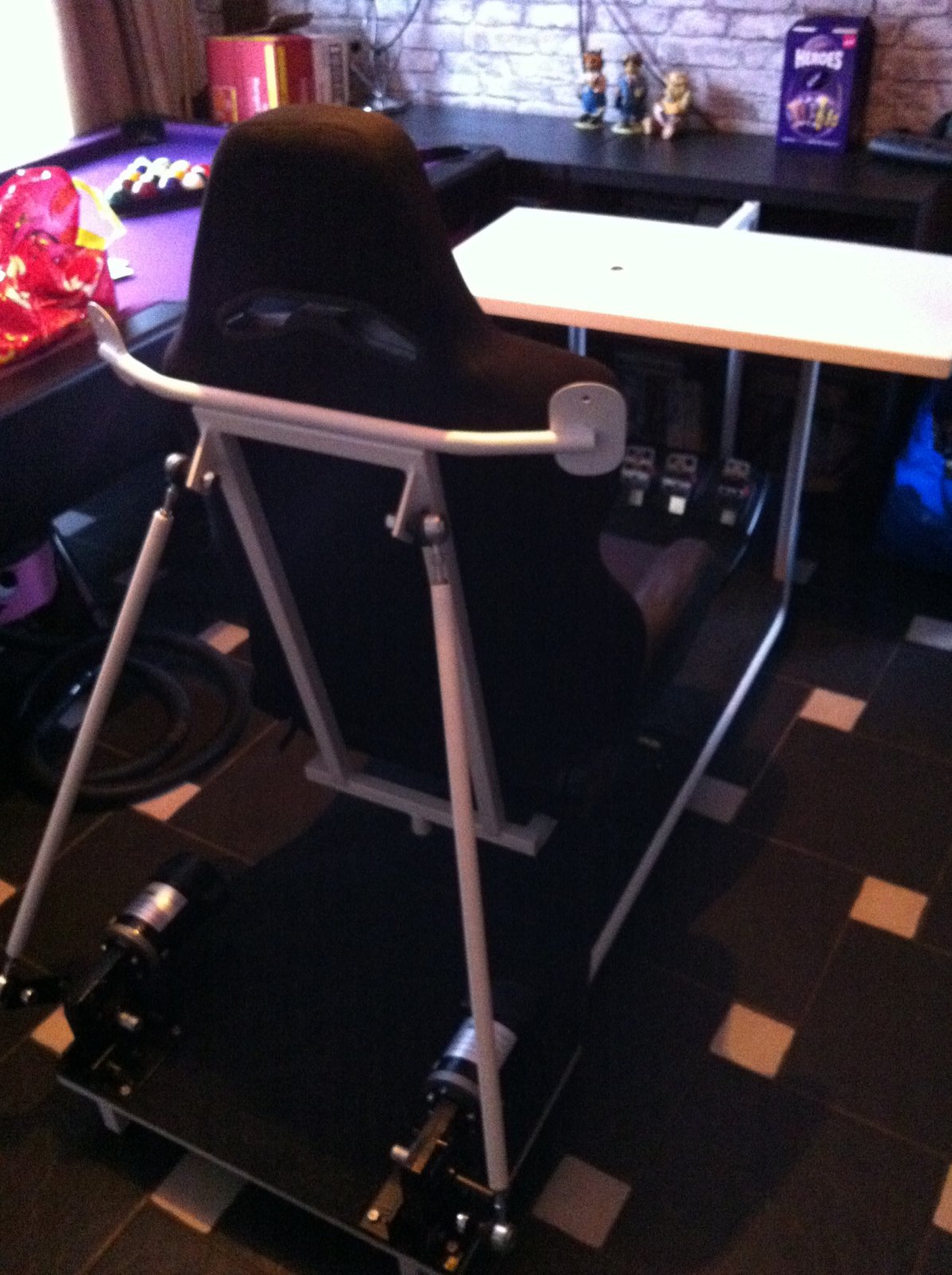

    Hi
    I'm hoping that my crazy life will calm down a bit so I can get on with this project

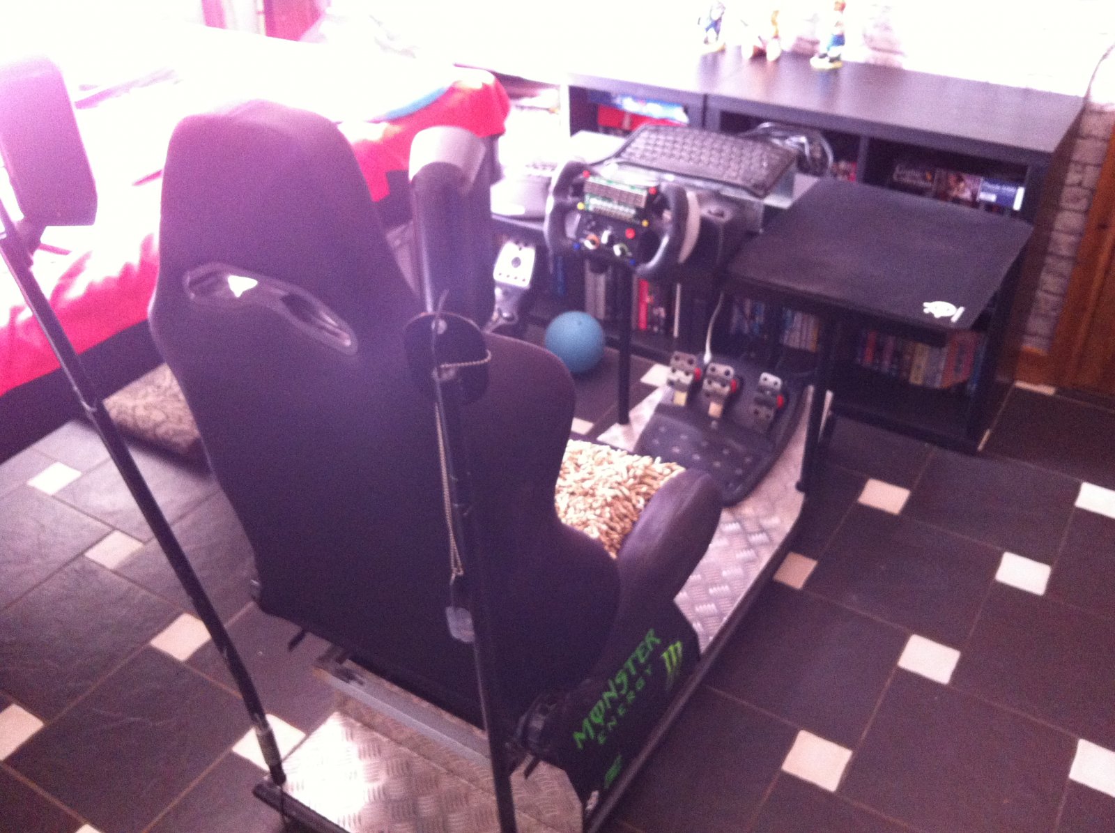

    here is a couple of pictures of my static rig that I plan to convert to motion
    I built it about 4 or 5 years ago and use it for Racing, FPS and Apache Air Assault but mainly Rally
    but I have to say Assetto corsa is drawing me into track racing more and more these days;)

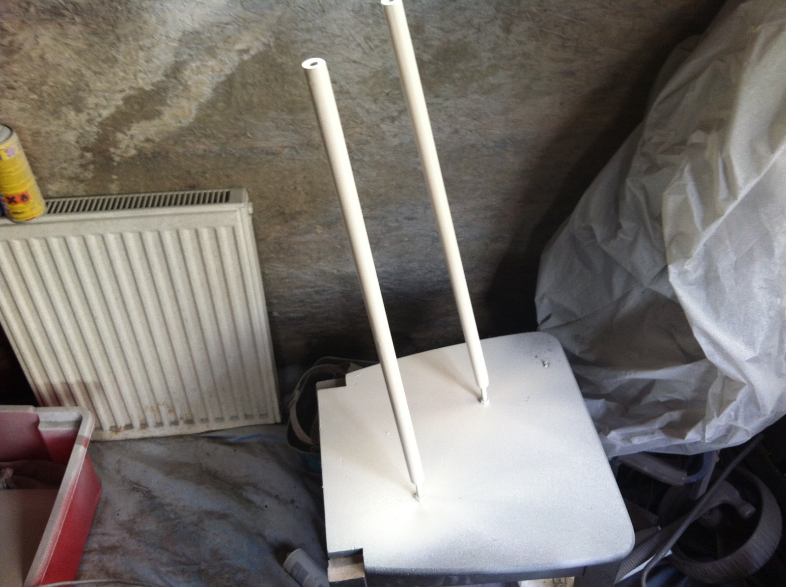

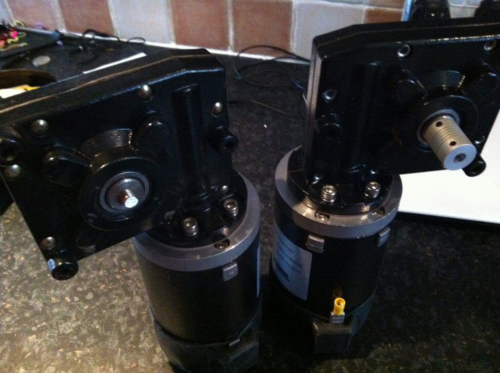

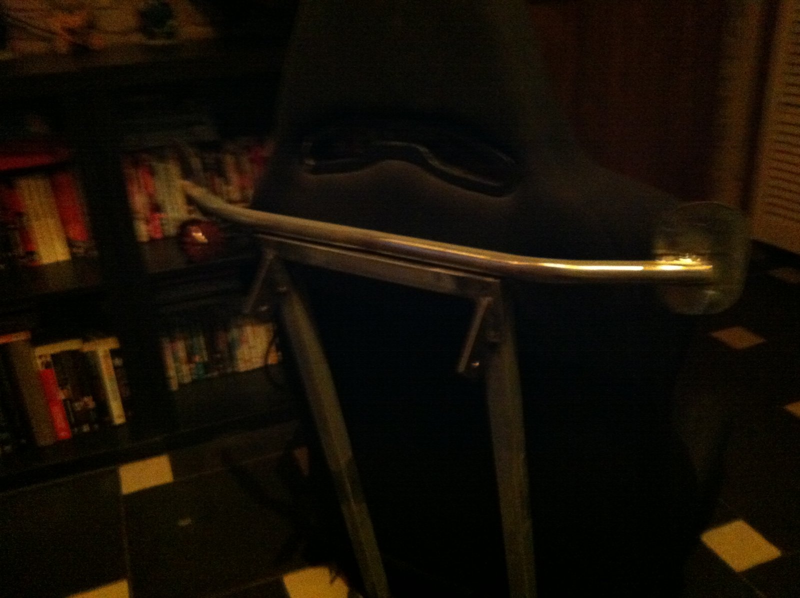

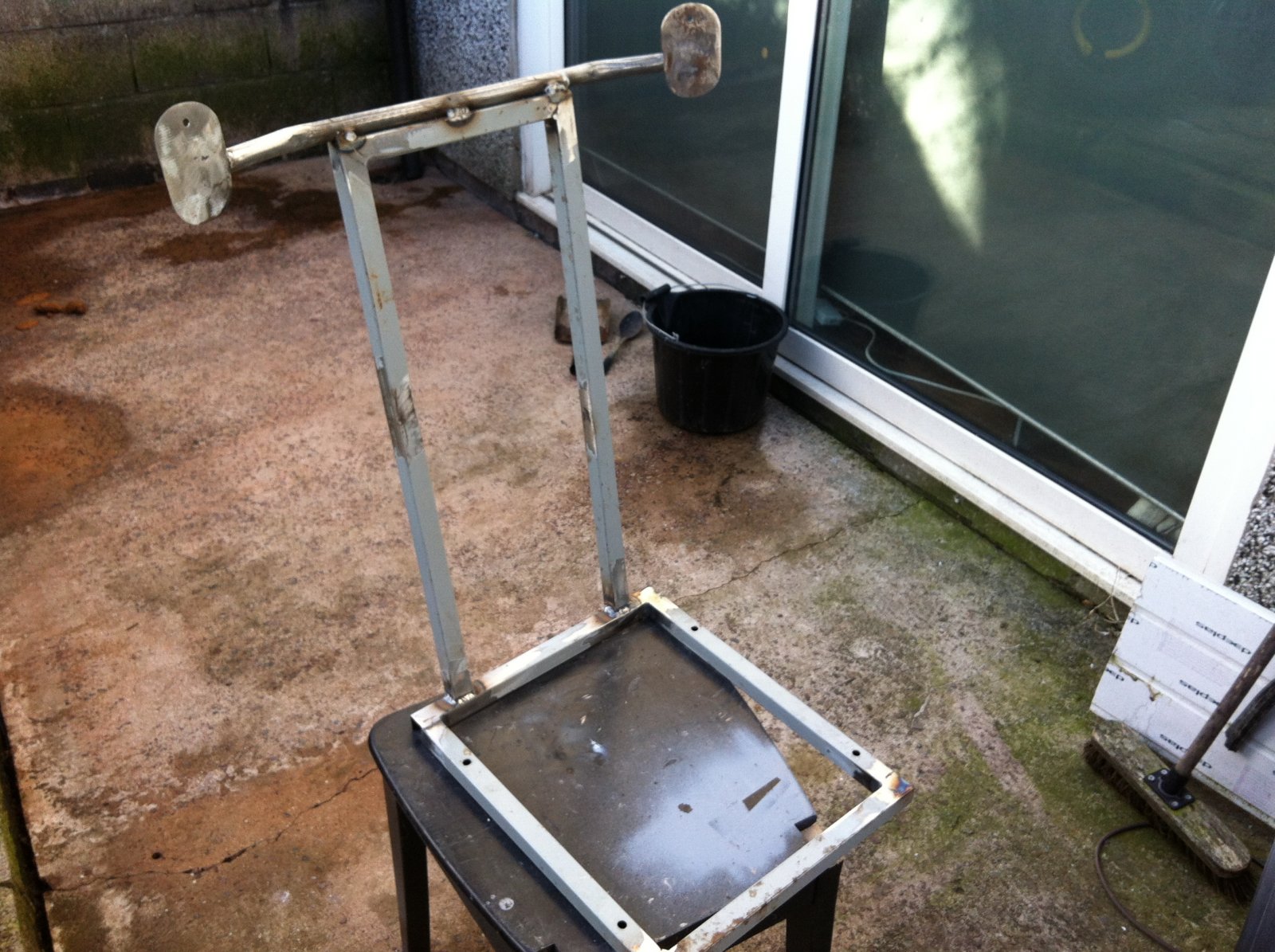

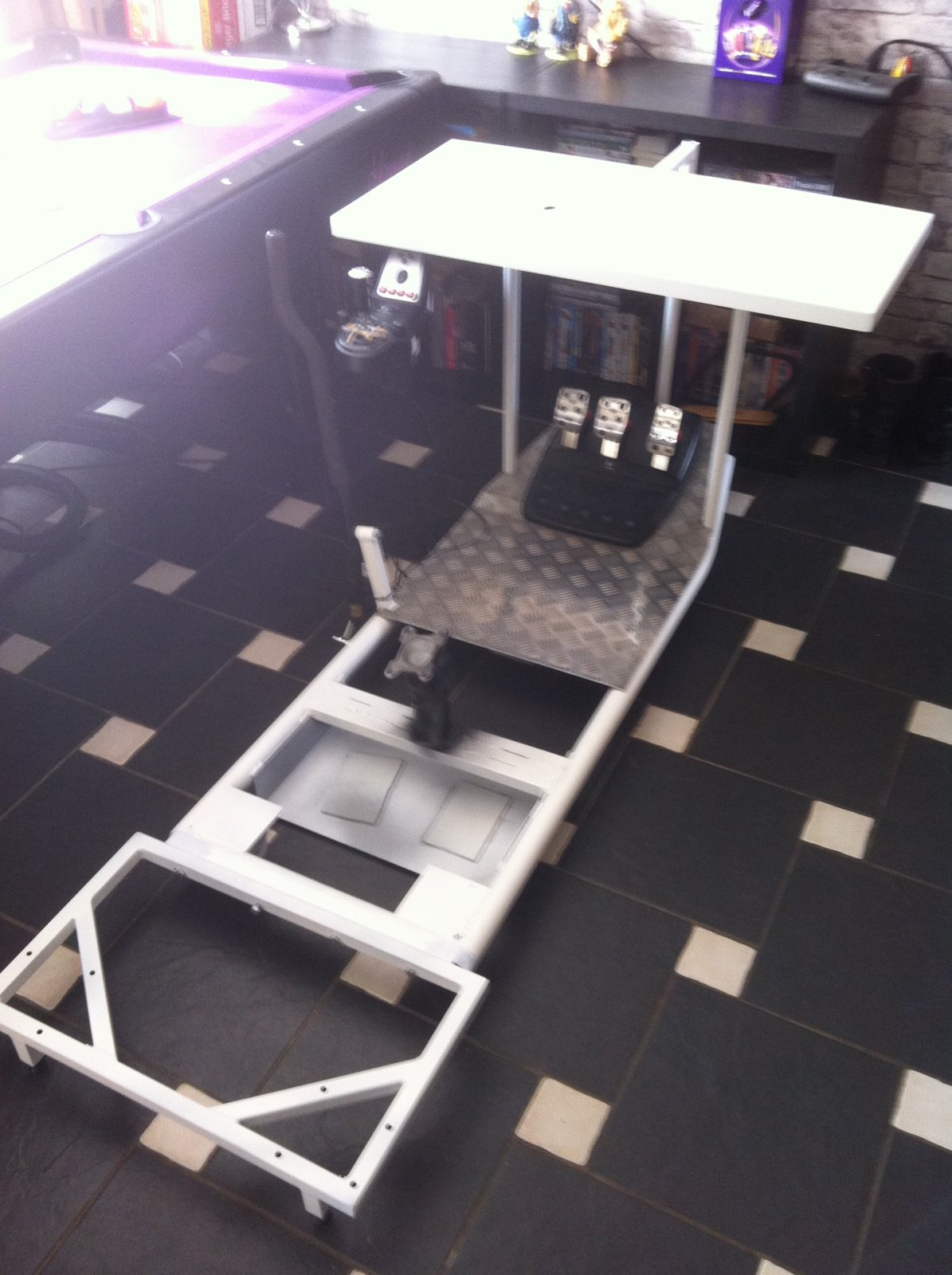

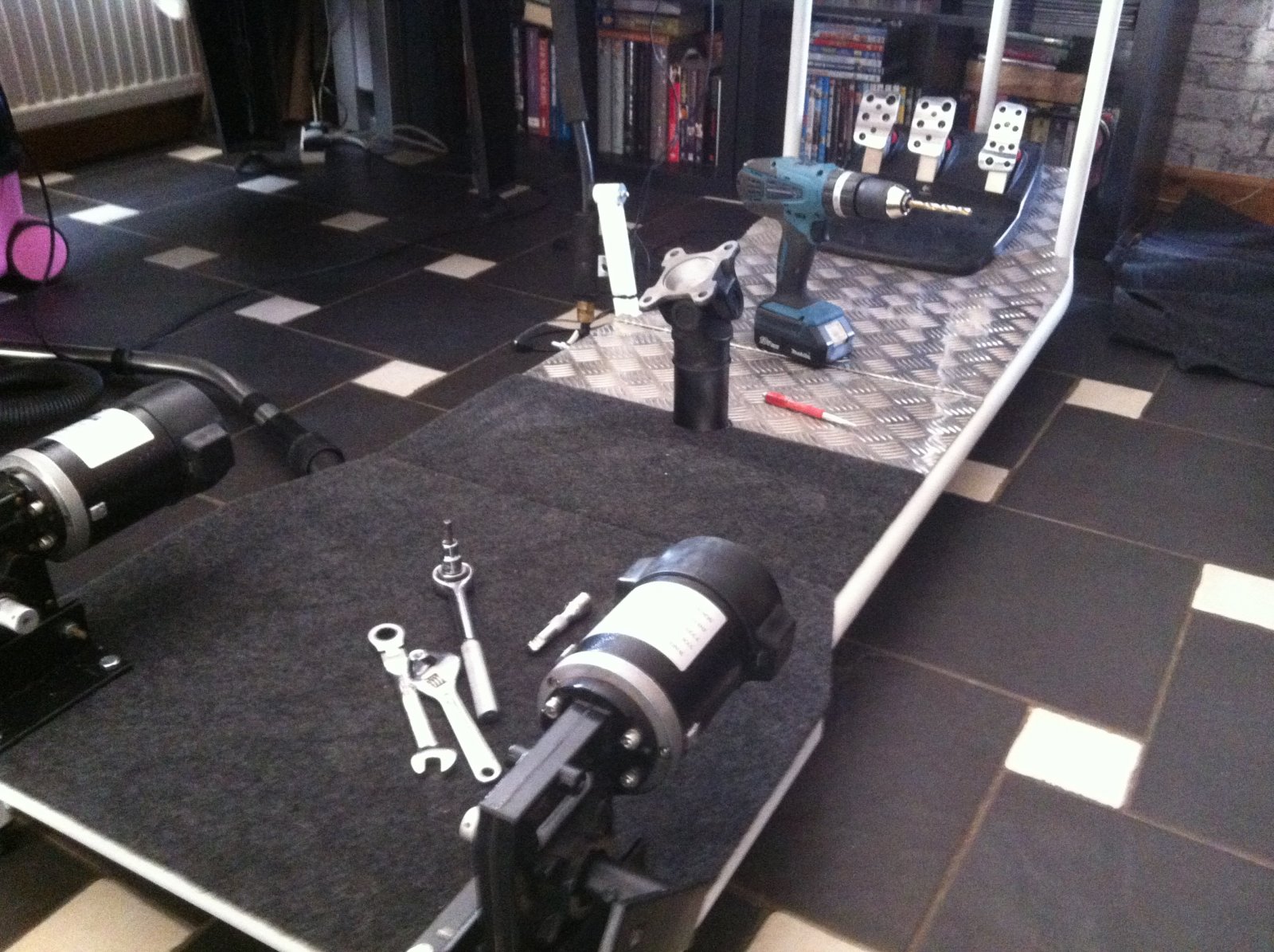

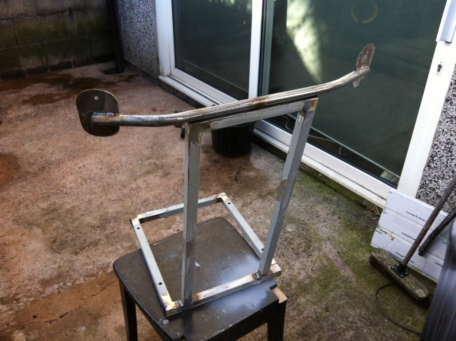

    quick update
    made a start on the seat frame
    a pair of levers
    drilled and tapped M8 bolt in rear of shaft for pot mount
    its a nice feeling getting stuck in for a few hours :cool:

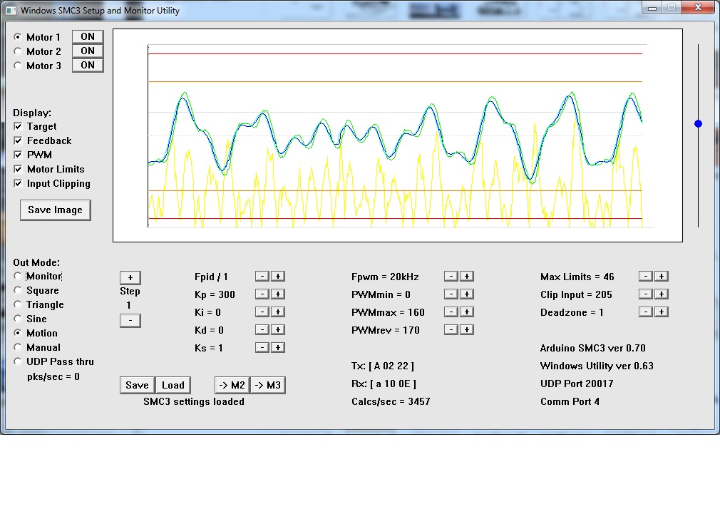

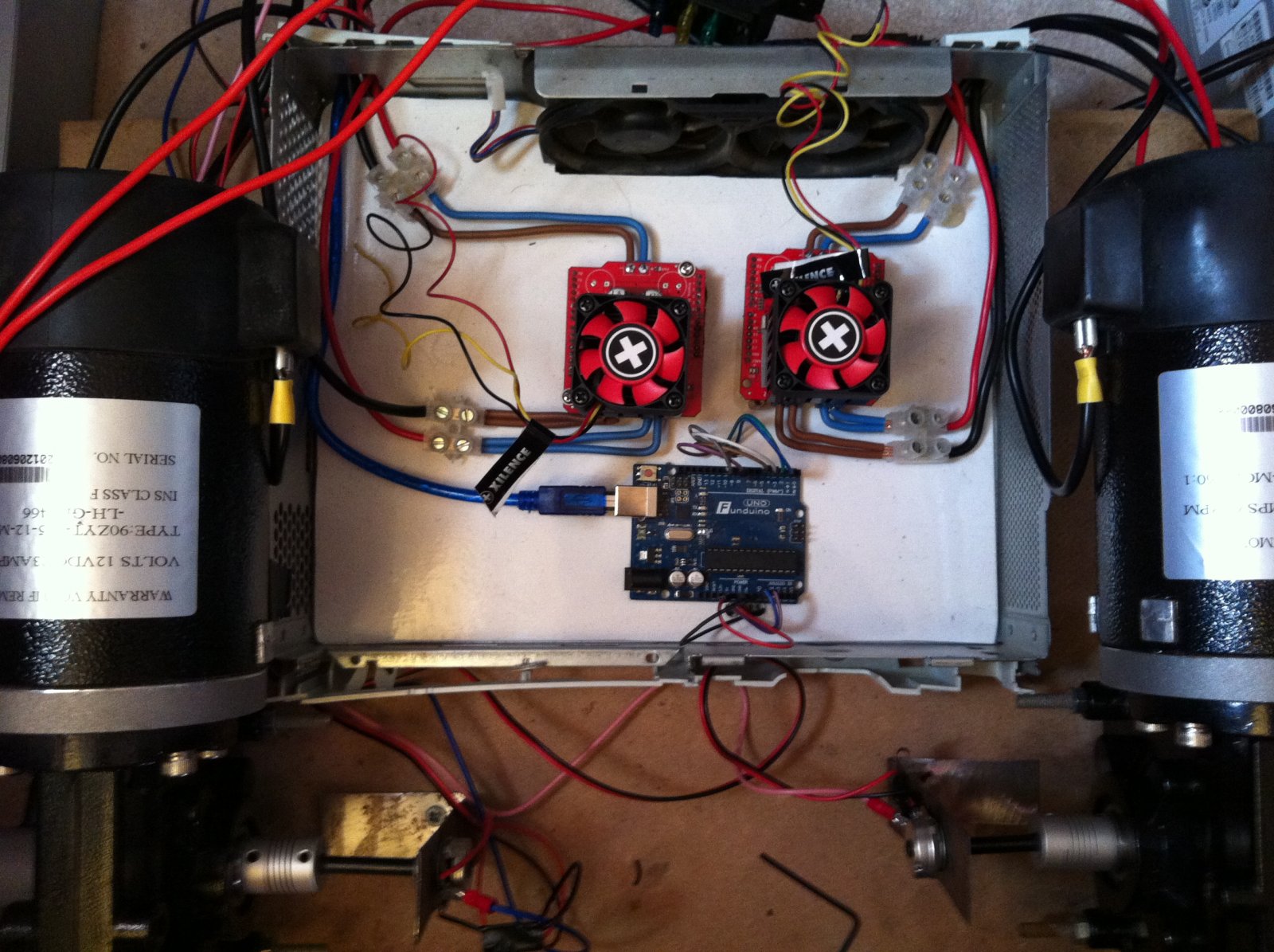

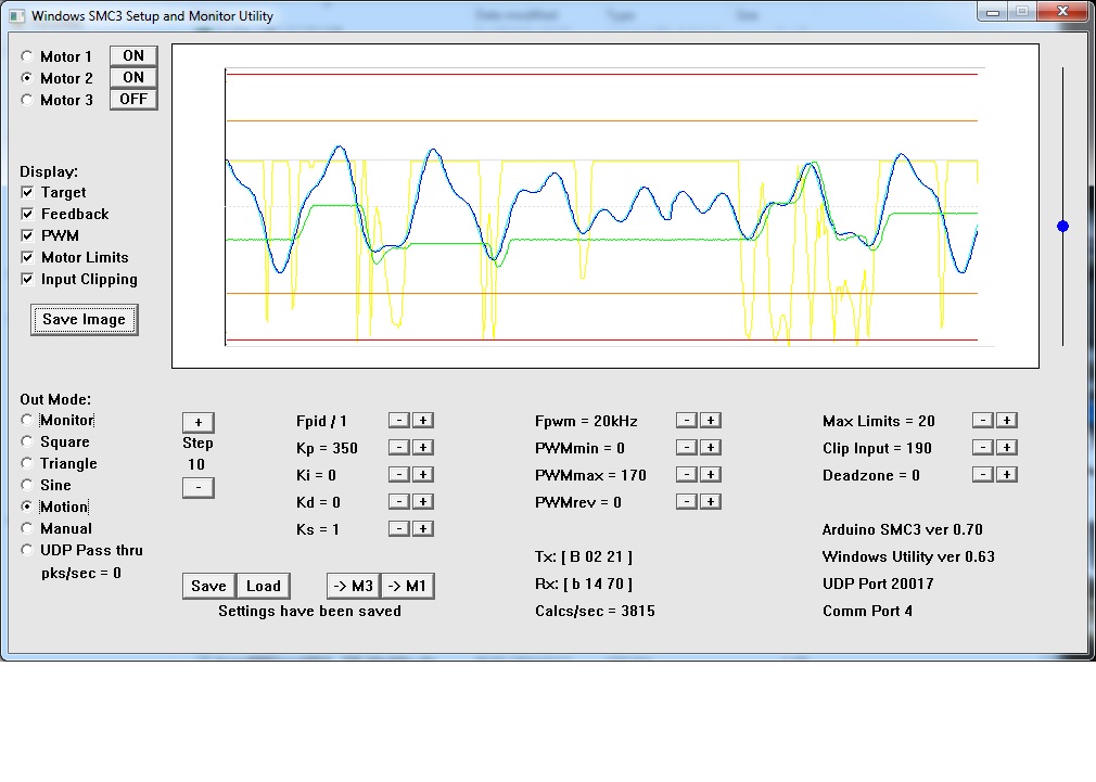

    Hi
    I've mocked up the wiring and motors loaded the arduino with SMC3 ran through the tutorial a bingo I have motion
    set up SimTools as per tutorial and bingo I have motion in games, 3 games tested so far so to my question
    how does the SMC3 Utils settings look to you guys
    im using 2 monster motos with 90zyt 155 with 60:1 I have left the settings im guessing on the low side so I didn't blow anything right away
    I am using very cheap pots and think that might be why the feedback is not spot on is that correct ?

    Hi guys,
    Good news and bad I got rig mocked up, tested it and it seemed to be working ok so started to setup some profiles and then noticed the one motor would stop working intermittently so took a screenshot of smc3 utils
    any ideas?
    I swapped the power supply's over and it still the same.
    Also swapped the pot for a new one and ran a fresh wire from pot to arduino.
    Just quickly tried a car battery to power it and still no joy.
    kind regards
    Dag
  12. Blame73
    Blame73 Well-Known Member
    Nov 6, 2014
    1,216
    8,316Coins
    +1,142 / 5 / -0
    check monster motor solderings, the power ones, I had a similar issue and it was due to a bad soldering

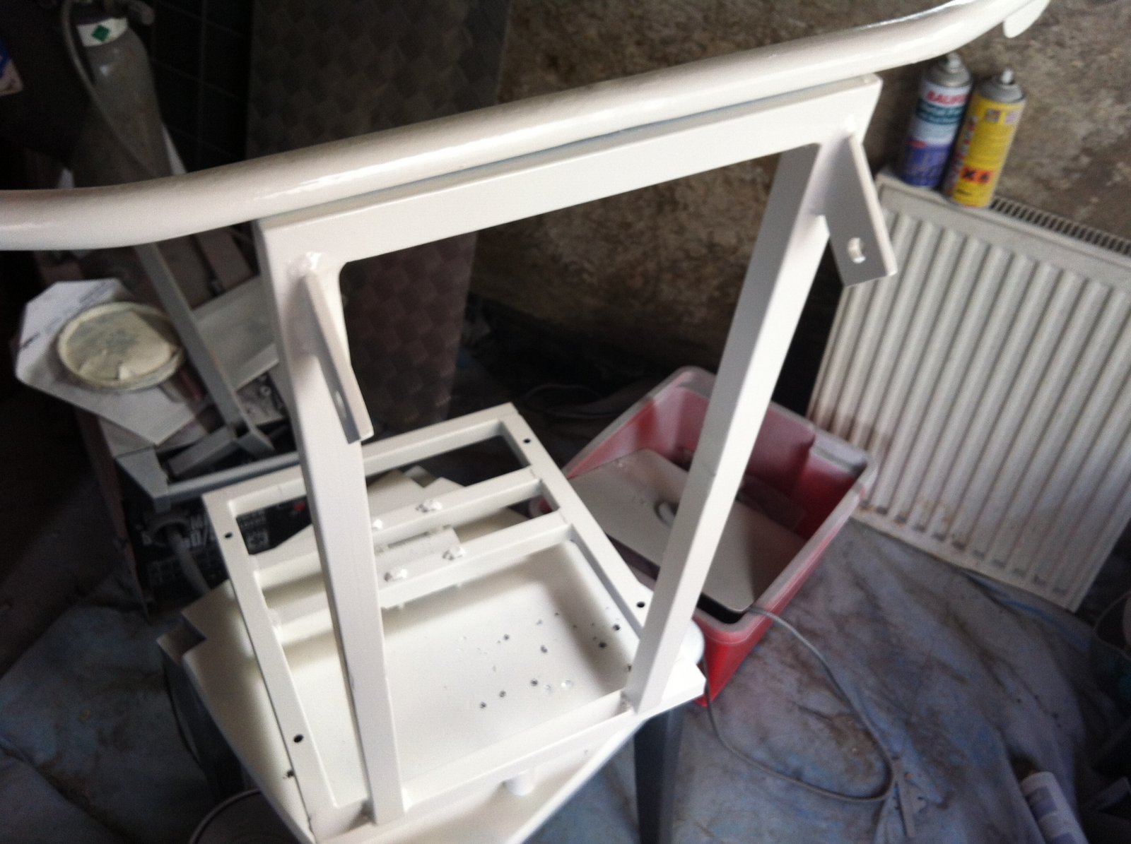

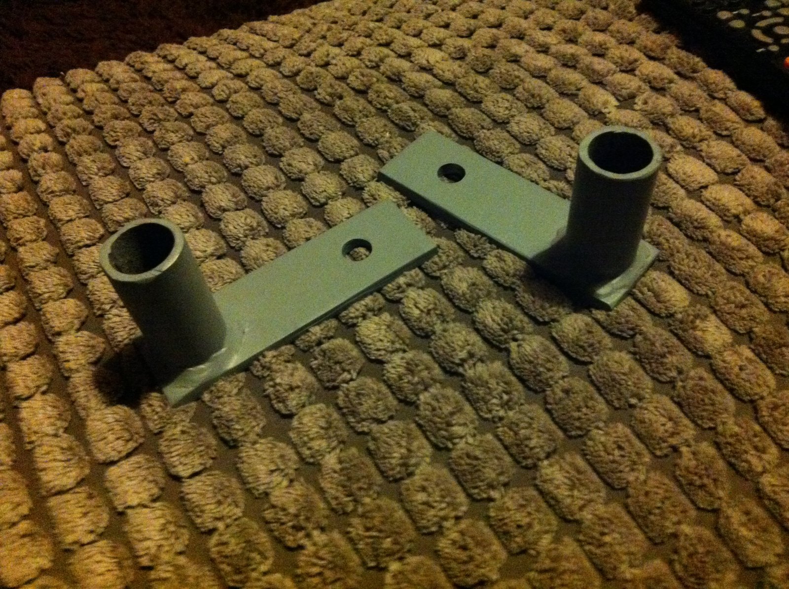

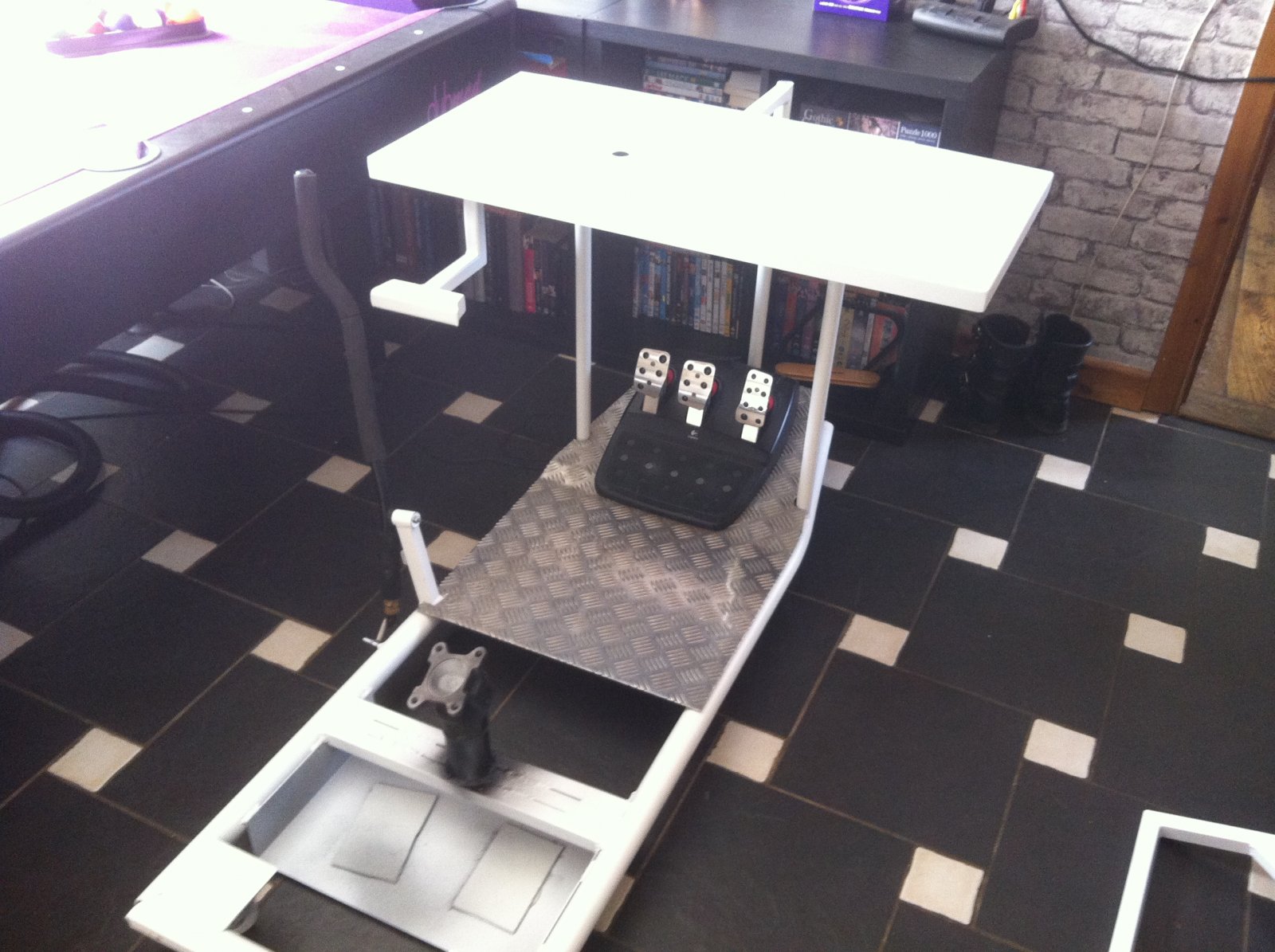

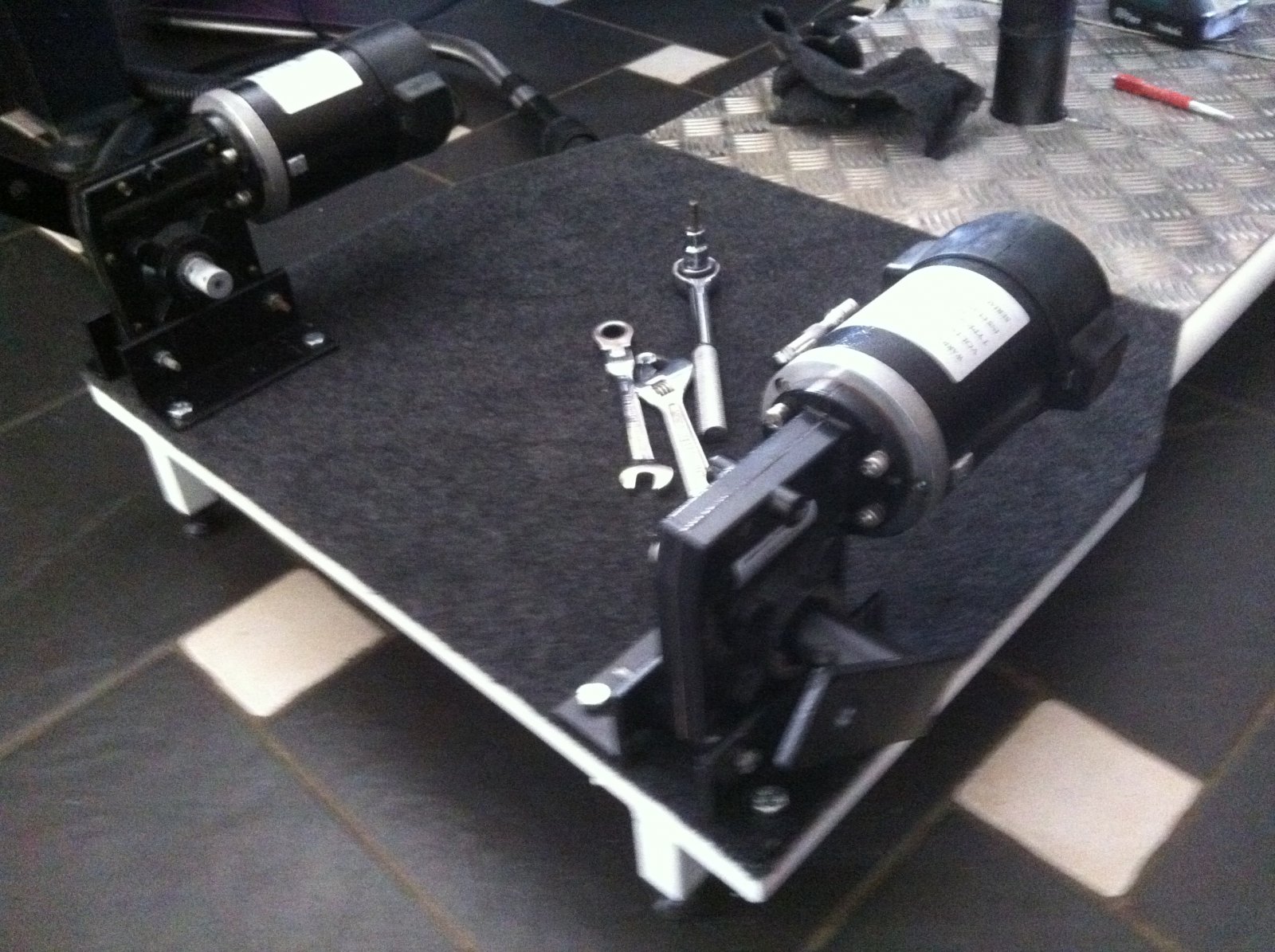

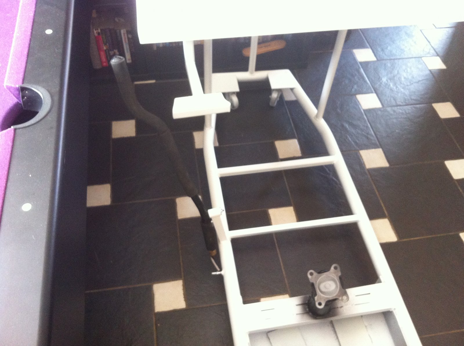

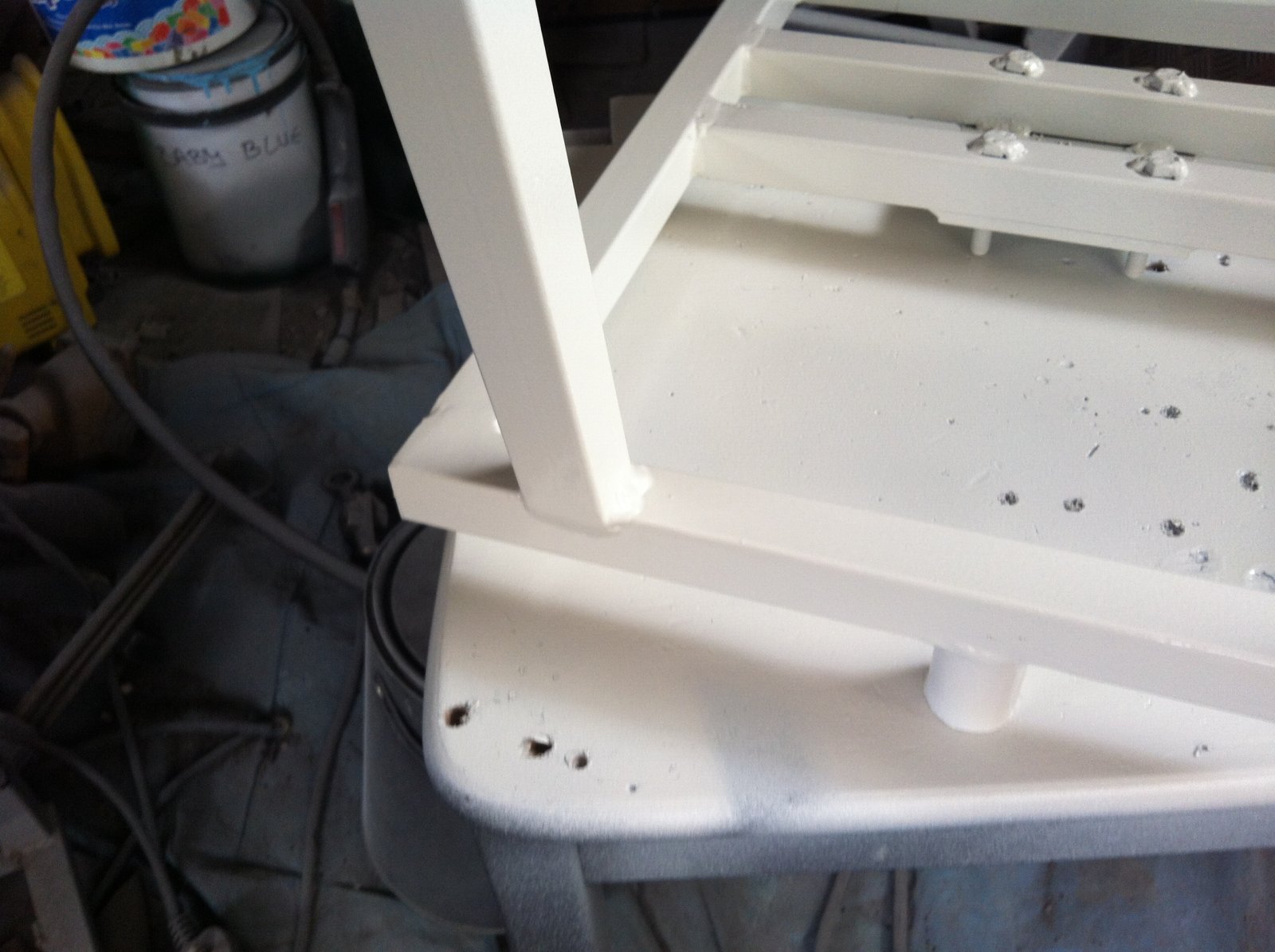

    little update
    seat frame painted
    arms painted
    and my brother printed me a mug lol
    going to paint main frame now ;)

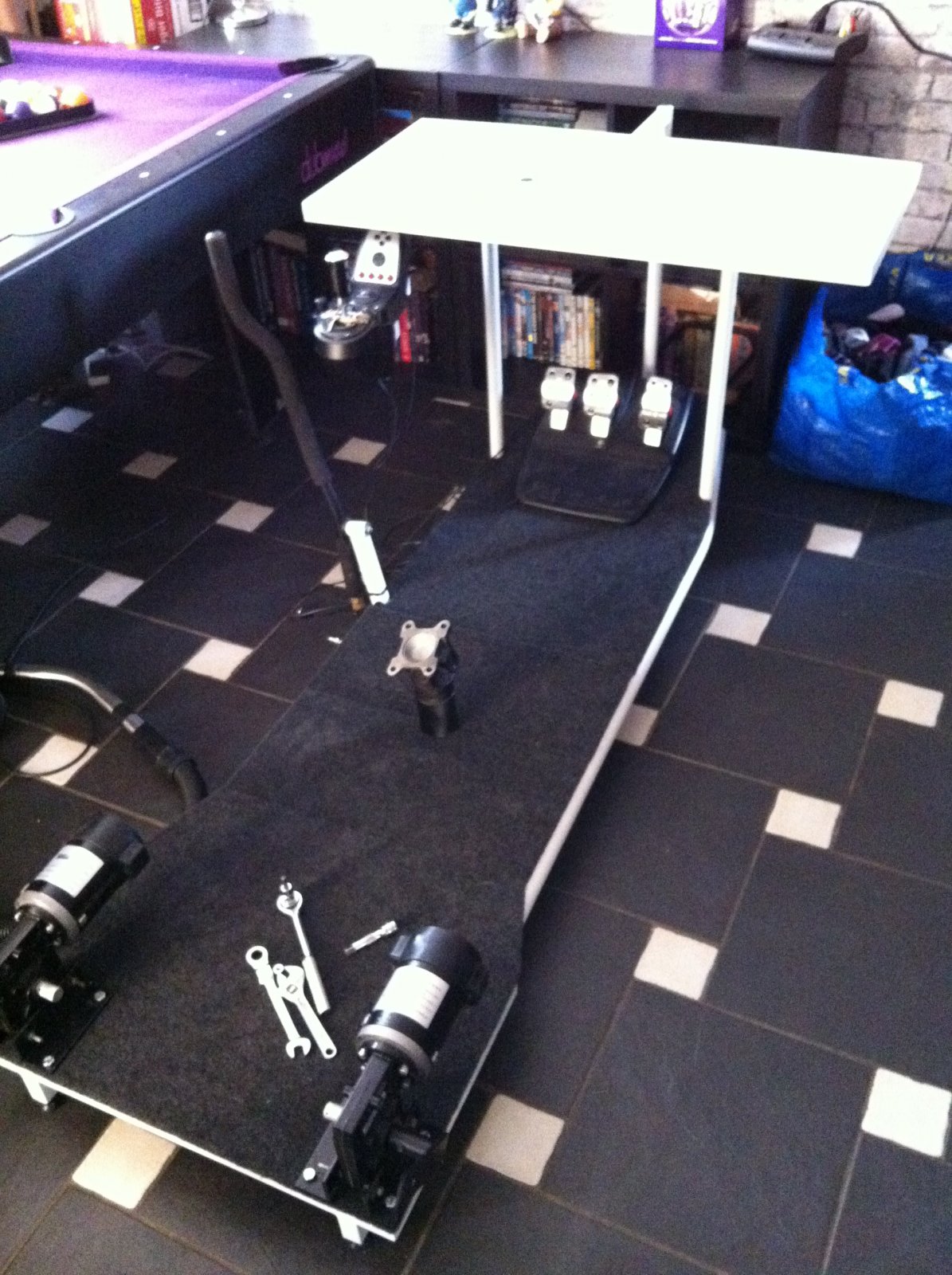

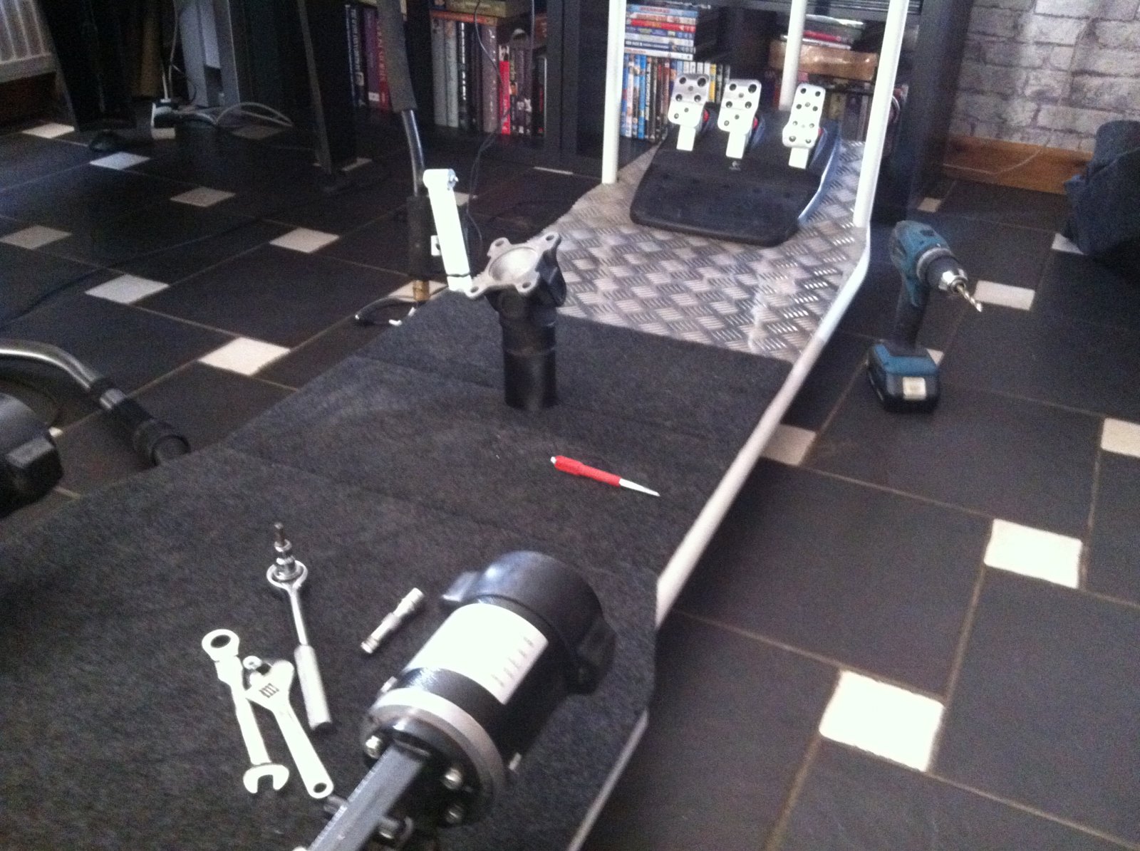

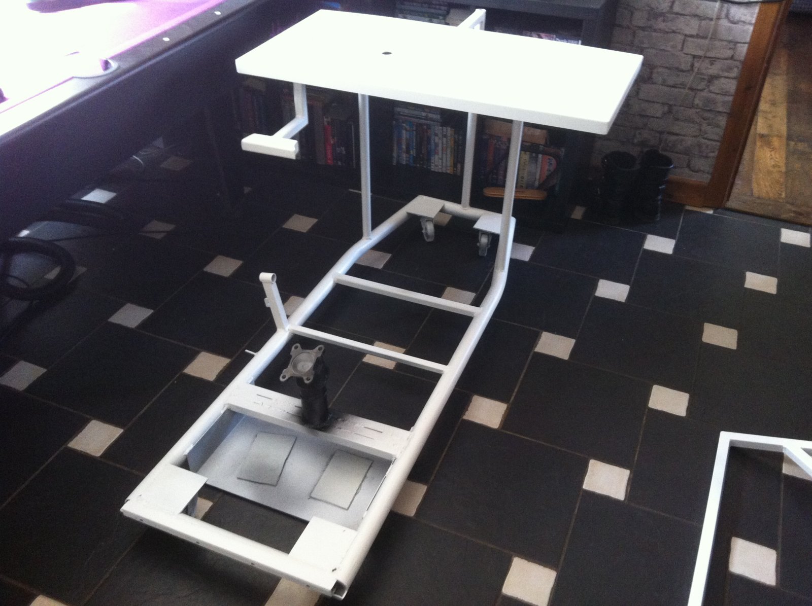

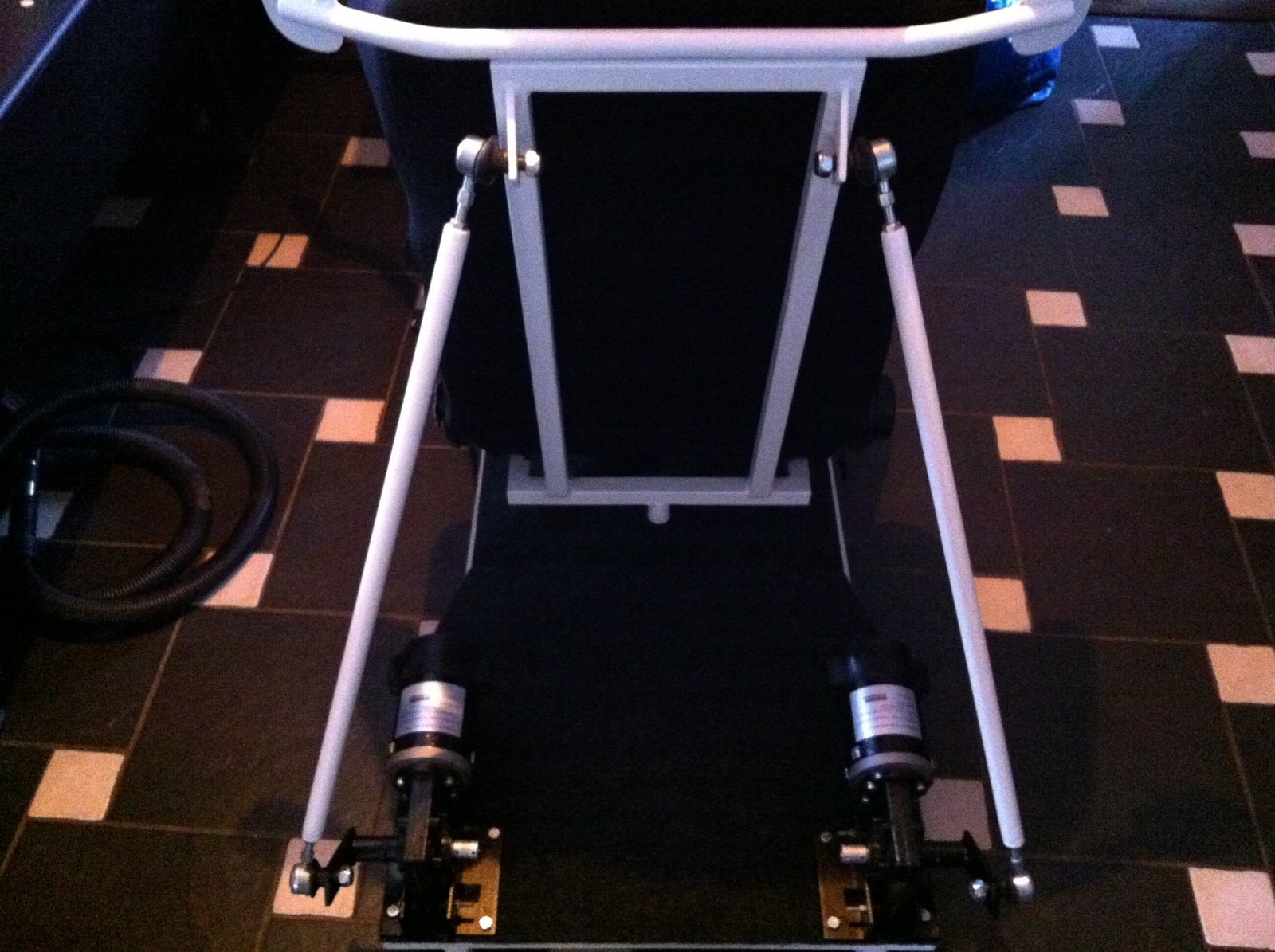

    been away for few days but made a bit of progress today

    Ok guys need a bit of help my rig is now in full test mode working with motion very happy (massive thank you all the helpful members of this site);)
    Ok so my question after about an hour or so of profile setting I keep getting the one motor stopping, I've tried a range of different kp and pwmmax settings from low to hi, strange that it seemed to work fine for the first hour.
    things I've noticed one motor gets a bit warmer than the other but it's the cooler motor that cuts out the heat sinks on both MM are cool to the touch so I'm thinking it's not a heat related issue.
    im away from pc right now so if you guys need any screen shots etc let me know
    Thanks in advance
    Dag
  20. Pit
    3,007
    30,517Coins
    +3,098 / 31 / -0
    @Daguru great rig you have build so far! Please can you share more information, some more details, when it happens, which tracks of which racing sim you are using, which SMC3 settings you are using etc. Please post only information about any issues which has been confirmed.
