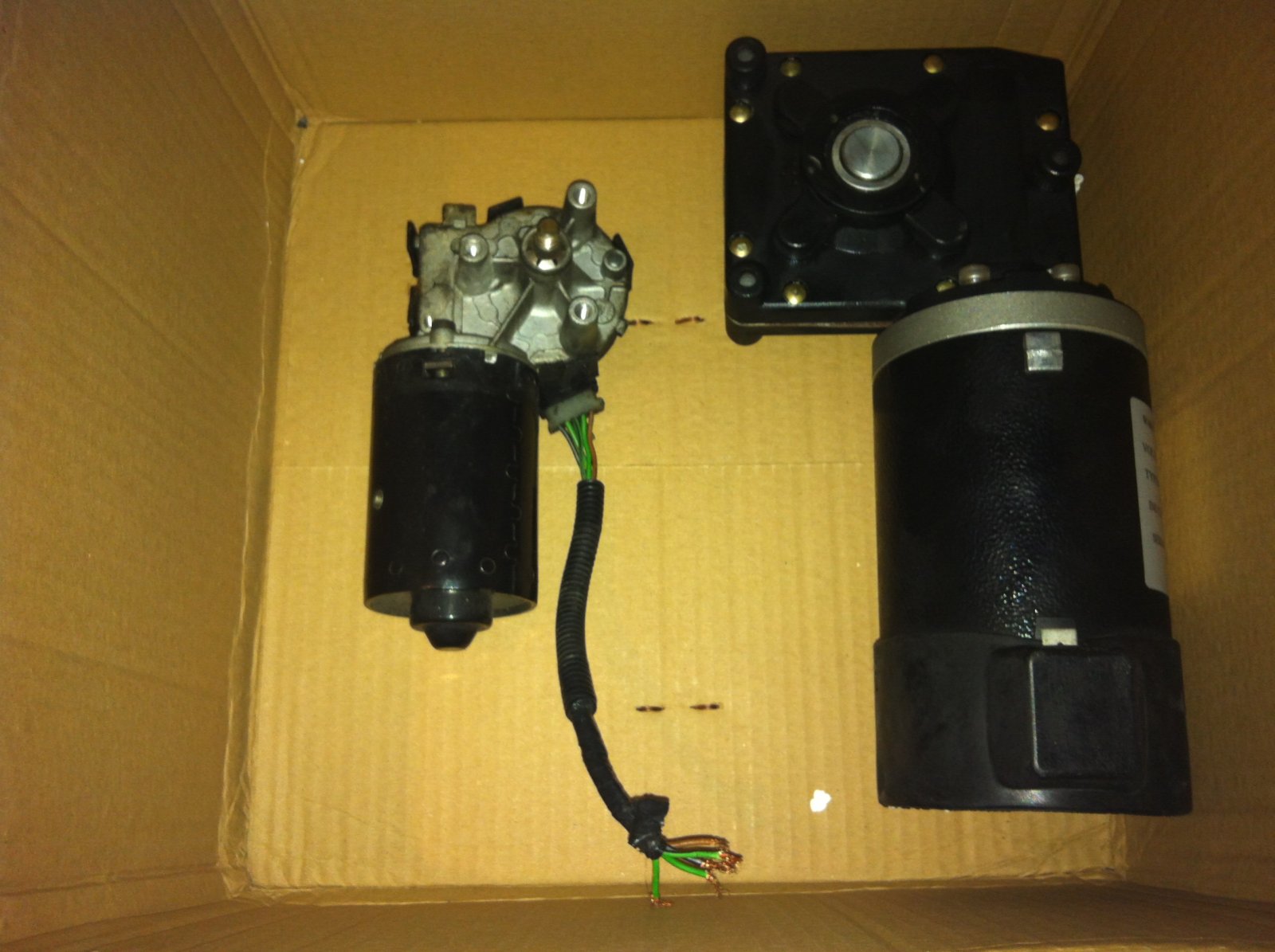

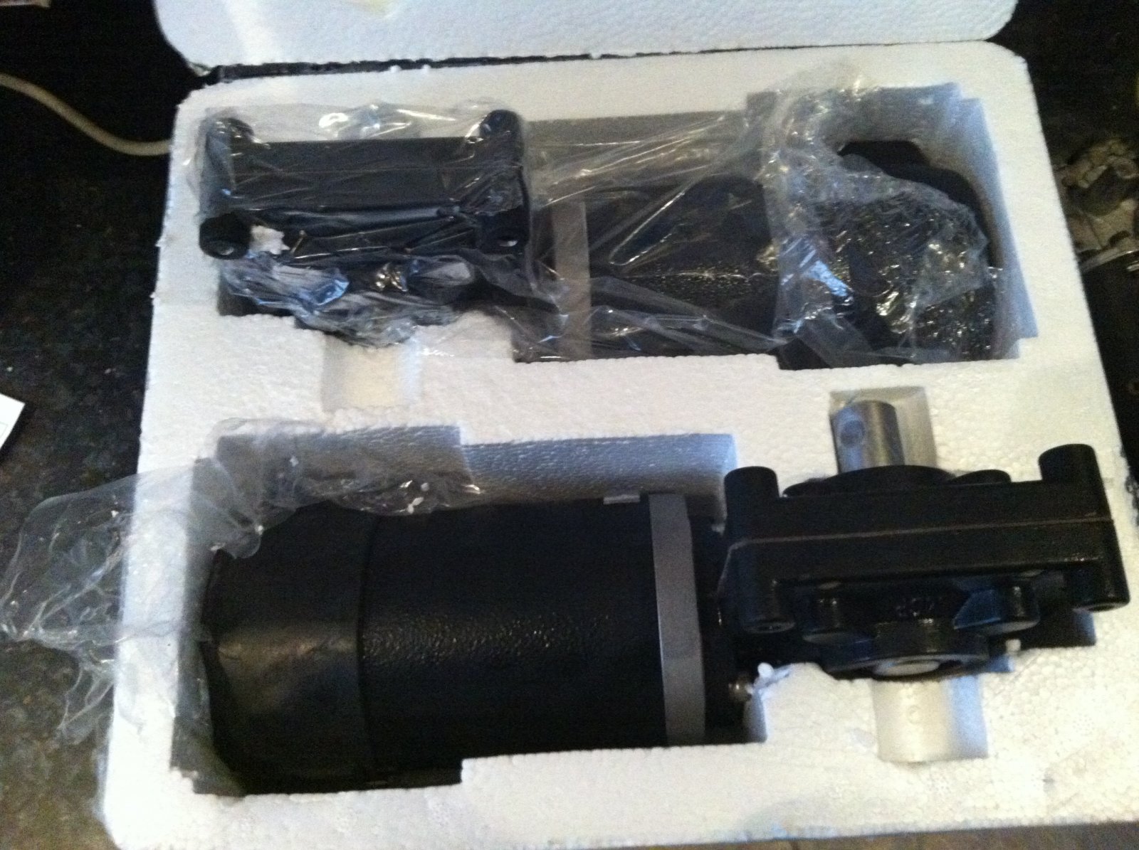

    Still not had much time for this project just getting bits done here and there.
    got a couple of pics nothing major just small update.

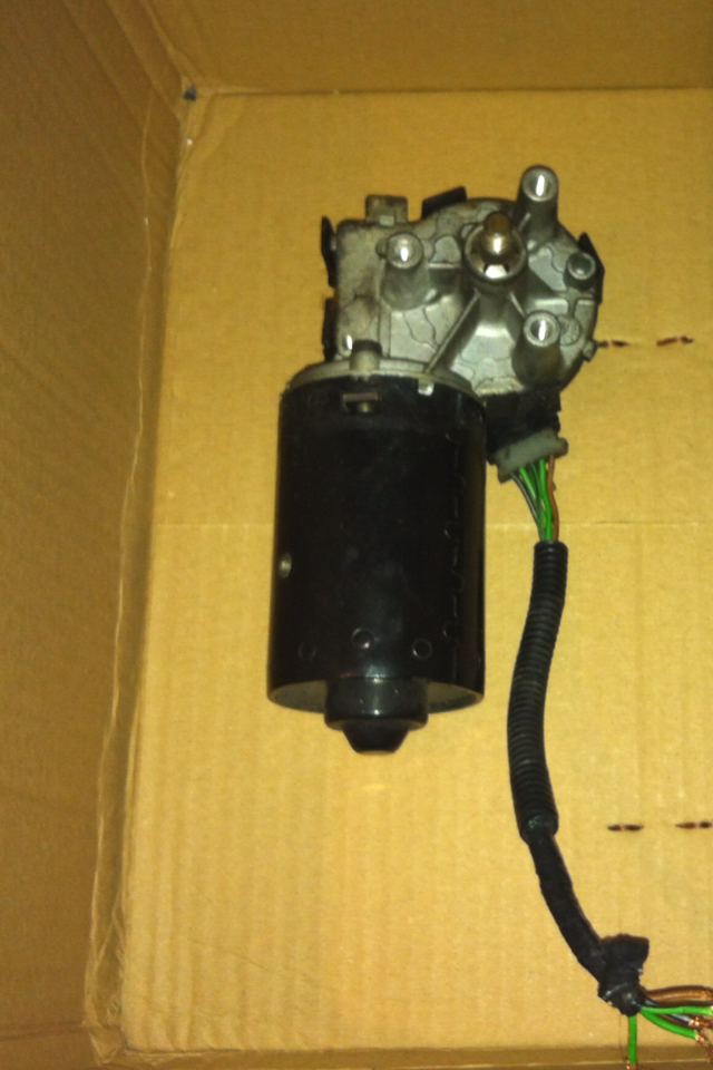

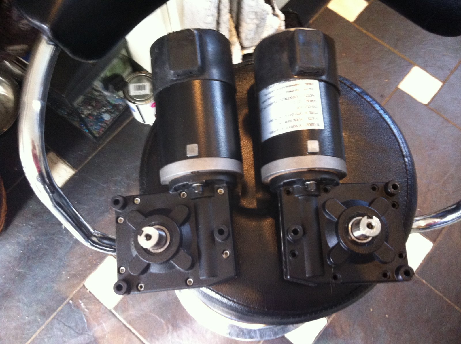

    first pic of motor was going to use
    new motors
    these are monster motors lol side by side
    I have seen people say they cant believe the size of these worm drive motors well WOW !! is all I can say.

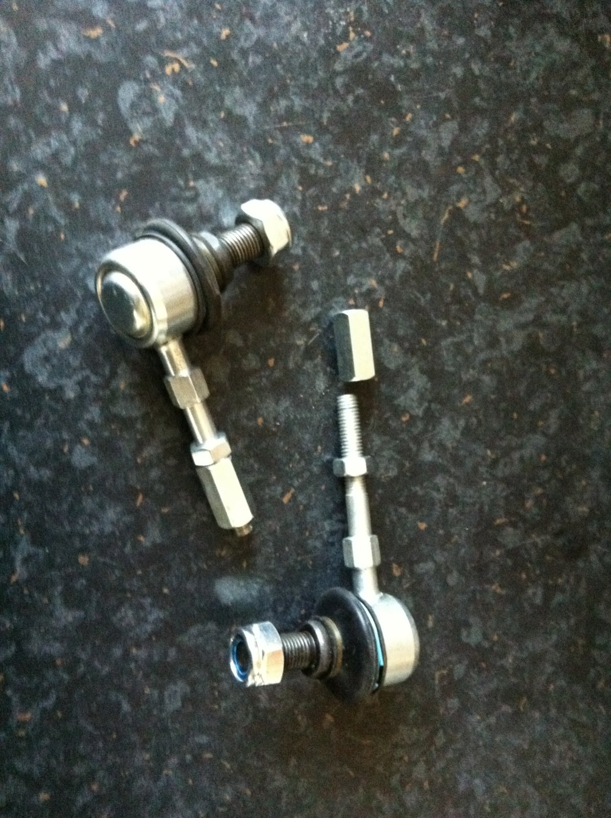

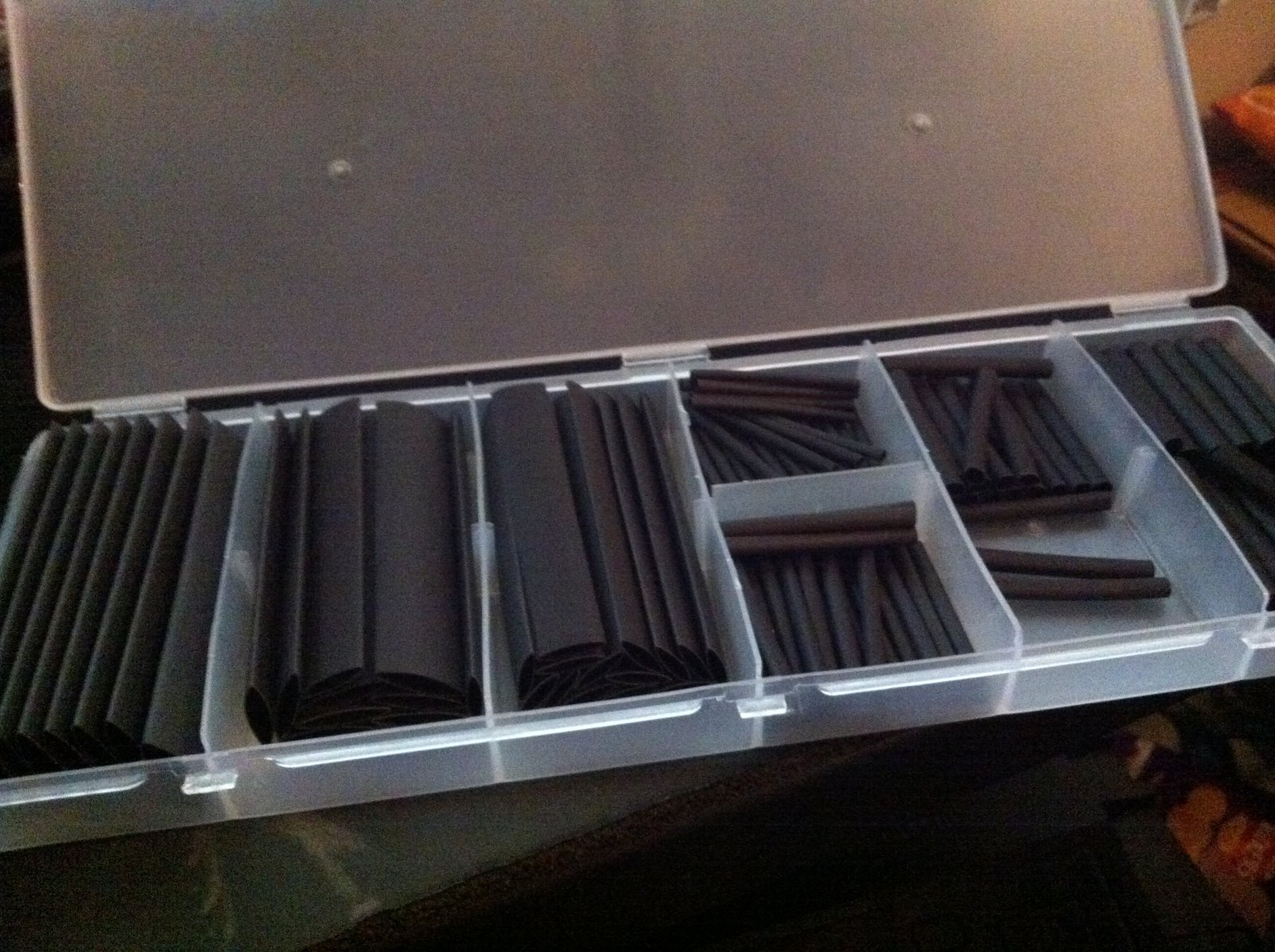

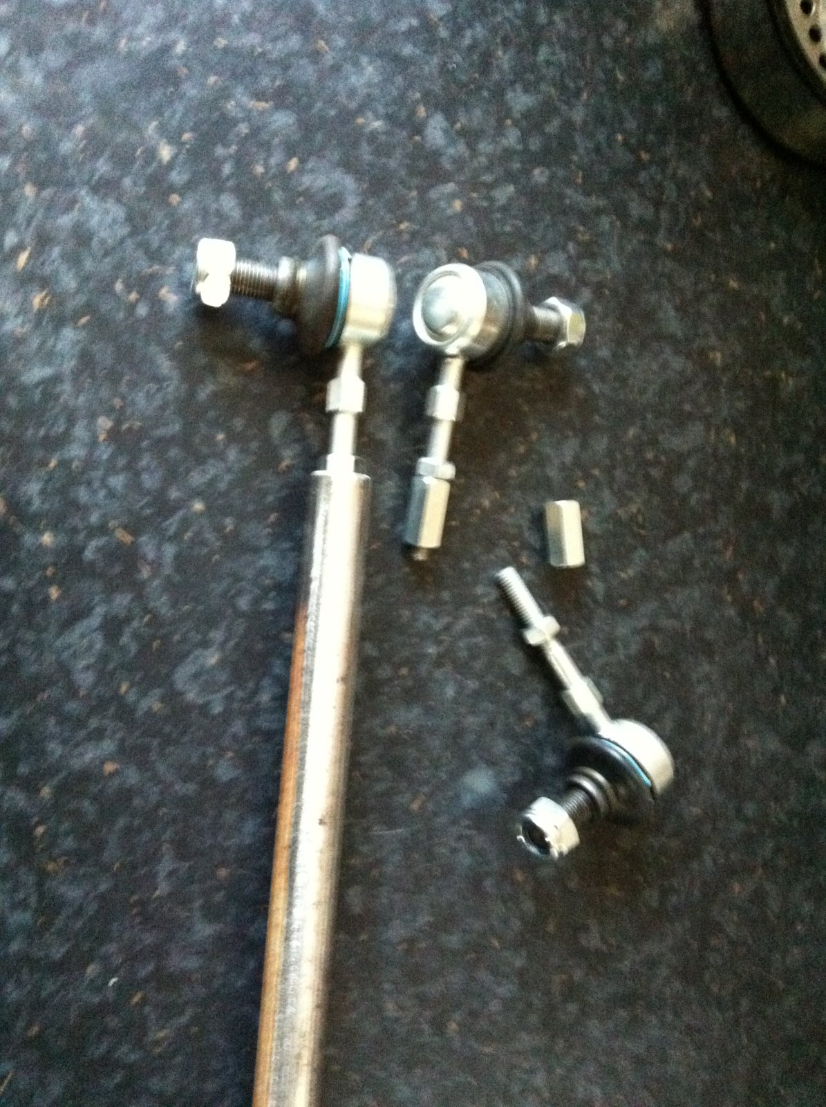

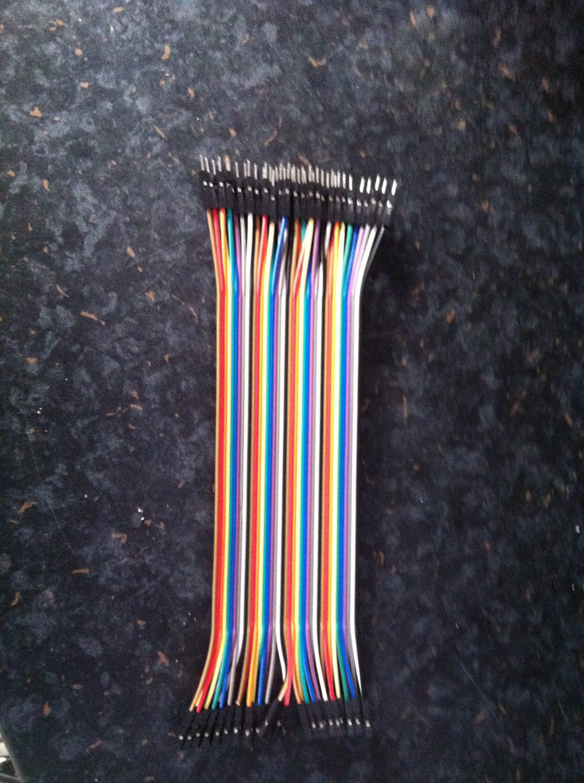

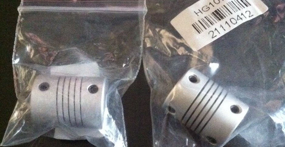

    Got my flexi couplers
    jumper wires
    ball joints with threaded bar joiners to slide into the tube for welding
    and cant forget the heat shrink makes a normal wire job look pro lol

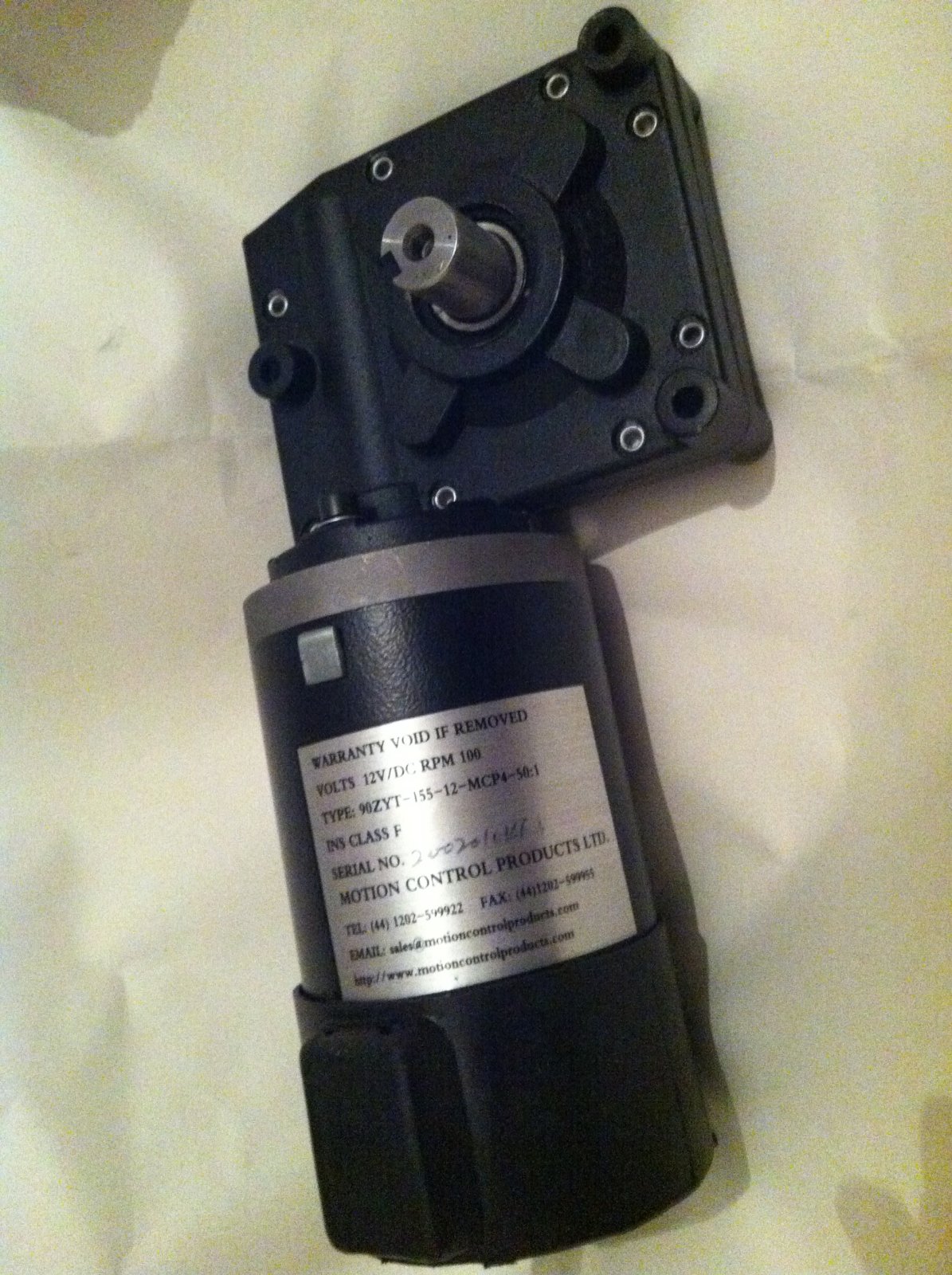

    The new motors are in a whole different league @Daguru. What ratio are the gearboxes?

    @noorbeast i have changed my mind so many times but now I think I'm going for shoulder mount seat mover which is going to be a cut and re weld of my static rig and as for gearbox ratio I have a choice the ones in the pic is 60:1 and some second hand 50:1 came up on eBay so I grabbed them also :grin

    There is a big difference in size between the two engines, one does not believe like that. The gear reducer is what the matter?

    Good picture comparing the motors, omg! :eek: "My Mommy always said there were no monsters, no real ones... But there are" -Newt

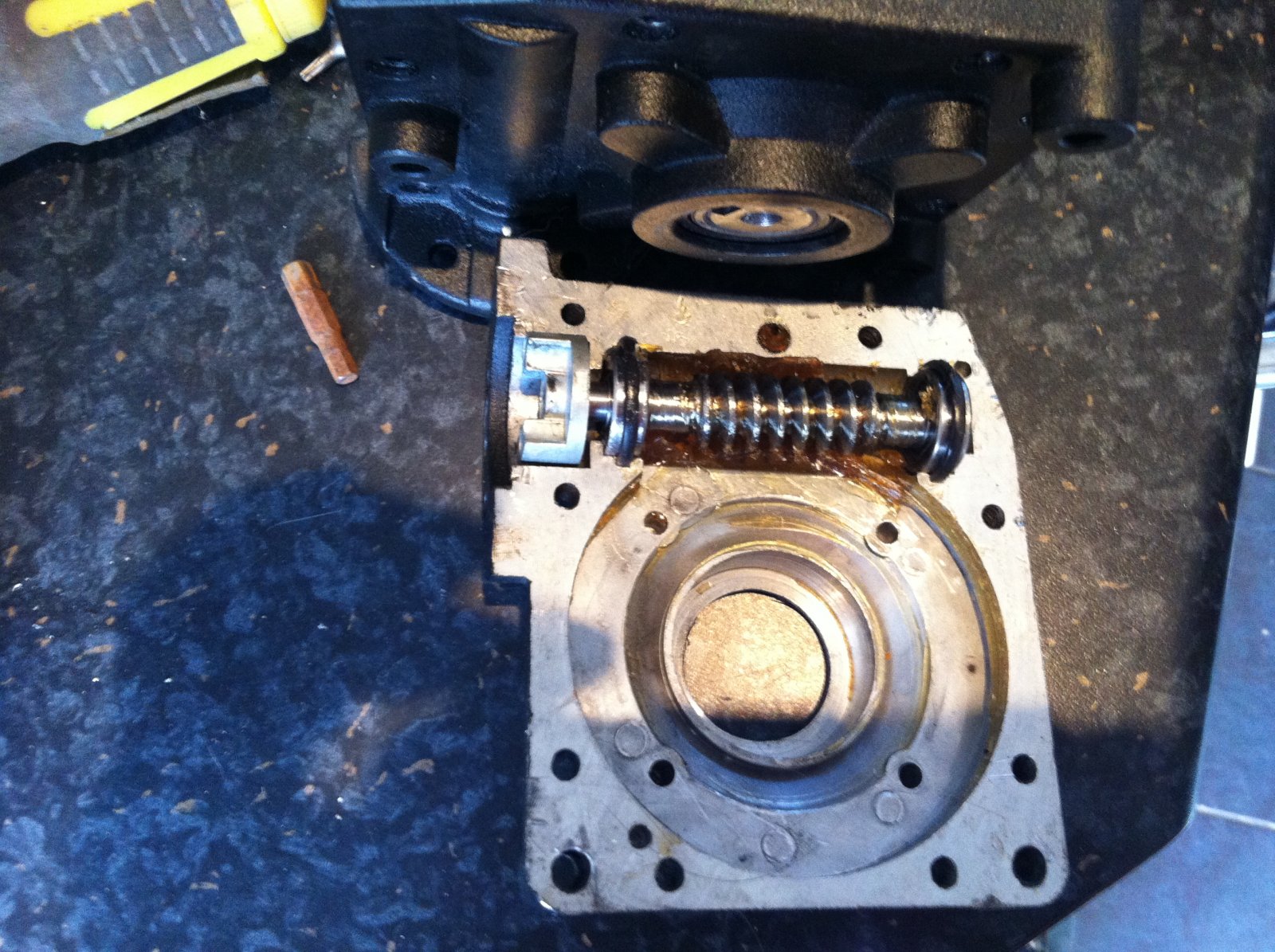

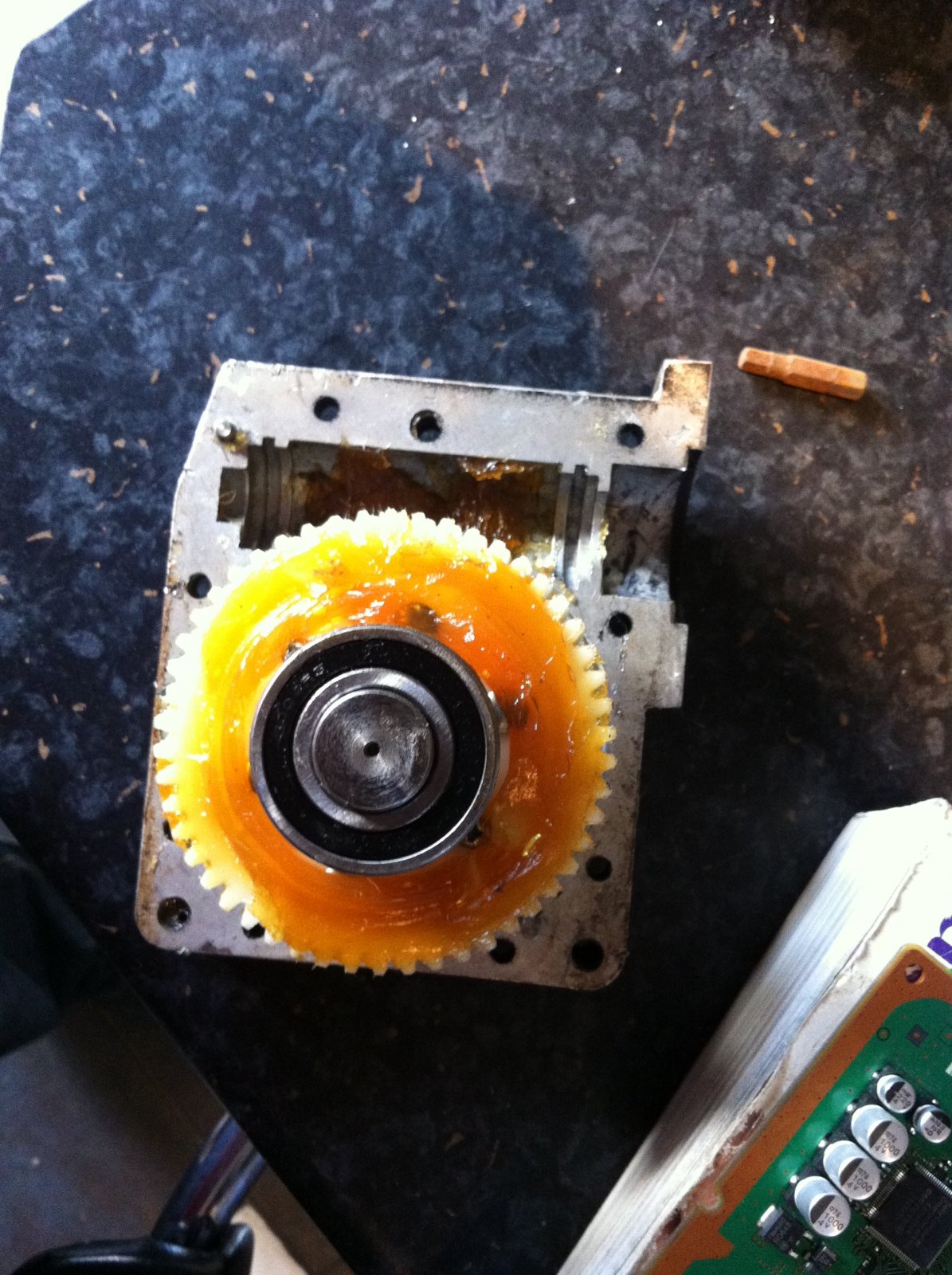

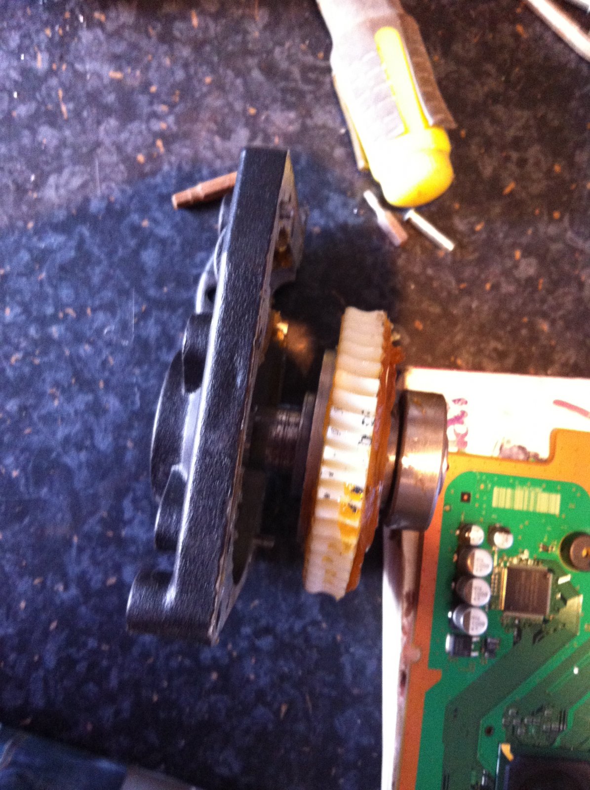

    Does anyone know if these motors be taken apart and swap the handing of the gearbox ?
    I have two the same hand and want to make a pair
    cheers in advance

  14. Daguru

    Thank you @noorbeast I will split the box and see if it can be done and post some pictures of my findings :)

    Thanks again @noorbeast gearbox hand swap was a great success:grin
    split the box
    press out the shaft and bearing
    cleaned and re greased
    pressed back together job done :cheers
  16. RacingMat
    2,234
    21,101Coins
    well done! nice pics!
    i'm surprised it's nylon made... but it has been proven to be solid, no?

    Not used it under load yet just tested on the bench (I picked these up cheap off eBay ) so had no choice with what hand they were .
    So I have 2 pairs of motors 1 pair of 60:1 and 1 pair of 50:1 which set should I run with on a shoulder mount seat mover I'm about 200lbs (90 kg) ?
    Thanks in advance
  18. noorbeast
    22,211
    154,729Coins
    +11,213 / 57 / -2
    Either would work fine.
